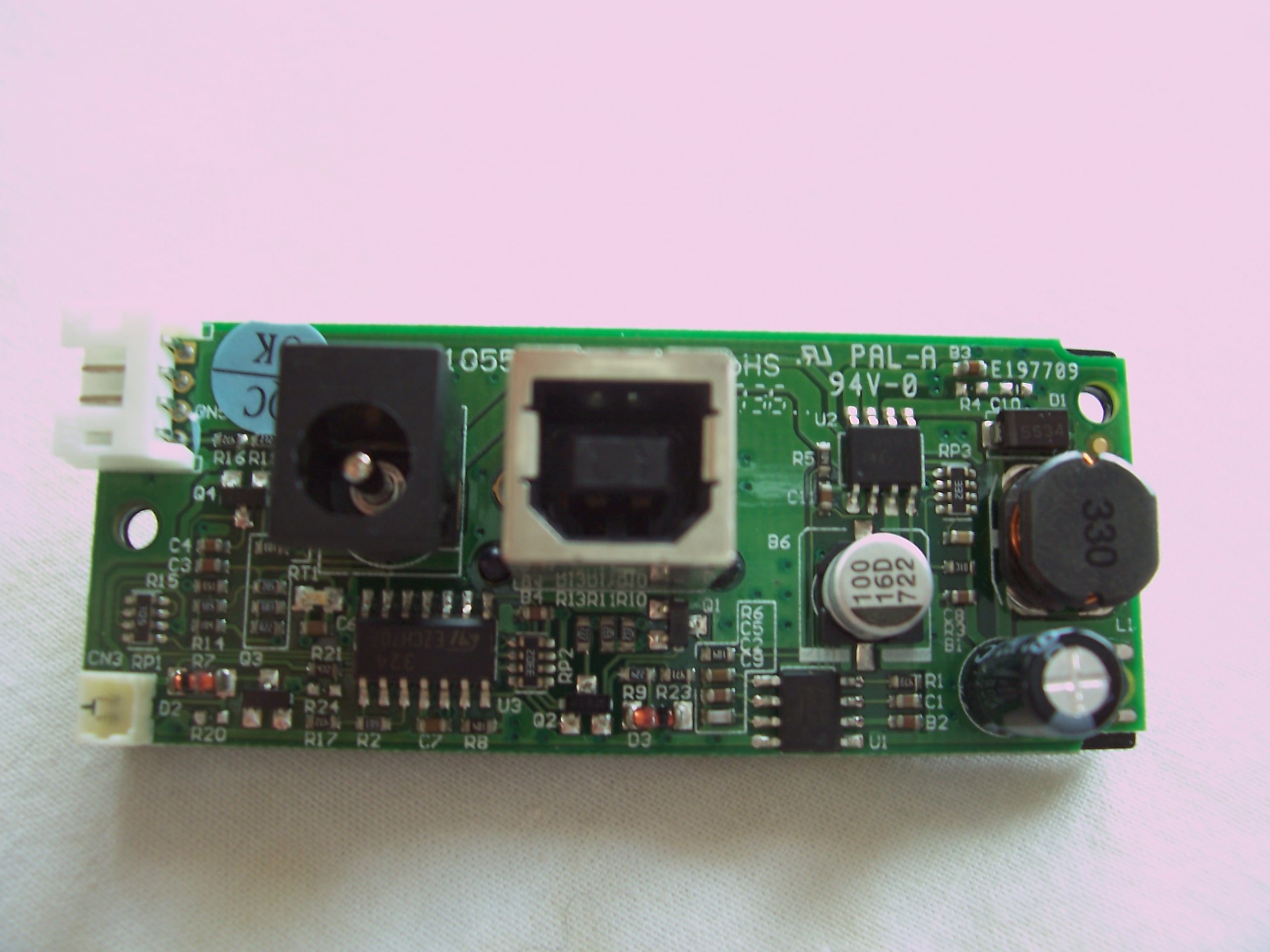

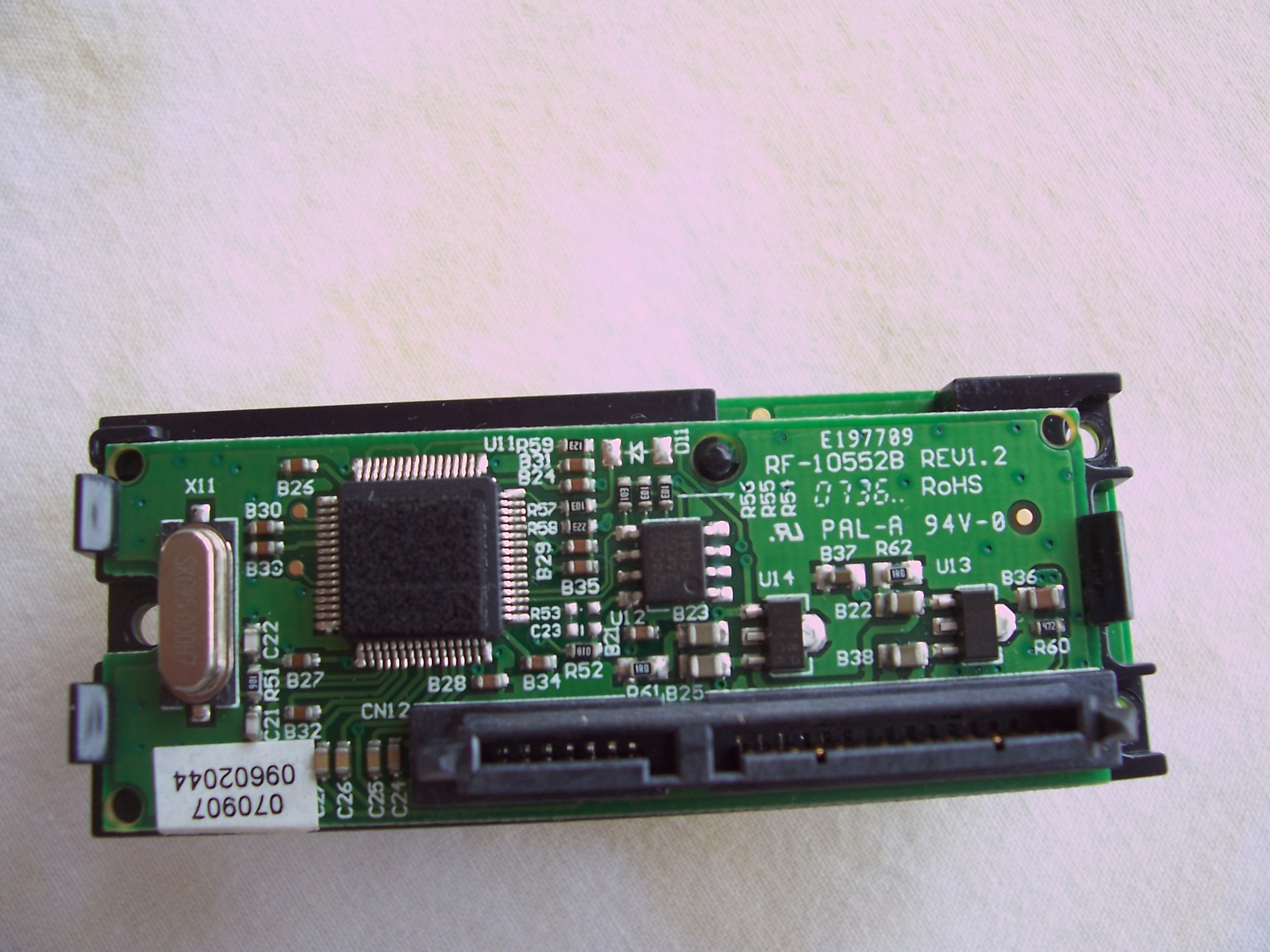

                  Re: External Drive Enclosure
                  As promised here is some pictures
                    • 31281
                    nice.
                    plug the psu in,
                    and meter the voltage on the 2 things that look like regulators - u13 and u14
                      U2 looks like a DC-DC converter with that big diode and inductor connected to it
                        Originally posted by stj
                        nice.
                        plug the psu in,
                        U13 looks like BA33P reading left to right (with ground on top) Black on center pin, red on pin 1- 3.297v and red on pin 3 - 5.11v
                        U14 looks like CB18p reading left to right (ground on top) black on center pin red on pin 1 - 1.783v red on pin 3 - 3.296v I don't have a date sheet so not sure which pins are in or out
                          • 31281
                          pin 1 is output - and they seem o.k.
                          they are 1117 compatable 3v3 and 1v8
                          i suspect the initial 5v is from the switching supply mentioned by agent24
                          so power-wise that only leaves the 12v to check.
                          i cant see any access to the connector solder-joints - best to plug it into a harddrive & meter the connections on the drive-side.
                          it's the wide-part.
                          did you try it with a 3.5inch drive, or a 2.5inch one?
                          2.5 wont need 12v.
                            Reading 5.17v only. 12v is missing?? 3.5 inch drive will not work a 2.5 inch drive will work just fine
                              then you found the fault - trace the 12v contacts back & see where they lead.
                                Success!!! at least temporarily?? The fault is with a ribbon cable that connect the front and back boards. This cable has separated from the board with the sata connector dropping the voltage to that board. I am not sure if this ribbon cable was soldered to the two boards or just glued in place?? right now I have soldered it but it don't look pretty however it do work but sometime I get a message "the hard drive need to be formatted before use"
                                  • 31281
                                  maybe it's pulling too much current for the connections - see if the 5v & gnd have the same poor looknig connections.
                                    Thanks stj.Yes it do and I will be going back over the thing later to try and fix up the poor solder job (soldering not my specialty)
