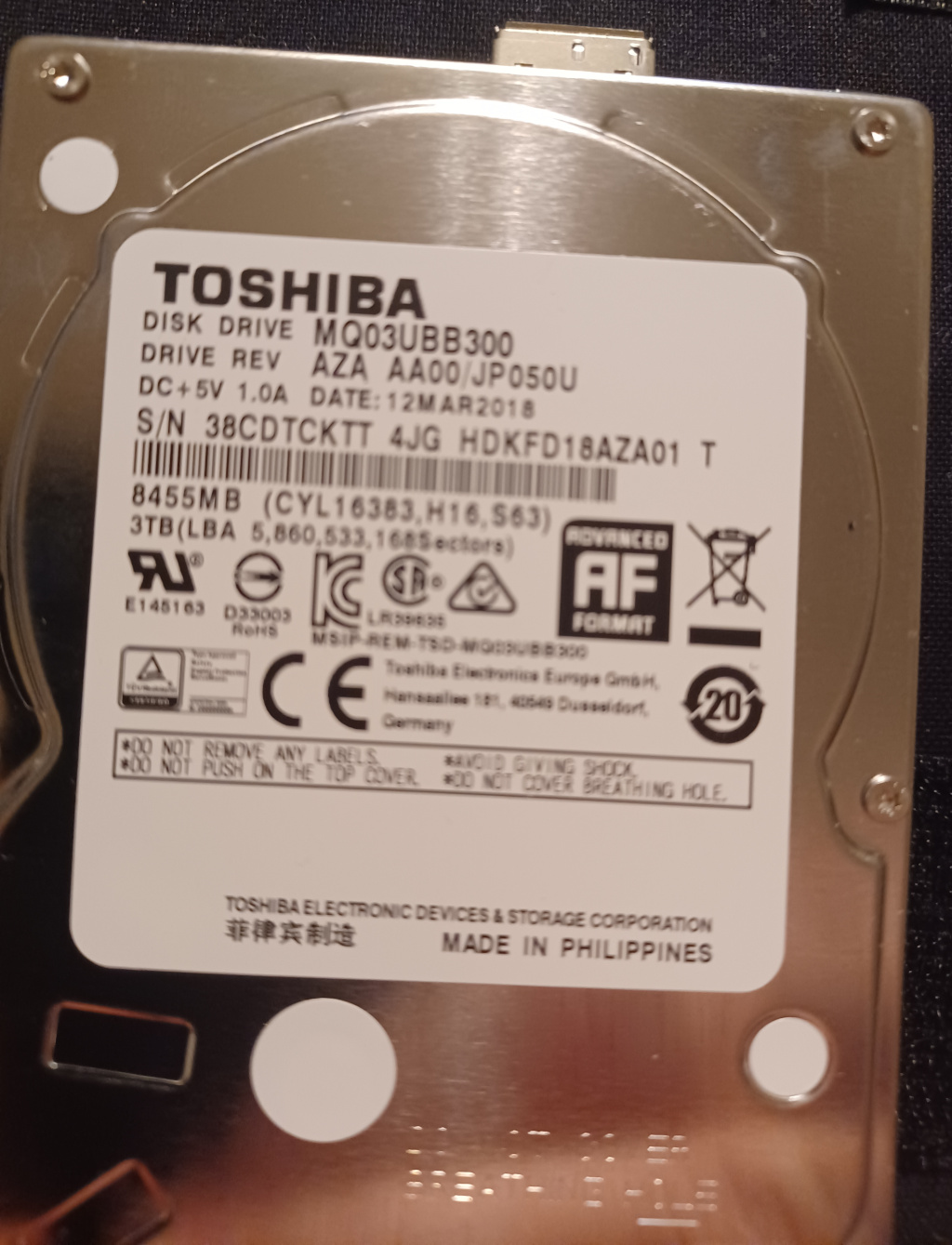

    I had been using this hard drive for a while, and it worked fine only going back and forth between 3 computers.
    Plugged it into an older computer that happened to have a really loose USB port. Light flashed once and died, never to be powered up again. Not sure if it's relevant that the USB port was loose.
    Anyway, now it doesn't power up at all, it's been sitting on my desk for years and figured what the heck, nothing to lose as I'm not going to pay someone to fix it, maybe I can learn something from it.

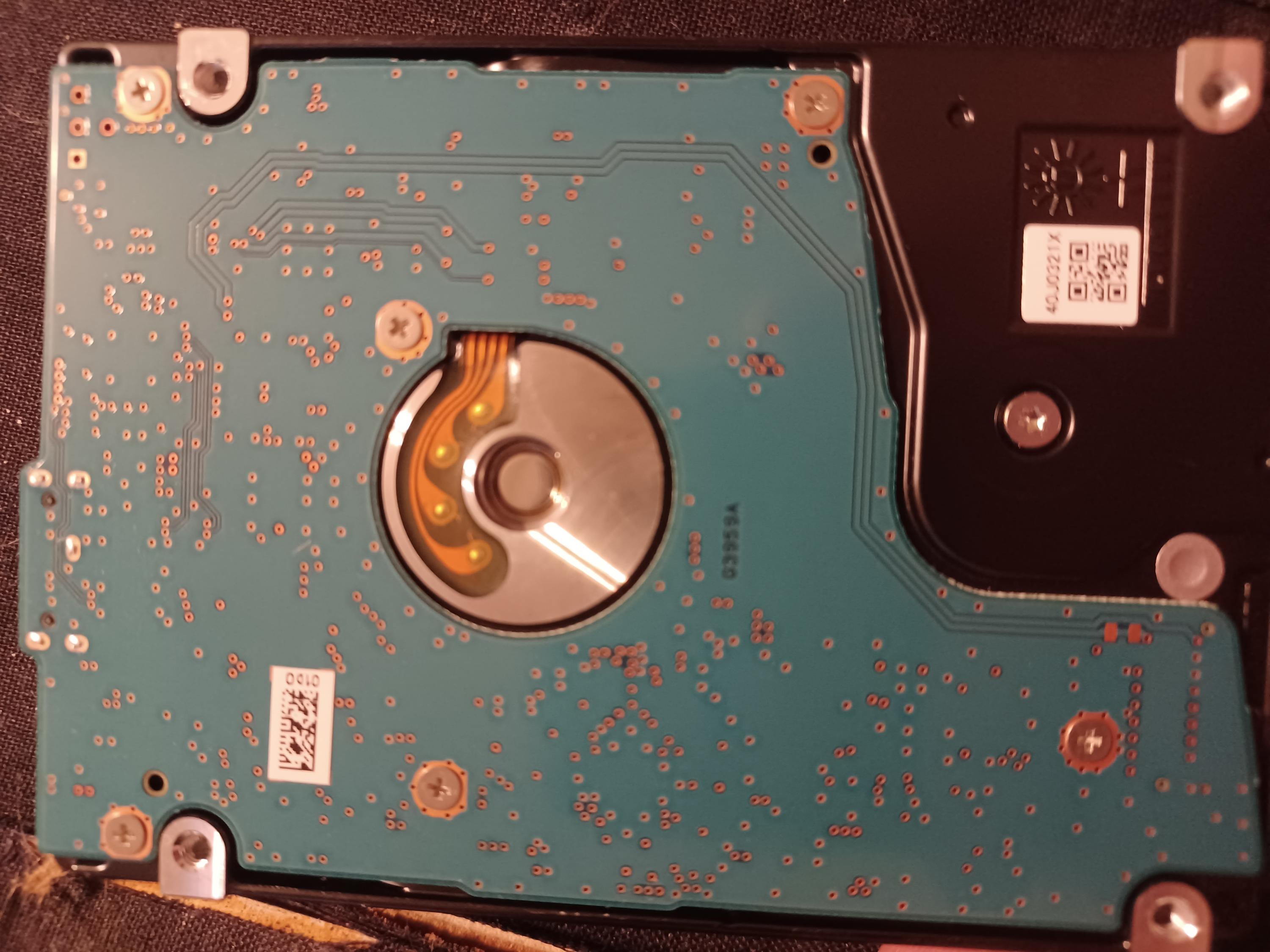

    Removed the case, figured I would look for anything obviously wrong. Though to my untrained eyes everything looks kinda normal, I don't see anything melted or burnt.
    Toshiba HDTW230XS3CA 3TB
    Disk Drive: MQ03UBB300
    Rev: AZA AA00/JP050U

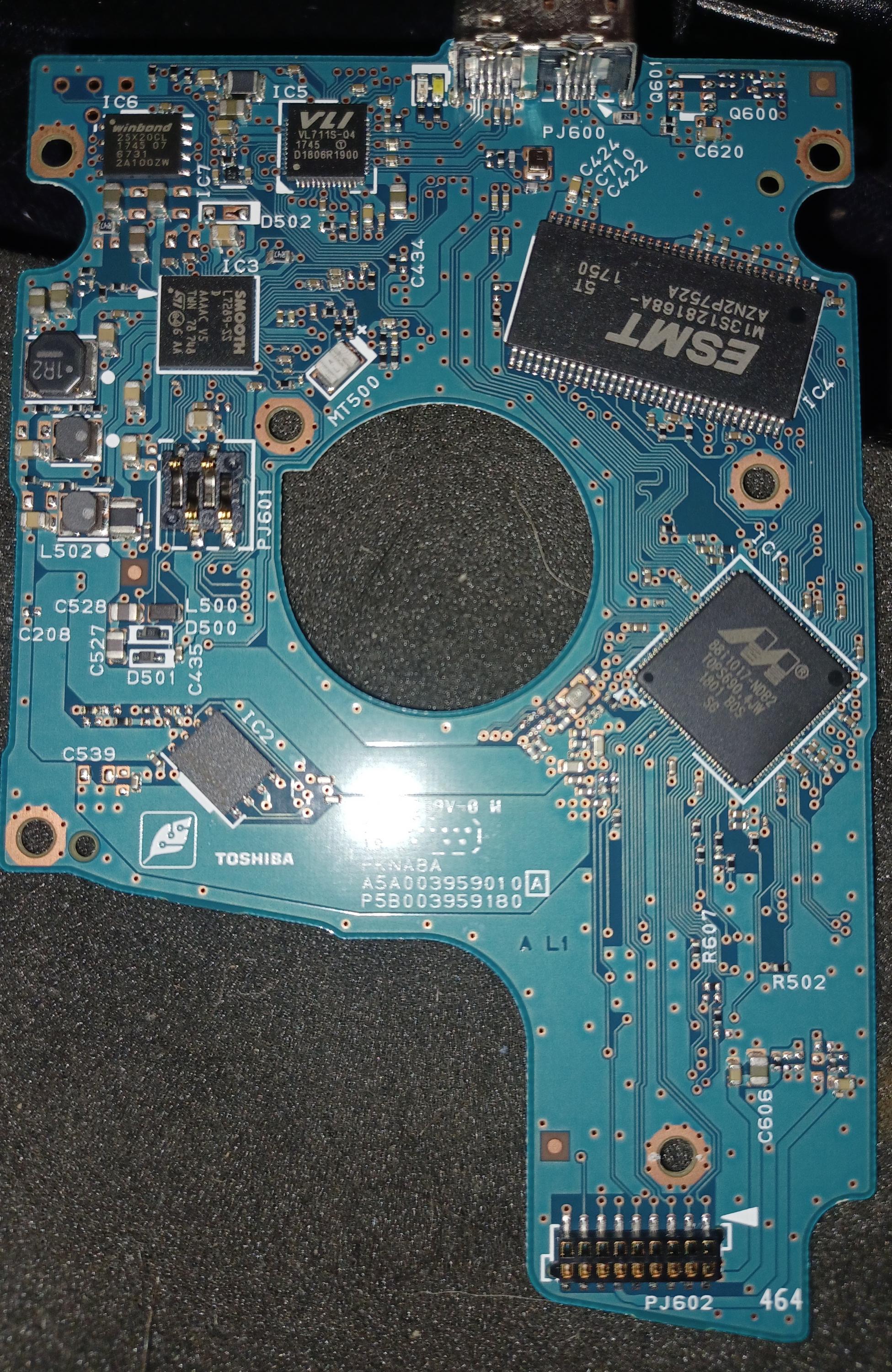

    Unfortunately the USB port is built into the controller board of the hard drive, so can't just swap the case for a new one like with a SATA drive. I'm guessing that these controller boards have specific information for each drive and simply swapping with an identical board is unlikely to work. If this is incorrect, I might be willing to buy an identical replacement drive and swap the board, but doubt that I could find the exact same board without opening up the case which I'm sure a seller isn't going to be willing to do.
    I have needles and some very small leads for my meter but maybe I could get some guidance on what to test/bypass/whatever to possibly get it to power on again.

    Check the soldering of the connector and measure the voltages on it.

      Also test the fuse is has N on it.

        Thanks for the reply. I got some results, results that seem really weird to me.
        I removed the controller board, plugged in cable and connected it to a USB port, nothing happened. Tested the voltage with my meter, leads between the port housing and the controller side of that fuse and the light on the controller board lit up right away and showed proper voltage. I thought it was weird that the controller board lit up just from testing the voltage. So I unplugged the board, then plugged it back in, no light. Tested the voltage again and the light came back on, so I unplugged and reinstalled the board to the drive.
        Same thing, no lights, drive didn't spin up. But I could just reach the controller side of that fuse, so I put my meter on it again to test the voltage as I had done previously. Surprisingly as soon as I connected my leads the drive light came on and the drive spun up like normal. Recovered all files and now I can unplug and plug in the drive repeatedly and it's working perfectly. I had plugged this drive in about 30+ times with all different ports and cables I could find and it never worked, how does simply testing the fuse cause it to power on and work like new?
        This result doesn't make any sense to me at all, but I'm super happy that I was able to recover my drive contents and that it's working perfectly. I erased the drive, wrote 3tb of data to the drive, checked integrity, all is well. Strange.
        • m710q_flash
          • Oct 2023
          • 6
          Just had another failure today. Makes absolutely zero sense to me. I have been using this drive regularly(multiple times weekly from my last post) for moving things around from computer to computer. Had the exact same thing happen again but on a different computer as I have disposed of that other computer. For some reason the drive simply doesn't power up at all. Took it apart again, split the case and take out the 6 screws, used my meter to ohm out the fuse, tested fine. Plugged in the same cable, same usb port, after testing the fuse and now it powers back on again.
          I guess the only reason I'm posting is so if someone else has this hard drive and has the same problem, something as simple as testing that fuse could get it to work again. I may not understand why, but it has worked for me twice now. Got two more years out of it from the last time, have had zero data errors and it's as fast as it has ever been. It's a mystery to me, but fingers crossed I get another two years out of it.
