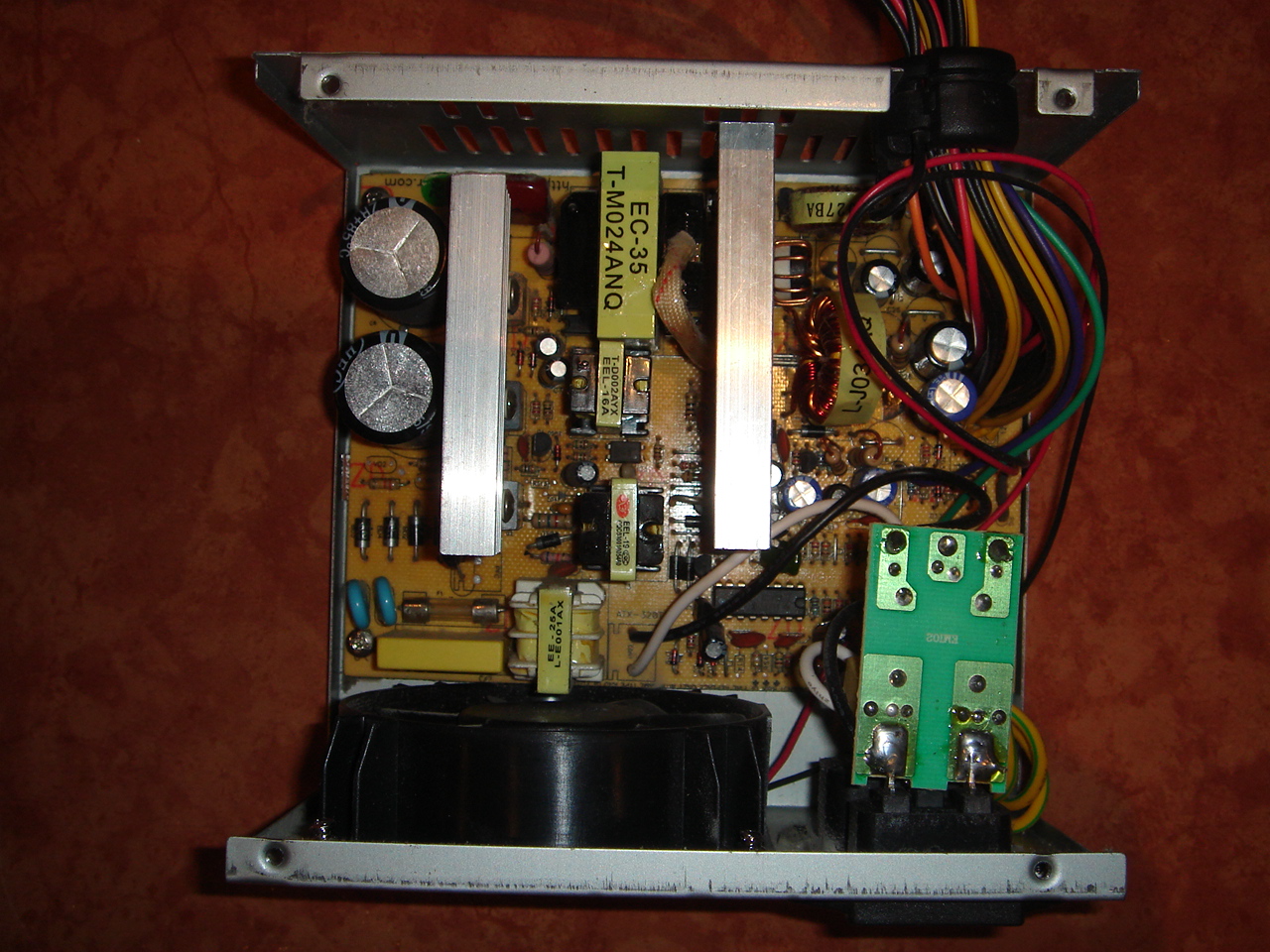

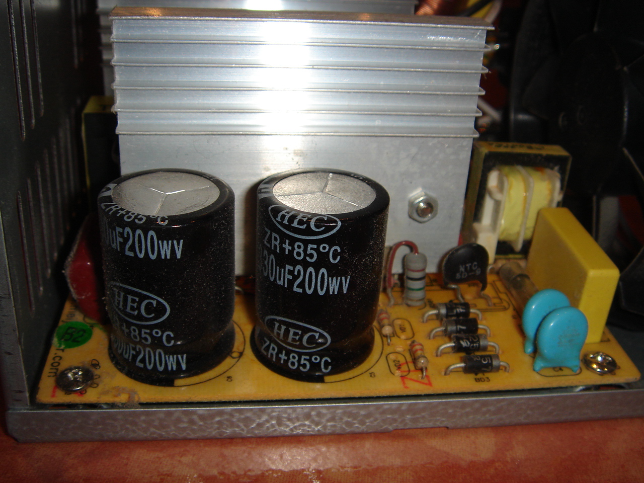

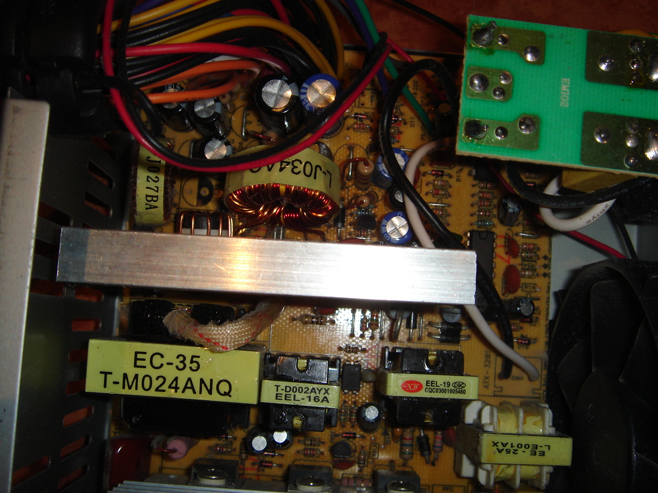

                  I finally took apart the PSU in the system to take some photos and it looks very hollow in there....
                  Does anyone know who makes this PSU?? it's a re-branded one so I am guessing it is a Deer PSU.... but i am probably wrong because my sample Deer power supply looks completely different in terms of PCB components layout.
                  Theres a web URL on the PCB of the PSU but I can't see it through all the wires everywhere.
                  Is this PSU still safe or should I just go and buy a new PSU?? Apparently that 500g (estimation) PSU pumps out 400W.... I kind of doubt it.... my Dell 300W PSU already weighs 1.8KG on the scale....
                  This PSU has been in use for about 3 years now.... It was originally taken from a P4 3.2Ghz system since the owner of the system upgraded to a Thermaltake 430W PSU.

                  • Rainbow
                    • Aug 2005
                    • 1371
                    Re: Is this a sign??
                    Doesn't like look DEER. Looks like 200-250W PSU.
