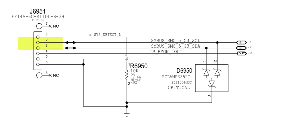

    Hi. See attached.
    Meter in DC volts mode.
    With extreme care, check the voltage to ground of the SMBUS (aka I2C) communication lines (SDA & SCL).
    on this logic board:
    SMBUS_SMC_5_G3_SCL
    SMBUS_SMC_5_G3_SDA
    The logic board will extract battery details using this 2 wire communication.
    What voltage do you measure on each of these lines ?
    Red meter probe on SDA; black meter probe to ground.
    Then repeat with SCL & ground.
    • kurland
      • Sep 2020
      • 25
      • Norway
      Re: MacBook A1707 - low batt sign displayed then shutdown - but battery voltage is ok
      That's a great tip, thank you.
      I scoped the SCL and SDA lines and they look perfectly fine. The SMC is obviously trying to speak to the battery.
