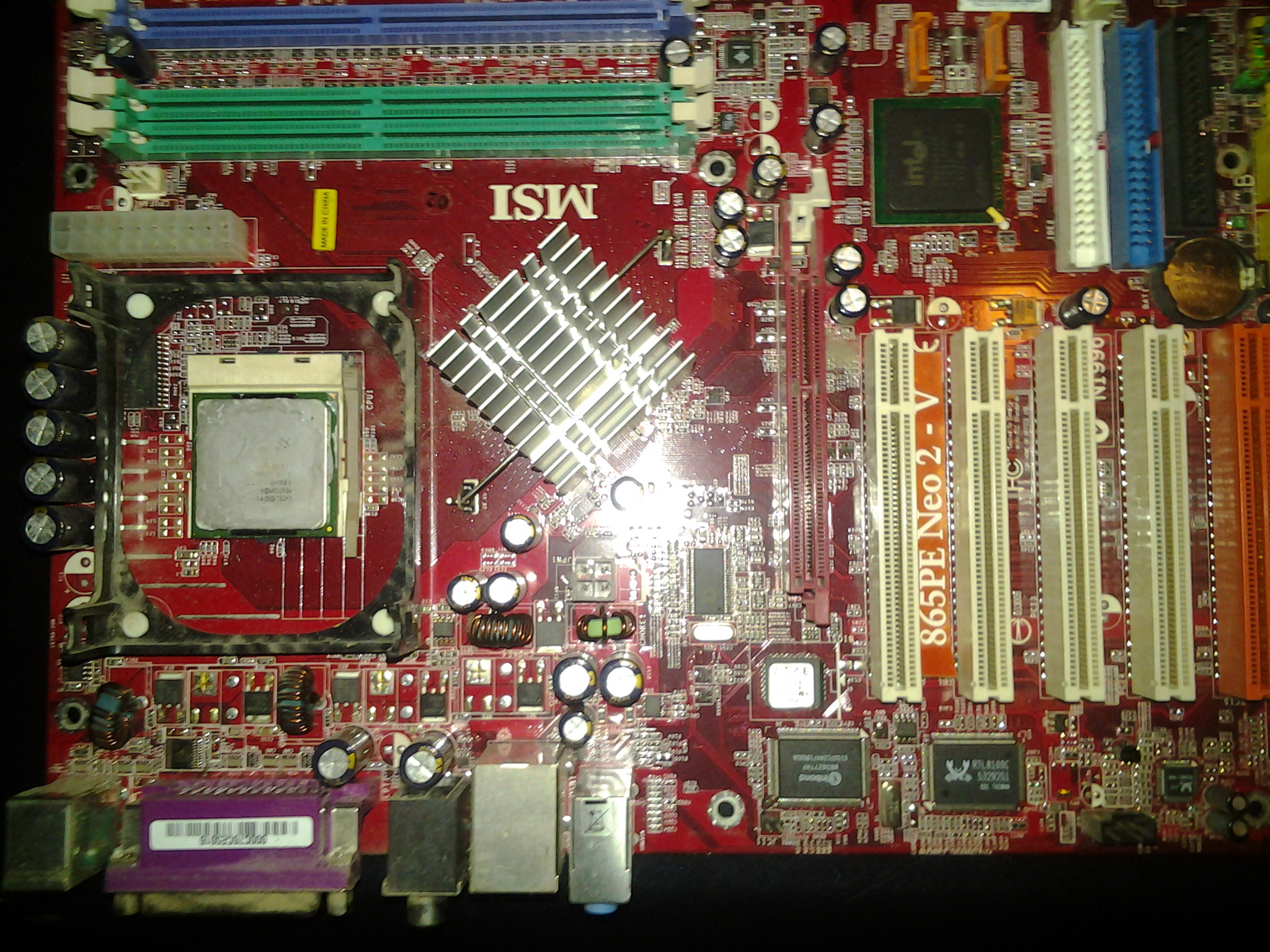

    MSI N1996 Motherboard with bad timer
    Hello, I have a MSI N1996 it also has a sticker on it that says 865PE Neo 2 - V.
    When I power it up it takes a long time then beeps once if I keep waiting it beeps twice then once more. If I leave it after that it just automatically shuts down. If i do not wait after the previous attempt to try it again it doesn't even get to the beeps it just shuts itself down.
    According to this site - https://forum-en.msi.com/index.php?topic=86906.0 Under the AMI BIOS (Which is what I have) 4 beeps means bad timer. Under the PHOENIX BIOS 1-2-1 beeps is also bad timer.
    If I am correct the timer is a chip on the motherboard right?
    If it is would it be possible to replace?
    All of my google searches just come up with changing the motherboard's battery.
    Any help is welcome

    Re: MSI N1996 Motherboard with bad timer
    I think you're looking at a complex solution when the answer may be simple
    1a. How do you know the memory you're using is good ?
    1b. And compatible with the board ?
    2a. How do you know the graphics card you're using is good ?
    2b. And compatible with the board ?
    3a. How do you know the processor you're using is good ?
    3b. And compatible with the board
    4a. Do you have the optional MSI D-Bracket ?

      the timer chip isn't a discrete part, it's either part of the super i/o chip or the southbridge. Either way you'll be hard pressed to get a replacement and actually swap it out unless you work with high pincount SMT or BGA packages.

        Which processor are you using ? - Pentium4 S478 a given - what speed, FSB, cache (all embossed on the chip) - Sspec would be useful
        What memory are you using ? - DDR1 a given - what brand and speed rating, i.e. DDR266/DDR333/DDR400 ?
        Is your board the model with three memory slots, or two ?
        Compatibility of components is an underrated requirement, but key to getting something that works
                Originally posted by canadaboy25
                since before it broke
                So it used to work, not something you've recently got your hands on ?
                my board has 3 memory slots.
                Your board has i865pe chipset (ties in with 865PE Neo2-V model name), as distinct from i848p chipset of two slot board
                Therefore it can run memory in dual-channel, given compatible DDR sticks
                Do you have memory in same coloured slots, or different coloured slots ?
                Have you tried removing second DDR stick, or moving it to alternate slot ?
                MSI manual indicates different coloured slots are dual-channel setup - at odds with convention, where dual-channel is same coloured slots
                I'd try a single memory stick first, to see if that boots - both yours are quality brands, I'd probably favour Samsung, but if one doesn't boot try the other
                If single stick boots, try second stick, moving to alternate slot if no boot at first

                    Well I took the motherboard out of the case and attached the bracket and put in one ram module and the graphics card and the system is now working fine other than the fact that it randomly shuts down all the time. What would cause that?

                            Well I had taken off the cpu fan/cooler for testing to see if it would boot because the atx plug is in a hard to get to spot. So I put the cooler on and presto! now its working
                            The only issue I have now is SATA hdd's wont show up in the bios and the BIOS has 4 IDE channels when my board only has two any Idea how to fix that?

                              Sounds like your SATA contoller is running in IDE mode. There should be an option somewhere to change it to SATA or AHCI mode.

                                i865 SATA channels will show up as IDE
                                Check SATA is Enabled in BIOS - presumably so, if you have extra IDE channels showing
                                If Enabled, try new SATA cables - temperamental things
                                Otherwise, disks not compatible with i865's SATA - or need jumpering into compatible mode
