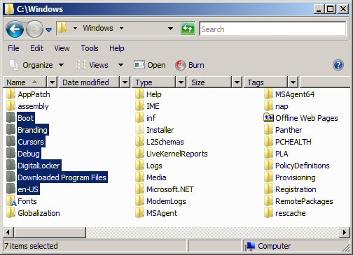

    Ok, this is server 2008 R1, which is the Windows Vista UI when it comes to themes and Aero. It doesn't in R2, which is the Win7 UI. It's not an Aero thing, as it does this with Aero off, but using the basic theme. Note in the image below how browsing files in a list, the highlight doesn't just select the file, but also the entire line in the grid....IE there's no 'dead space' to click to unselect or drag anything without moving the selected. This is insanely annoying!!
    Where is the setting to change this to select/highlight the folder/file ONLY, and not the entire space in the grid?!?
    Like this (shown using windows classic theme):
    The setting is probably stupid simple, but for the life of me I can't seem to find it.... Normally, I'd just leave the 'classic' theme on and call it a day, but this computer isn't for me, and it's user really wants the vista/aero theme, if this little quirk can be figured out...

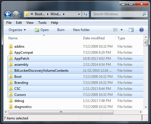

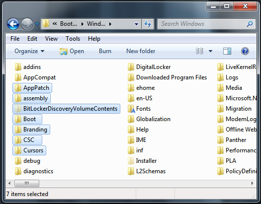

    Whilst not an answer if you can view as "Tile" instead of a list can you select a single tile
    • Per Hansson
      • Jul 2005
      • 5895
      • Sweden
      Re: Windows Explorer Issue....and an annoying one!!
      It's the same in Windows 7.
      AFAIK it can't be configured.
      And yea I've seen firsthand how lots of people have issues with this.
      Never really thought much about it before I saw your screenshots now...
      EDIT: Found this but it's not without caveats...
      http://www.winhelponline.com/blog/di...rer-windows-7/
      EDIT2:
      Server 2008 R1 = Vista
      Server 2008 R2 = Win7
      Keep that in mind when reading the above link.

          I was wondering about this. I don't like being able to select a file by clicking anywhere in the grid, but you have to right-click directly on the file name or icon. I've had a lot of issues with copying and pasting in Windows 7 as well because of this.
          I could never figure out why double-clicking on the file name sometimes opens the file and sometimes highlights the name so the file can be renamed. It seemed completely random to me. Clicking once on the file before double-clicking like that article said doesn't seem to help.

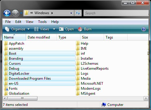

              Any ideas on how to disable the mouseover / hover? With that gone, I think the problem would be gone too.....couldn't seem to find an answer to that question either.

                  Been there, done that. The mouseover thing is part of the theme, only does it with the vista (with and without aero) theme selected. WIth the windows classic theme, its just like normal....its an eye candy thing, not a mouse problem. Win7 does it too, but only the file/folder name in explorer. S2K8 (like Vista) does it like the image in my initial post, it highlights the whole grid line....which is asinine!!

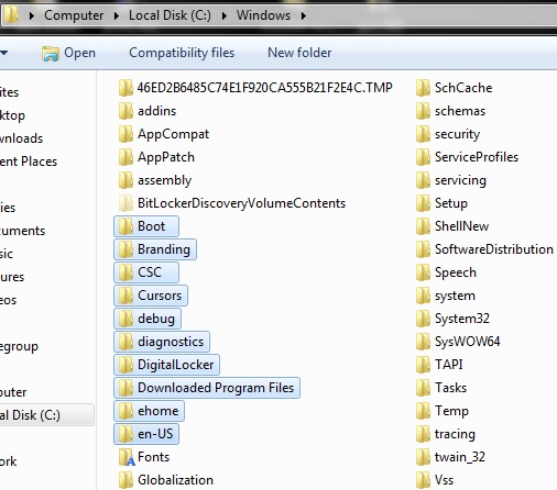

                      I am running x64 Windows 7, sp1 and while in 'detail view' the whole row is selected but in 'list view' it is not. (See attached)
                      I would like to note here that the basic theme still uses aero while the classic does not. You can open basic.theme in notepad and scroll down to the
                      [VisualStyles] section and see it is using Aero.msstyles
                      While in the themes folder, I noticed all the files are dated 6/10/2009 except for aero.msstyles, which is dated 11/20/2010. It appears MS updated aero. Perhaps the version of aero.msstyles is affecting how the folders are highlighted.
