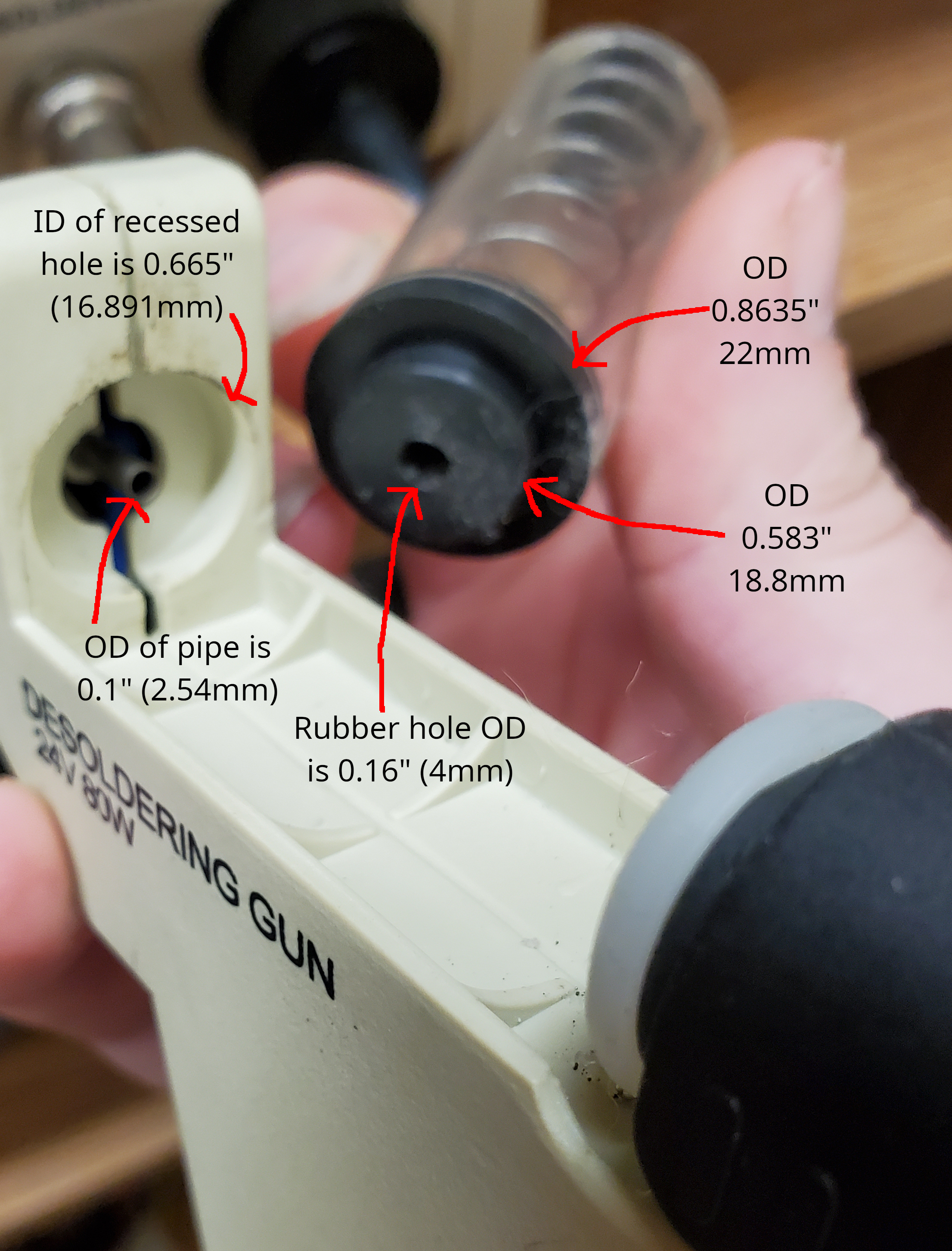

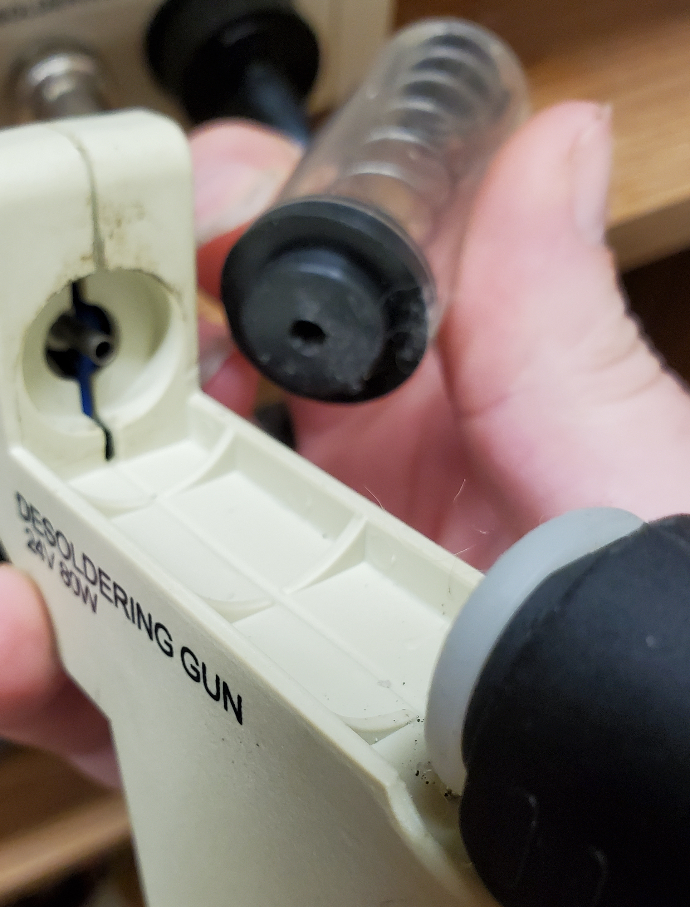

      now that my phone is charged i can take a photo

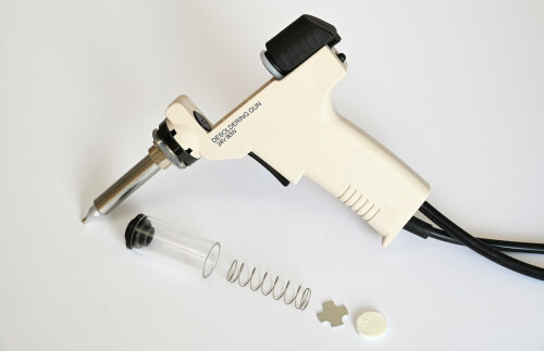

        Click image for larger version  Name:	zd-552.jpg Views:	0 Size:	26.9 KB ID:	3304112 These are the parts for that gun, I don't know where to get them in the us

          The part i need is a rubber washer, what are the measurements on it?

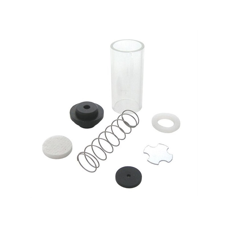

            thats the rebuild/upgrade kit in that photo - the whole pack is under $5
            that washer is 1.6mm thick, 14mm diameter and the hole is 1.9mm but remember it has to withstand a lot of heat

                  What made the "front holder seal" hole so big? It looks punched out. You have to be really careful putting the filter back in, otherwise the heater tube cuts the seal up. It's just rubber.
                  This looks like a chinese knockoff of a Hakko 809 gun, seal A1011. Would be good to compare sizes to see if that stuff can work. What is the ID of the glass?
                  The heater exit tube gets really HOT, almost solder temps. You could put a piece of silicone tubing over the heater tube to increase diameter, but then what.

                    Glass Tube has OD = 0.87" (22mm); ID 0.726" (18.44mm); length of 1.858" (47.2mm)
                    The OD of the rubber on the inside of the tube that holes the spring is 0.737" (18.72mm)

                      Thanks for the measurements. I checked my 809 gun (is 802 with upgrade) on 470 station and the A1011 it seems a bit different.
                      The heater exit tube is 2.50mm OD, seal inlet hole 2.8mm, OD at that end is 14.8mm. Seal OD to fit inside pipe 18.0mm, overall OD 21.8mm. The filter pipe has an o-ring and lip, it is not just a glass cylinder.

                          This is a very common failure of the flat rubber washer you are lucky if it last 200 hundred hours of use this issue is that it has to fit tight so you do not loose suction so each time you take the cylinder out to clean it it stretches the rubber hole in the middle of it the same thing happens to the rubber seal that holds the spring in place to collect the solder this one last longer but it tears as well in fact I need to order some myself because I am on the last one unless I find one that got misplaced somehow

                            if they can make them let me know, if these fail that often I'll get some as well and maybe we can get volume pricing
