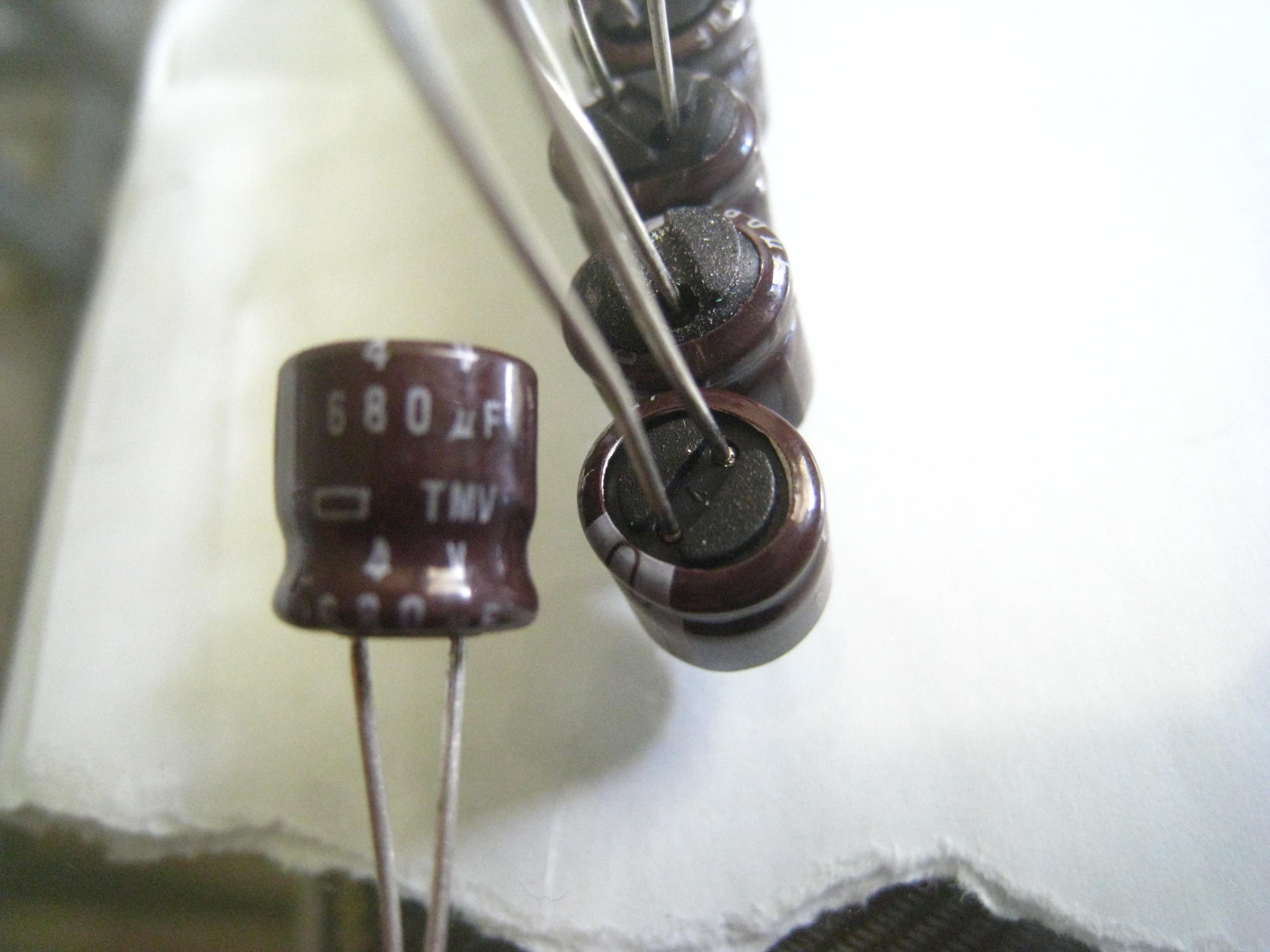

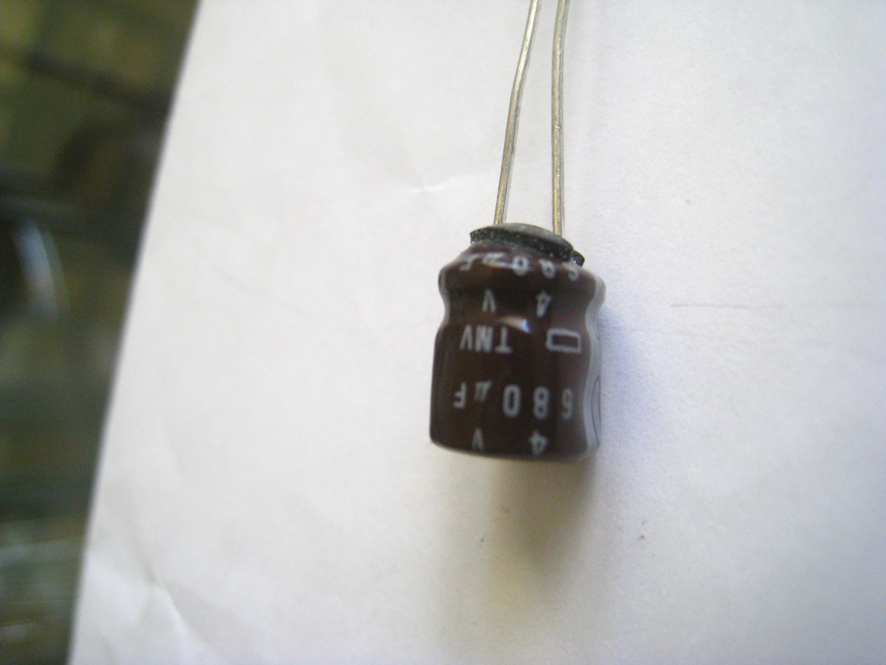

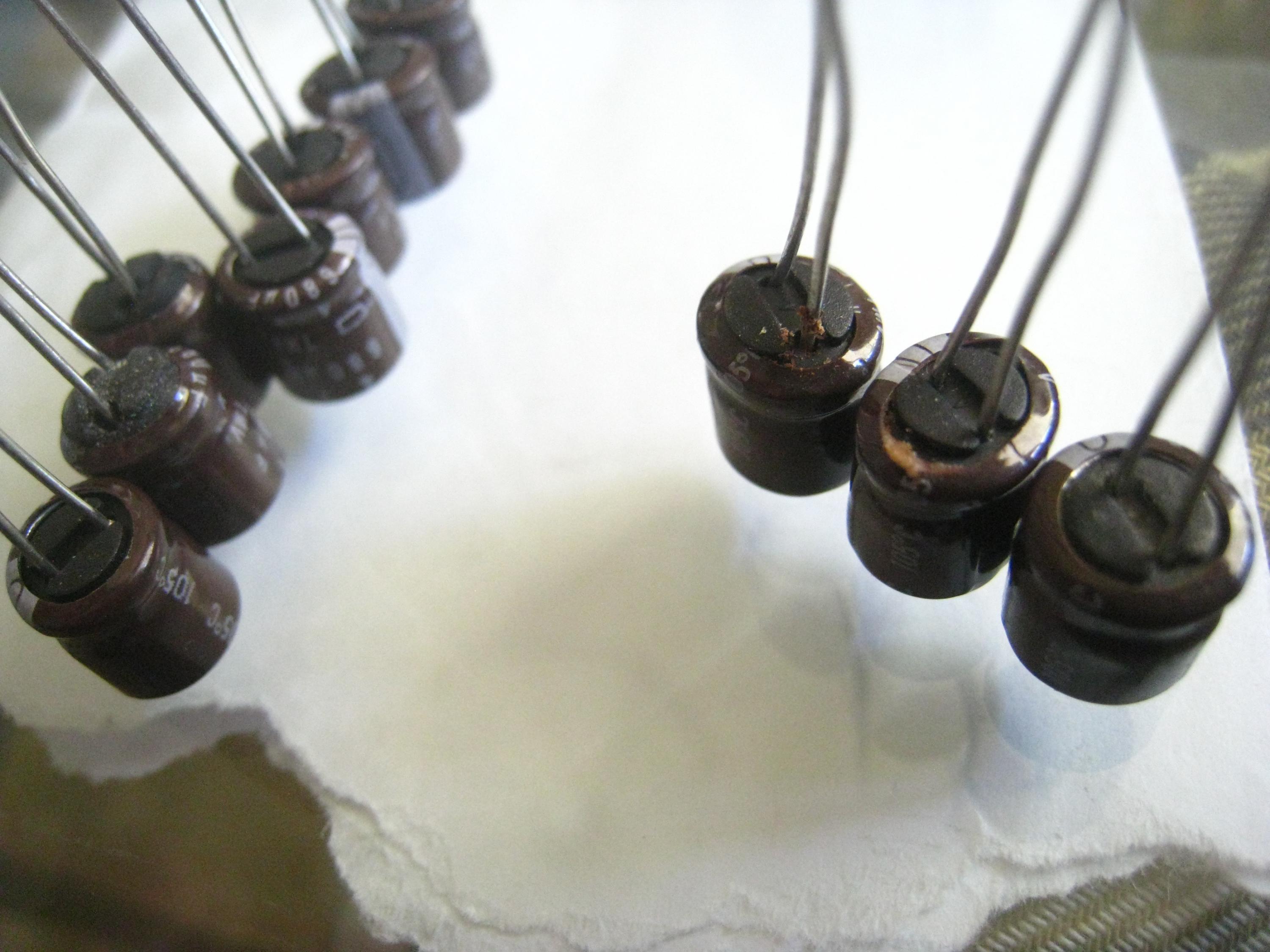

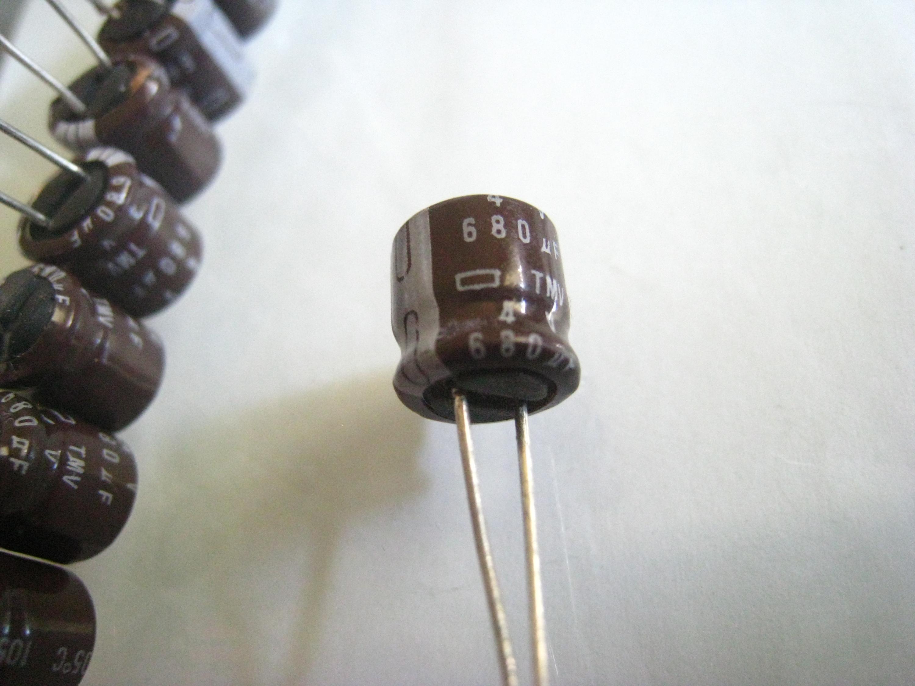

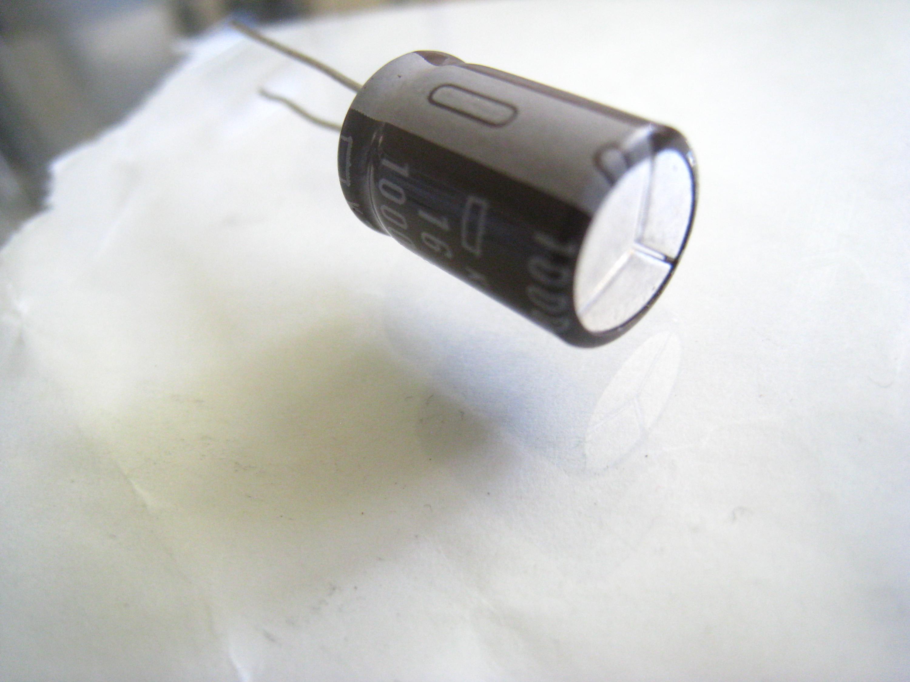

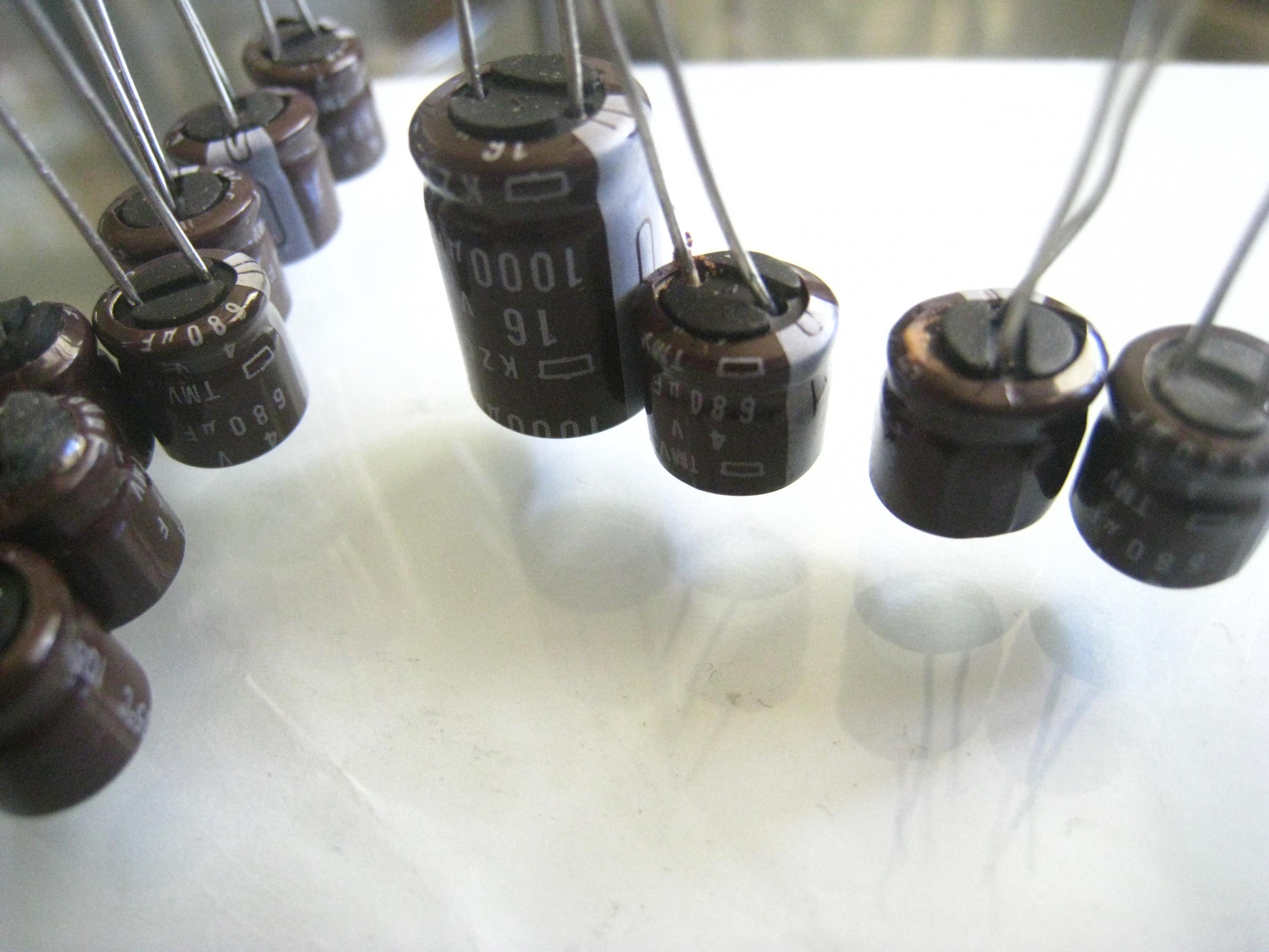

    Hey everyone..
    Was going through everything I had on hand took these out of storage.. wrapped in bubble wrap.. They could of been crushed but I'm not sure.. No vents on top.. Cans look like an oval almost..
    I also have a KZG Y vent going to garbage aswell..

    No, they're 4v rated in a small can size, so they don't have enough electrolyte inside that would cause enough pressure to blow up. Therefore, there's no need for vents on such small capacitors.

      Nope.
      Those are actually Nippon-chemi-con TMV series capacitors.
      Did you have them in an attic? Looks like they got some heat damage, including the bigger capacitors too! Some of the little ones have their bung (rubber seal on the bottom) pushed out, or they are leaking.

          My mistake and yes thinking about it they could of taken heat damage.. I got a bunch of rubies and sanyos which are ok.. They are all destined for the trash.. Yes my mistake Nippon Chemi-con..

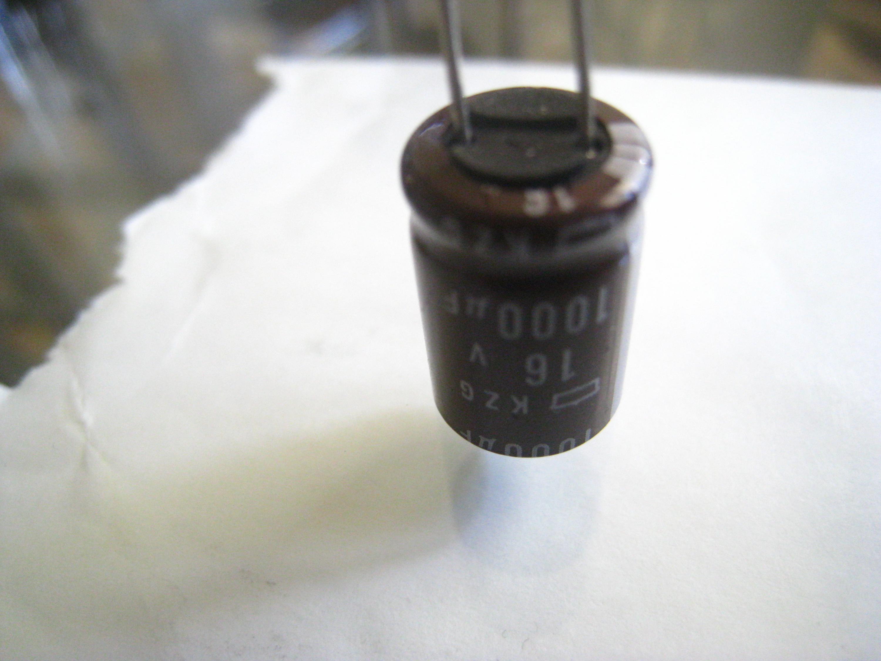

            TMV and KZG are bad series and fail with no use, as your TMVs have.
            I have a cap that is crushed like the second one from the right in picture 4, but it is still sealed and tests good. I bought it at Radio Shack and never noticed it was crushed until I got home and took it out of the bag. It's in some really cheap and crappy computer speakers now.

                Yes, those are junk. The two crushed ones are leaking, and I see two more in your pictures that are bulging from the bottom. Those same caps fail a lot on motherboards.

                  In all seriousness, KZG aren't good to have lingering on your motherboard. They aren't so stable. I have some mobos yet to get to with them, but yeah....

                          KZG/KZJ/KZV/TMV/TMZ/TMJ are indeed all true crap. They fail on their own because something is chemically (internally) wrong with their electrolyte. I find it interesting how Nichicon only really had two dud series for only a limited time and a single shift (HM/HN) but they addressed that problem relatively quickly. KZG and all its variants that Chemi-con produced lasted from 2003-2011, was it? There have been some random KZH failures in some 800W Delta power supplies documented in this forum as well...
                          Otherwise, there were Japanese capacitors from the 1980s-1990s that had insufficient seals (bungs) so they would eventually give away and leak... (even Panasonic had that problem) or the problem with unstable quaternary ammonium salts... but those capacitors were well out of production before this millennium. There have been some bad batches of Rubycon MBZ/MFC/MCZ spawned as well, but I wonder if those are just fakes... sometimes it's hard to tell...
                          To answer the OP more directly, however, TMVs aren't fake, they're just garbage.
