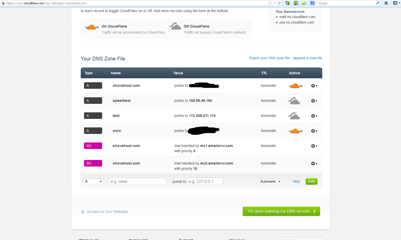

      Anyway, you will want to make an "A record" for the subdomain to go to the IP address of the VPS. So let's take a real example, using a VPS I use as a test box for making YouTube videos like this one....
      http://www.youtube.com/watch?v=CvIccZI1ELg
      Let's say the domain name is shovehost.com, but you want the VPS to be at test.shovehost.com. You would go to wherever your DNS is hosted (in this case you probably have it at your registrar), an alternative is to use a third party service like CloudFlare or Rage4
      https://www.cloudflare.com/
      http://www.rage4.com/
      Anyway so I have my VPS at 173.208.211.110 and since I want it at test.shovehost.com I would add an A record for test to my DNS zone file, pointing to the IP of the server. Some extra info: CNAMEs are like redirects, MX records are for email (in this case I host my email with Rackspace so I can't just use the email servers on my hosting).
      Don't get confused by any options at the DNS to make an AAAA record, you DO NOT WANT THAT as it is for IPv6 only which is NOT going to work for you.
      Then you would add your domain and subdomain to ISPConfig on your VPS. Then upload your website and have fun. But I hope that is helpful. I know Badcaps.net is on a server running ISPConfig, so I'm sure Topcat could answer any super specific ISPConfig questions because I'm more of a cPanel guy myself and it's been at least a year since I last used ISPConfig.
      Anyway, good luck on your project, and see the attached screenshot for an example of the DNS Zone File I've blacked out the IPs for my website because those need to be private.
