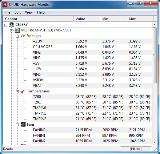

                                  Well the Seasonic 360W went fine into my big PC and works great creats no heat whatsoever even after 10 minutes of Furmark+Prime95
                                  Now the problem lies with my secondary PC. It's got a tiny 65W intel celeron g540 and 8gb of ram, with a single hard drive, a bunch of led fans, and a radeon hd 5770.
                                  but.. wtf?
                                  would my computer even turn on with 8v on the 12v rail?
                                  It's using a 500W Cooler Master Extreme that I'm aware is not so great but it's better than nothing!

                                    Well maybe, it would kill your harddrive quite fast though
                                    Measure it with a multimeter

                                      The readings are false, like Per says, grab a multimeter and measure it.
                                      The readings also say 5.7 for the 5v rail, which is unlikely, it's a dc-dc conversion from 12v so those 5v and 3.3v should be spot on.

                                        mariushm; well you never know with these Chinese PSU manufacturers
