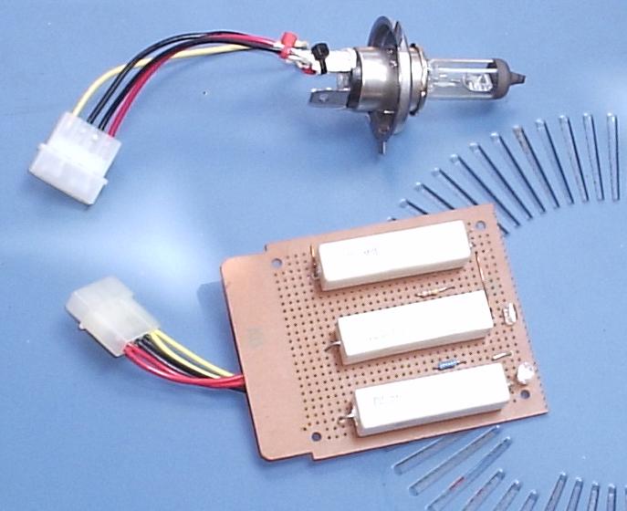

    My dummy load devices, version 1.0
    days are so short when you actually do something..
  • yanz
    • Nov 2004
    • 910
    Re: My dummy load devices, version 1.0
    +5V ===> 10ohm + 15 ohm
    +12V ==> 48ohm
    bulb ===> 12v 100W philips, but used on +5V (~42W).
      i bought out a store and got a bunch of those godawful blue ricer bulbs.
      they are doing dummy load duty now.at least they are good for something!
        Nice, you can see how melted the caps are with that. Good one.
          it was very bright and dangerous for my eyes found out that it was only 90W 12v rated.
          Code:
          P = V x I
          90W = 12v x I
          I = 90W/12v = 7.5A
          at 5V:
          P = V x I
           = 5v x 7.5A
           = 37.5W
          I built another dummy load. very usefull to test and measure the rails output of a psu without the case/PC.
