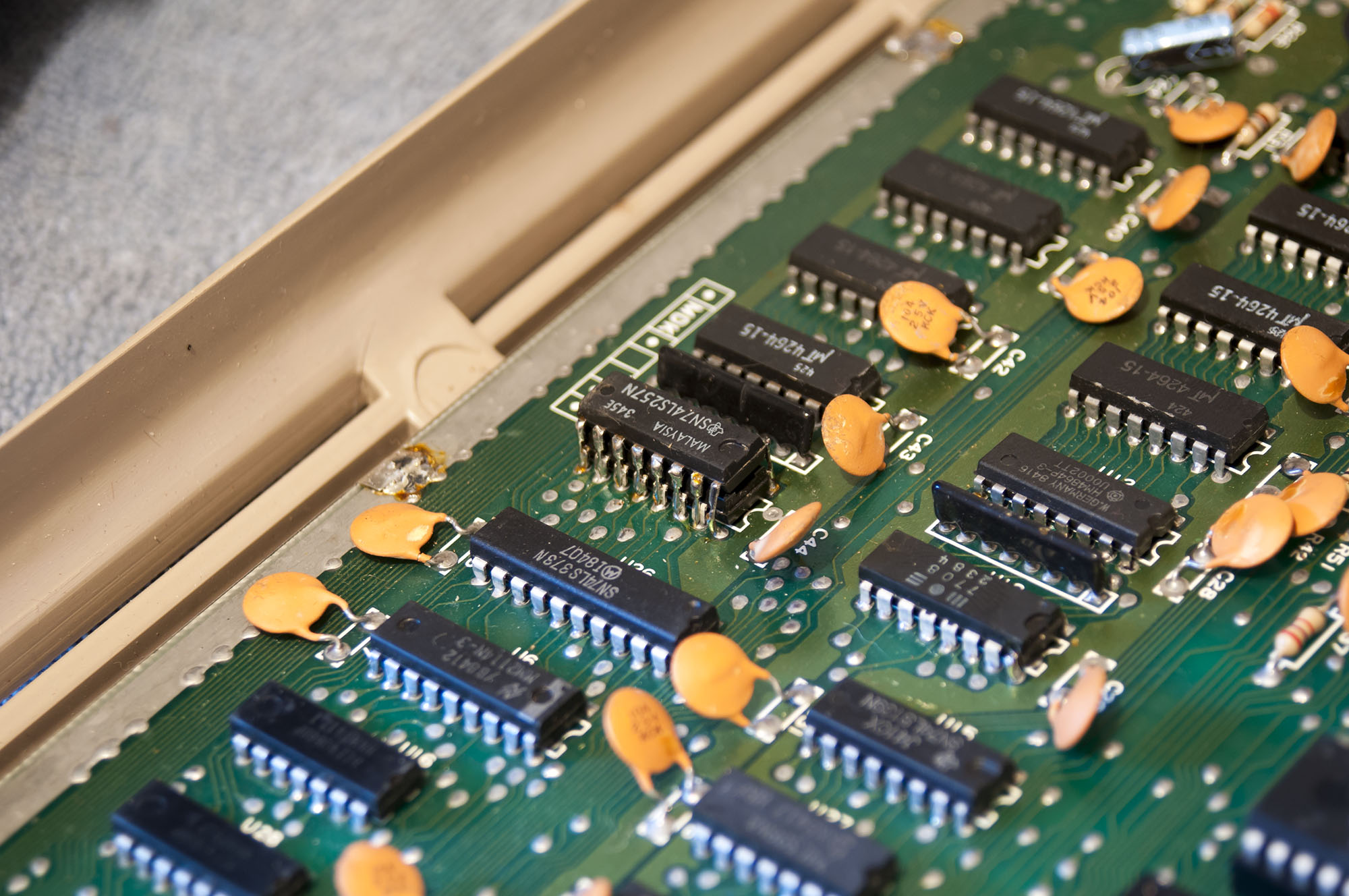

          Found this in a C64 with ram problems. Pin1 was cut, but still not that great of a fix.

            #265
            Re: The ghetto mod thread
            i hate that trick, it causes excess loading and wont help if an input or output is shorted on the old chip.

              #266
              I do as well. Makes it harder to diagnose when you find something like that and you don't know if that's the cause or something else is bad and they tried that as a fix that didn't work.
              Piggybacking is only something I do for diagnostic, like stack a 2nd 4164 on top of one of the existing ones to see if that chip's bad. Very useful trick for old computers, saves a lot of time from desoldering all the chips and soldering in sockets then swapping until something works.

                  #268
                  Now that's what you call chip pr0n
                  (I guess that's where the piggyback term originates from? )

                    #269
                    Probably they did it for a quick test and it worked, so they left it like that to save time.
                    Of course if I was now trying to troubleshoot it, I'd remove both chips and replace with a socket.

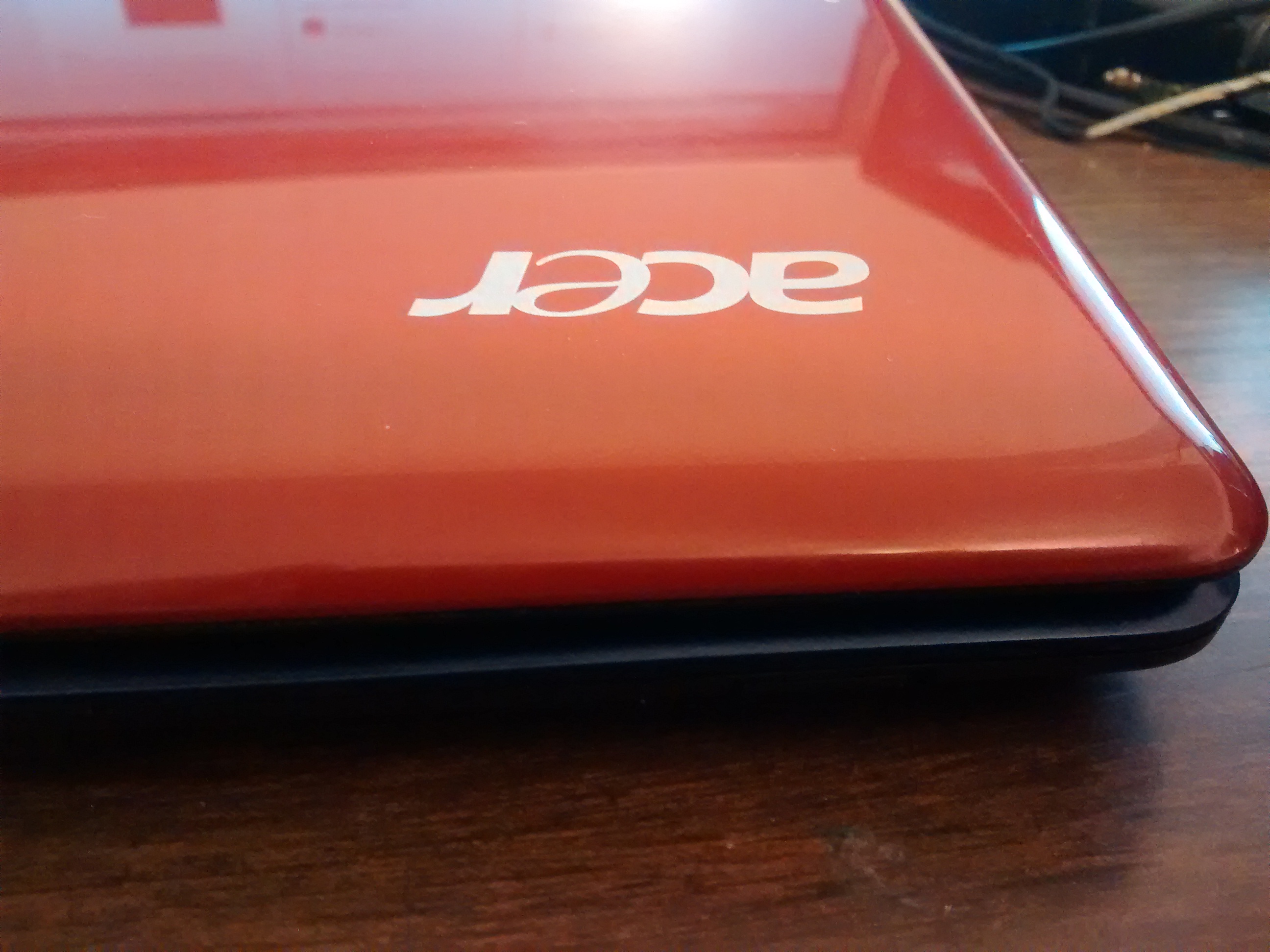

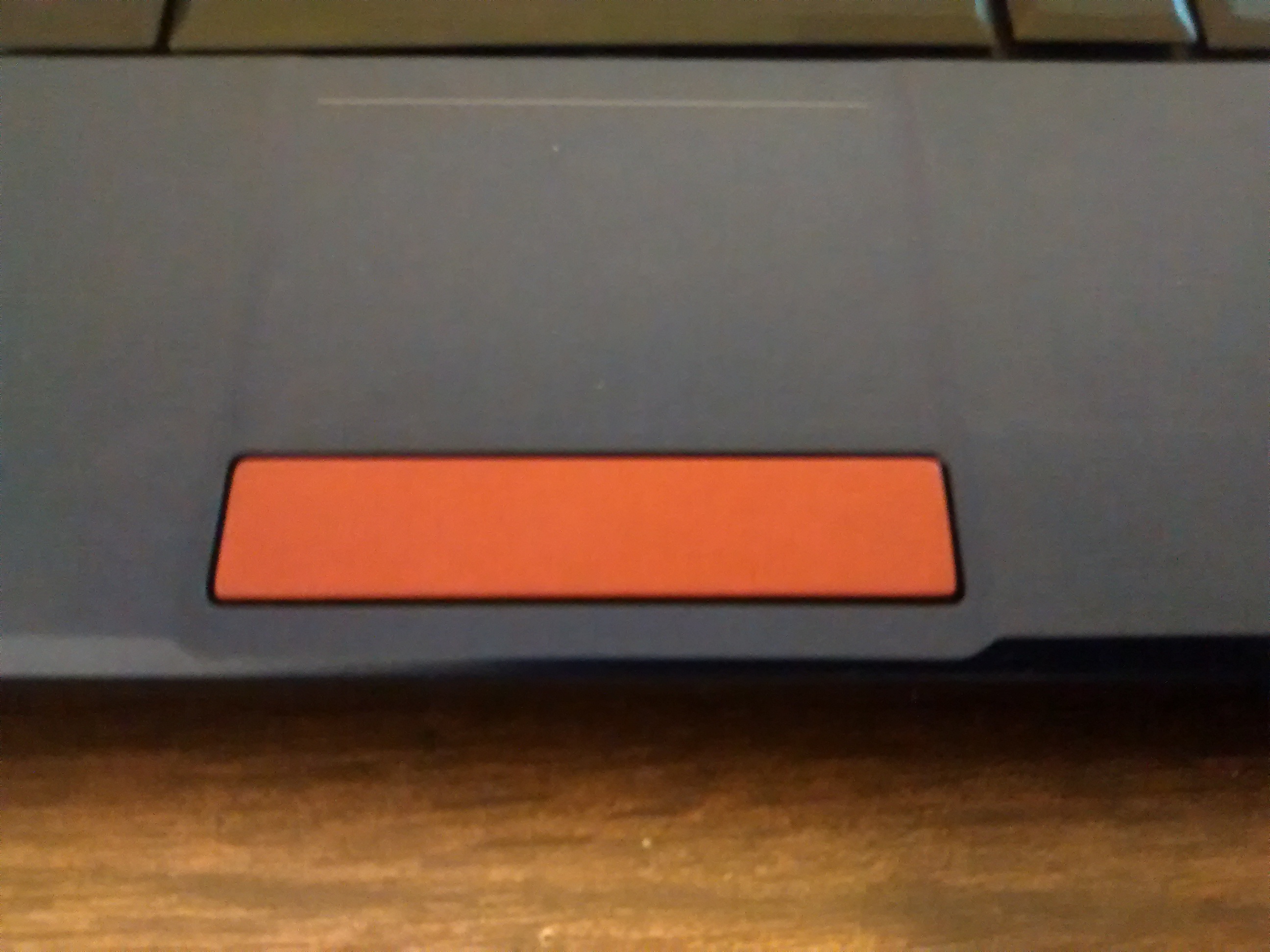

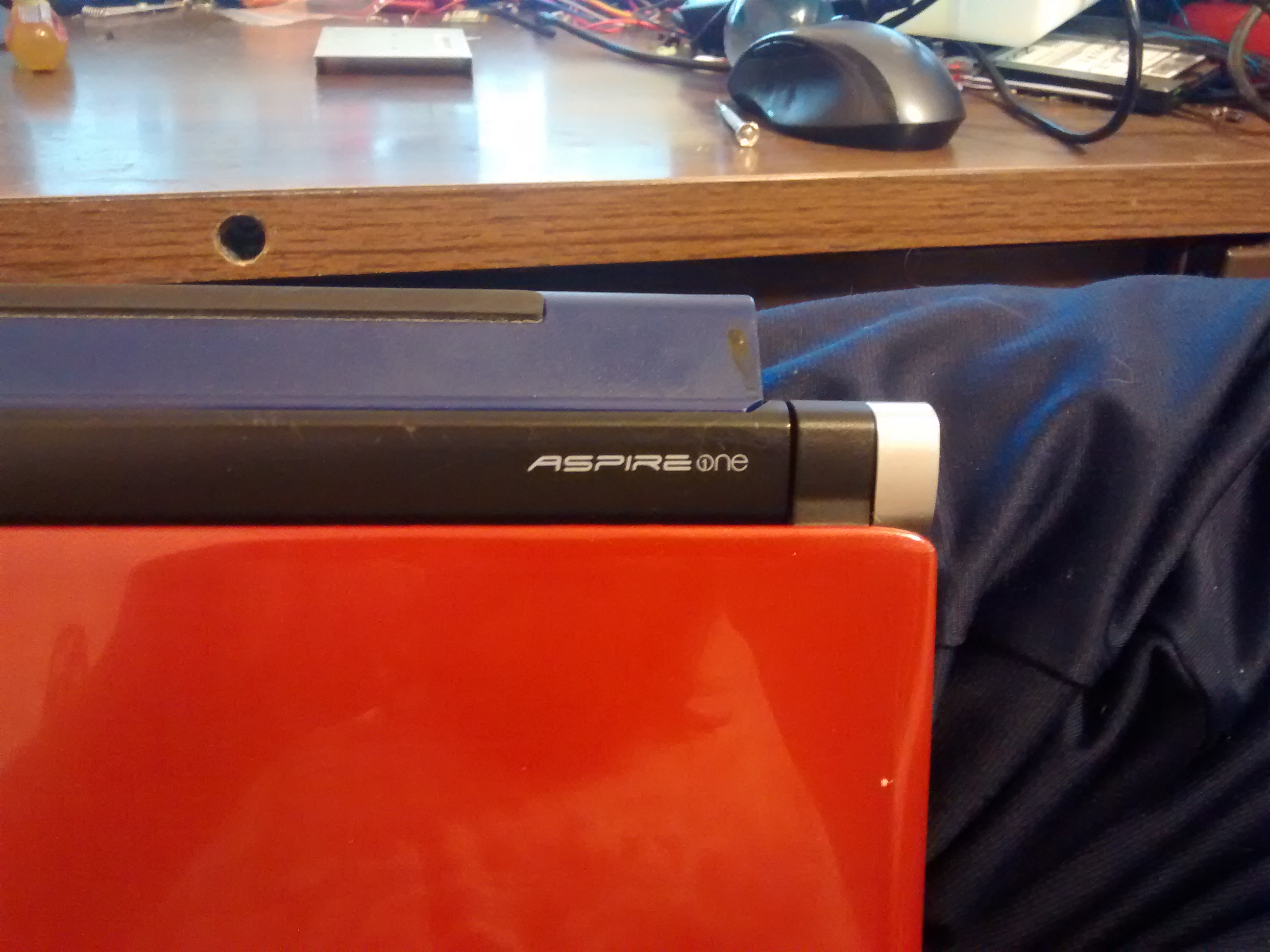

                      I had two dead acer aspire netbooks. I made one with the good parts. Blue one had a good everything but display and SDcard slot. The red one had a bad motherboard, no ram, no HDD. I put the red display on the blue unit and put the SDcard slot in it too. The touchpad buttons on the blue one had gouge in it, so I put the red one in its place. It's complete with a bodged in 64gb SSD and a crap looking (internally good. Protected well. LG cells!) Battery. It also has a RTL8188 N wireless in place of the atheros G wireless.

                      • dragos2009
                        • Mar 2013
                        • 110
                        • Romania
                        #271
                        by the way i really like the look of that acer goontron looks really nice like a custom job
                        • goontron
                          5000!
                          • Dec 2011
                          • 4108
                          • US
                          #272
                          One thing i didn't notice was the display hinge end pieces are one blue and one red.

                            #273
                            Now I'm not an expert at C64 hardware as I've never owned one, but it also could be possible it wasn't an aftermarket fix, but rather a design fix. I'd imagine if it was an aftermarket fix, pin 15 needs to be cut. But as a design fix, possibly the output of the LS257 simply didn't have enough drive strength and the quick fix was to use two (assuming the inputs aren't loaded down too much.)
                            Design fault, yes, alas, if it works, it works. I'd be worried if just pin 1 was cut as a repair... pin 15 must be cut as a repair...

                              #274
                              From the photo it looks like Pin 16 (Vcc) was cut on the old chip. Without power I don't see how you'd get extra drive current though, so I doubt that's why the new chip is there.
                              Both Pin 1 and Pin 15 are inputs. I don't see how cutting either of those would make sense. Pin 15 is for disabling the outputs, but only when pulled high. Unless you hoped it would float high (probably a bad idea).
                              But why would you set the outputs disabled on a faulty chip? Who says it would disable them anyway?

                                • 31283
                                #275
                                commodore dont do that, all pcb revisions are error free.
                                the only change to the 64 was to add some diodes to the serial port, and that resulted in a pcb change.

                                  #276
                                  hmm... hard to tell if pin 16 was cut... that may do more for disabling the old chip, but it would still leak. Not sure why they simply remove the old chip. If they were cutting pins, might well just cut all of them to stubs, take off the body of the old chip, and solder the new chip to the stubs?

                                        #279
                                        I've seen that on a few boards as well back in the 80s. Not limited to any particular brand as I recall, it was just done and if it worked then it was left alone. Shitty practice but it happened.

                                          #280
                                          I guess once you cut off the plastic of a soldered DIP, it should be fairly easy to remove the remaining pins one by one especially if it becomes loose and flops around... Still don't get why it was stacked other than for drive strength!
