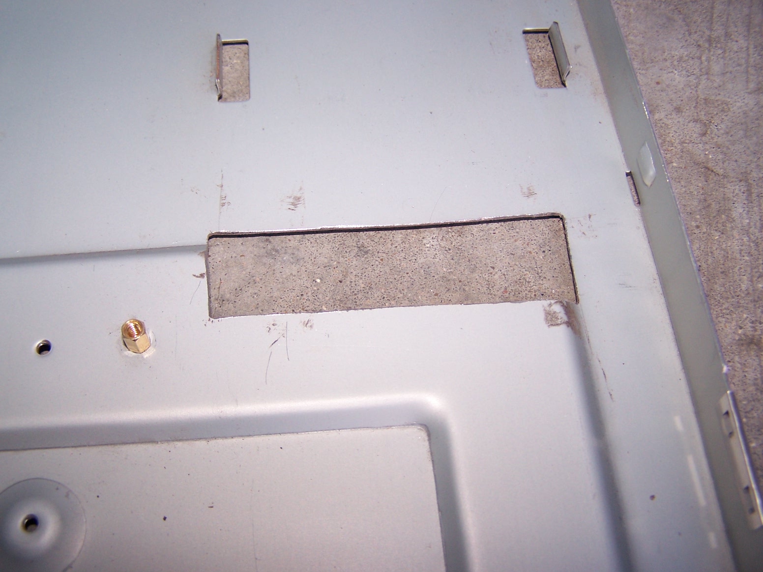

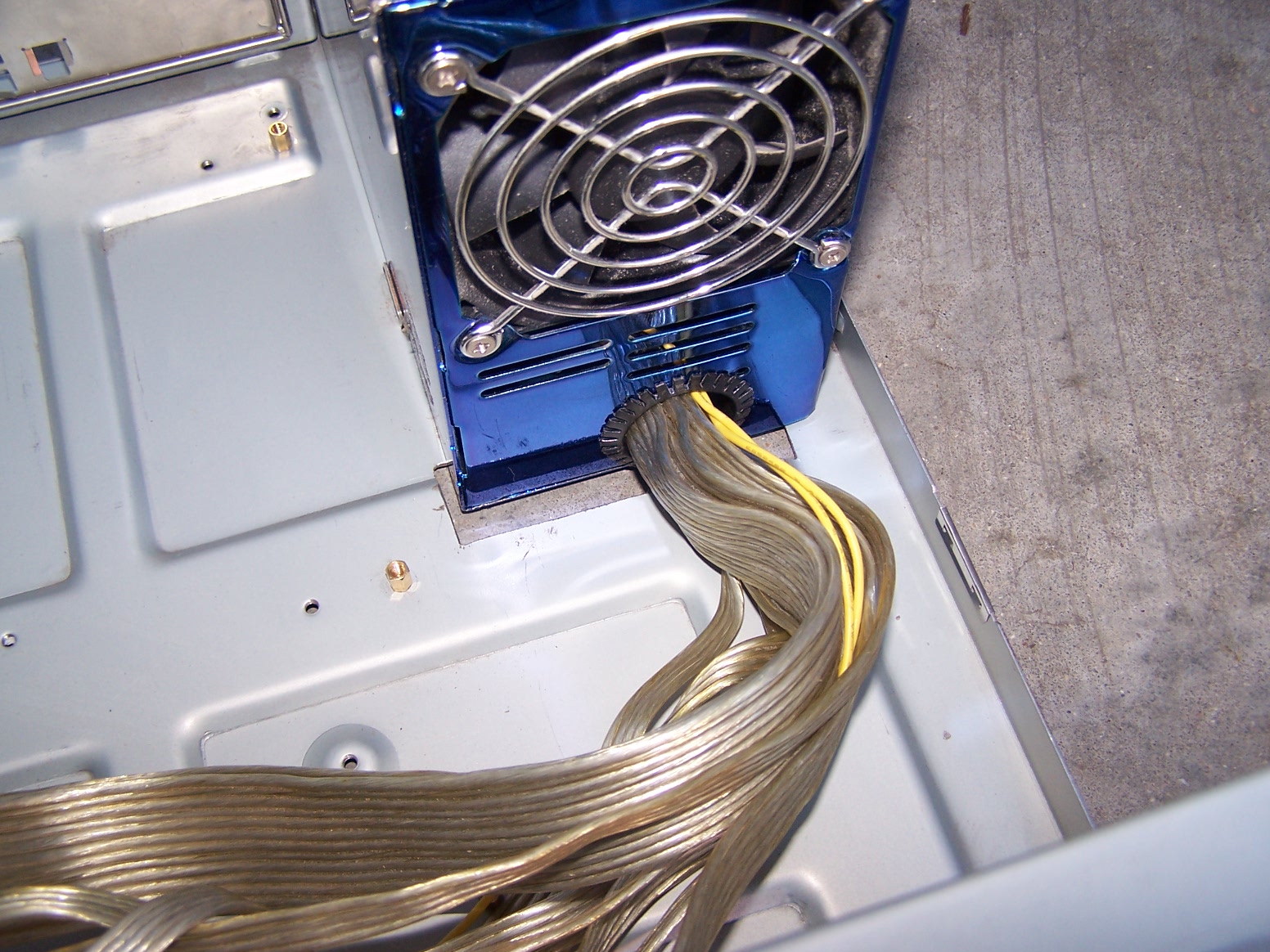

    In order to make the PSU fit, I had to once again bust out the dremel:
    I had to cut out a little more than one would think... it needed some wiggle room to aid installation.

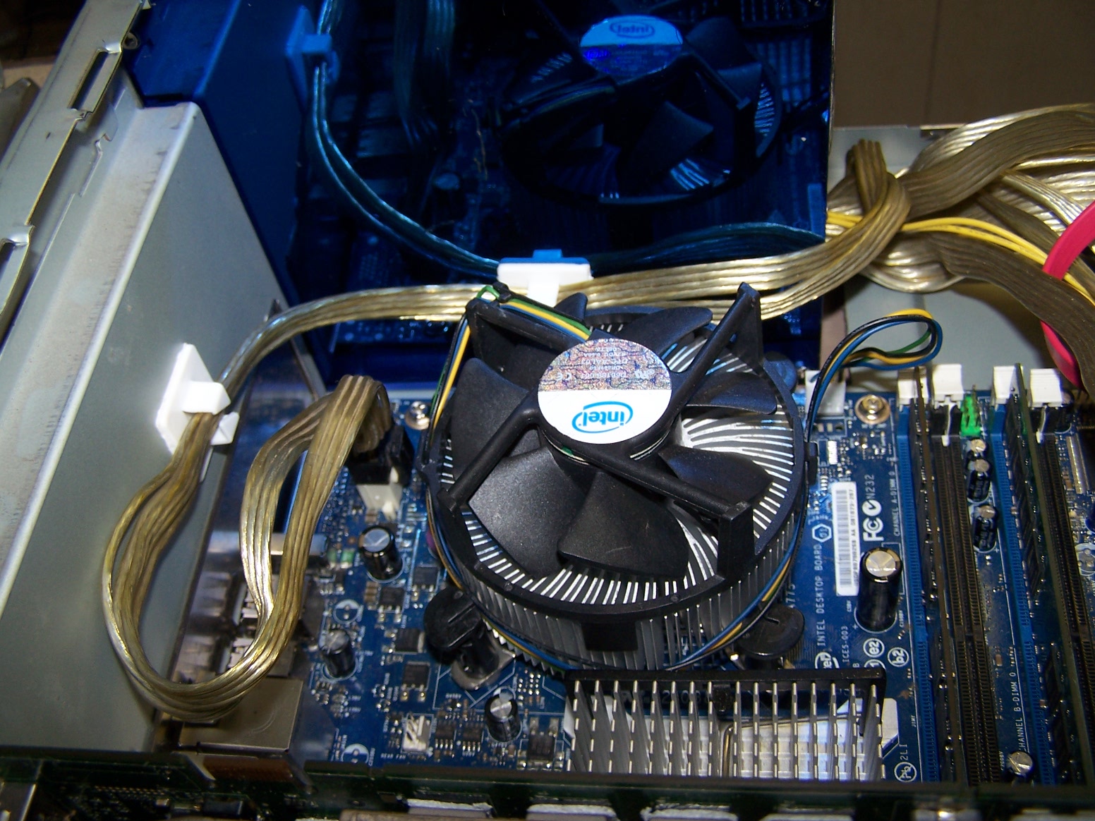

    The cable routing around the CPU:

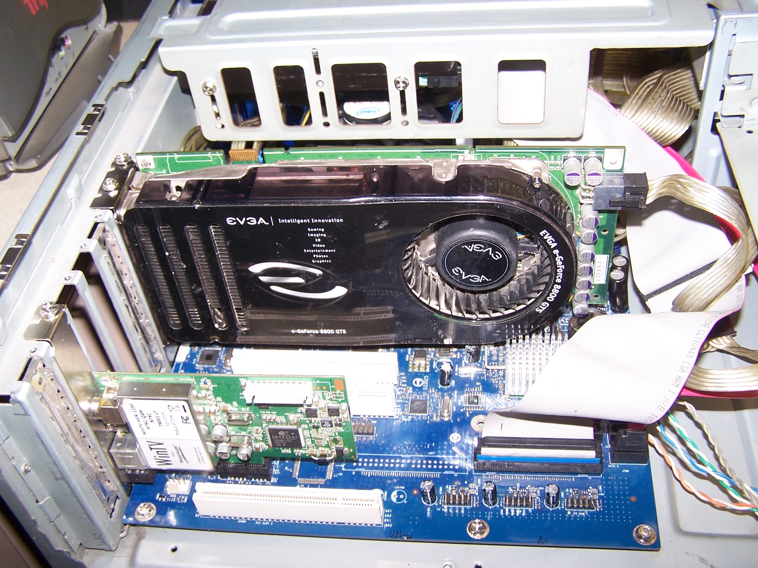

    The two PCI-E cards and the HDD carrier:
    I tested it earlier in the week... so far it runs well (booted a live USB stick without issues).

    Looks good, but those stock coolers are horrible options for HTPCs. while they don't get overly loud, there is a constant buzz which constantly changes pitch according to CPU load. It annoyed me anough to convince me to get a CM TX3.
    • ratdude747
      Black Sheep
      • Nov 2008
      • 17136
      Re: Ratdude's HTPC
      The issue is clearance... I have a spare TX3 and a Artic 64 for 775 but both appear to be too tall.
      I didn't notice any annoying buzz... then again, with the HVAC system going full blast the basement is a poor place to judge noise.

        I just tested it... the cooler has no annoying noises. The PSU was louder (it could use a fan swap).

          Cool (pun intended).
          Personally, I've heard an annoying buzz on every s775 and newer stock cooler I've had, regardless of who made the fan (Delta, Nidec, Foxconn or Fujikura). Sometimes it doesn't happen when the fan is running at idle speed, but as soon as the CPU had any load, it would happen.
            I haven't taken past idle though... I'll see once I have it more together; right now all that is on the HDD is a half-corrupted XP install that was orginally on the HDD when I got it at a thrift store. The one time I was rocking gnome shell and the nvidia driver (mageia x64 live USB I randomly had), I didn't recall any odd or excessive noises.

              In my experience the Intel stock coolers on Socket 775 and newer are very good and quiet.

                My HTPC has a gigabyte board and they have this neat little throttling program for the cpu fan

                  Mine is PWM, throttled by the temp.

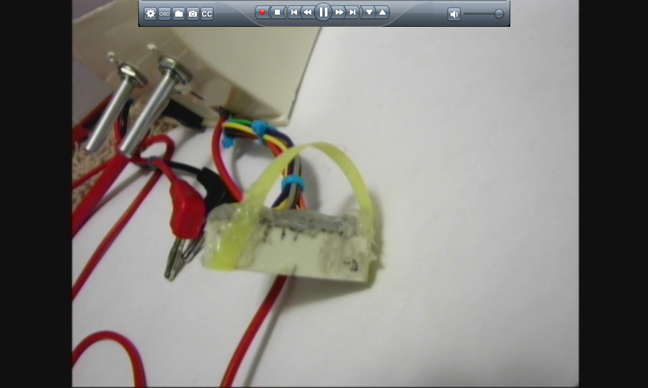

                    2. I did some tests using a Composite source and the S-VHS VCR... The "deinterlacing issues" I had in the past are not present when I am using the S-VHS unit as my converter. I'll upload a few screenshots later.

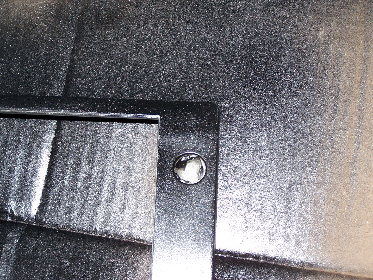

                    4. I painted the case parts. Pics to come in my next post.

                      First, a screenshot of the tuner w/o deinterlace errors:
                      (A digital camera hooked via the composite cable)

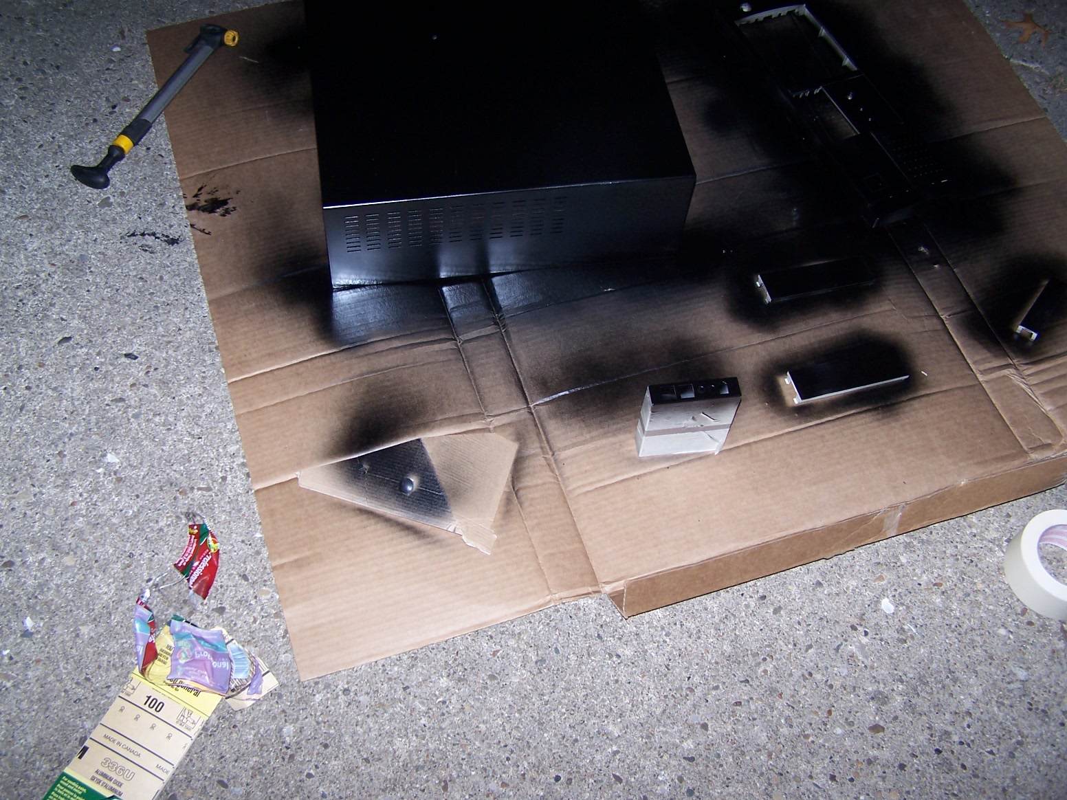

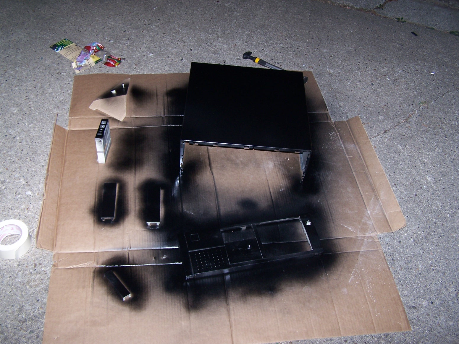

                      Time to watch paint dry:
                      What I did was:
                      1. Clean every surface to be painted with generic Windex.
                      2. Lightly sand the surfaces with some 100 grit sandpaper. In hindsight I should have used 150 or finer but it nevertheless worked. This removes any surface wax and increases the surface area that the paint can stick to.
                      3. Spray the parts with two lighter coats. I used some Rustolem Painter's touch Black semigloss for this.
                      For the buttons I had to get creative:
                      I also removed the two clear pieces for the LEDs, which I super-glued back in after the paint dried.
                      Also, I had to make sure the button holes were plugged:

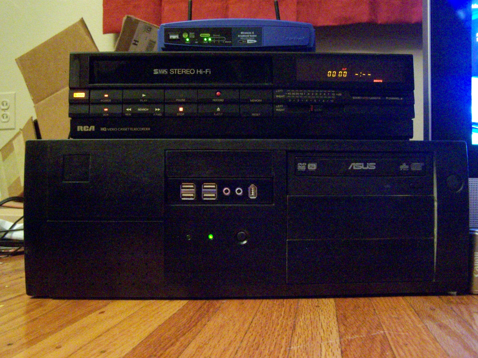

                      The finished product:
                      To control it I currently am using a USB keyboard with a Hub, connected to a 16' repeater cable. I eventually would like to find a decent wireless USB set, since my only set is a total POS (it's MS too.. very disappointed)
                      I eventually will install a card reader in the bay above the USB/audio/1394 ports... I was going to install a black sony one like i have in my main rig but Fry's was out when I went to buy it. One idea I had was to find a silver 3.5" card reader with a USB port and swap that for the one in my main rig that doesn't quite match (it only had a black and a beige faceplate).
                      Other then the card reader, all it needs is better HDD, a 80mm case fan, and a pair of fresh 80mm fans for the PSU (the one foxconn fan in the PSU is way too loud).
