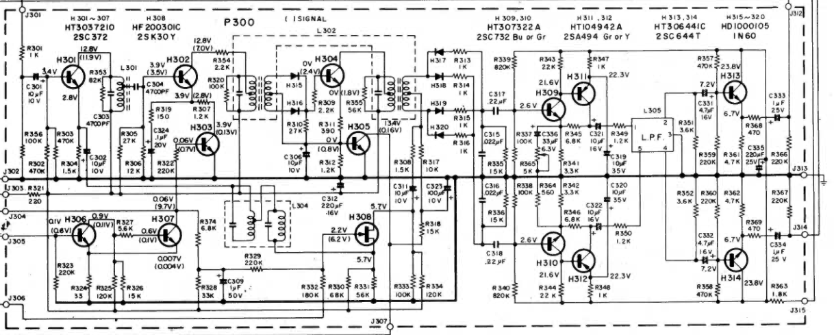

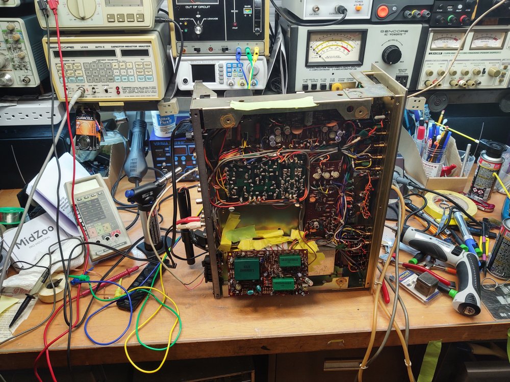

    My Marantz 120 Tuner stopped receiving Stereo signals. It works fine other then Stereo. I have a fully loaded shop here with all test equipment except and RF signal Generator.
    I get great reception on FM so I have used that signal troubleshoot. I have been all over the MPX board and replaced all caps. Also the entire power supply caps were replaced.
    All Voltages on the MPX board are good... all Transistors Good...All Diodes Good and other components.
    The stereo lamp is good as I powered it up and it lights. The signal flow to that lamp is unbelievably complicated.
    I am at a loss to try and figure out what has happened? Last time I powered it up in my system with a Model 500 and 250 and 3300 all was good. I haven't powered up the tuner in about a year.
    Been all over YT and nothing. There was one guy working on a 120B which had the same problem but that circuit is different. And he only fixed it by removing one transistor and replacing it with a resistor. This left the unit without a muting control.
    Anyway If you want I can upload a PDF of the Service manual. I'm missing something. Any help greatly appreciated.

    Also forgot to add that when I first powered it up in the rack ...the face plate lit up and the scope was dim and there was no audio. This was because a 47@ 50V cap blew up and killed the power supply. Back in the day electrolytic caps had the blow out protection on the bottom using a soft potting compound. Todays use the section cut top where they vent.
    The one on my board was cocked over to one side as the bottom had blown out. I just rechecked the PS and all seems ok.

        I would check DC voltages in the MPX section- assuming it thinks it has enough signal strength to go to stereo mode and muting switch H303 is on.
        I think voltages in (brackets) are stereo. It doesn't play FM mono, I can only find muting but no stereo/mono switch.
        If it's in stereo mode H303 on, then look for 19kHz pilot signal at H302, H303 see if it is there.
        I find it's usually the tuner thinks signal strength is too low which is why no stereo. But this tuner has a built in scope, that's so coooool

          Which cap blew? this might help with the diagnosis, Have you cleaned the mono, AM and FM switches? do you have 13.5v on H001/H003
          What voltage do you have on transistor H305, Base and Collector and does it change when the FM signal is tuned
          Voltage in ( ) are with signal

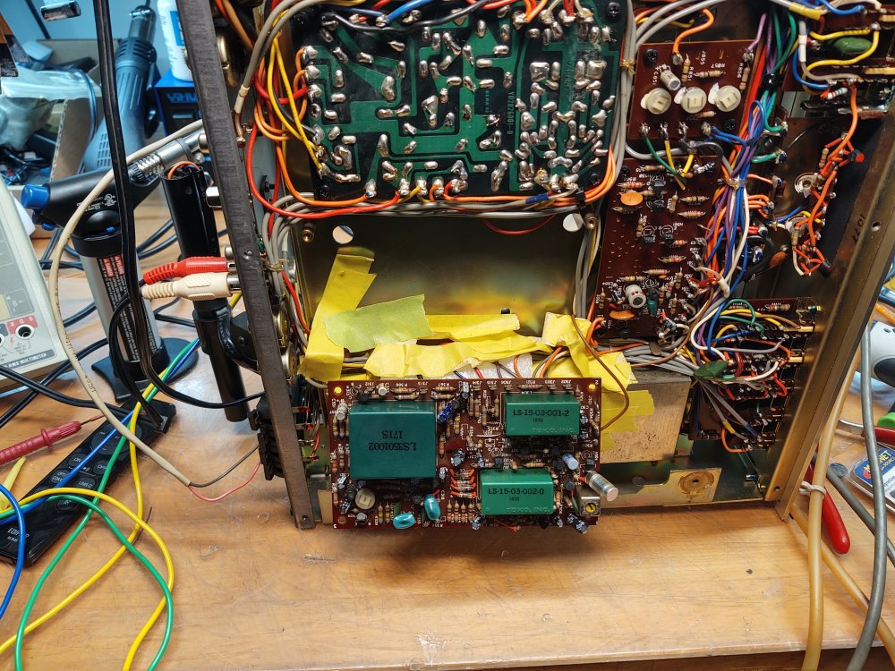

                  OK let me run this buy you gentleman... Look at C405 in the power supply 330 UF @ 50V.
                  The top side of the circuit board is marked C405 with a Plus and - symbol on the board indicating how to replace the cap for correct polarity Even the Pictorial View shows the same.
                  Here's the rub.... When I replaced that cap with the correct polarity placement.... It exploded!!!.. This is when I first was replacing all the caps. Ok??? I reversed the placement polarity and it worked fine with a New cap. Then I checked again and thought maybe they marked the cap wrong with the covering...But the long lead was the pos and it was correct.
                  That + rail has a Aproxx -30 Volts on it. Did Marantz Mark the board wrong and the Skids.
                  Or did I make some kind of stupid mistake and or analyze it wrong?

                        Ok RJ...Here's the skinny.
                        H001 is right on +- a few 10ths.... My unit has the 2SD315 which is called H001....... H003 Is a BZ140 which is not there or on the unit
                        Now Transistor H305 Base and collector are as follows..
                        Collector is 12.5 Volts DC ..... Base is "0" Volts. those are not the ( ) Volts..Stereo..?? The ( ) Volts Are (Collector 0.16 v) Base (0.8V)
                        Now Redwire said to Check H303...
                        Collector read is 3.40 () shows (0.13 V)
                        Base is Read .051 () Shows (0.7)
                        So something has turned off the stereo No ?/Yes?

                              That measurement was on a station or not? H303 is OFF which means it's in mono (muting) - power is shut off to the MPX section at H302.
                              If it was on a station at that time, then work backwards at J305/H306-base which needs to be on at 0.7V (I think) and if not then it's a problem with the muting thresholds which is a bit complicated on the P550 board.
                              Don't just blindly swap out transistors because they affect the alignment and calibration, and nobody wants to redo that, it can make it worse. I prefer to track it down to the problem even though that takes more time and patience.
                              Exploding C405 is the -45V rail, check H003/C001 100uF 25V are OK. I don't know what that little section does. Check H406 36V regulator output is OK as well.
                              Just looking for after-effects due to C405 poppen corken.

                                  Ok RedWire...update. Finally found H003 and C001 100@25 Volts. They were hidden on a terminal strip nowhere near the PS Board. The H003 is good .. both the 1.5K Ohm resistors are good and the 150 Ohm is good. The Cap showed Leak on the Sencore LC 102.
                                  So I replaced the cap with 35 Volt in stead of 25 Volt. Still had the -45 skid reading which is actully -43 Volts taking into the age and spec given at the time. Who knows how accurate it was.
                                    Hey Redwire,
                                    Here's an up date.. H303 Base. .026 V Emitter..011V Collector... .853 V
                                    J305 Which feeds the base of H306 is .026 Volts. Which lead me back to P550. I checked all components on that board and they all checked ok. Replaced the two Caps 10UF @16 with 25 Volt-ers. There should be .............. 0.1 Volts No stereo and (0.6)Volts stereo @ H306
                                    I have an audio signal on the scope at certain points and places on the transistors.
                                    Also... Where is a good place on this circuit to pick up 19 Kkz and 38 Khz?
                                    sigpichttps://www.badcaps.net/forum/image....ine=1697924519
                                    • redwire
                                      • Dec 2010
                                      • 3912
                                      Re: Marantz Model 120 Tuner Craziness I am Stumped!
                                      I need a coffee before diving into this lol.
                                      Your H303 is off (no base drive=mono), although the collector voltage should be higher than 0.853V, schematic says 3.9V when H303 is off. C324 might be leaky or H302 open E-B.
                                      How it works.. H306 ON (+ve voltage at J305, signal strength is good), turns OFF H307, which turns ON H303 to enable the MPX amp H302 = FM Stereo decode.
                                      Reversed: H306 OFF (no voltage at J305), turns ON H307, which turns OFF H303 to disable the MPX amp H302 = FM mono.
                                      So I'm not seeing the FM Stereo enable to the MPX. Then we'd go back to the P550 board.
                                      I would try tuning off and on a station, while looking at signal strength voltage at H559-C, I think that is what is going on there.
                                      Does H305/J307 turn on the FM Stereo lamps (two are in series)?
                                      You would look for 19kHz at H302-C, 38kHz at H304-C but only if the MPX is enabled in the first place. If will be dead with no Stereo mode on at J305.
                                      • Mark R
                                        • Oct 2023
                                        • 71
                                        You need a cup of Coffee????? !!! ..L.O.L.
                                        I need some JD!!!!!!! This is like "Who's On First"
                                        Getting ready to check out your above task's... The tools are closing in on me...I'm running out of room on the bench..LMAO. It's a good thing that the MPX board is like the trunk of your car and works in reverse. I must have folded it up and down a 100 times.
                                        In fact ... I boke some of the lower underboard wiring lose from there terminals an lost FM. But I'm back in the game again, ready for another round. I swear ..I'll never work on another Tuner again...L.O.L.
                                        Now if you'll excuse me...I have to make some room on the bench...The tools are getting ticked off at me and closing in.
                                        I'll let you know what I find.
