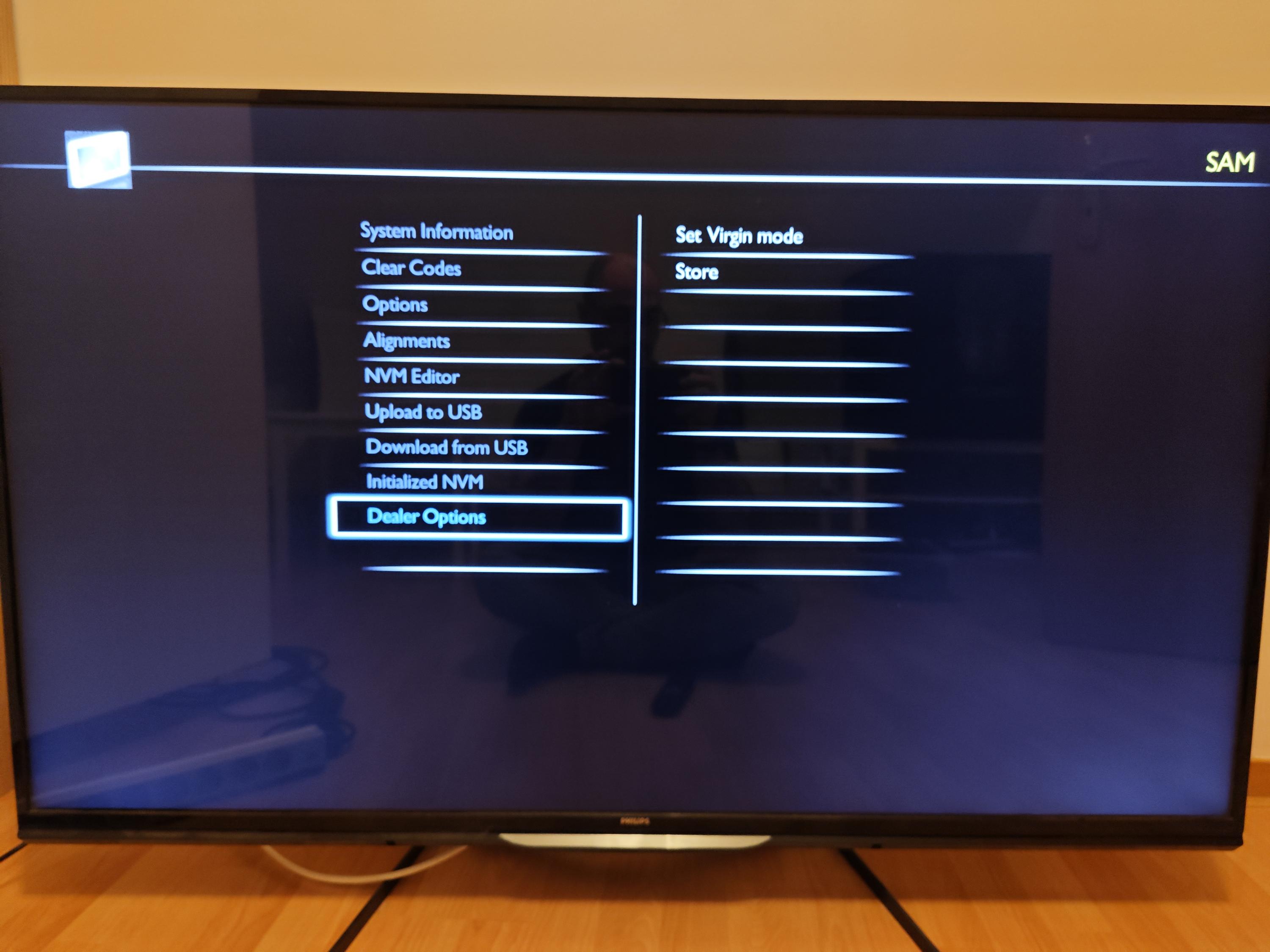

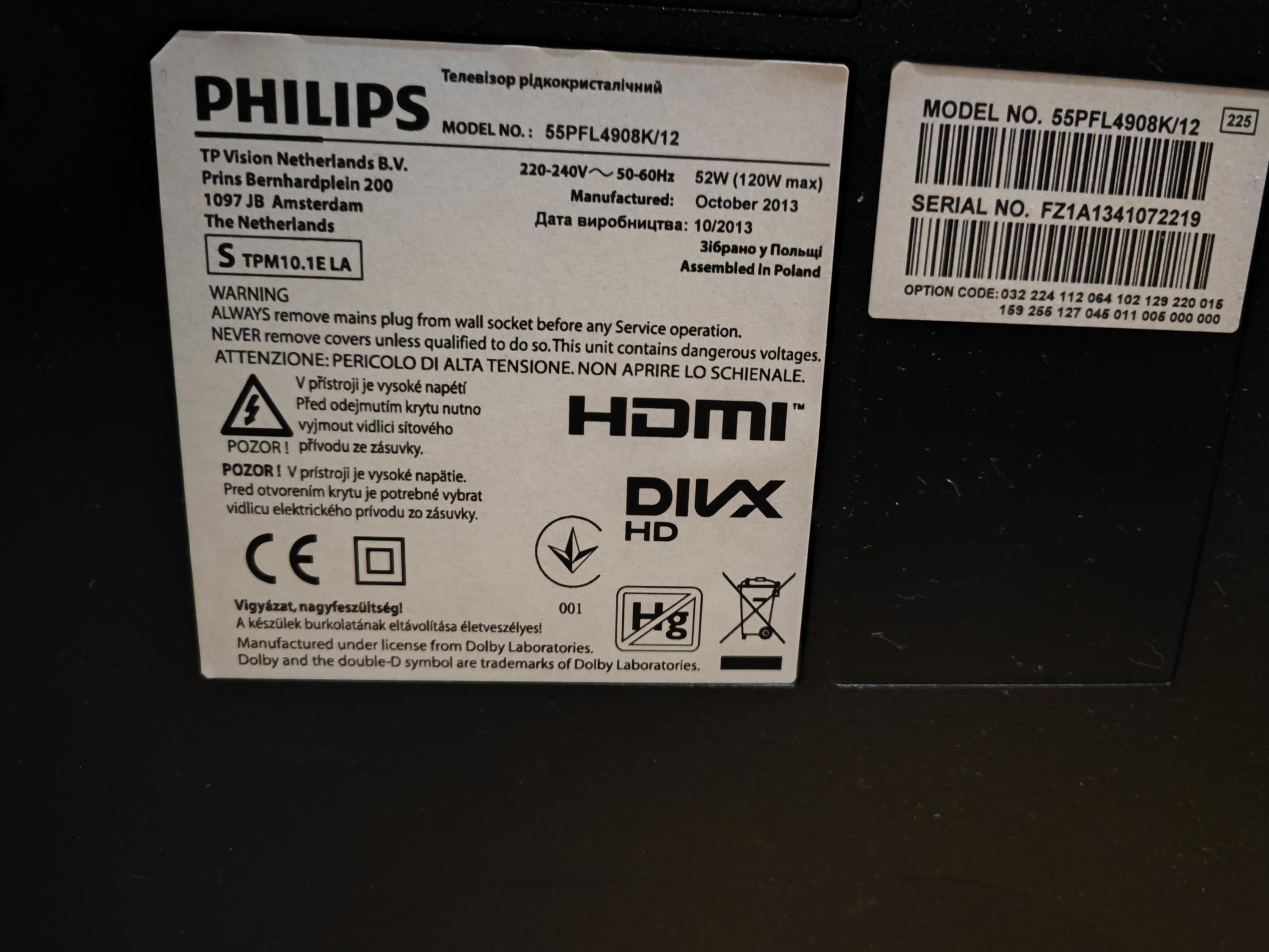

      There is no "reset" option in the service menu, but I was able to turn "virgin mode" on, which lead to a new setup dialogue at the start. But still only option to scan DVB-T or C.
      I also checked all the option codes and they are identical to what is printed on the lable on the back

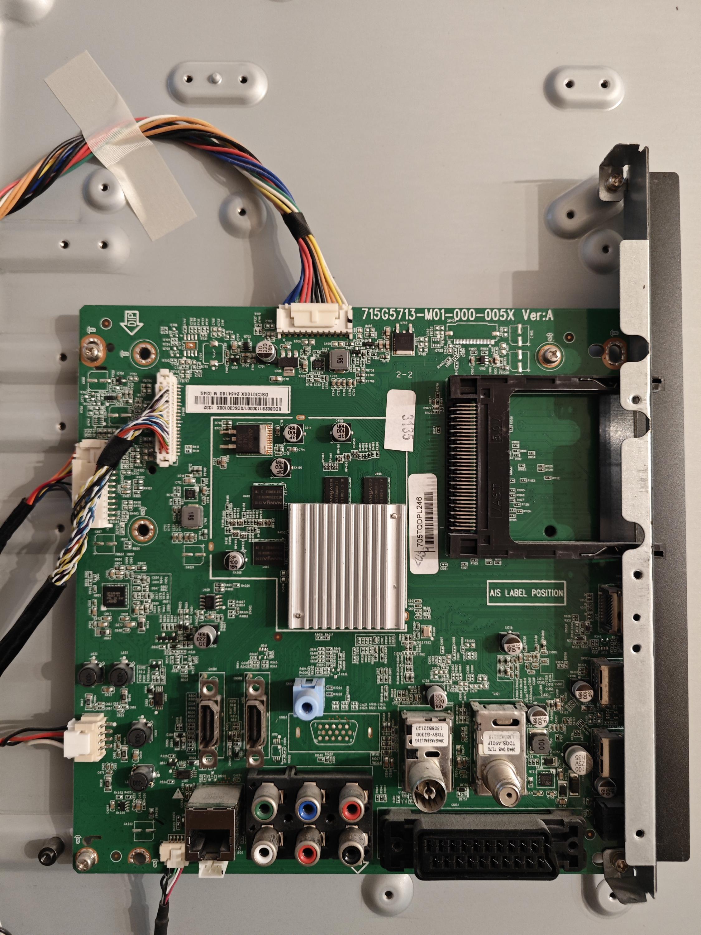

            could you upload photo of the main boards ?

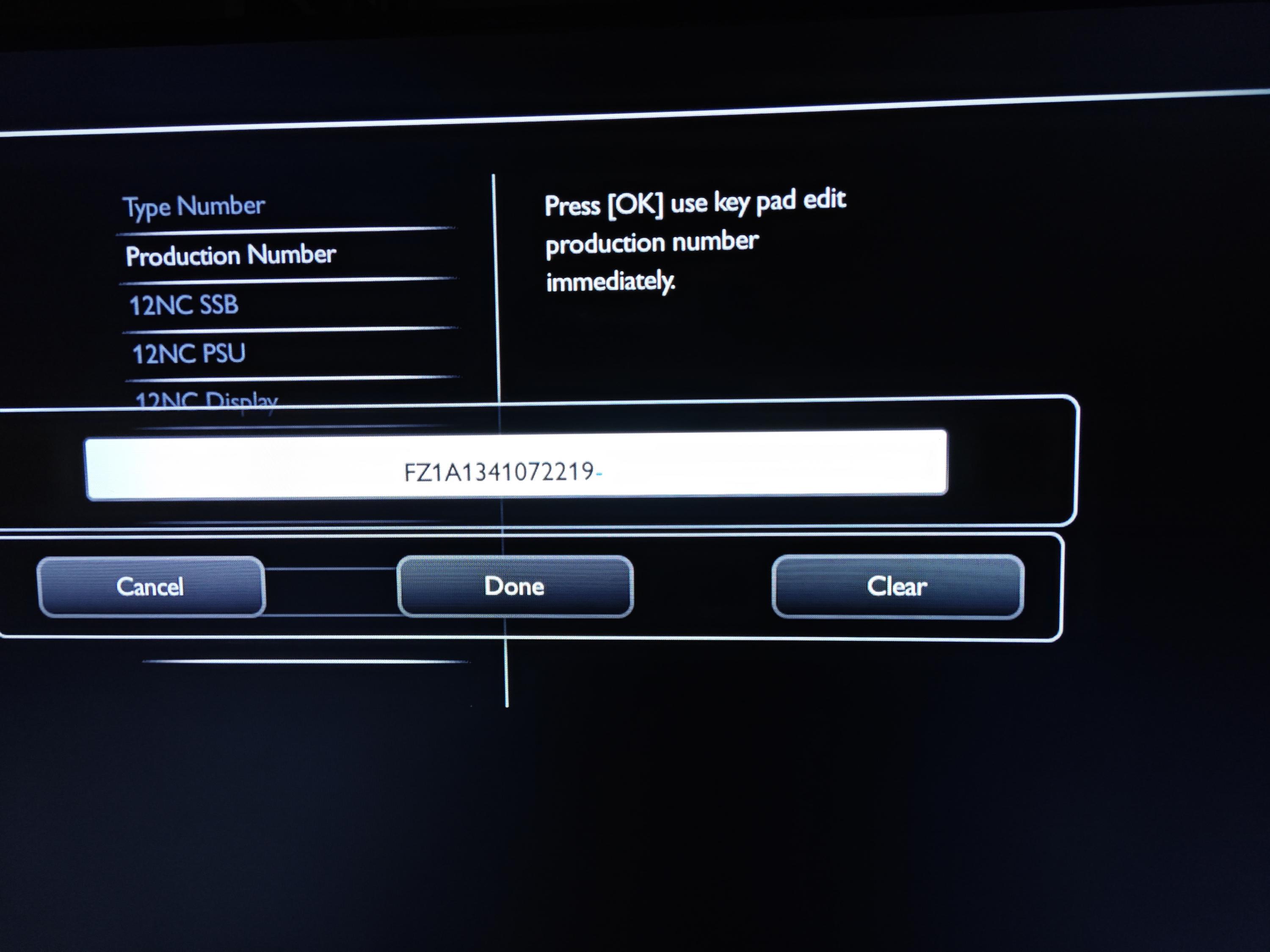

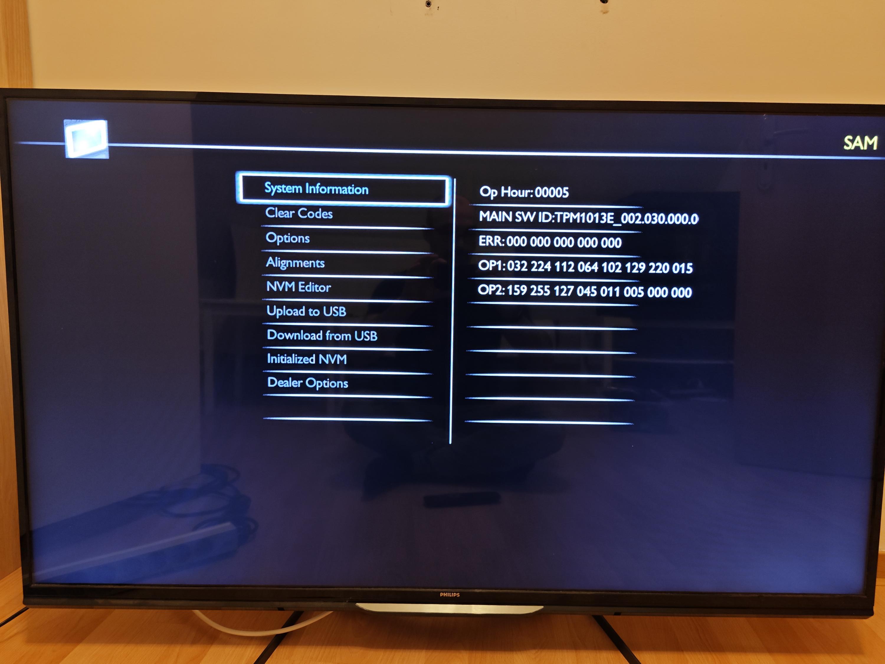

              I did not take pictures during the repair but I can open up the set again tomorrow.

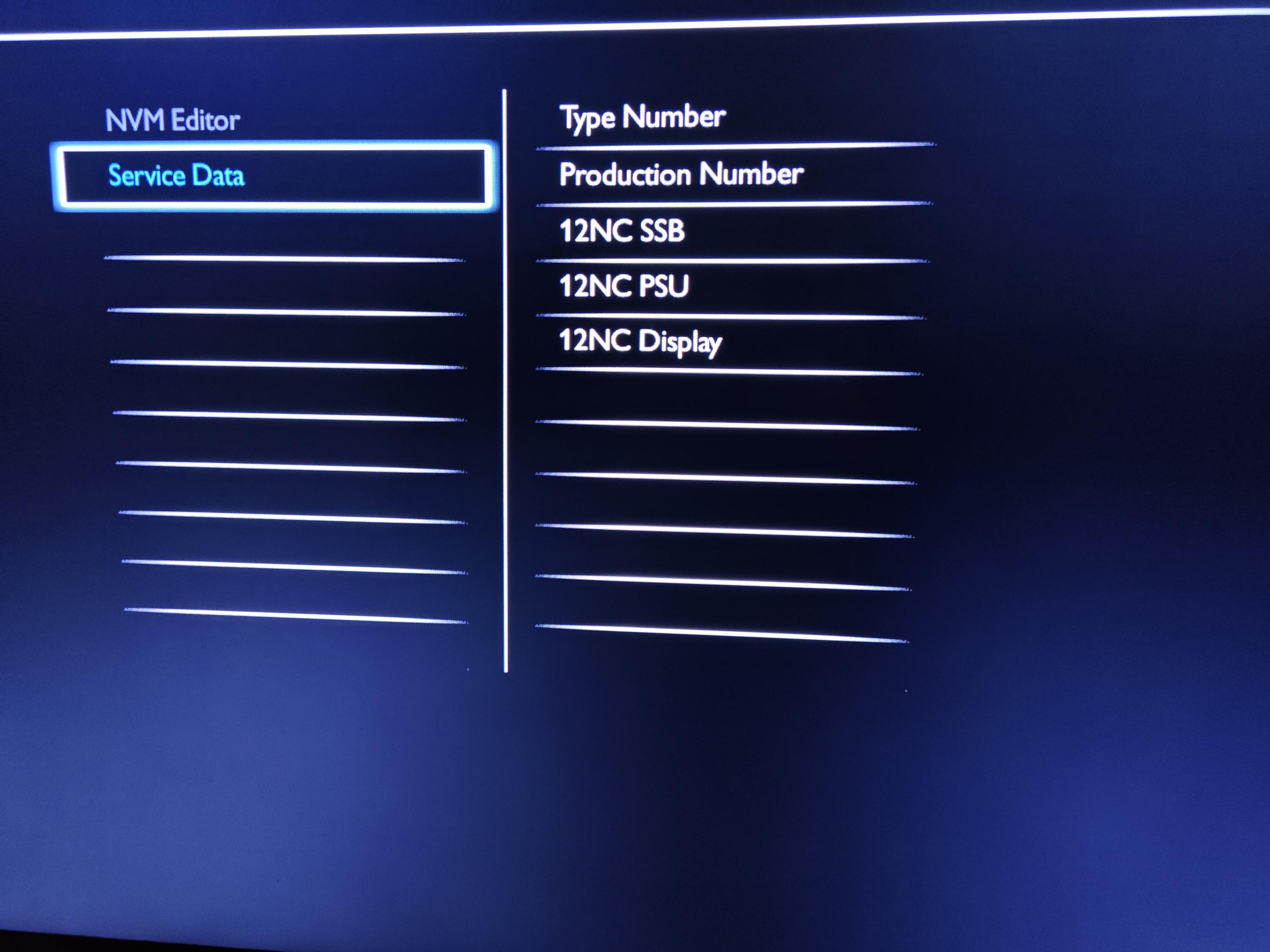

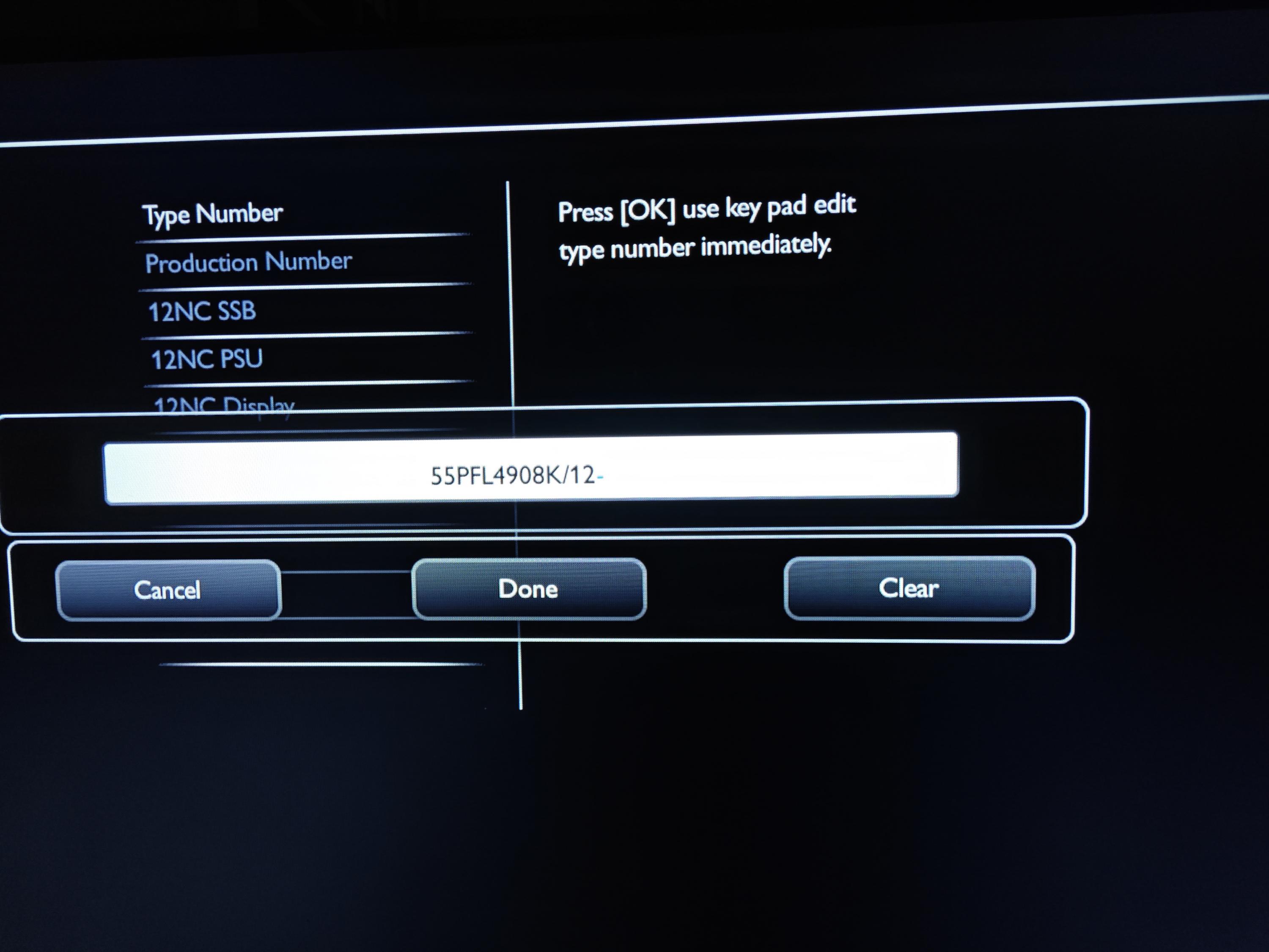

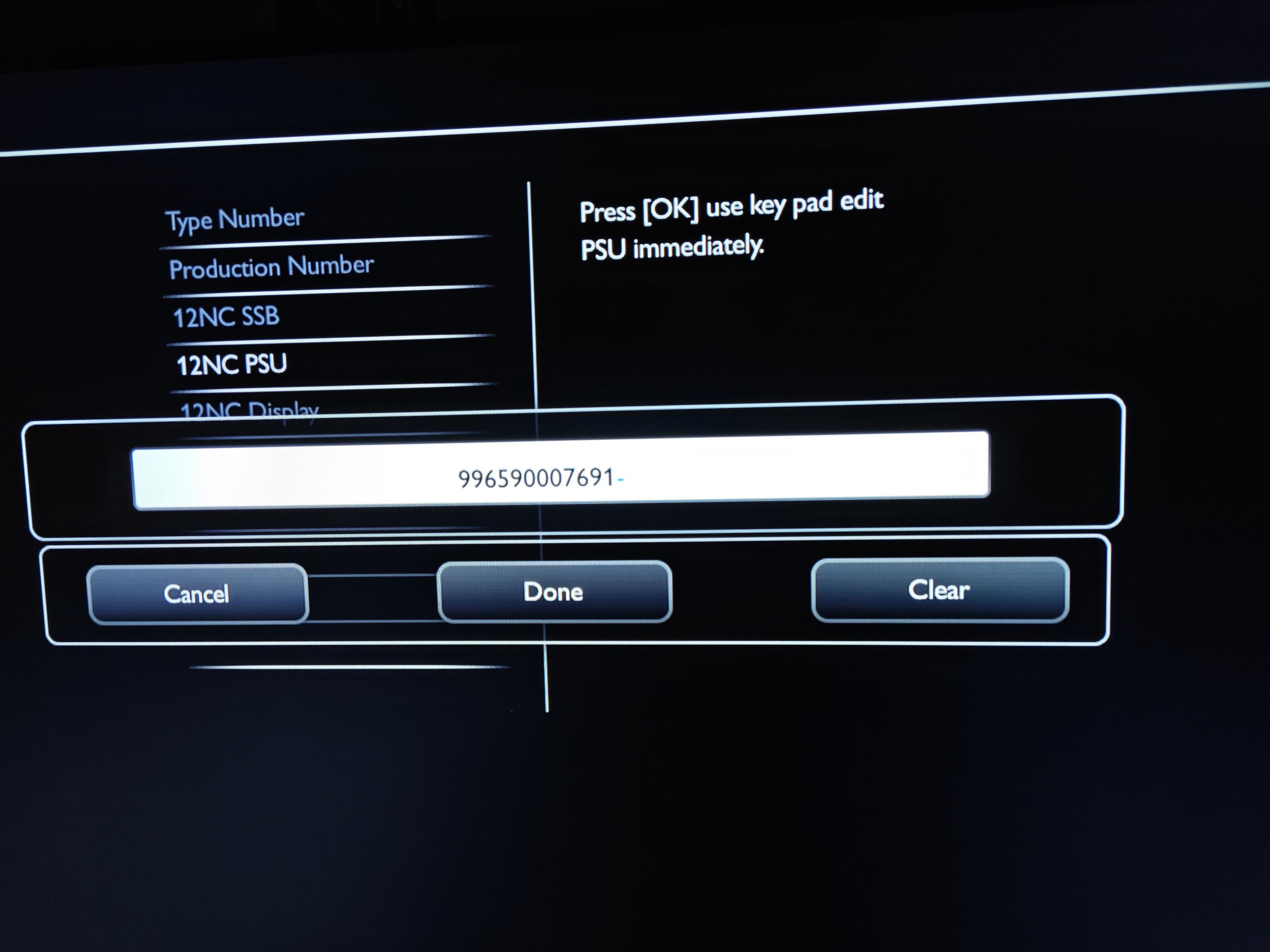

              Attached are some screenshots of service menu. It looks a little different than what I have seen from other philips tvs durng my research and there is no menu item for tuner configuration.

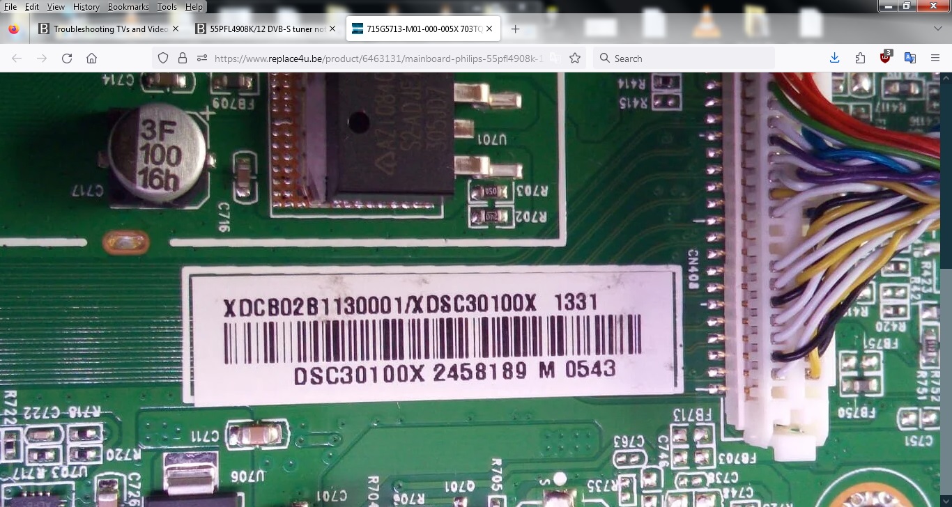

              Now I couldnt wait to see if this is more than a dummy conector.
              It says "094G DVB T17G" and the connector is labeled "SAT" on the plastic back cover.

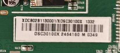

                Re: 55PFL4908K/12 DVB-S tuner not available
                look on the back side of the main boards.... it could be NTSC C not SAT, it sold in USA / CANADA with same 55PFL4908K but F

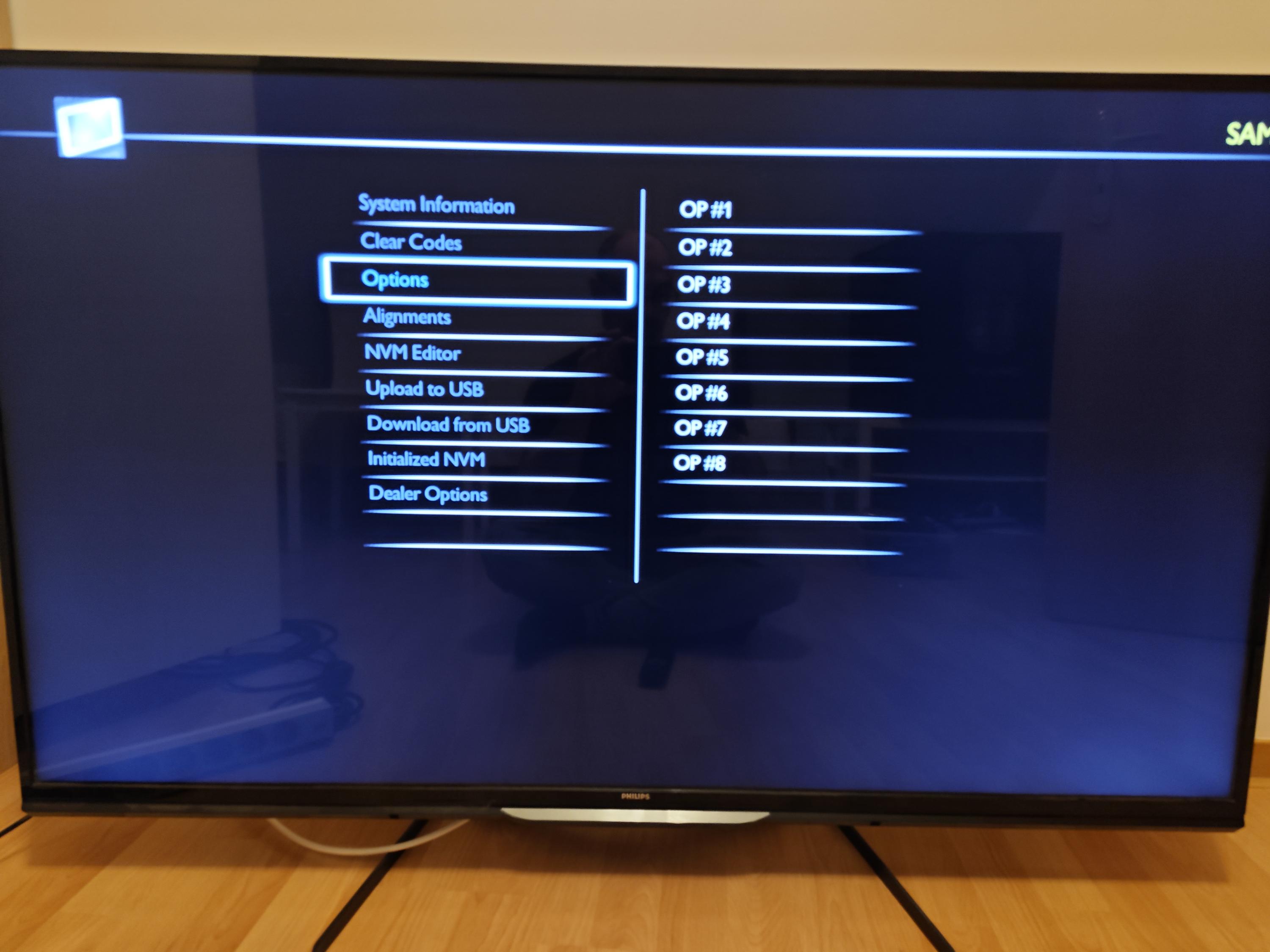

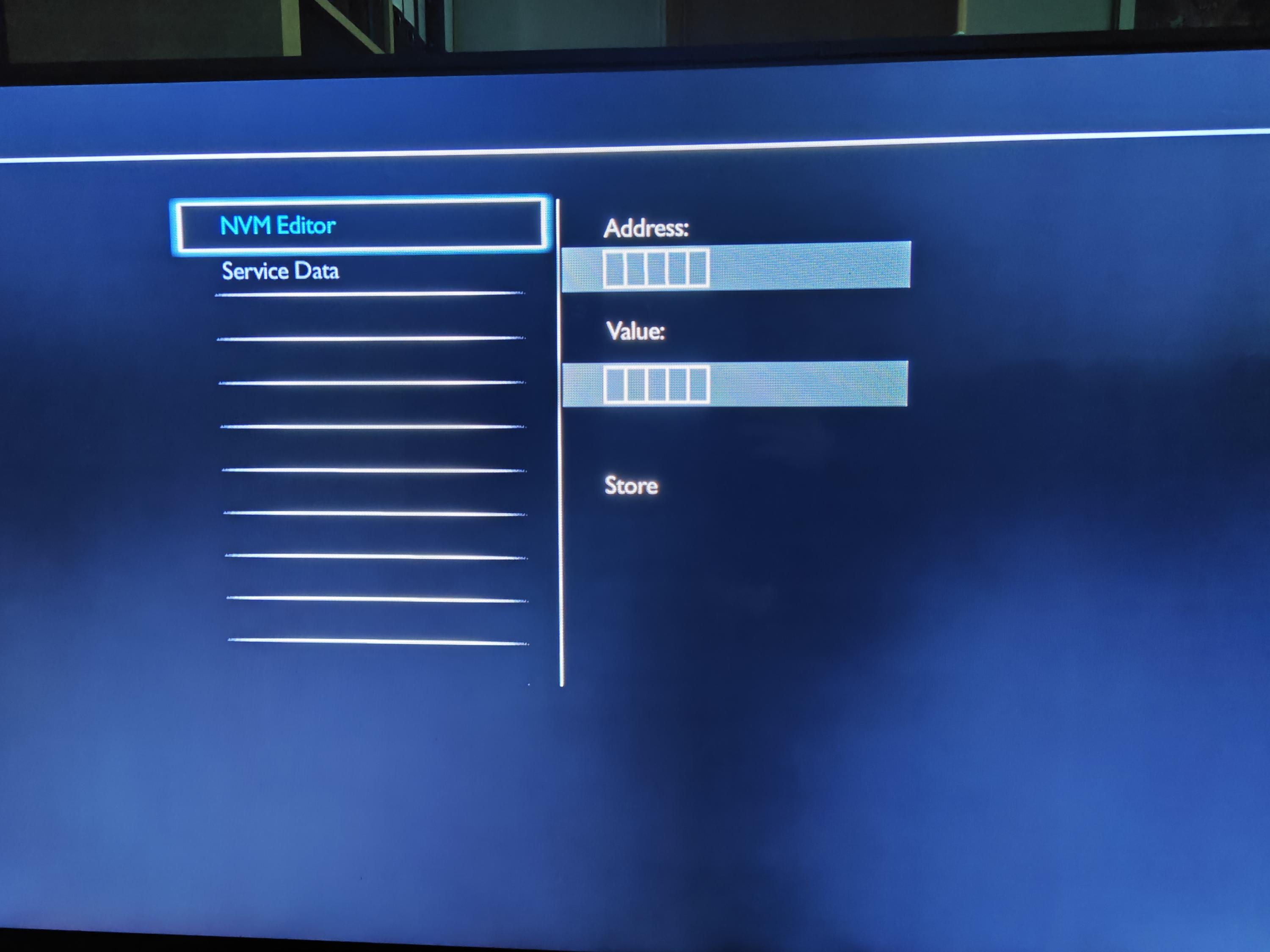

                    BTW show me NVM editor option and sub folder

                      you are right, I do not know the history of the TV so there might have been a weird replacement going on.
                      It might even have been sold not advertising it as a SAT capable TV at all.

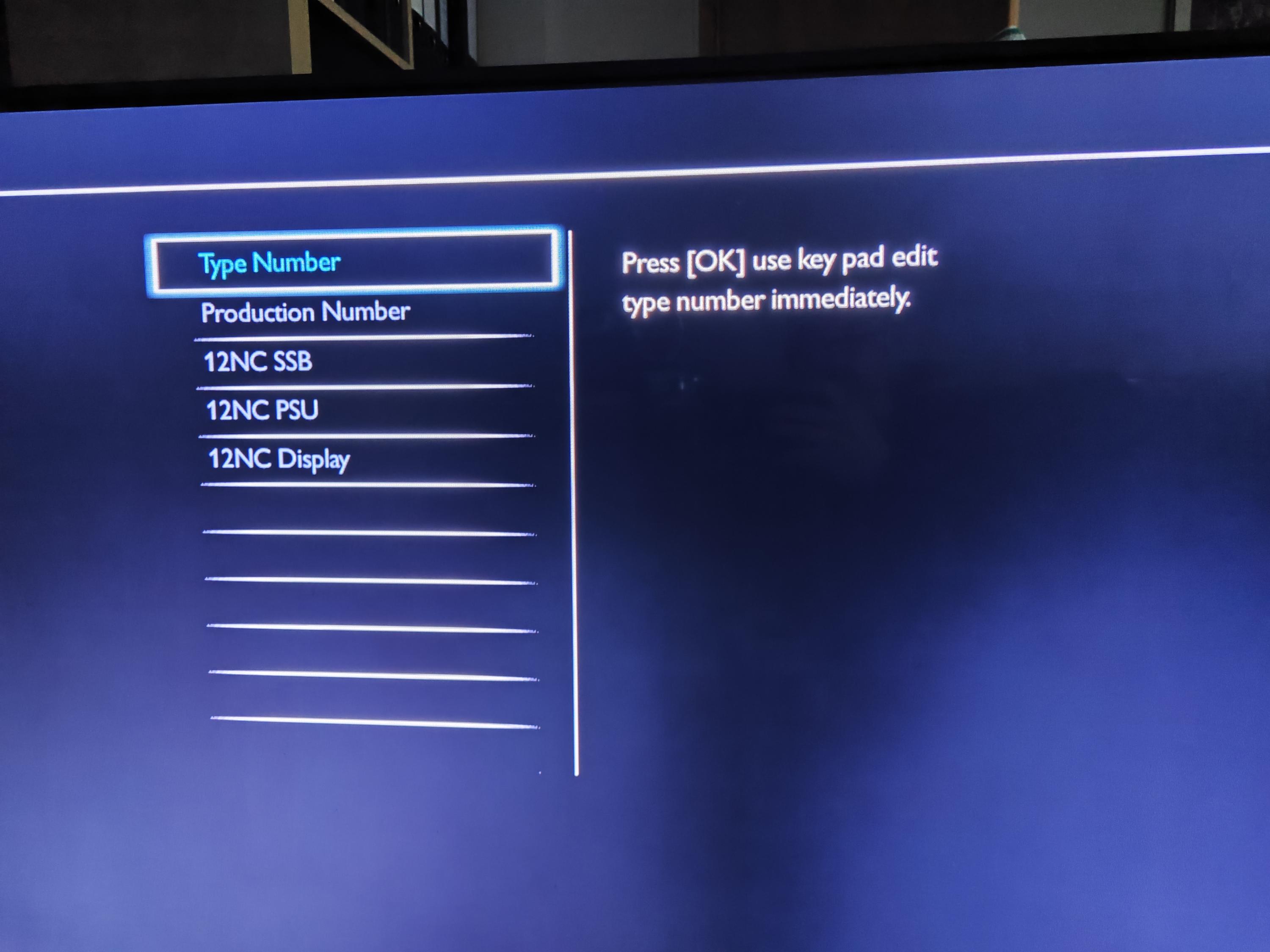

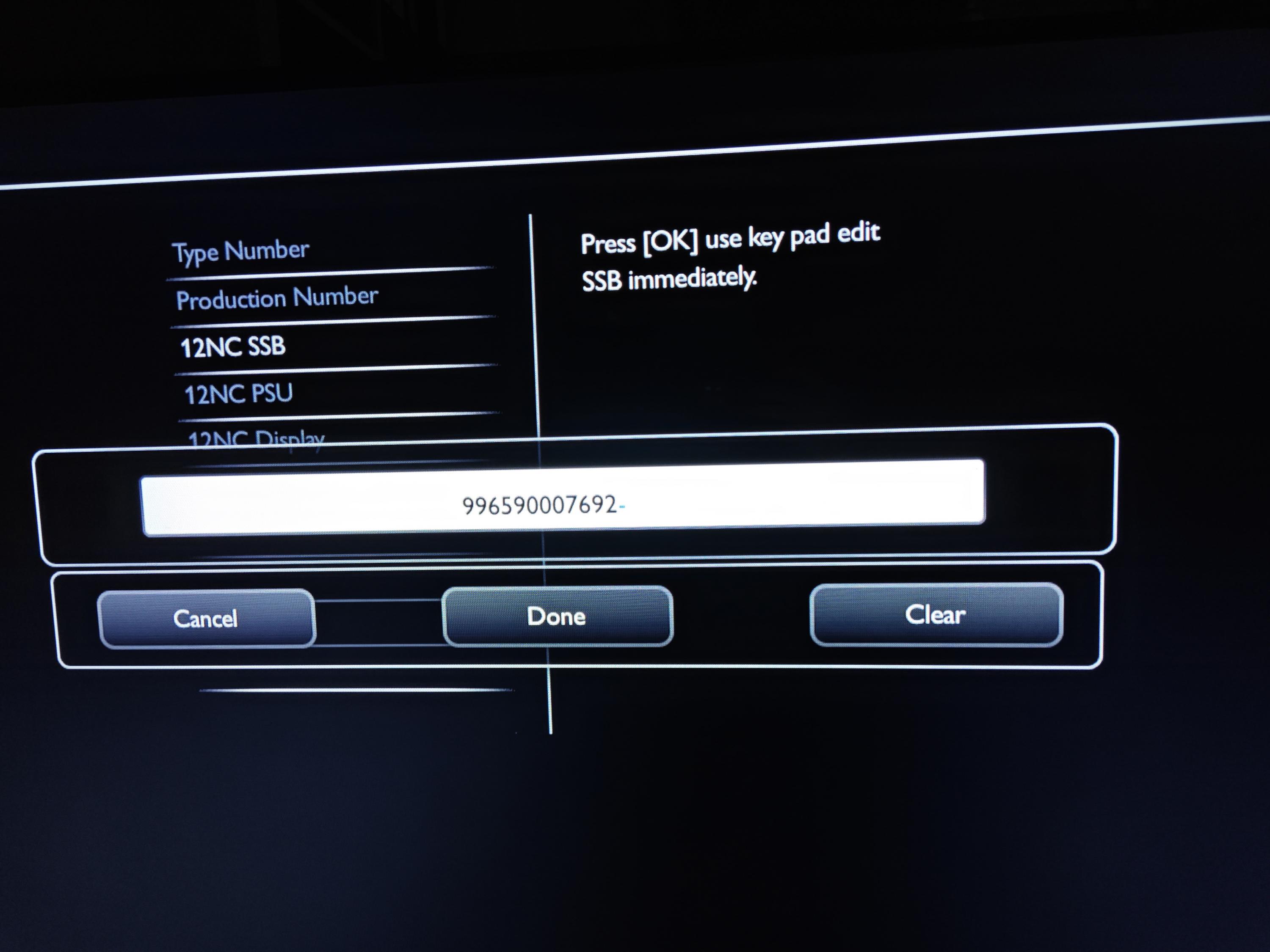

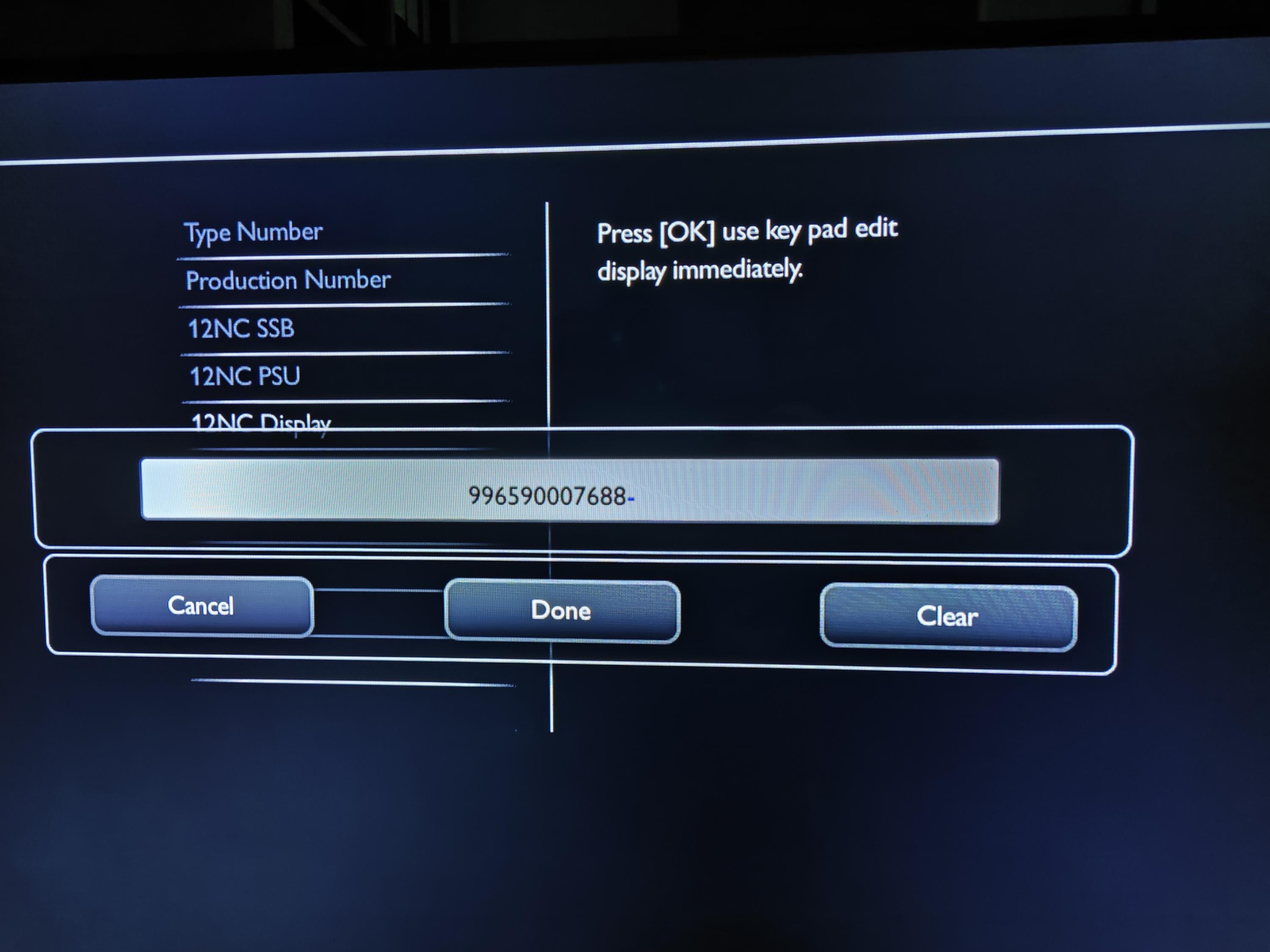

                      I took some screenshots of the menus but there isnt much to do unless you know exactly which value to store to a certain address
                        for me its just HW mixing.. see yours MB in set and the ORG in market,,
