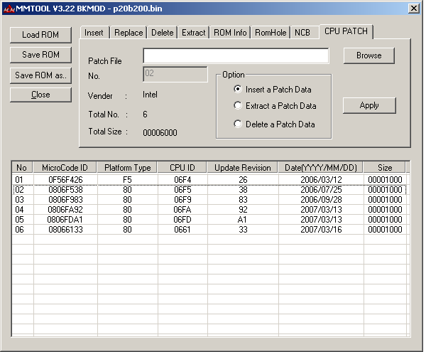

            any idea how to see what cpu microcodes are supported by this bios?

              Re: a giiiiiiiift
              Ask on the BIOS-MODS forum...

                  I've been trying to find any kind of list of CPU codes or the microcode ids but hours of research has turned up nothing

                        U-235: Look at the date... The last micrococde update was after the release of the last Socket M chip so flash this BIOS and you should be able to upgrade the CPU.

                          a T7300 isn't out of the question but cutting it a little close, infact its about dead on with the last microcode update, which is what worries me. I don't want to spend $20-30 on a c2d to have it not work
