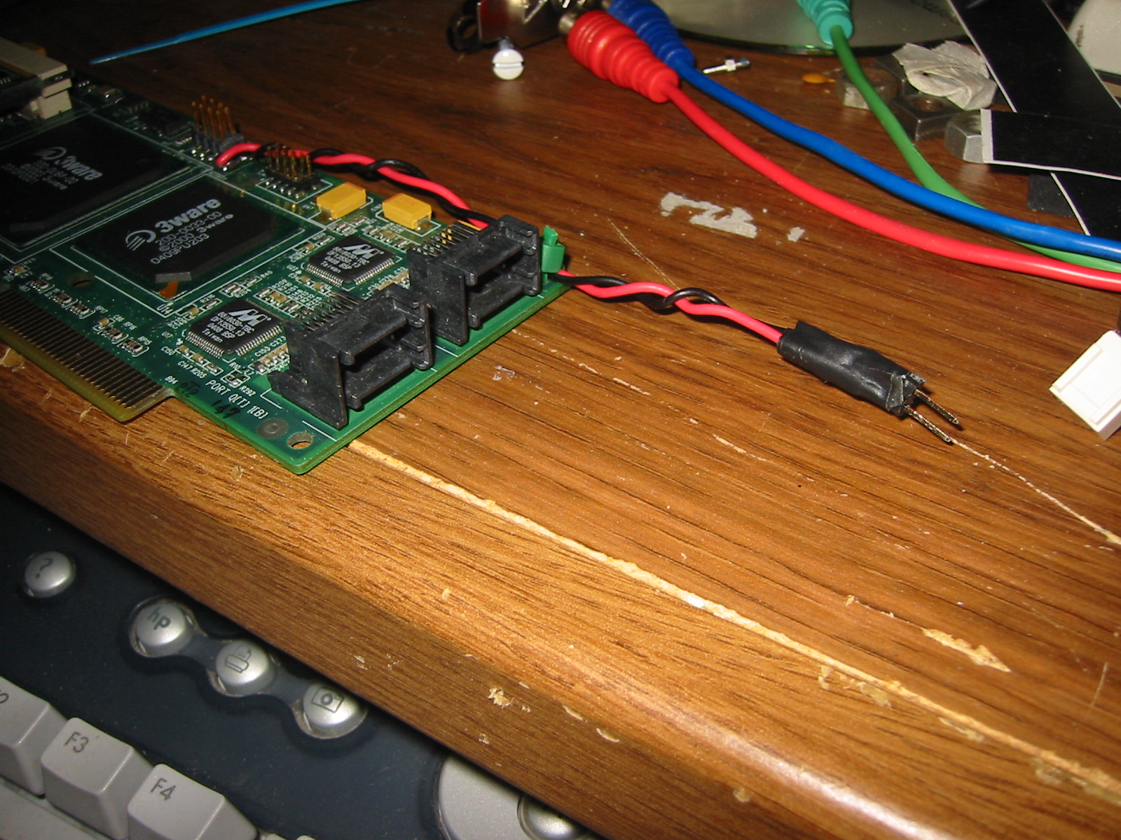

                        Bad news: while test-fitting the 3ware, I snapped on of the pins on the activy LED header pins.
                        Good news: I was able to fix it:
                        On the plus side, this makes it easier to plug in the HDD led and fixes the clearance issue with the header... right below the card, there will be the tuner:
                        top to bottom ( device (slot) ):
                        -AGP GPU (AGP8x)
                        -1394 (PCI)
                        -Sound card (PCI)
                        -controller (PCI-X 100MHz)
                        -Tuner (PCI-X-66MHz)
                        yup, all slots will be filled...
                        I know the fix is , but does it look ok anyway?
