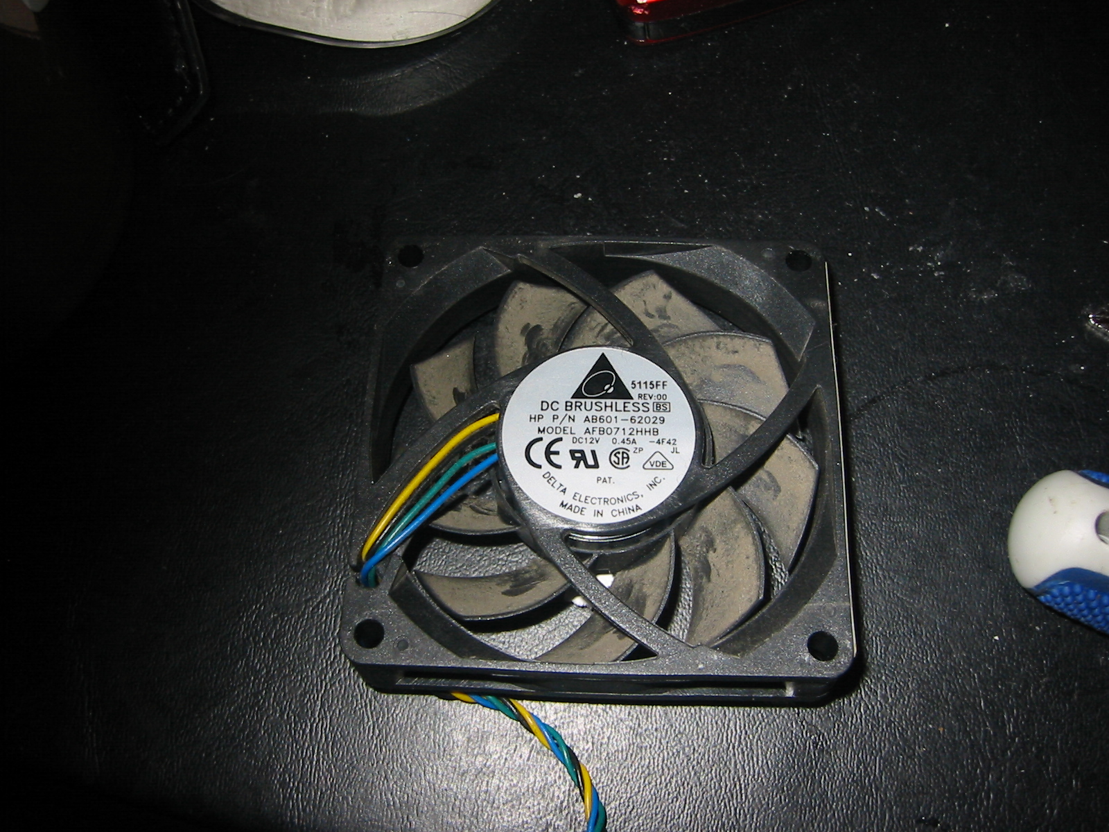

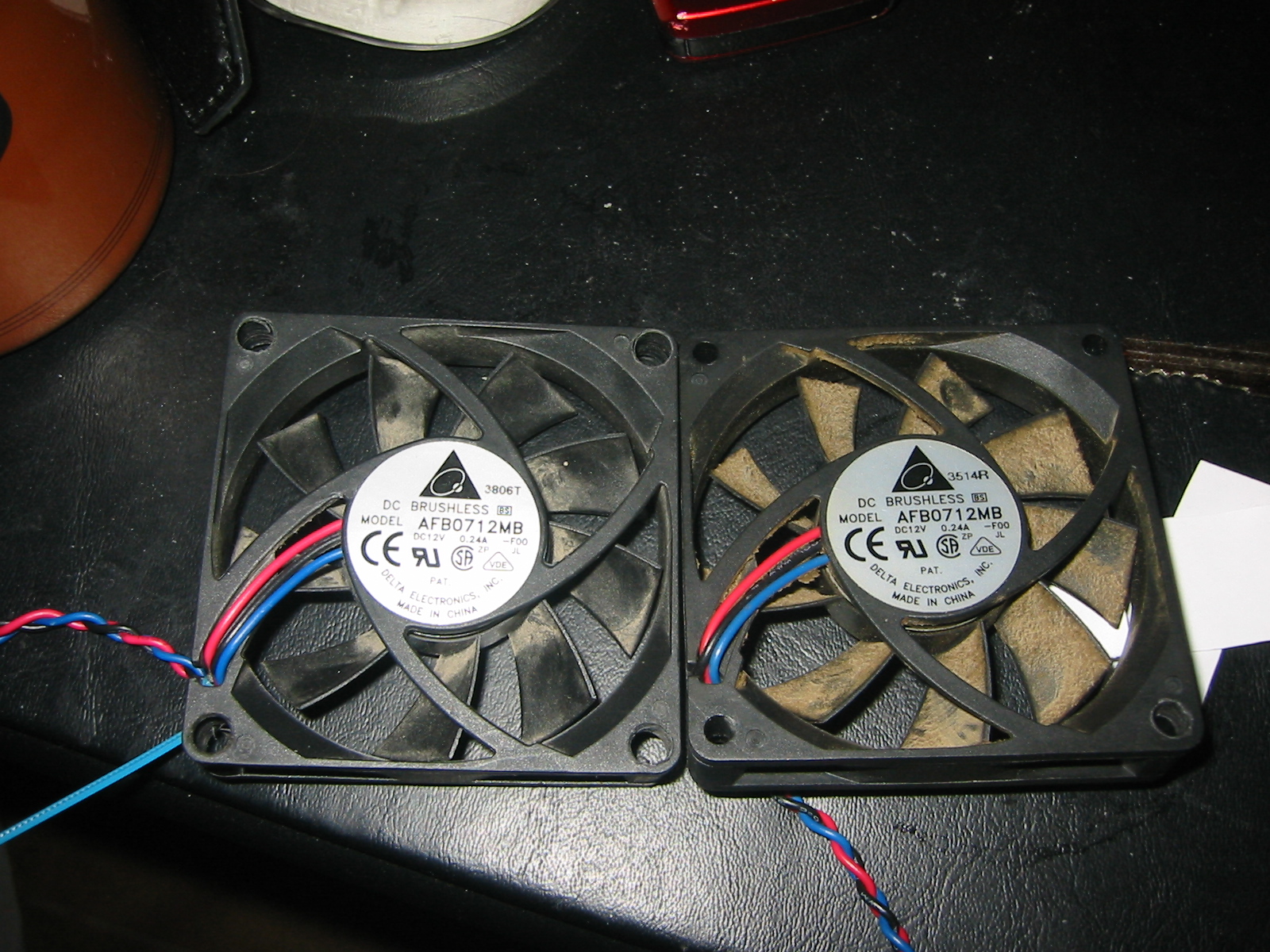

      1. I got the coolers home... And I swapped the fans:
      One of the old fans:
      The new fans:
      I am swapping the fans because I needed longer cables and the existing fans are too loud for desktop use. I did do a test with an old fan and a new fan powered up... the airflow was not that much different but the noise was considerably less.

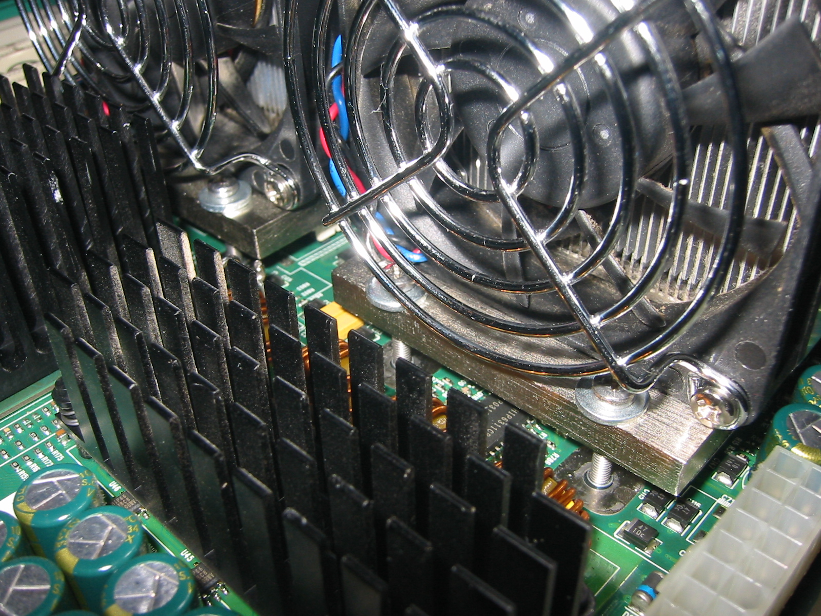

                              updates:
                              the board came in today... and I found out that the coolers did not fit... the scews are the wrong thread and the brass studs are too long.
                              I was able to mod the coolers though:
                              1. I removed the exisisting springs and scews from the coolers. I then used a hammer, pin punch, and a vise to hammer out the brass studs. I slipped and gave myself a blood blister (ouch).
                              2. I went to the local hardware store and bought some m3 x22 screws (x8) and some #6 washers (x8).
                              3. I installed the coolers using the screws; the washers keep the scre heads from slippign through the holes in the cooler. I used the amount of unused thread in the bottom of the backplates as a guide to get the cooler flush with the CPU.

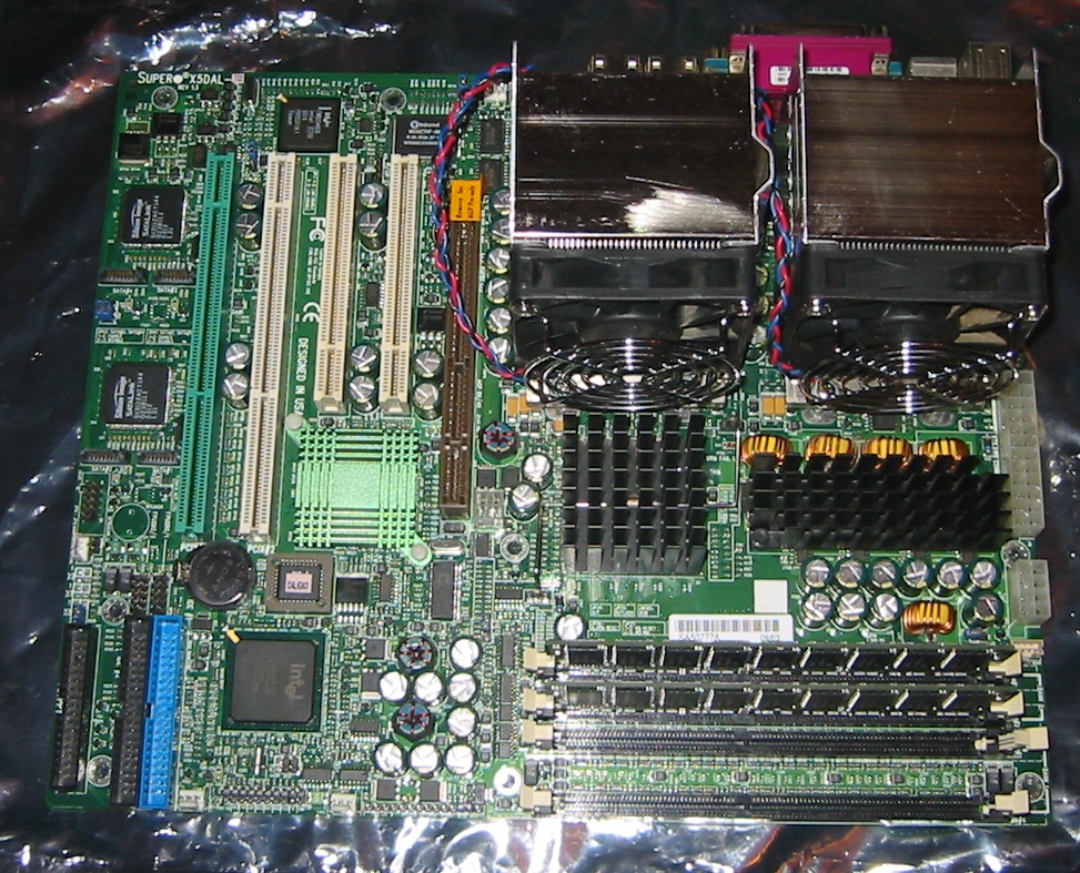

                                    Here are the few I have:
                                    the board before I installed it into the computer:
                                    close-up of the hacked cooler mounting:

                                      Very nice! I got close to a decade of 100% rock solid service out of that board! In all that time, it was running 24/7. I only shut it down when it became clogged with dust bunnies and needed a blowjob from the air compressor

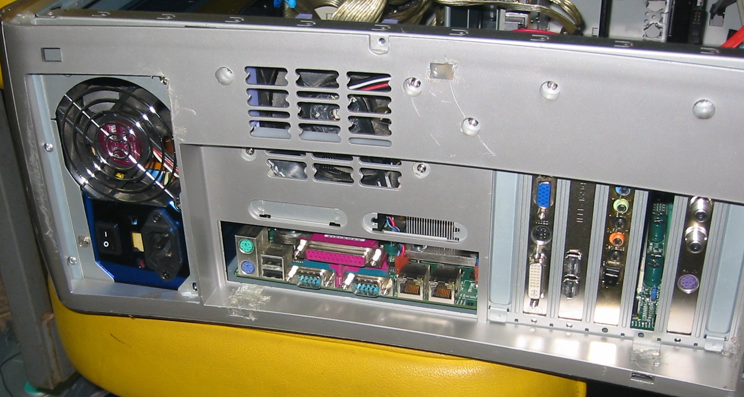

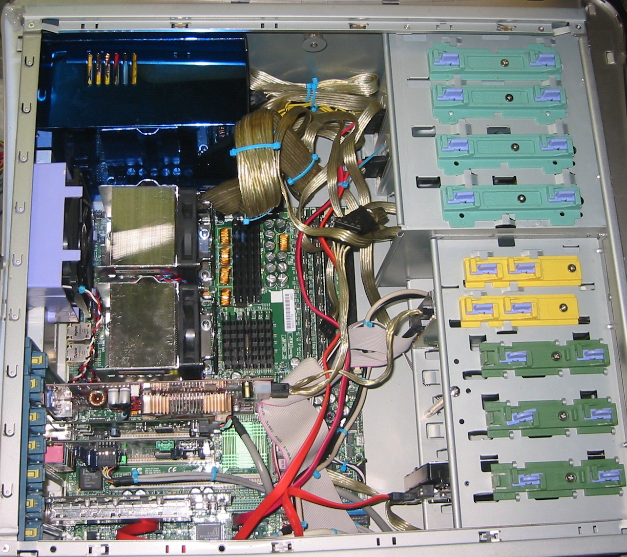

                                        #39
                                        Re: Ratdude's Main rig V2
                                        I thought you sent me the NOS one?
                                        (I am happy either way)
                                        some notes:
                                        - it is LOUD... the fan swap helped but even with a dell temp controlled fan, it is kinda noisy... trade off I guess
                                        - for some reason the two SATA DVD+RWs have to be set after the hdd in the boot list for the hdd to boot... the SATA controller must not like optical drives (it treats them like hdds, resulting in a no boot.

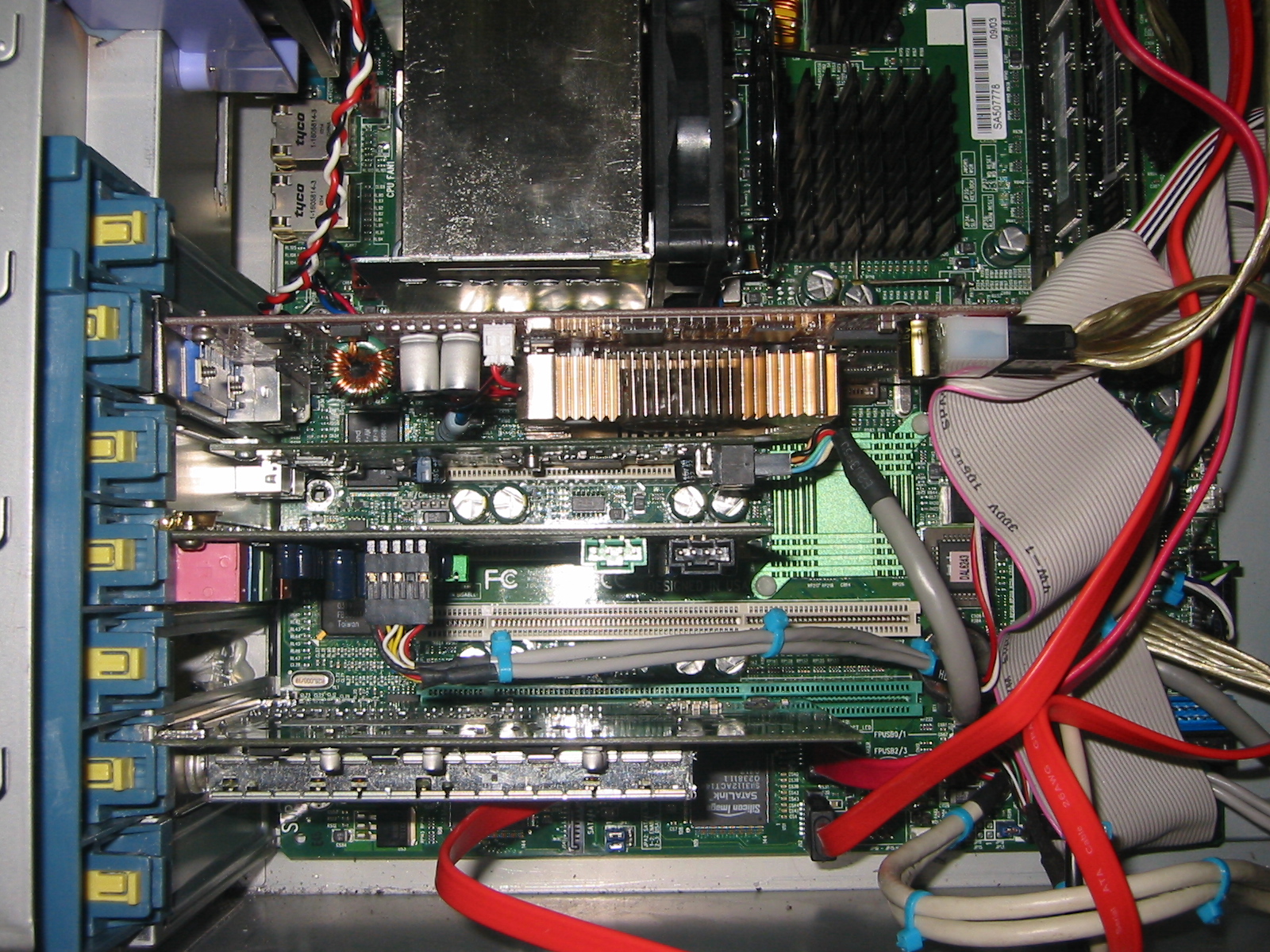

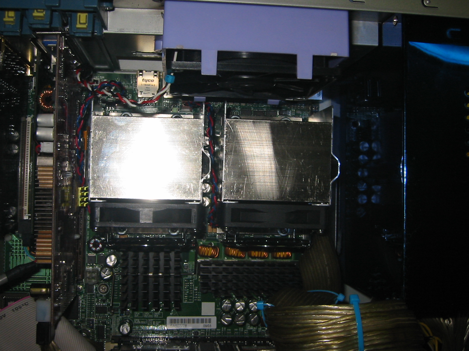

                                        some pics:
                                        overall:
                                        Yes, it is a bit cramped.
                                        The cooler area:
                                        the cards (note the gap where the 3ware card used to live)
                                        the back:
                                        Look good?

                                          #40
                                          Are there supporting backplates behind the CPUs on the board? Are they thick and sturdy?
                                          - If not, your heatsink bolt mod can seriously warp the board over time. At the place I work, we get Xbox 360s all the time, and when people usually apply a similar heatsink bolt mod, the damage is usually worse than from the original X-clamps.
                                          Then again, the Xbox 360s also run a bit hotter than your CPUs, so that contributes to the damage a lot more.
                                          2. I also spun up the case fan for the system and found it to louder than I thought. I decided to undervolt the fan by using resistors... I calculated that the fan itself is about 60 ohms (12V / .2A) and that 3 1/2W 100 ohm resistors in parallel woulf create a 33.3 ohm resitor and would be a good choice. I went ahead and made the mod... the good news is that the fan went from 2500RPM (full blast) to 1800 RPM (about right). The bad news is that the resistors get hotter than I anticipated... after doing the math, I am putting them at just over 1/2W per resistor... Oops!
                                          I guess I will want to look for a quiter fan by design or perhaps a temp controlled fan (like the ones in Dell towers, only with a usable tach output). Anybody have suggestions?
                                          As for the fans being too loud - maybe you can run them at 7V (red wire to 12V, black wire to 5V) or 8.7V (red to 12V and black to 3.3V
                                          Look good?
                                          Yes.
