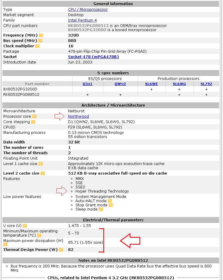

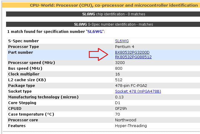

                        Like I said before, the SSpec number is engraved into the heatspreader. With that, you can look up the detailed specs on CPU-World.
                        It's like a part number, with every intel CPU having it (always a 5 letter/number code that starts with "S")
                        On cpu-world, put the Sspec number in the "Identify part" field on the right and click go.
                        This will bring you to a page showing the basic specs. To get all the details, you have to click on any of the part numbers shown.
                        You'll end up on a page with every single detail about that CPU (see 3rd attachment.. won't post it inline cause it's huge)

                        All 3.2GHz Northwood P4s on Socket 478 (SL6WE, SL6WG, SL792) are 800MHz FSB :P
                        And only one of them (SL792) does not have HT (or at least the info is missing).
