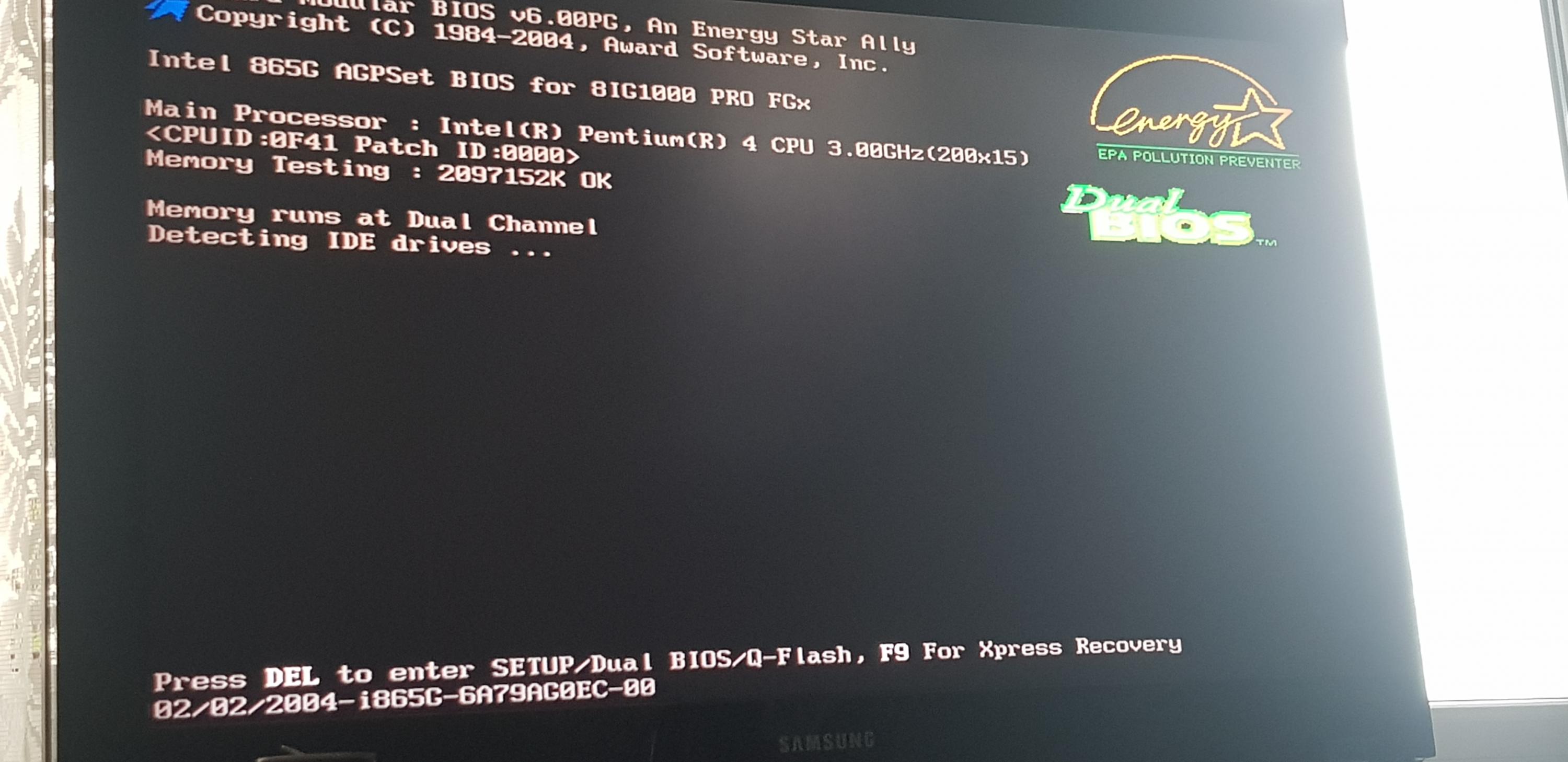

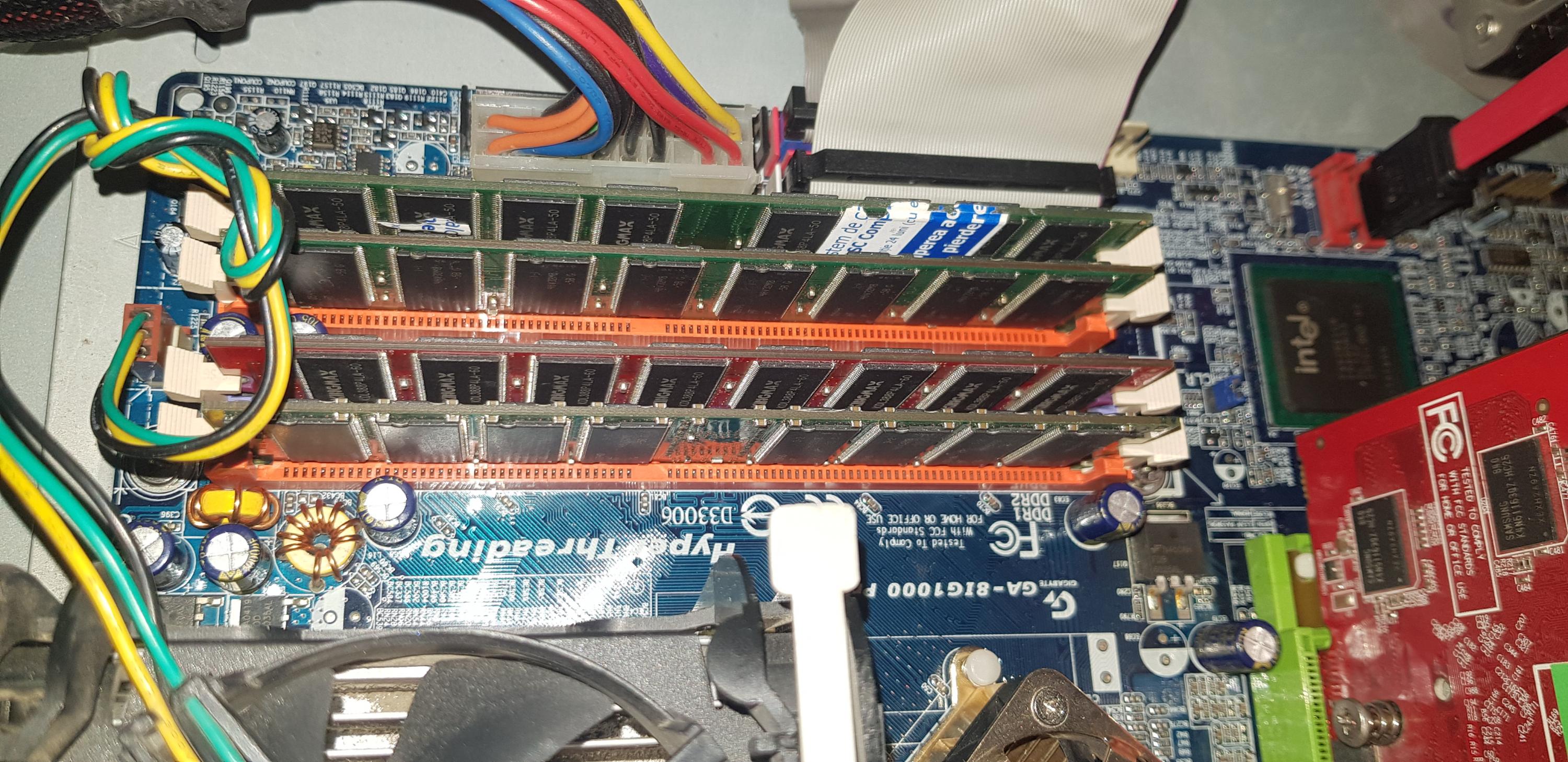

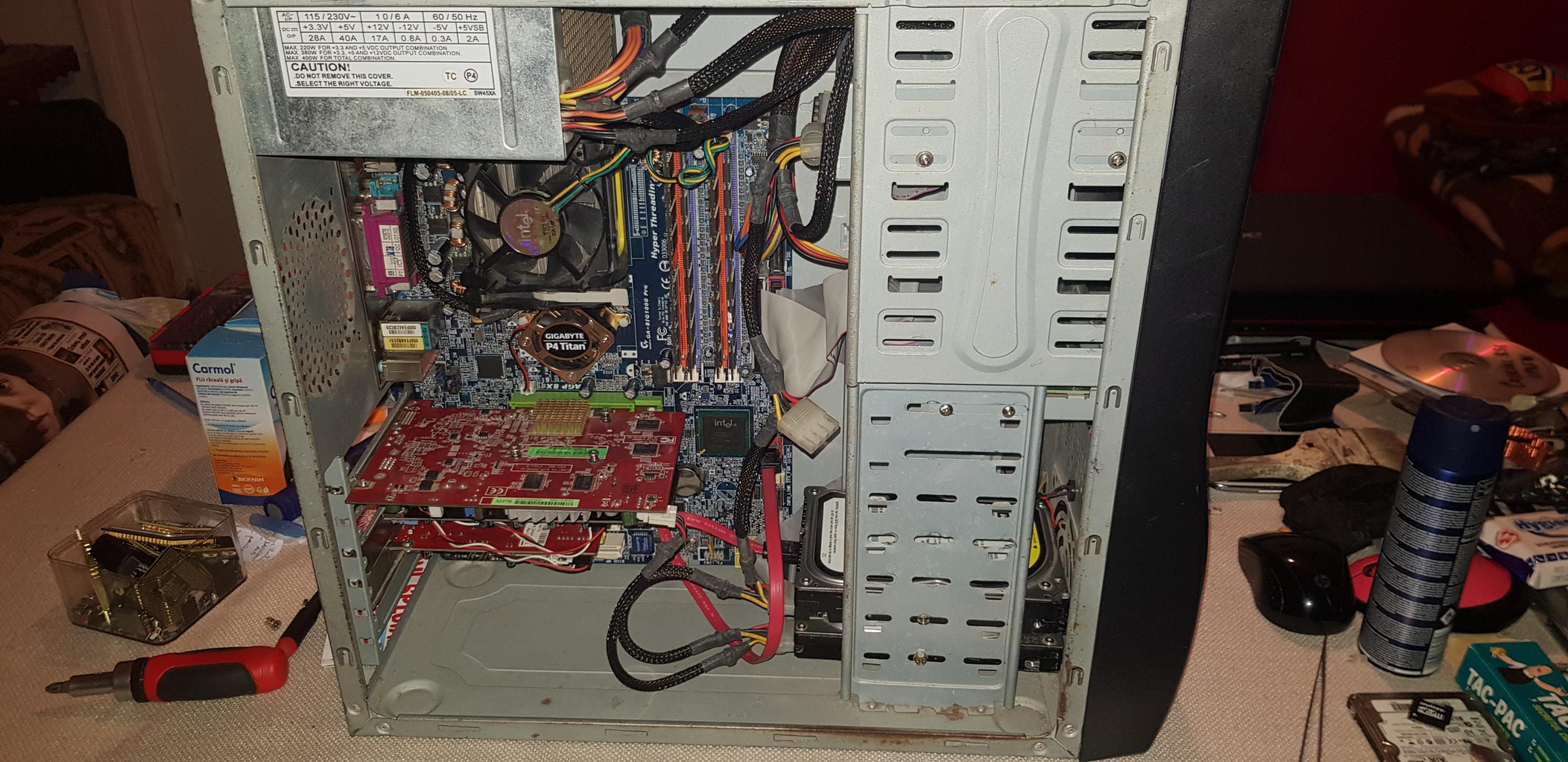

    Just as the title says, this machine is basically a "Netburst Mercedes". From the case, all the way to the innards, IMO.
    First, let's take a look at the specs:
    Mobo: Gigabyte GA-8IG1000 Pro w/ FGx BIOS (special BIOS revision made by AGFA for their dlab.1 MPU machine.)
    CPU: Pentium 4 HT 3.00GHz Prescott - will probably replace it with a Northwood HT as this Prescott is literally HELL incarnate. Wish I'd be joking, but it's absolutely true.

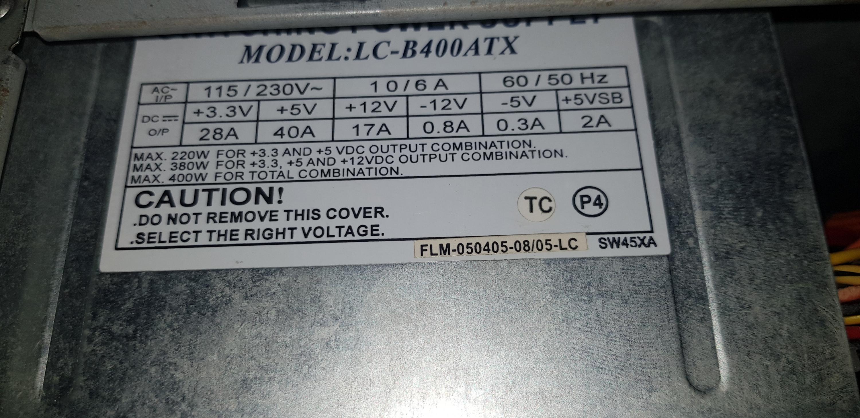

    PSU: revamped Deer/L&C LC-B400ATX (strong heatsinks, 35 size main trafo, complete main filtering, recapped with good caps, and sleeved wires out of a totally busted Thermaltake.)
    RAM: 4x512MB, nothing special
    ODD: some random Lite-On that is literally not even reading discs

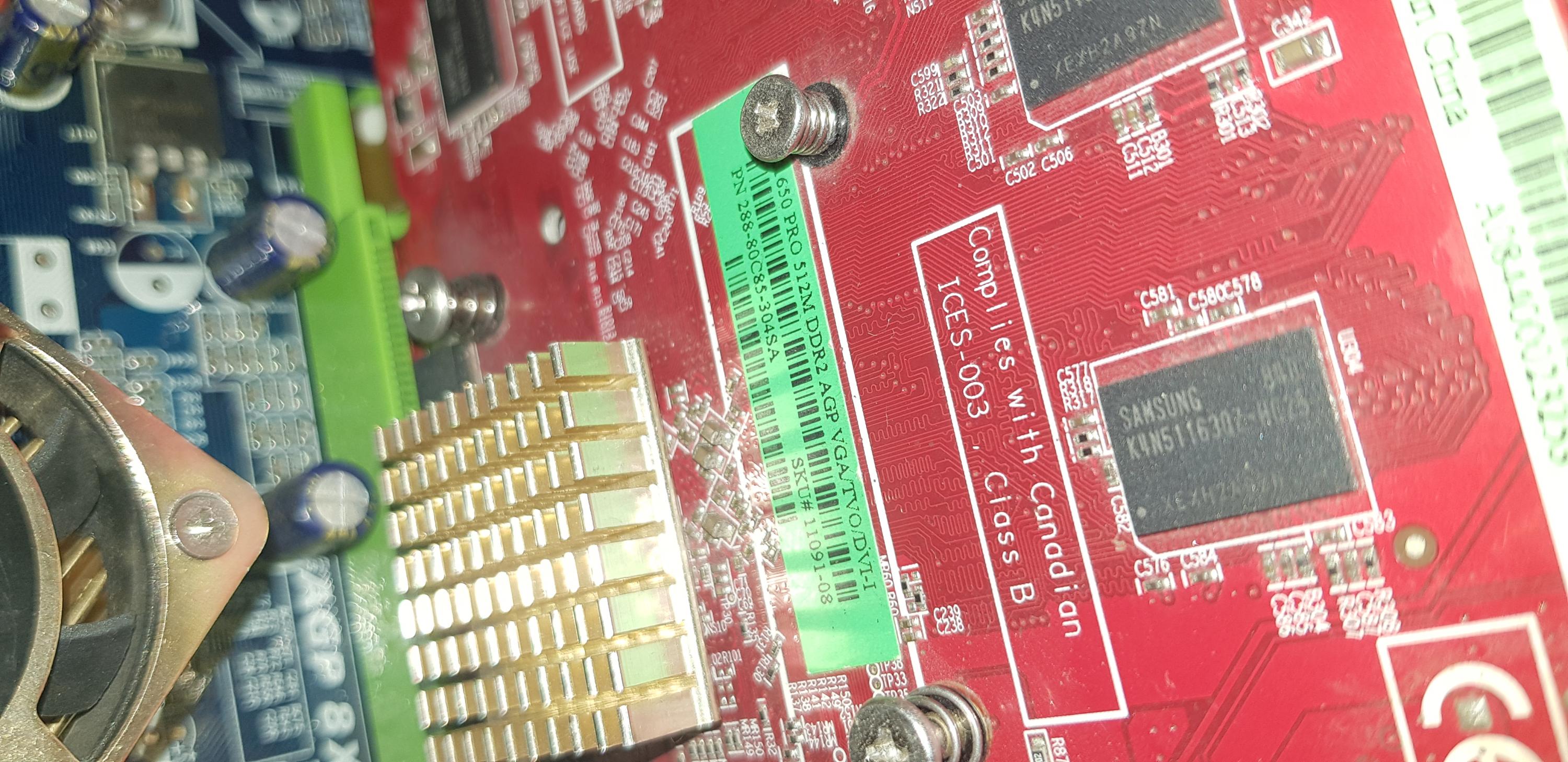

    GPU: Sapphire Radeon X1650 Pro 512MB DDR2 AGP8x

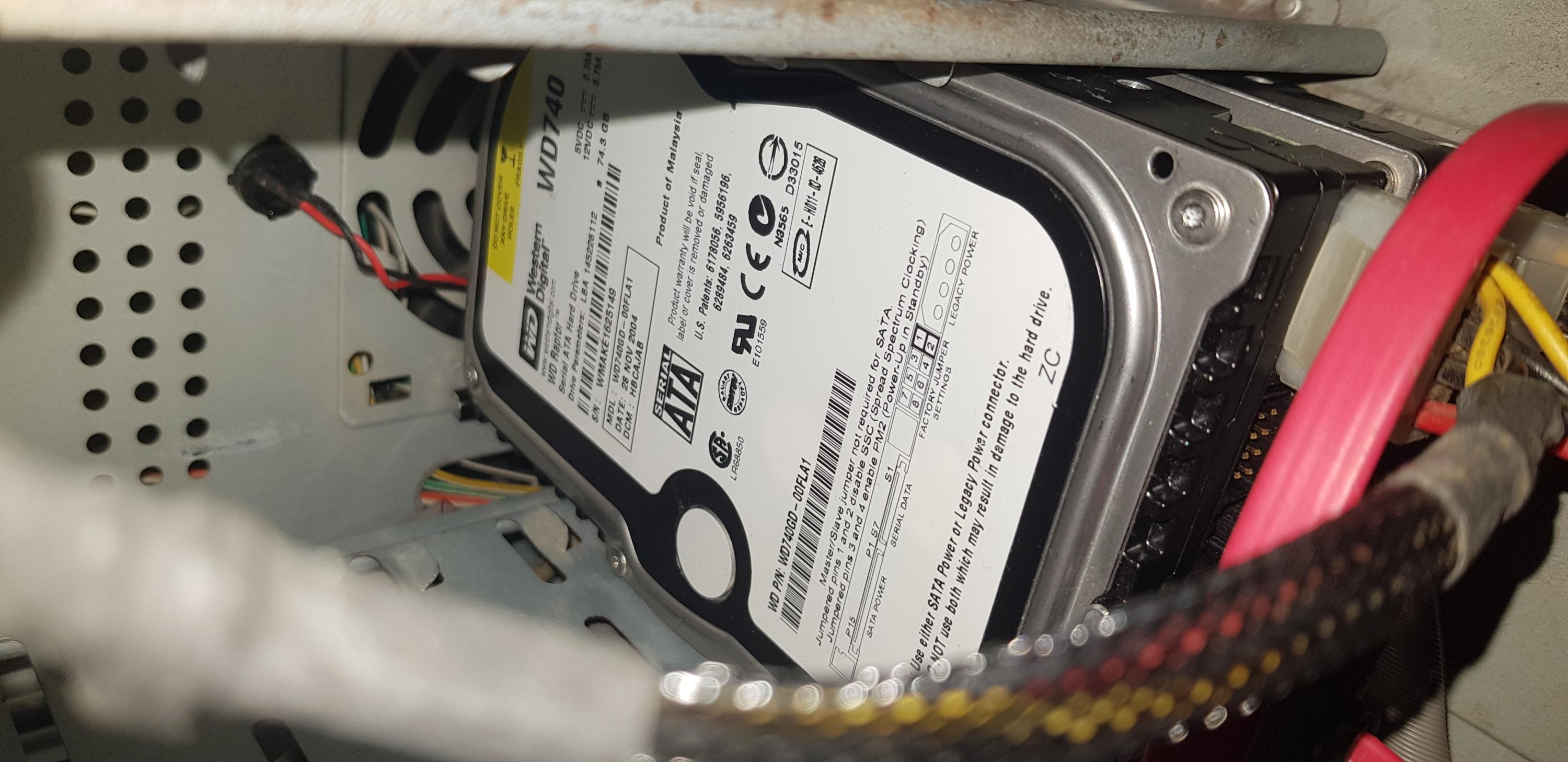

    HDDs: 80GB Hitachi Deskstar as OS drive, 74GB WD Raptor as storage.
    Soundcard: Sound Blaster Audigy SE SB0570 PCI
    Other: Pinnacle PCI TV Tuner that I have no idea of its model number.
    To do:
    - replace the absolute Prescott furnace with a 2.8GHz Northwood HT. Cooler operation and doesn't murder the PSU as much as the Prescott currently does (not really, it's just running hot and loud - Deer's thermal controller works surprisingly well so no wonder the fan is loud.)
    - replace the ODD with either an LG or Samsung
    Finally, I'll leave some pics.

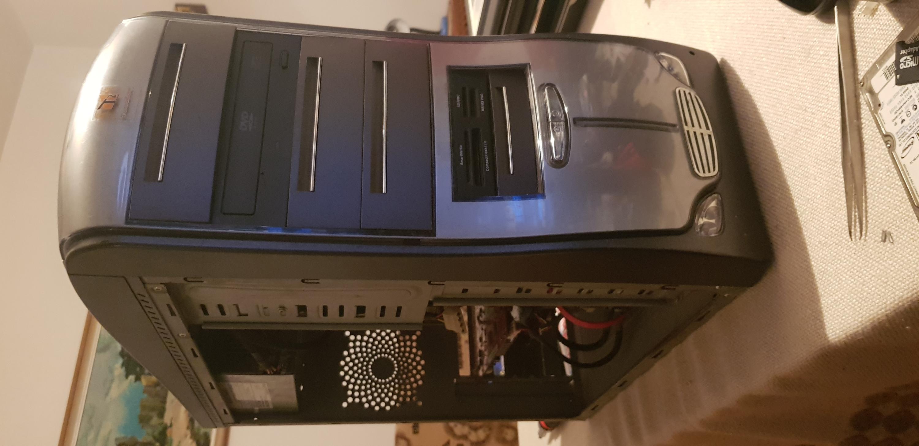

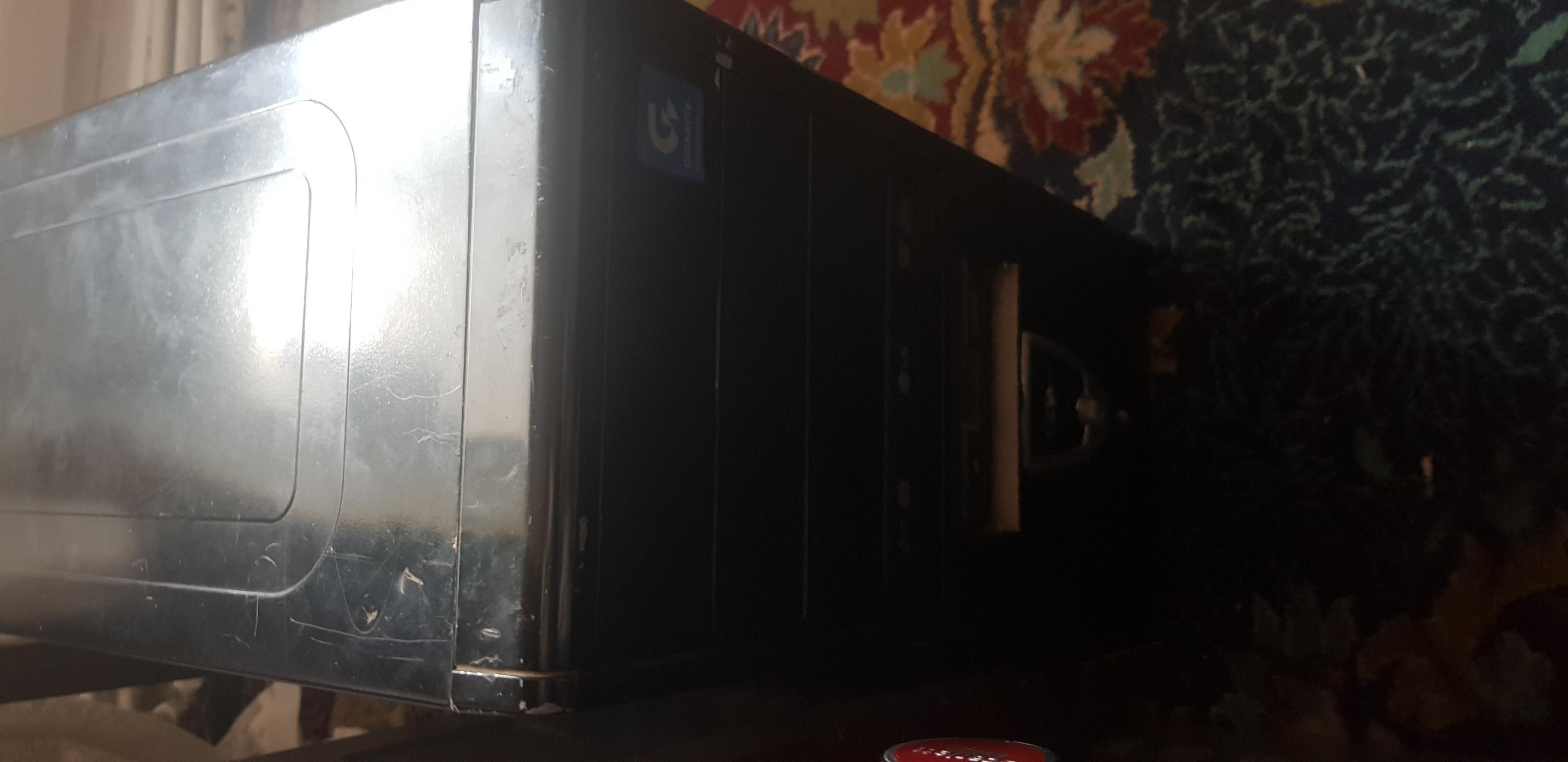

        Looking back at the original post, I now realize I forgot mentioning the mysterious Mercedes styled case! It's a Linkworld 3210 (yes, Stinkworld) case I was given for free, that had been in rather rough shape.
        It's ever so slightly rusted, but in much better condition than when I got it nevertheless - I had matched it with parts from another Linkworld case of the same construction (a 313G I think) that was rather ugly but had same kind of chassis. Same goes for the drive covers - they came from that scrapped case, despite not being fully compatible.
        I also modified the front LEDs so that they match my main PC's configuration - thus, there are two green power LEDs put together, along with two amber (which will probably be replaced with red and white-based green LEDs) HDD leds.
        Left to do to the case is also glue some rubber standoffs - the case only has some slight pits that act as standoffs and you can imagine how bad the case would drift on wood. Surprisingly cheap yet good case, otherwise.

          Also sorry for double post. Replaced DVD drive with some older Liteon unit dated ~2003. It's white, but it seems to still read discs like new.
          Also replaced the SATA cable as I had issues with the old one.
                HA! You weren't kidding with that tittle.
                I figured when you said "Mercedes", you just meant a cool P4 build... but I see it now - the case IS actually very much like a Mercedes front.
                That's actually really cool.
                I've seen the same "BMW" cases with the carry handle on top and whatnot. Always thought they looked tacky and yet cool/unique for that era at the same time. In any case (pun intended here), I still find these a lot more interesting than the modern cases with RGB LED fans on the front and boring glass window on the side.

                Well, good sir, you are running a stock "low-TDP" Willamate/Northwood CPU cooler in that build... so no surprise your Prescott is running hot. Even the 2.8 Northy might run a bit hot with that. The proper heatsink for 2.6 GHz Northwoods and up has slightly more fins. And the Prescotts usually run all copper or Alu-heatsinks with copper inserts. I've seen only a handful of stock all-aluminum heatsinks for Prescott and they were... THIC.
                Do you have a stock s775 "full-height" cooler with copper insert? If yes, those will do for the Prescotts. AMD's 89W TDP heatsinks from the AM2/AM3 era would also be suitable. But of course, this would require ghetto-modding.
                As for it being worthwhile - maybe. Depends what you're going to use the system for. If just for retro games, the Northwood will probably do just fine. But if some browsing or video-related stuff will be done, the Prescott is actually considerably better due to extra cache and SSE3.
                https://www.badcaps.net/forum/attach...1&d=1646761495
                Nice!
                Did you add that heatsink on the bridge yourself or did the video card come with it?
                Either way, this is THE ONLY way those cards should be used. Otherwise, the bridge chip is a common failure for these cards, rendering many of them broken after some years of use.
                Really glad to see yours has it.

                Stinkworld PSUs were never that great... but their cases - not bad!
                Do you have the side for that case? If so, consider adding a rear exhaust fan. Pentium 4 systems do need them. PSU fan likely won't be enough.

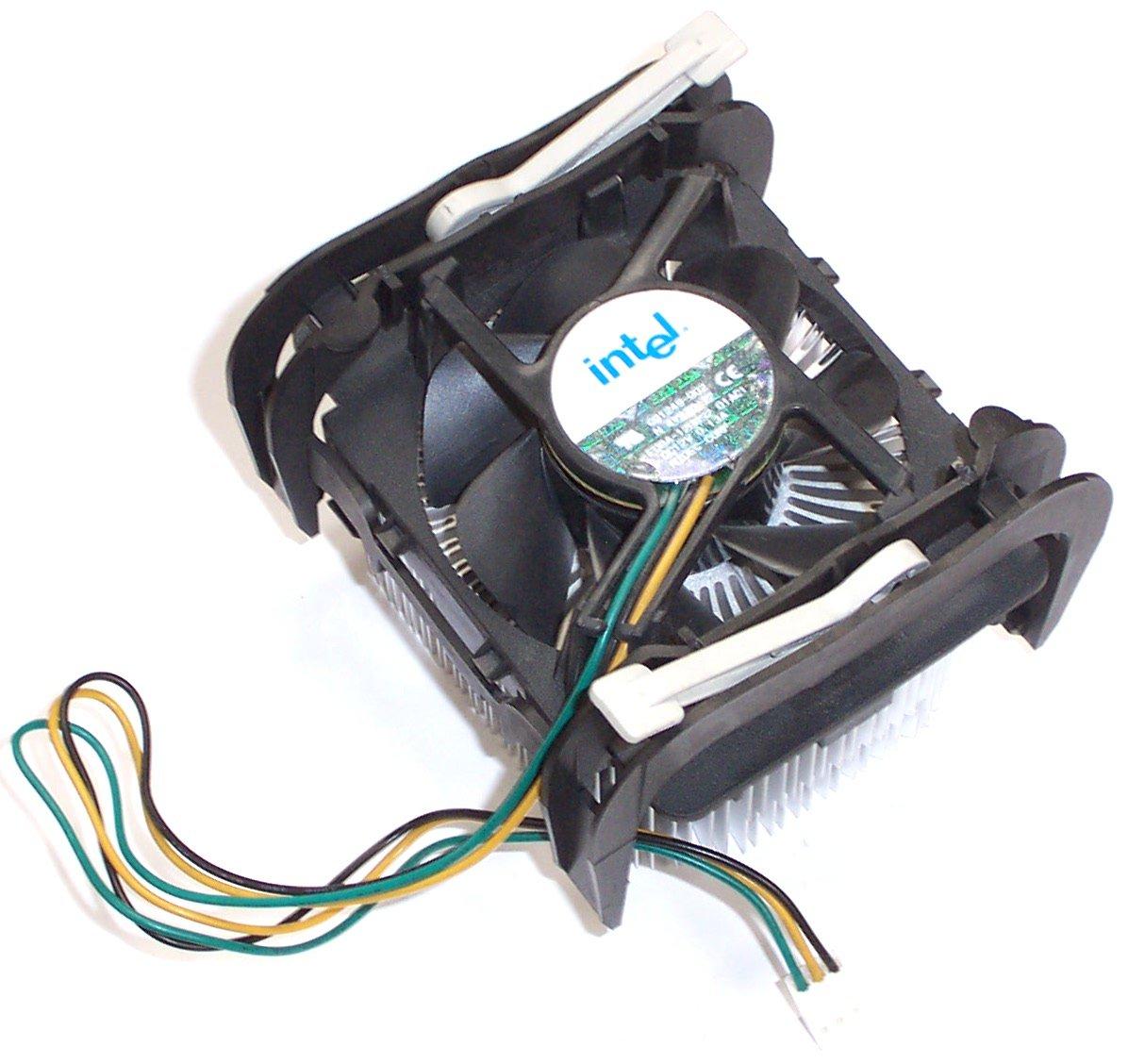

                  You mean the C91249-002 shown like in the photo? If so, I remember having tons of these, and they do have the copper base. I'll check to see how those fare against the stock Willy/early Northwood heatsink.

                  Nice!
                  Yes, it's superglued in there. I had artefacts before glue-ing it in there, along with a X1300 exhibiting the same symptoms. Speaking of which, I think I should bring that one up to snuff as well.
                  The side panel isn't really anyhting special, though I figure a 92mm (or at least that's what I think the case fan size is.) will probably help.
                  As for PSUs... I think I still have some "Stinkworld" PSUs I could patch up - these were actually among the few that you could fix and have a semi-decent 250W unit. If you don't count the absolutely dumpster-fire half-sized units, that is. Their standard full-sized units were okay-ish though (bar the abysmal cap choice, that is.) once recapped.
                        https://images.prom.ua/1465999940_w6...rotsessora.jpg
                        Heh, I've actually never seen those before... but they do look like they have more fins, so I think they should cool a little better. Give it a try and see.
                        Nice!
                        Whatever works.
                        But yeah, those bridge heatsinks were necessary. Too bad too many manufacturers cheaped out.
