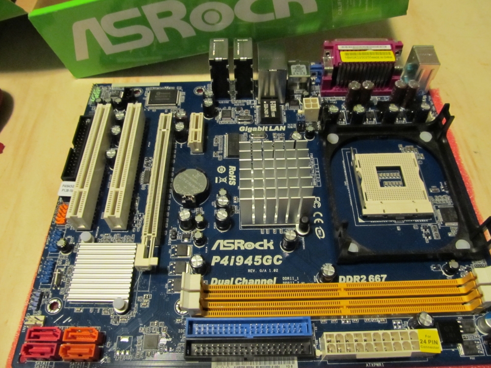

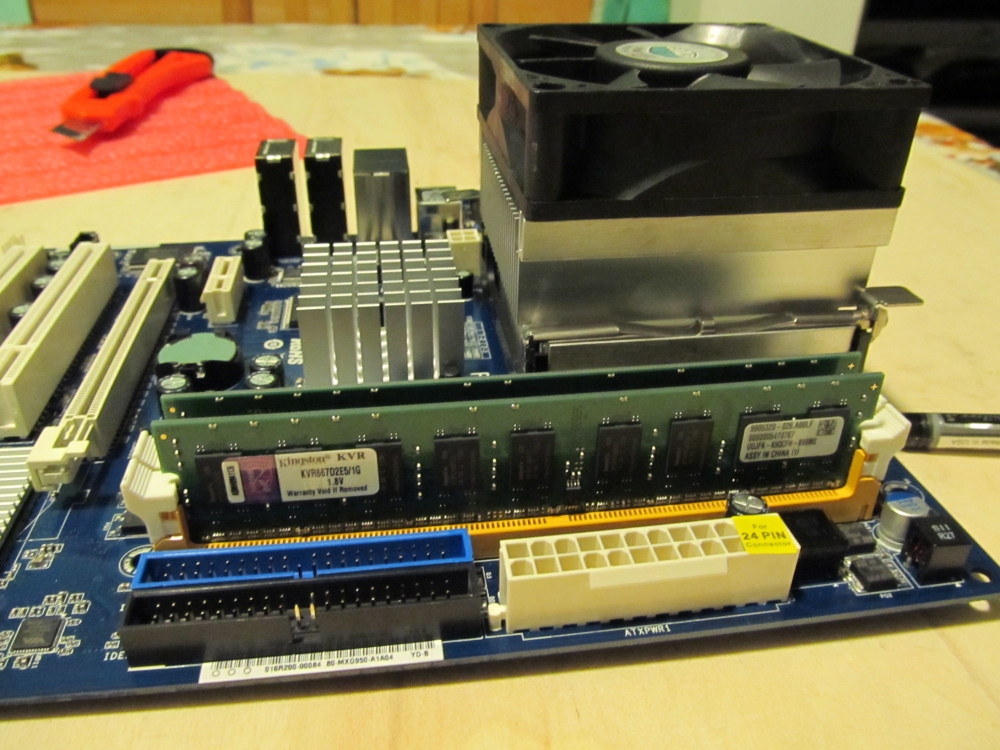

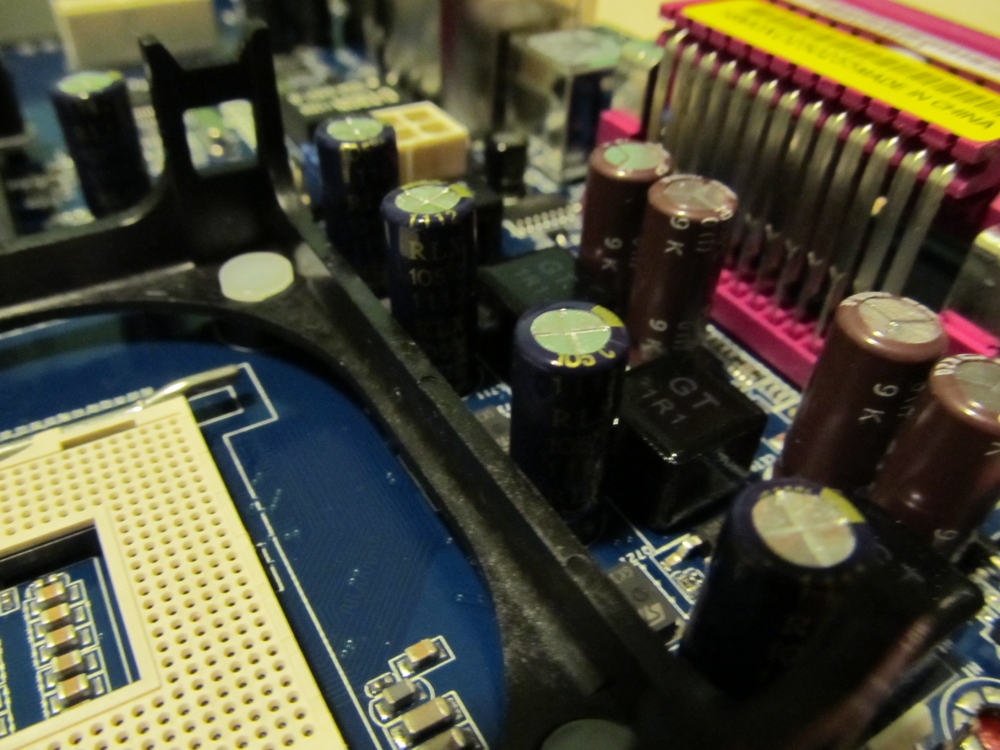

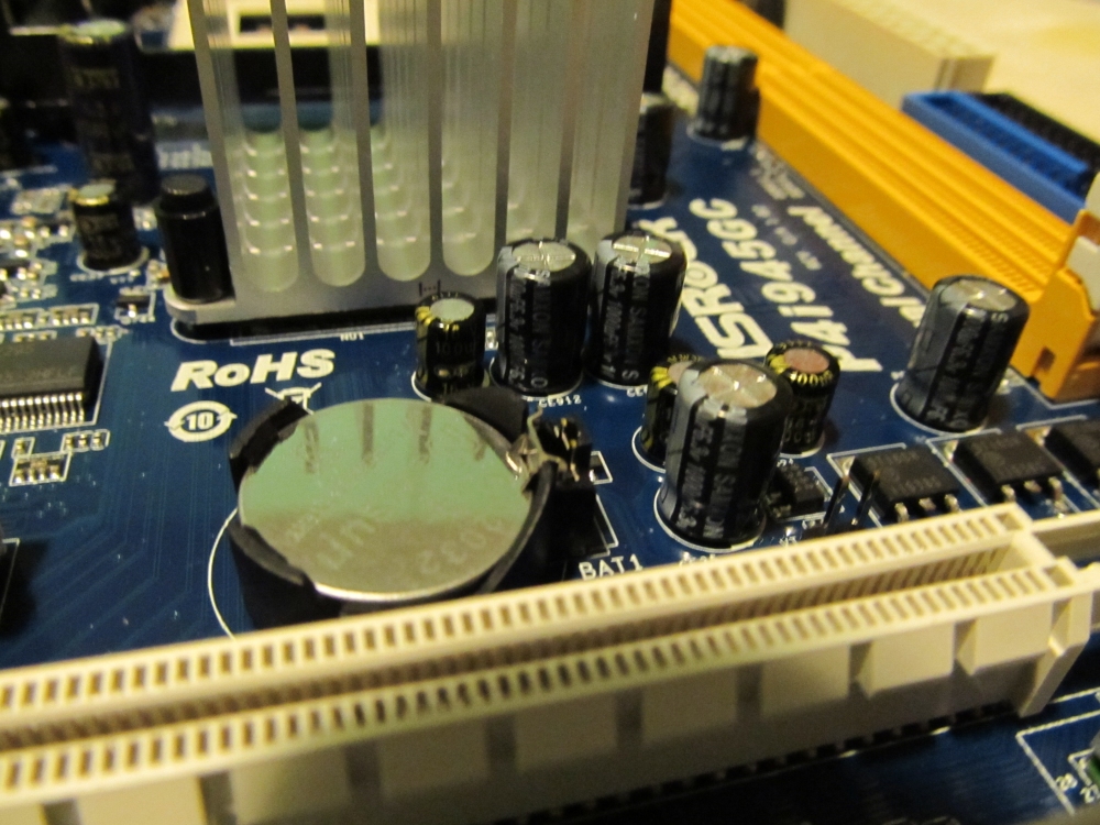

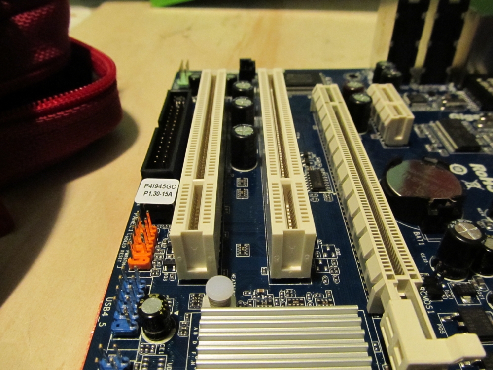

                                      Hi Scenic
                                      I will never by another Arock unless I have a gun pointed at my head!!!

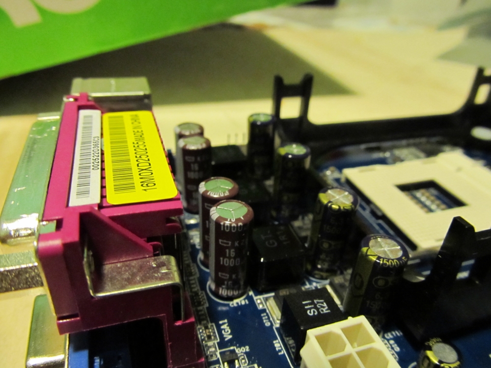

                                      The ECC Ram I bought work without problems... but in the MOBO manual is written they are not supported!!! !@#$%^&* why they list them on the qualified RAM??? Boh... I don't know. Anyway I read the RAM list to be sure to buy something working... as I bought them on line I wanted to buy something approved.
                                      The MOBO has different caps: OST Chemi-con and Samxon!!!
                                      I hope it will not give problems...
                                      My children are happy because it is more fast than Gigabyte MOBO.

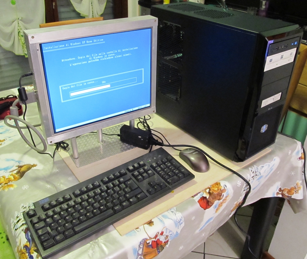

                                      I had a strange problem: I installed XP than the driver using the original CD and surprise... the Ethernet card was missing even if it was active in the BIOS setting.
                                      I had to re-install XP than I downloaded the LAN driver from Asrock's site and I installed it first... than the other drivers. I don't understand why they didn't put the LAN driver on the MOBO CD, at lest it doesn't appear on the installation menu.
                                      OK at the end the PC is working perfectly now, here some pics.

                                      P.S.: I forgot to write about CPU socket: it was not in the centre so I had to use another heat sink instead of the one mounted on Gigabyte. I was lucky to have one spare otherwise it would be a problem. But why it is not in the centre like most MOBO I have seen till today? Another Asrock stupid thing????

                                        OSTs aren't necessarily bad on those boards.
                                        My mom's ASRock 4Core Dual-VSTA (S775 ; AGP & PCIe, DDR & DDR2 ; Core 2 Duo support) which i mentioned in the "kill asus with fire" thread still has the original OST caps (VRM out and everywhere else), and it's been rock stable for over 2 years (with a mild CPU overclock from 1.6 to 2.13GHz (Celeron S420))
                                        It'll definitely work for a couple years. And i'm almost willing to bet the KZG's will fail first lol
                                        The off-center CPU socket is weird though. Almost looks like when they were designing the board, they wanted to put the retention module turned around by 90° from where it is now, but realized it won't fit or something
