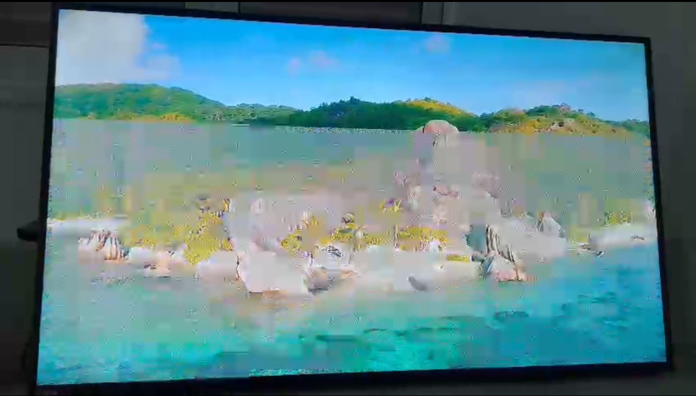

Toshiba 65S2650EV 65" TV What in your opinion the issue is ?
  • Ancient1
    • Dec 2019
    • 275
    • Israel
    Flickers at lower half (only? short vid. )
    Buyer drove 100km with it, after it goot a bump at the staircase.
    It was repaired "here" highly unusual and over 6 months long saga. ( I can give the link if you're interested )
    I used only VGA to check the display. He uses HDMI. ( told him to try VGA etc)

        Damn.. i don't understand if the tv after sale lasted some time with no faults, when he drove 100km? He hit the stair with the tv? i don't think this defect could be possible with a crack in the screen. It is possibile it depends by the original fault, maybe the damage was in both sides of the screen, i have here a tv with same type of issue and it has some bad lines on the left and one starting from right..sorry

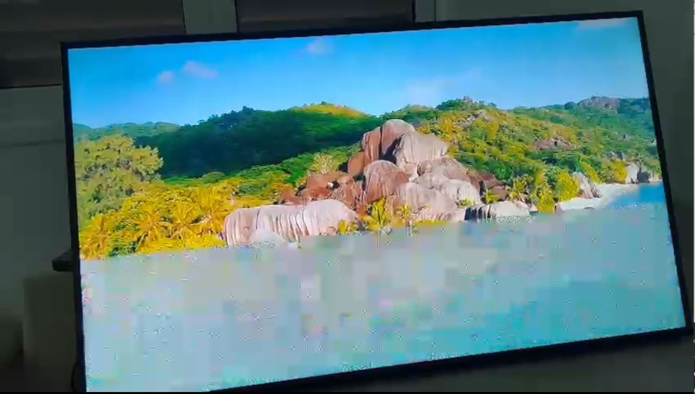

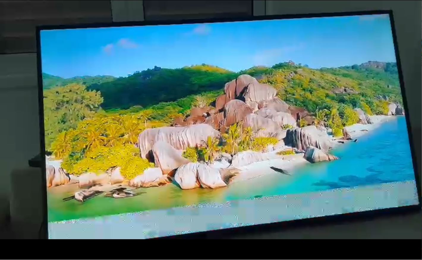

          I ran his video in slow motion, and captured the blips :
          They appear at 5s , 6s twice, and 10s. Note the 5s delay at first.. blips.. than about 5s delay.
          The Area of the white blip is not the same every time
          * I will ask him for longer and better resolution videos.
          So, Davi.p : The TV got a small bump. What/Where might the issue be ? I would like to know what are chances for a repair

                    Sorry but my english shakes... yes it is possible that that "bump" to the wall was fatal, might be inspected for cracked COF / Tab, or is possible the fault is the original one that showed up lately, i don't know how many hours tv runned before this fault, but surely it is a gate driver tab fault, ie side tab, no stories..

                      OK. So you say it is a side COF. I assume you mean the bonding, or cracked edge, not the plastic itself. And since we did work on Side Cofs, you think there is a small chance, but a chance nonetheless, it has been there before.
                      But how do you explain the blipping AREA ? which at one image is lower quarter and in another half the screen ? the cause is at a high point, near the board ?
                      • Davi.p
                        Hobbist Tech
                        • Sep 2009
                        • 4536
                        • Italy - Milan
                        Re: Toshiba 65S2650EV 65" TV What in your opinion the issue is ?
                        it is a bad cof chip or bad support,a dispersion that it causes disturbance in signal
