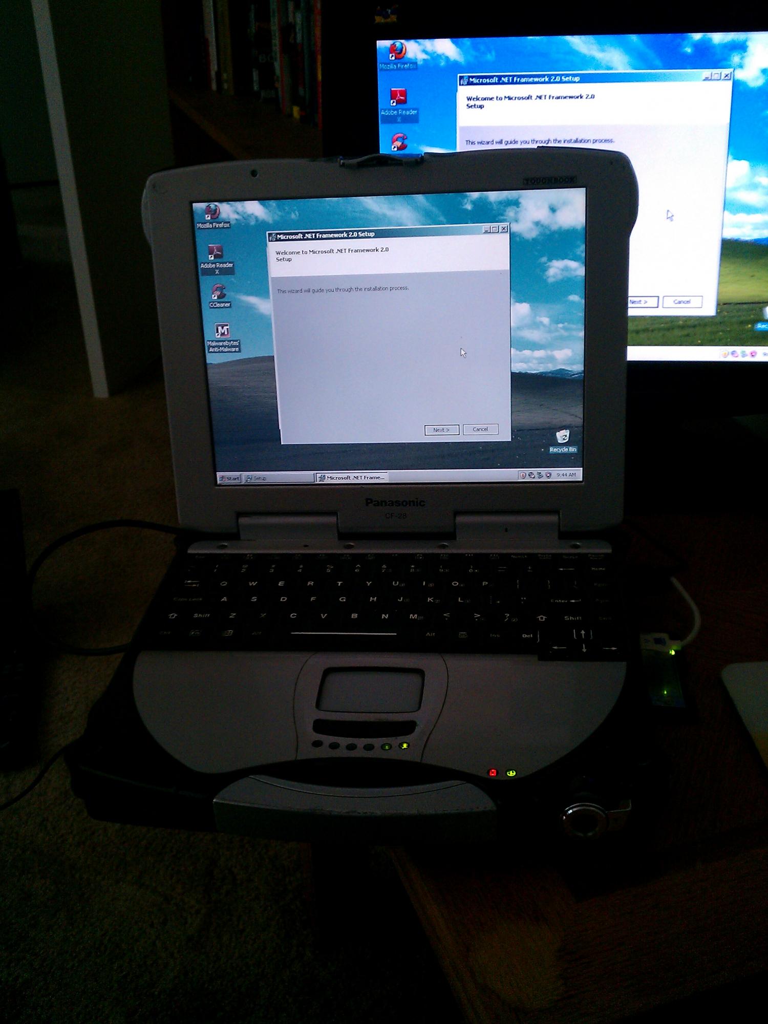

                  Alright, meanwhile here is my other issue.
                  The screen is like lacking in color and has too little blue and too much green. Or something like that. I'll show y'all a pic in a minute...any idea what's causing this?
                  Thanks.

                    Alright here's a pic:

                          EDIT: The screen issue sounds like it could be a CCFL problem. On an older laptop, that wouldn't surprise me, (depending on the usage it had before you got it). you'd probably have to replace the screen to fix it.

                            My guess is that the TFT wasn't that precise to begin with.

                              @c_hegge & dood: how would I test the backlight? thanks!
