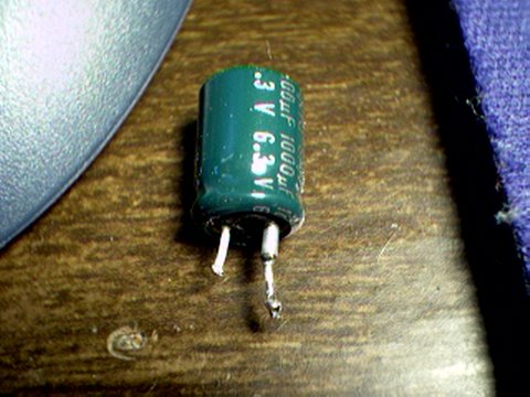

                          The patient is out of surgery and doing fine. It's been alive for 10 minutes and counting with no video glitches. I replaced the two Chemicons with Panasonic FM 6mm caps I hadn't realized I ordered, replaced the Nichicon HM's with Panasonic FM, replaced the OST and two of the Sanyos with Chemicon KY. One of the Chemicon KZE's appeared to indeed be bulging very slightly at the top.
                          Things did get interesting, especially when I got to the Sanyo caps near the northbridge. A picture is worth a thousand words in this case:
                          This one felt a bit loose to me even before I put the iron to it. I had to push on the lead from the underside with the iron to get this one out.
                          Nothing else of note happened really... I left the Ruby, the 820's, and the other Sanyos alone. Still a couple low value OST caps on there, but I'm leaving them be for now.
                              Looks like one of the leads is no longer attached to the foil inside.

                                Re: A Tale of Two Emachines Boards
                                Yep.
                                I should be more specific on the video - it looks like it loses vertical sync. On the old VGA, it looks like the video is there but rolling at a very high frequency.
