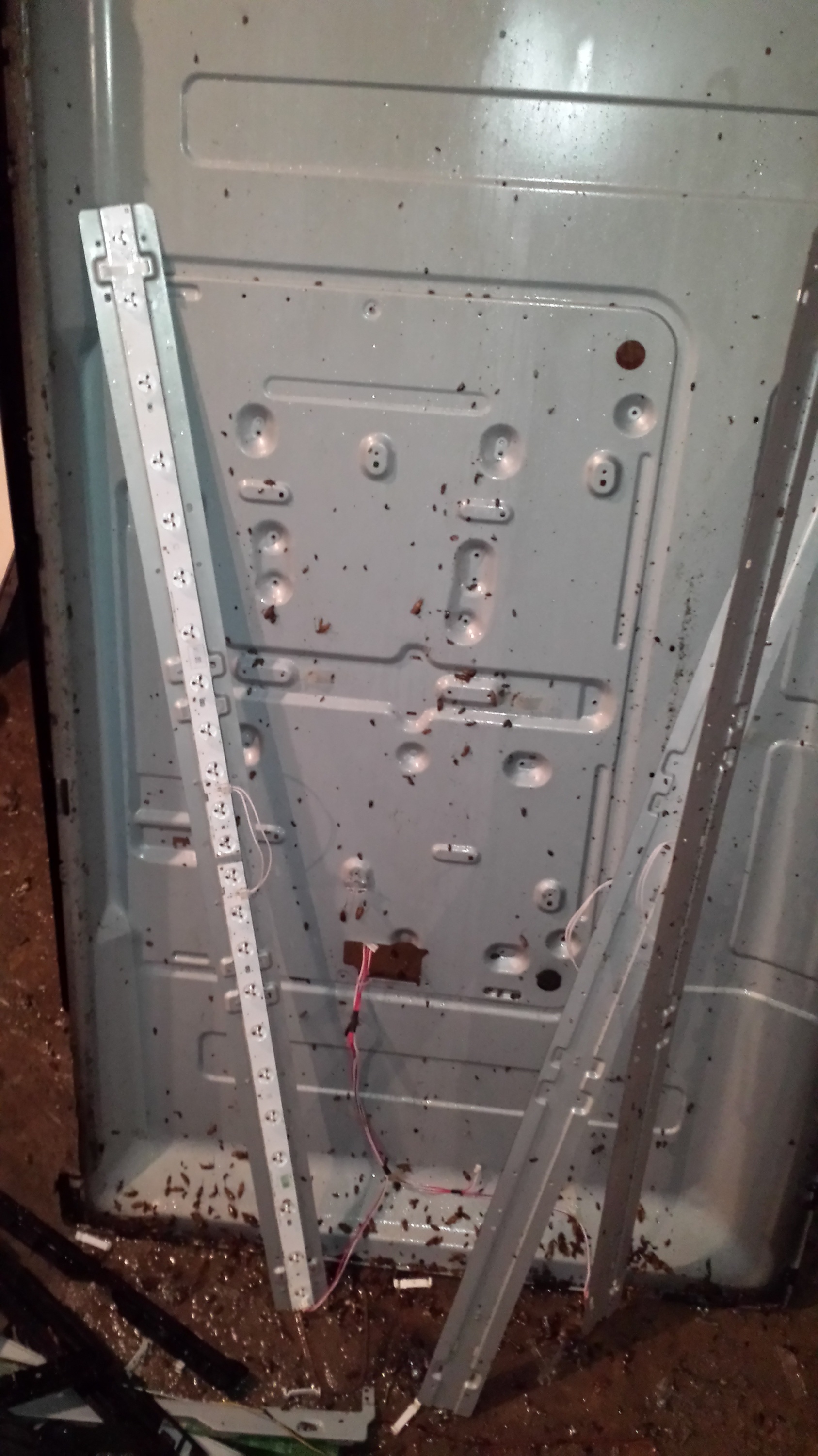

Cleaning Motherboards - ATTN SMOKERS!!
This is a sticky topic.
  • ph3d
    replied
    Re: Cleaning Motherboards - ATTN SMOKERS!!
    Originally posted by linuxguru
    Vaguely related - I just had an Acer desktop PC survive full immersion in silty river water for a period of 24+ hours in a recent flooding here. The machine had been disconnected and placed upright on a table, but still got immersed above the top of the cabinet. I retrieved it immediately after the water receded to ankle depth, and cleaned off all the exterior deposited mud and sludge within 48 hours of immersion, followed by drying in open sunlight for about 36 hours, followed by indoor drying for a full 3 weeks.
    I opened it for the first time about 2 days ago, and it wasn't too bad inside. A bit of dry silt was present on all upward facing surfaces, and I left it alone. Motherboard showed some light corrosion at the terminals of the CR2032 CMOS battery holder. I cleaned and replaced the battery - the submerged battery showed a terminal voltage of 1.72 volts. The fans were a bit sticky, but released quickly when gently rotated by hand. I removed the DDR2 DIMM, cleaned the contacts with IPA and reseated it. I left everything else alone.
    I powered it in on, in the hope of getting to the POST screen, but I was certain that the submerged HDD would not even spin up. To my surprise, the only error was the CMOS date/time reset, and after the date and time were set, the machine booted straight into Win7 and all data on the HDD is intact. This is a conventional rotating platter 320GB SATA HDD, not an SSD. It appears that all gaskets worked well and kept the water out, and the small hydrophobic membrane seal that allows air recirculation within the head/platter chamber also worked well and kept the water out.
    Other contributing factors are that it had been powered down and disconnected completely before immersion; it was immersed only to about 1 foot above the top of the cabinet (thus keeping the hydrostatic pressure fairly low); the cabinet was upright allowing the sediment to settle harmlessly mainly at the bottom of the cabinet; and the extended dry-out period of 3 weeks that I gave it before powering it on.
    In short, PCs from the last decade or so are far more durable that they're given credit for. For reference, the processor is a Core 2 Duo E5700 (Wolfdale-2M), the board is an Acer G31T-M5 v1.0, and the HDD seems to be a Seagate. Capacitors are mostly Sanyo and Rubycon, with a sprinkling of small Teapos at the audio and I/O locations. No electrolytic has bulged in about 4.5 years of normal household use.
    The LCD monitor that came with it is also electrically functional, but the screen/polarizer has purple internal splotches all over due to the ingress of water. Maybe the splotches will diminish over time as the water evaporates - we'll see. The DVD-R/W drive is likely to be dead, but I haven't checked it yet - it's a relatively minor expense.
    Amazing what they can stand up to given a good time to dry out!
    Leave a comment:
  • ph3d
    replied
    Re: Cleaning Motherboards - ATTN SMOKERS!!
    wow amazing the amount of crap that came off that - nice job!
    Leave a comment:
  • linuxguru
    replied
    Re: Cleaning Motherboards - ATTN SMOKERS!!
    Vaguely related - I just had an Acer desktop PC survive full immersion in silty river water for a period of 24+ hours in a recent flooding here. The machine had been disconnected and placed upright on a table, but still got immersed above the top of the cabinet. I retrieved it immediately after the water receded to ankle depth, and cleaned off all the exterior deposited mud and sludge within 48 hours of immersion, followed by drying in open sunlight for about 36 hours, followed by indoor drying for a full 3 weeks.
    I opened it for the first time about 2 days ago, and it wasn't too bad inside. A bit of dry silt was present on all upward facing surfaces, and I left it alone. Motherboard showed some light corrosion at the terminals of the CR2032 CMOS battery holder. I cleaned and replaced the battery - the submerged battery showed a terminal voltage of 1.72 volts. The fans were a bit sticky, but released quickly when gently rotated by hand. I removed the DDR2 DIMM, cleaned the contacts with IPA and reseated it. I left everything else alone.
    I powered it in on, in the hope of getting to the POST screen, but I was certain that the submerged HDD would not even spin up. To my surprise, the only error was the CMOS date/time reset, and after the date and time were set, the machine booted straight into Win7 and all data on the HDD is intact. This is a conventional rotating platter 320GB SATA HDD, not an SSD. It appears that all gaskets worked well and kept the water out, and the small hydrophobic membrane seal that allows air recirculation within the head/platter chamber also worked well and kept the water out.
    Other contributing factors are that it had been powered down and disconnected completely before immersion; it was immersed only to about 1 foot above the top of the cabinet (thus keeping the hydrostatic pressure fairly low); the cabinet was upright allowing the sediment to settle harmlessly mainly at the bottom of the cabinet; and the extended dry-out period of 3 weeks that I gave it before powering it on.
    In short, PCs from the last decade or so are far more durable that they're given credit for. For reference, the processor is a Core 2 Duo E5700 (Wolfdale-2M), the board is an Acer G31T-M5 v1.0, and the HDD seems to be a Seagate. Capacitors are mostly Sanyo and Rubycon, with a sprinkling of small Teapos at the audio and I/O locations. No electrolytic has bulged in about 4.5 years of normal household use.
    The LCD monitor that came with it is also electrically functional, but the screen/polarizer has purple internal splotches all over due to the ingress of water. Maybe the splotches will diminish over time as the water evaporates - we'll see. The DVD-R/W drive is likely to be dead, but I haven't checked it yet - it's a relatively minor expense.
    Leave a comment:
  • trebo
    replied
    Re: Cleaning Motherboards - ATTN SMOKERS!!
    OMG
    Leave a comment:
  • lookimback
    replied
    Re: Cleaning Motherboards - ATTN SMOKERS!!
    Biohazard computer!
    I'll take mice over roaches anyday. This was my nightmare last week.
    Leave a comment:
  • lookimback
    replied
    Re: Cleaning Motherboards - ATTN SMOKERS!!
    I always get a bunch of mice in the fall. I honestly don't like killing anything, but they leave me no choice. I just keep a bunch of traps set. Peanut butter works best for bait.
    Leave a comment:
  • RJARRRPCGP
    replied
    Re: Cleaning Motherboards - ATTN SMOKERS!!
    Biohazard computer!
    https://www.youtube.com/watch?v=7rG7T3ezHuQ
    Leave a comment:
    replied
    Re: Cleaning Motherboards - ATTN SMOKERS!!
    if you want to check for a mouse, just put a few sunflower seeds down and see if they disappear.
    mice and other small fluffy things go wild over sunflower seeds.
    Leave a comment:
  • RJARRRPCGP
    replied
    Re: Cleaning Motherboards - ATTN SMOKERS!!
    Sadly, American hantavirus isn't just some hooey being spewed.....
    So I get suspicious real fast if I see anything that looks like a mouse turd!!!!!
    I lately have been finding a lot of suspicious pellets, I have possible signs of mouse trespassing!
    Not a good sign when I see black pellets.
    But, there's good news, no suspicious pellets detected on any counter, kitchen shelf or cabinet.
    And the home provider didn't freak out about any ripped food packages.
    No one detected any rips in a potato bag or onion bag.
    My allium seed package wasn't torn open.
    Last edited by RJARRRPCGP; 09-15-2015, 04:33 PM.
    Leave a comment:
  • lookimback
    replied
    Re: Cleaning Motherboards - ATTN SMOKERS!!
    I'll give it a try then. I've had this thing for about a year already. Thought I was going to need an ultrasonic cleaner for it.
    Leave a comment:
    replied
    Re: Cleaning Motherboards - ATTN SMOKERS!!
    if you bake it dry using a fan heater or hair dryer it should be o.k.
    Leave a comment:
  • lookimback
    replied
    Re: Cleaning Motherboards - ATTN SMOKERS!!
    I have a TV which was in a house fire. It powers on and works fine, but the screen is scratched to hell. I was going to part it out but when I opened it I found every board to be covered with soot. Would this cleaning method be OK on the power supply too? My concern would be water inside the transformer windings.
    Leave a comment:
    replied
    Re: Cleaning Motherboards - ATTN SMOKERS!!
    exactly - they are nothing new because they have been around forever.
    except the "new " ones!!!!
    those are the ones i dont trust.
    Leave a comment:
  • ratdude747
    replied
    Re: Cleaning Motherboards - ATTN SMOKERS!!
    Originally posted by stj
    that virus sounds like a lab mistake.
    i'm always suspicious of "new" diseases that only effect humans.
    And why is that? Species specific diseases are nothing new or unusual...
    Leave a comment:
  • RJARRRPCGP
    replied
    Re: Cleaning Motherboards - ATTN SMOKERS!!
    H5N2 also looks like nothing!
    H7N7 also looks like nothing!
    Last edited by RJARRRPCGP; 08-30-2015, 07:23 AM.
    Leave a comment:
    replied
    Re: Cleaning Motherboards - ATTN SMOKERS!!
    that virus sounds like a lab mistake.
    i'm always suspicious of "new" diseases that only effect humans.
    Leave a comment:
  • RJARRRPCGP
    replied
    Re: Cleaning Motherboards - ATTN SMOKERS!!
    American hantavirus reminds me of this:
    https://en.wikipedia.org/wiki/File:1...imsStLouis.jpg
    Leave a comment:
  • RJARRRPCGP
    replied
    Re: Cleaning Motherboards - ATTN SMOKERS!!
    Originally posted by stj
    i dont know if your joking, but most viruses cant survive long outside of the body.
    so if your host is long gone i wouldnt worry about it.
    You're actually majorly lucky you're in Europe! Strains of hantaviruses that cause HCPS don't exist! You'll just get HFRS.
    Sin-Nombre and the like wasn't found in Europe.
    Getting the American version of hantavirus is like getting influenza in the late-1910s and early-1920s!
    Many die! Possibly dead people commonly hauled in ambulances!
    H1N1 is nothing!
    Last edited by RJARRRPCGP; 08-29-2015, 02:04 PM.
    Leave a comment:
  • ratdude747
    replied
    Re: Cleaning Motherboards - ATTN SMOKERS!!
    Originally posted by stj
    i dont know if your joking, but most viruses cant survive long outside of the body.
    so if your host is long gone i wouldnt worry about it.
    Sadly, he isn't joking...
    https://en.wikipedia.org/wiki/Hantavirus
    Leave a comment:
    replied
    Re: Cleaning Motherboards - ATTN SMOKERS!!
    i dont know if your joking, but most viruses cant survive long outside of the body.
    so if your host is long gone i wouldnt worry about it.
    Leave a comment:
  • m1ch43lzm
    by m1ch43lzm
    05-12-2025, 08:37 PM
  • howardc64
    by howardc64
    07-24-2025, 05:17 PM
  • howardc64
    by howardc64
    Problem
    08-04-2024, 10:36 PM
  • Hakuu
    by Hakuu
    Hi There,
    More Details
    TV Model - LG OLED77G1PUA
    07-12-2023, 02:37 PM
