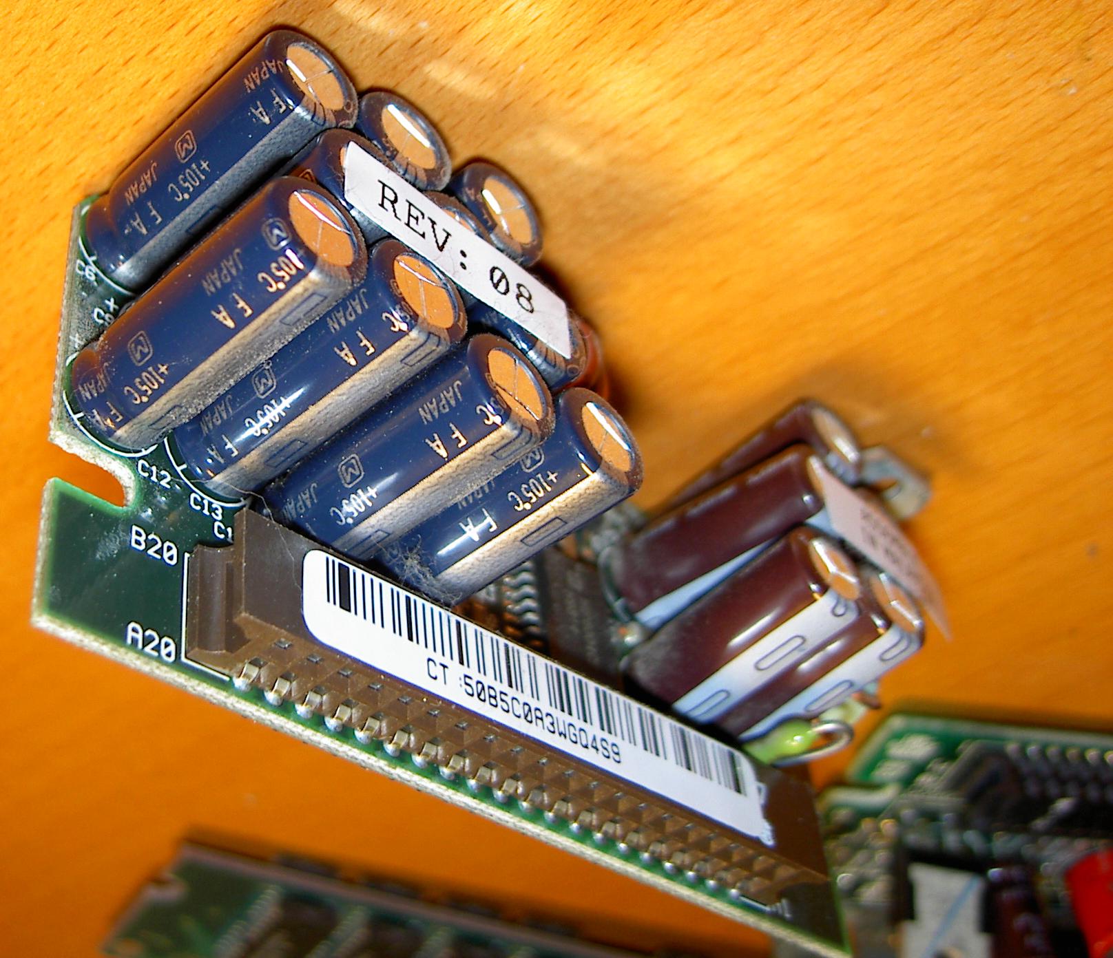

      This would be a VRM, on it are Mosfets and Capacitors... However when speaking of the VRM on a mainboard that does not feature a "Voltage Regulation Module" but instead everything integrated it is still the same parts talked about, i.e. the Mosfets and Capacitors used for filtering current and reducing or increasing the voltage for whatever device needing it, most commonly the CPU but also memory and add in cards...
      Last edited by Per Hansson; 05-11-2014, 08:26 AM. Reason: Offsite images uploaded due to problems with host

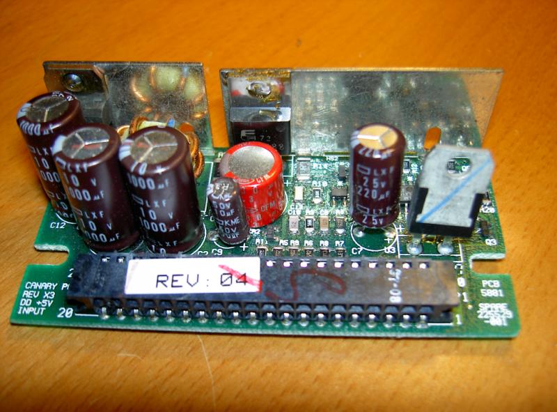

                      • Per Hansson
                        • Jul 2005
                        • 5895
                        • Sweden
                        Re: Vrm
                        Originally posted by Topcat
                        last time I actually saw a "VRM' as a module, it was a dual P-Pro board, about in 1998.
                        Yea, the pic of the VRM I posted was from a Proliant 800 dual PPro 200mhz Socket 8 server...
                        I've got two such servers, but only three processors... So if anyone happen to sit on a VRM and a 200mhz 256kb SL22T CPU that would fit this system I would be happy to take it off your hands... Of course it could use some more memory too, only two 32mb ECC 168 pin unbuffered DIMM's in it now...

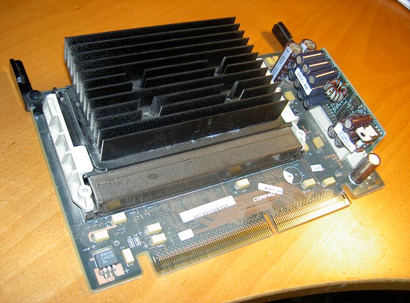

                        • Per Hansson
                          • Jul 2005
                          • 5895
                          • Sweden
                          Re: Vrm
                          More VRM goodness, this one from a Dual PPro 333mhz Proliant 3000 server, showing the whole processor board, processor and VRM... Dunno what type of caps are on the left side of the VRM, they just have an "M" for their name...
                          Last edited by Per Hansson; 05-11-2014, 08:27 AM. Reason: Offsite images uploaded due to problems with host
                          • linuxguru
                            • Apr 2005
                            • 1564
                            Re: Vrm
                            Panasonic, with the T-vent. 'M' for Matsushita, owner of the Panasonic brand.
                            • Per Hansson
                              • Jul 2005
                              • 5895
                              • Sweden
                              Re: Vrm
                              Thnx man... Was just curious what they where because I know they would be high quality since that is all that I expect from Proliant servers... This quote from the good caps thread:
                              Panasonic FC. Note the T vent marking which is exclusive to panasonic. Note the M character in a box which indicates Matsushita the parent company of the panasonic brand. Note the navy colour, they also come in black, note the gold negative stripe which is on both colours. Note the FC after the +105oC which indicates they are FC range. There is also FA series which is better but FC series is excellent for motherboard applications and general availability is good.
