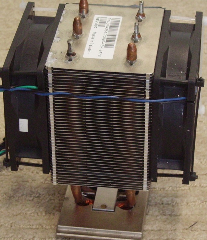

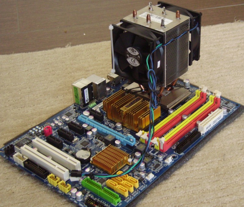

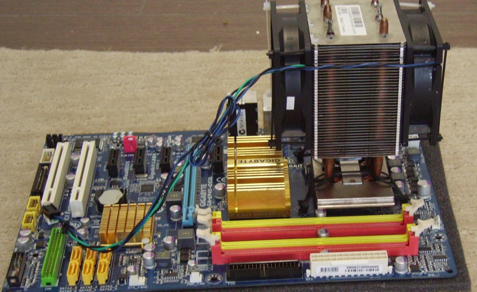

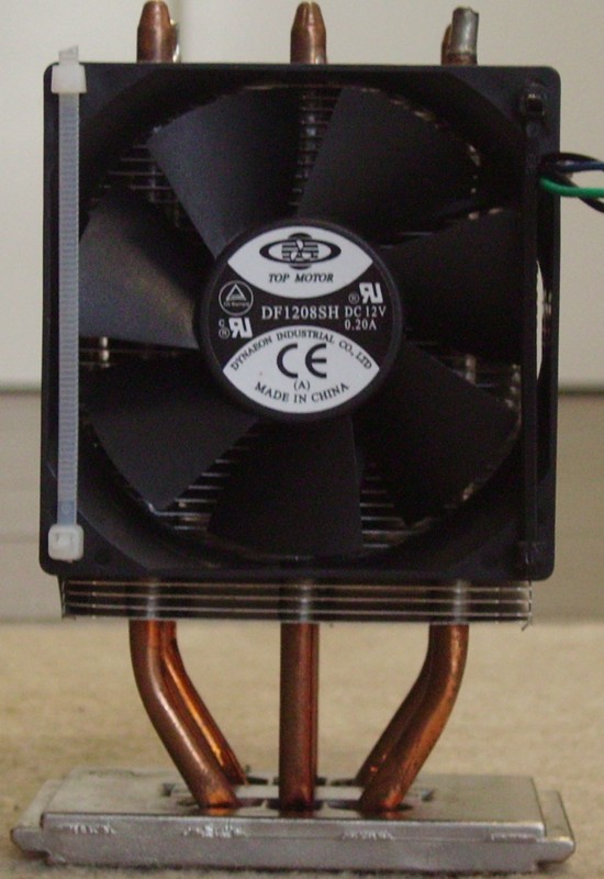

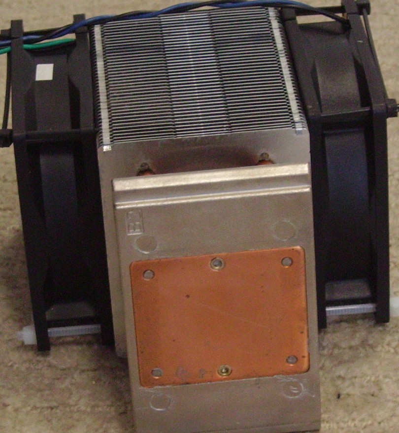

    A few days ago, my boss aquired a Dell Dimension PC (can't remember the model). The case was falling apart and the motherboard was faulty, so we decided to scavenge parts out of it. I got the CPU heatsink since there's no way of mounting it to a motherboard or a fan to it, or so I thought. I was able to use zip ties to hold everything together, so here it is.
    btw, does anyone know whether top motor fans are any good, as I have at least 20 of them in my collection.

    I REALLY wouldn't use zip ties on a cooler - no springing to press the cooler onto the CPU.

        fail. very bad idea. sounds like a good way to pan-fry a cpu.

          OK, will swap it back. I've been using it for the last month or so and the idle temp of my OC'd CPU is only about 40C or so (without either of the fans running). I thought it would be fine as long as you do them up tight enough

            I use these same dell coolers on my supermicro x6dal-g. Turns out the heatsink retention bracket for a socket 603/604 intel fits these coolers perfectly, and a 754/939/AM2/AM3 heatsink retention bracket fits the two little clips at either end perfectly.

              It's an Intel CPU. These don't fail when overheated like AMDs do. I've seen clips snap on coolers in other PCs and it only contacts it in one corner. The CPU was fine after replacing the cooler, the PC would just shut off about 5 secs after power on.

                            I swapped it with a CM TX3. It's a bit better since it uses 92mm fans instead of 80mm. I replaced the original CoolerMaster fan with an identical pair of AVC fans I found in my collection and used the old temperature controllers. The cool thing is, though that the TX3 also came with an AM2/939 clip and the base of the old dell heatsink fits perfectly, so it should be fine for Socket AM2.
