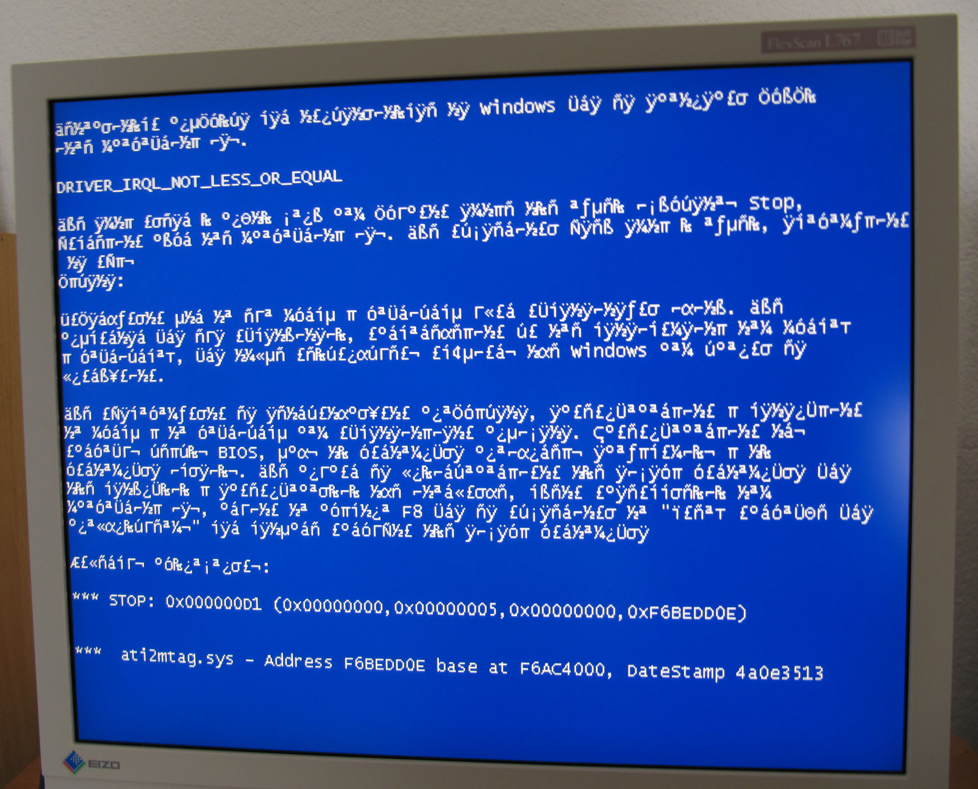

          I attach a common blue screen I get while I watch TV with the Hauppauge unreliable bundled software: bsod
          On the other side, I forgot to mention the computer is dual boot, it has XP and Windows 7. I tried windows media center today in win 7 and it recognized the TV card correctly and then it worked like a charm

                that for sure is a video card driver error. the ati driver is the one causing the BSOD. see if there are newer ones from asus available. either that or u might have to roll back.

                  Only one driver is available at asus site for that 4650 agp card... It's the same that came with the CD.

                          This bug check is tied to a Read failure, IRQ=5, memory address=000.
                          Time for new drivers... this is a coding problem.
                          The executing code went out in the weeds and tried to read low memory.
                          Not allowed.
                          Skip the ASUS drivers... go directly to the ATi site and download their latest drivers. The board vendors are always behind the times...
                            I have read somewhere in this forum that it's not easy to install ATI drivers on Asus graphics cards because they change the card's bios...
                            About the bsod, I found yesterday that if I change the mpeg-4 decoder from Arcsoft to Cyberlink, then I get no bsod. But Cyberlink decoder has its own issues with that crappy software..

                                  that's not possible. rhd is only for pci-e. the manufacturers hardmod the chip for agp. the drivers won't work no matter what. i've tried, its stupid and you feel stupid after spending forever trying to get it to work.
