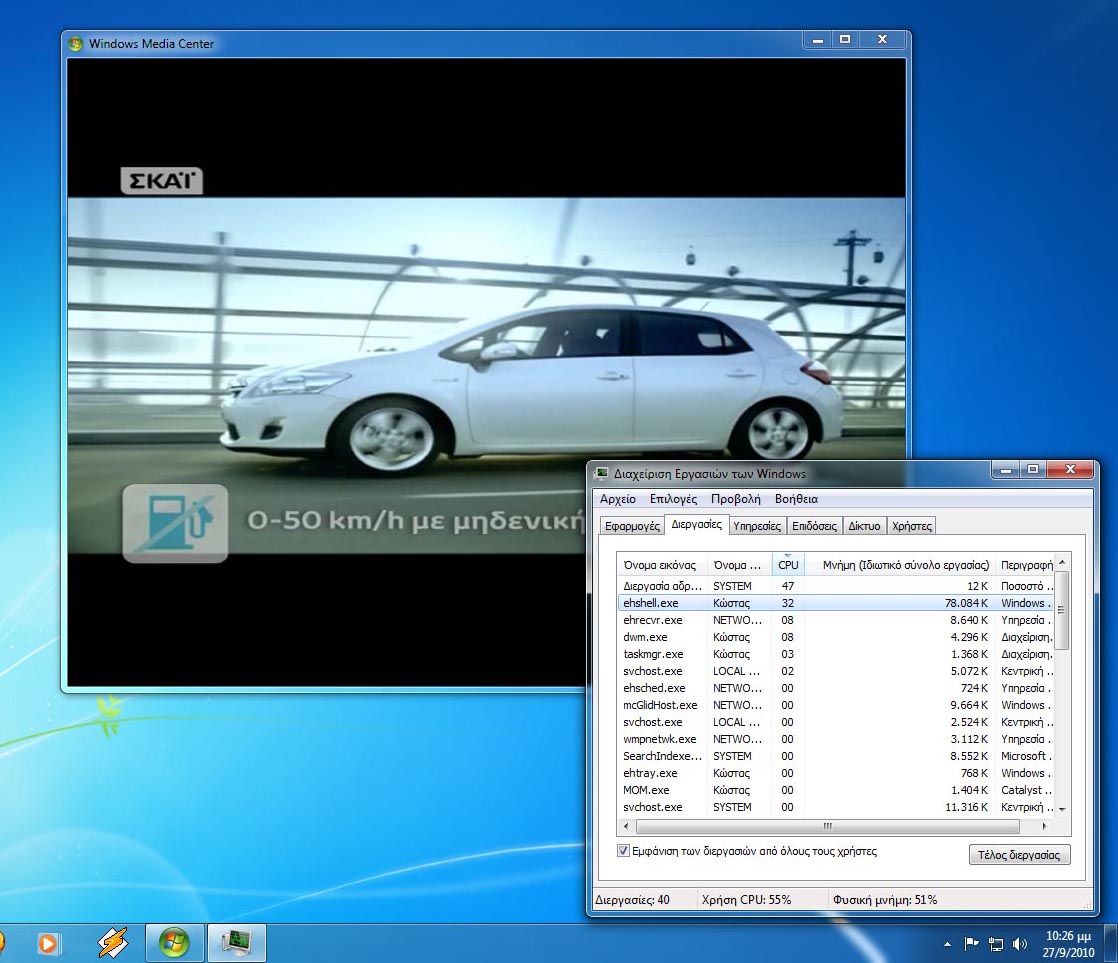

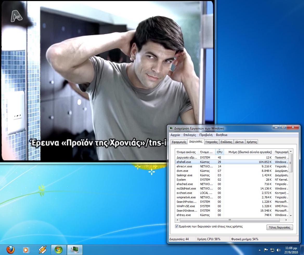

      I'm not sure if you'll get any hardware acceleration from your card. I get hardware acceleration on my setup because my HD tuner has the ATI theater chip and I have an ATI card (XFX 4850). The easiest way to see is to check your CPU usage while you're watching live HD. If it's super low (~3% for me) then you know your graphics card is doing most of the work.
      Hi! I am not able to test my card with live HD TV because we don't have any HD shows here yet.
      Most dvb-t channels here broadcast MPEG-4 H.264, but SD resolution.
      The total CPU usage varies between 50% and 60%. I don't know what service belongs to the dvb-t decoder, so I attach 2 screenshots of the task manager.
      Given that this is a slow computer (Athlon XP 2200+, 1GB DDR 355MHZ, ATI HD4650 AGP) and I am running Windows 7, do you think hardware acceleration is enabled?

        i doubt it. hauppauge hvr 1250-1300 series all use soft-drivers for the mpeg encoder feed. even on my modern system its roughly 10% for qam, so with hd dvb-t i would expect even more.
