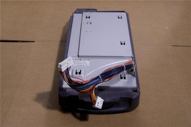

        This link: http://images04.olx.in/ui/2/63/29/34675429_1.jpg is the power supply that is on the 650, and I can get the plastic shroud off the front, but the sides don't want to budge. I don't want to cavemen them off.

          I think the plastic casing slides off, but I do not have any experience with these. Then you remove the screws. See if you can find a picture of one to see how it attaches. I saw one on Amazon without the plastic casing.

              Toasty: I did end up getting the case open on the PSU. It slid off with some force...more like a quick rap of my fist. Although there are a few larger Nichicons in there, they appear to be in good working order.

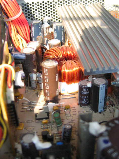

                      Well, if the Rubys are small ones, they're okay. Ltec & Nichicon have to go. If you can post a few shots of the insides too, that would be great.

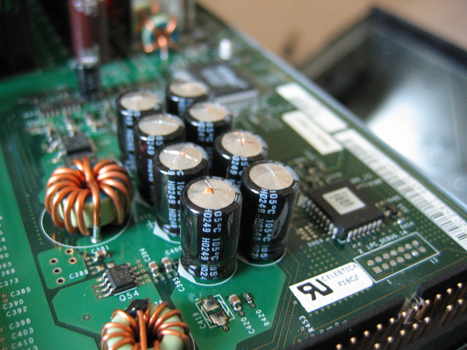

                        Here's a pic of my original motherboard with a bank of blown Nichi's as well as the inside of the PSU (there's a Ruby just below the heat sink lower right and one at the very back by the vent):

                          The Nichicon PW's are a one-for-one direct swap. Still in production. Were not in the bad caps series that I recall seeing. It's just that there were some Nichicon series that were crappy from that time frame, up until late 2005. It's really your call to replace them or not. Do replace the Ltecs. Use PW's for those replacements too.
                          Of course, you can always kick it up a notch and go with Panasonic FM's.
                          The NCC/UCC KY's are fine and the Ruby YXG are probably fine too.
