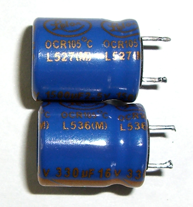

    Lelon OCR
    Can someone please tell me if this craps are indeed polymer?
    They are from my JetWay AGP 939P mobo.
    Any info is greatly appreciated…
  • japlytic
    • Oct 2005
    • 2086
    Re: Lelon OCR
    The Lelon website says the OCR series are polymer units, but they are normally with a clear sleeve with the series, voltage and capacitance on the top.
    Could the blue units in the picture be fakes?
    • User
      • May 2007
      • 36
      Re: Lelon OCR
      I recapped this mobo not too long ago, and what is interesting is that the CPU VRM in is at only 330uF and VRM out 1500uF 2.5v witch by spec might suggest perhaps they are?
      If so, did I make a mistake by using lytics with the same capacitance?

        Re: Lelon OCR
        when replacing lytics with polymers its OK to go down in capacitance somewhat.
        the other way around it's an absolute no-go to go with the same or lower capacitance.
        however.. that's on VRM input. my gigabyte s775 boards i've got here all have relatively low total capacitance on VRM in. most of them have 4x 330 - 470uF 16V for in, and 9x (or even more) 820uF 2,5V for VRM out. (all polymer)

          Re: Lelon OCR
          I should have paid more attention..
          It's very surprising how well it works even with mistake like that.

            Re: Lelon OCR
            I'm gonna order Nichicon LE Digi-Key part# 493-3061-ND to replace 1500uF 2.5 v and for 330uF 16v the only thing I found was 493-3718-ND.
            Any one used these before?

              Re: Lelon OCR
              Sorry. If I'd known thet these were on the board BEFORE I recommended rubycon lytics, I would have advised differently, but all you mentioned in the first post (https://www.badcaps.net/forum/showthread.php?t=8747) was sacon FZ. I had no idea that there were polys on the board until after you had re-capped it.
              • User
                • May 2007
                • 36
                Re: Lelon OCR
                No problem, the fault was my own.
                Ruby caps will be reused in my other projects, so don't feel so bad

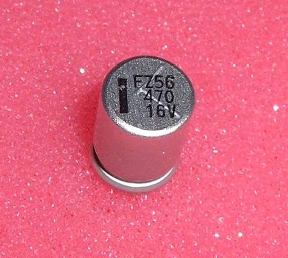

                  Re: Lelon OCR
                  The 470uF 16v are Sacon FZ. JetWay used poly for CPU only the rest were all lytics.
