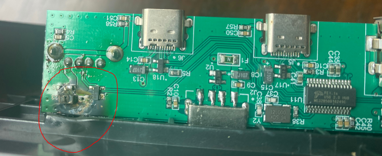

    J107 Tantalum cap burning inside a USB hub?
    I have a USB hub specifically to fit in my car. It stopped working and i saw a burned J107 capacitor (see picture). It looks like it might have briefly caught fire as you can see the plastic under the capacitor deformed. It was hot enough that the other side (outside of the plastic box) also melted a little.
    I'm curious - does anyone know what might cause a cap like this to catch on fire like that? Is it just a random manufacturing defect that can happen to anyone, or was there a design issue with the USB hub?
    Also, does anyone know if these can burn hot enough to actually ignite a fire? I.e., was all that was ever going to happen was the melted case, or was there a possibility of something more serious?
    The hub is plugged into the car 24/7, and likely it burned while unattended. So in case the manufacturer replaces it under warranty I wanted to know if there are any safety concerns with having something like this always plugged in?

    Re: J107 Tantelum cap burning inside a USB hub?
    Oops for some reason the photo didnt post in the original, I'm attaching the photo again.

      Re: J107 Tantalum cap burning inside a USB hub?
      yes it's possible to get hot enough to catch fire, likely it's due to manufacturer defect whether it's a bad capacitor or an improperly assembled PCB. MLC and tantalum capacitors are known to go up in smoke.
      Whether there's enough stuff around it to fuel the fire is the question whether it goes beyond the device. Most electronics stuff are housed in plastic that's made self extinguishing for this reason.
        • 31209
        100uf 6.3v???
        bastards!!!
        thats under-rated for a tantalum - you really need a 16v part there.
        letter code "C"
          Ahhh interesting, so the USB is a 5V power supply, and the J107 is a 6.3 volt cap?
          So do you think there wasn't enough voltage margin for spikes that may have caused this failure?

            • 31209
            exactly.
            you need some headspace with tantalums because overvoltage or reverse-polarity will make them burn.
              Tantalum caps can fail that way. Circa 1997, after a burning tantalum cap led to a large computer center being shut down (and a VERY POed customer!), Sun Microsystems banned tantalum caps from all new designs and required a partial redesign of then-current equipment.
              At another former employer (Brandt Electronics, now defunct I think) I saw several times a burnt tantalum cap damage a DC-DC power module so badly that the module has to be scrapped. There, too, the company designed tantalum caps out of that product line.

                • 31209
                it is rare though,
                apple and sgi used to pack there boards with tants and you never heard of a fire in one.
                  Ooow that could have been very nasty :-(
                  Maybe put a switch and fuse in series with the +12v input, so you can turn it off.
                  Im happy it didn't take your car with it :-D
                        The problem is that when it occurred, I wasn't in the car. The car is constantly powering the USB port to record data to a dashcam, so even if there was a switch on it -- most likely the failure happened when I wasn't there to notice it.
                        Hopefully the manufacturer put the appropriate fire-resist/self extinguishing plastic around the USB hub. (Maybe they did since the plastic only melted and didn't fully catch fire).
