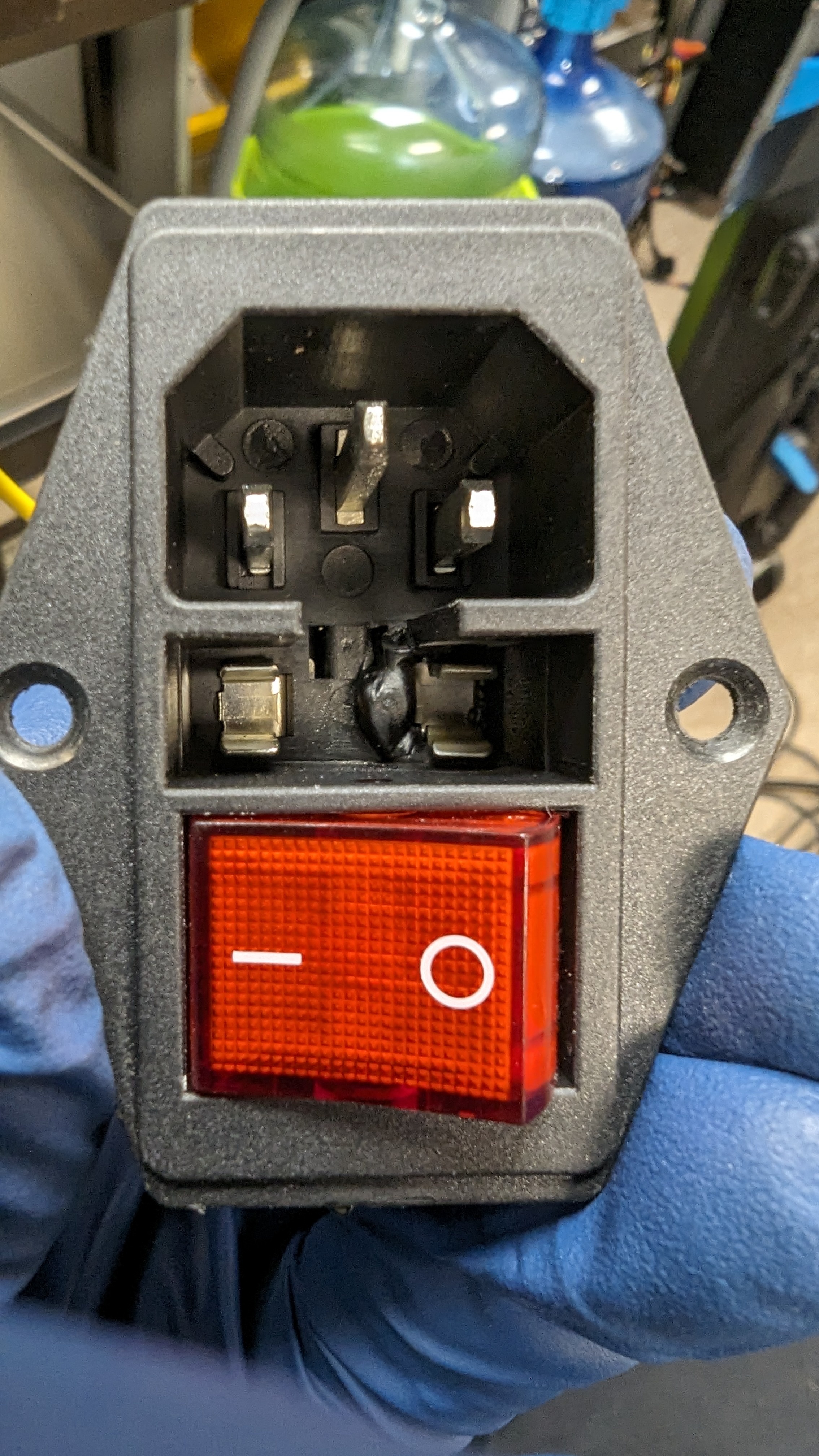

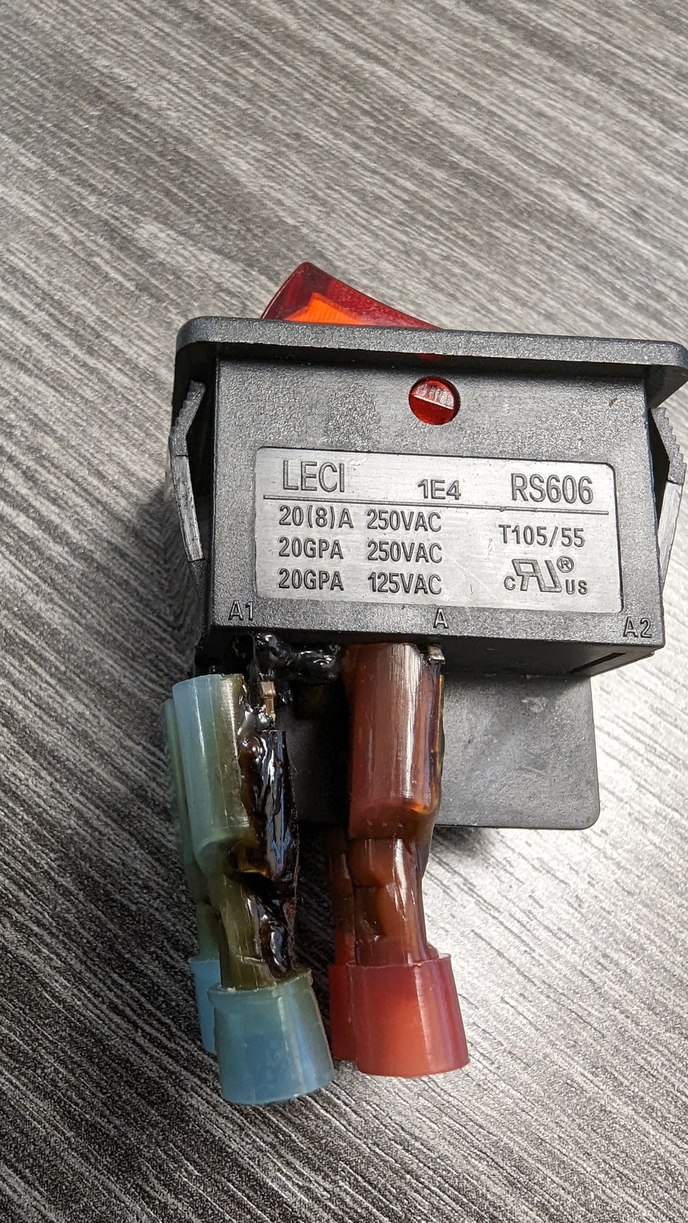

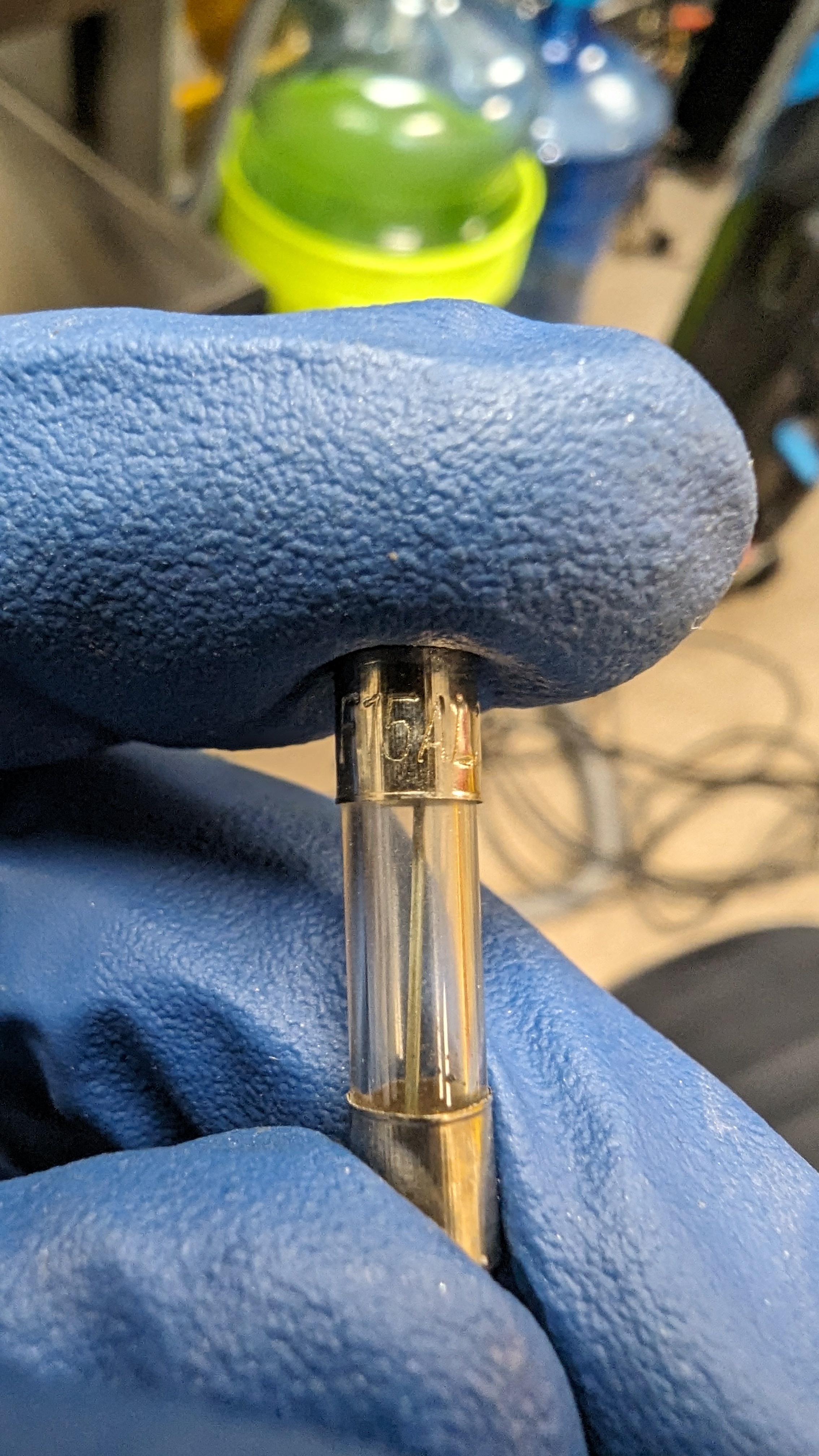

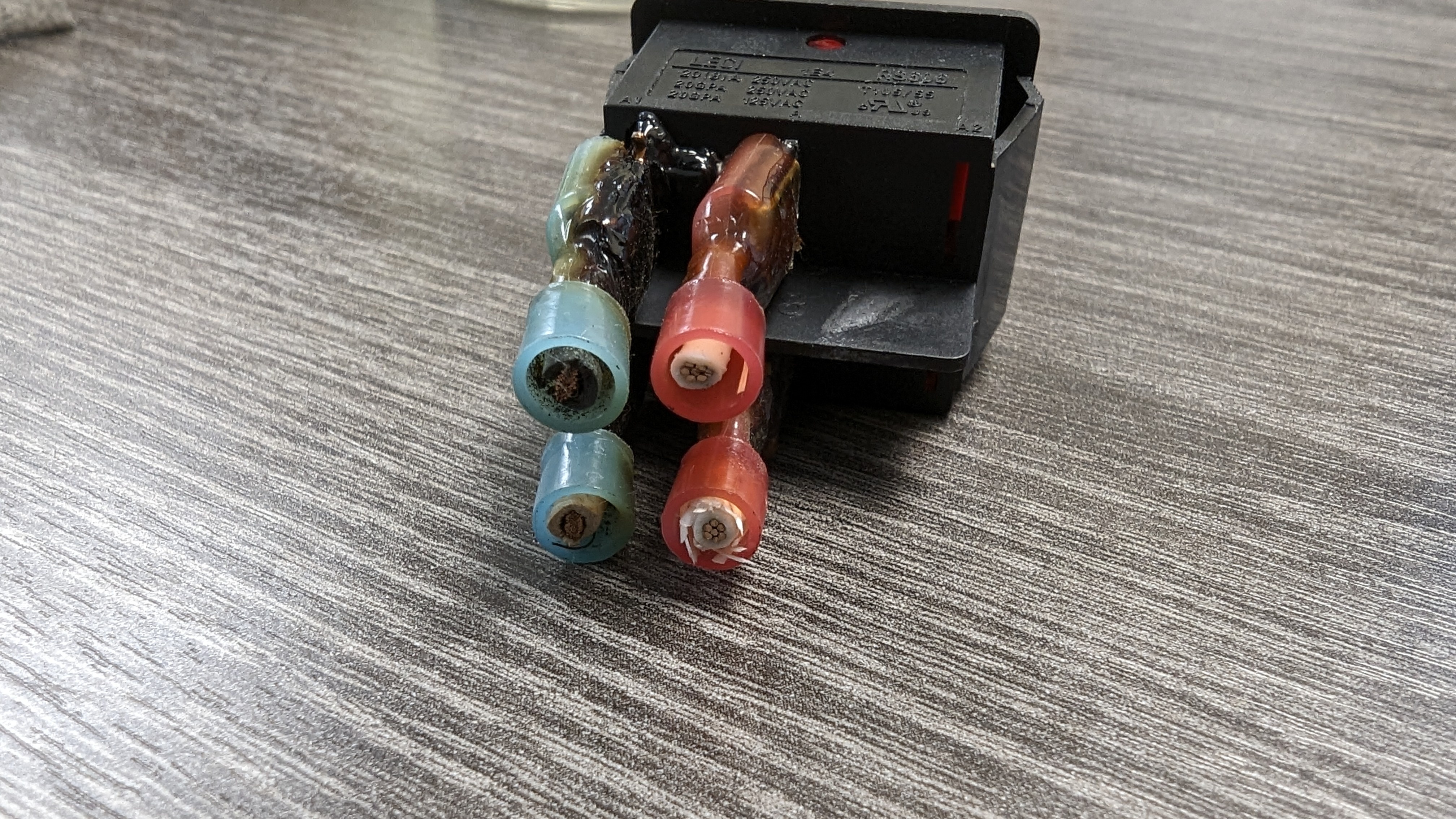

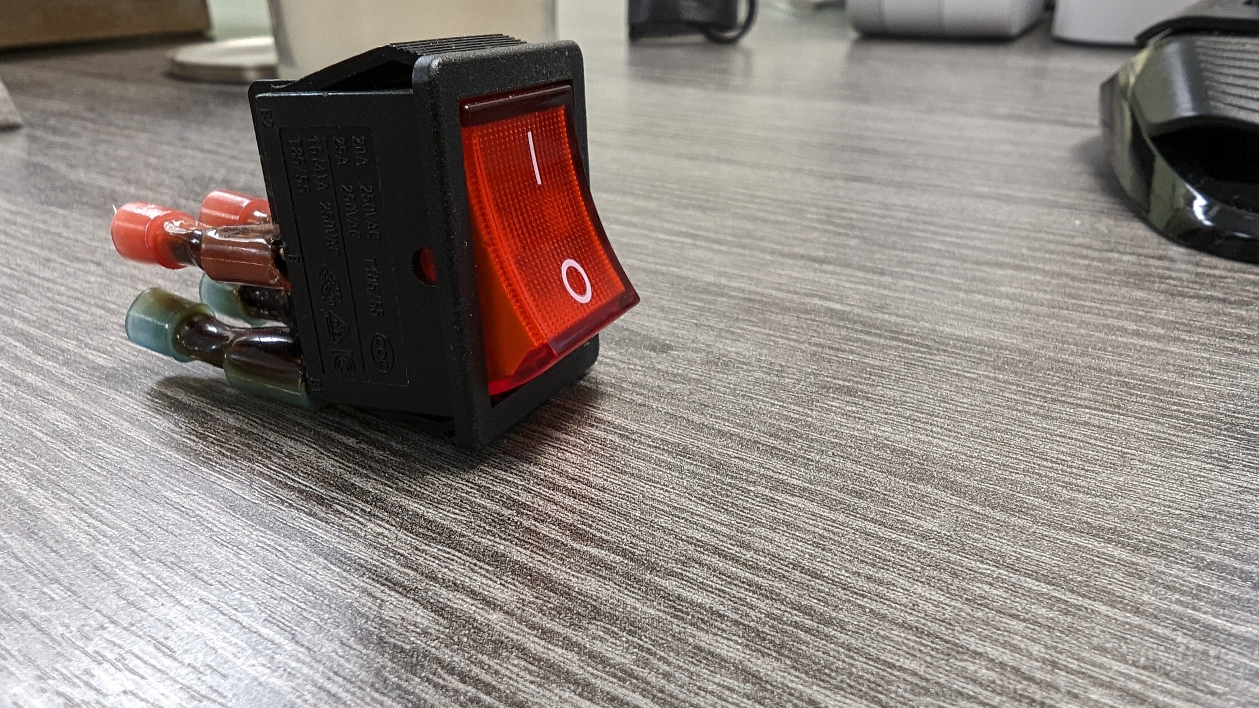

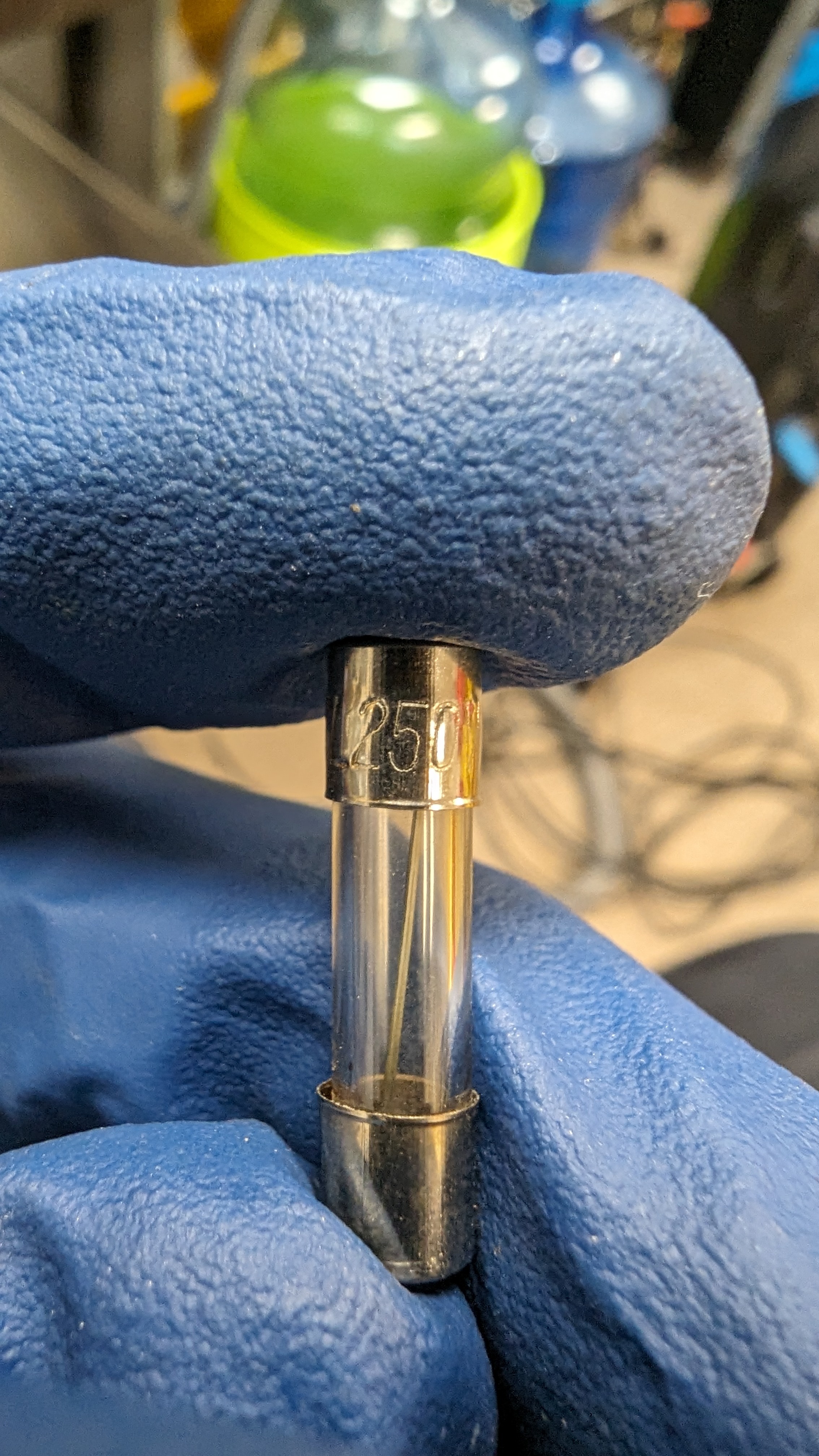

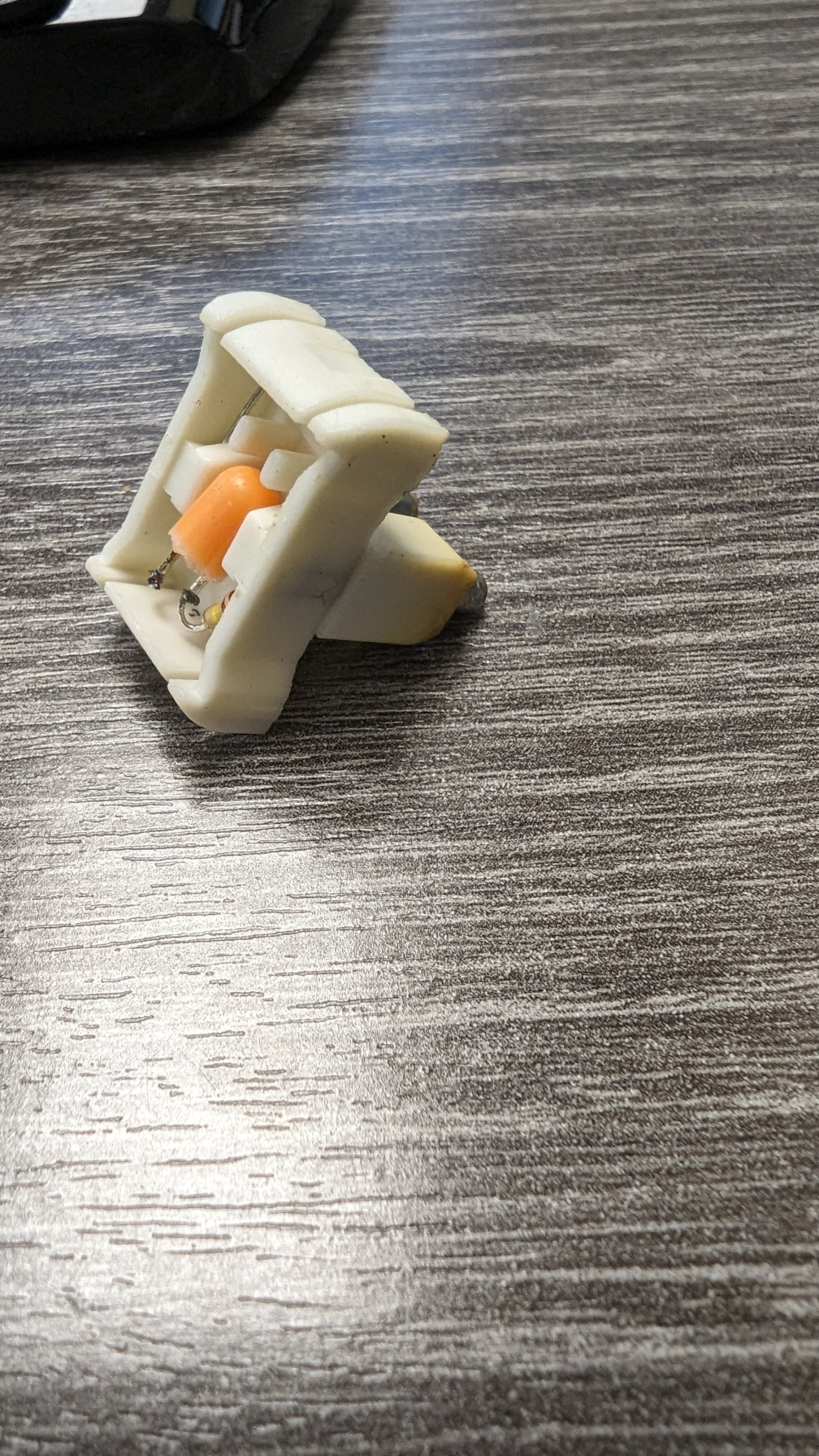

    So, my VEVOR ultrasonic cleaner switch melted.
    I contacted VEVOR, they sent me a new one after almost a month of back-and-forth messages.
    Over the past few months, I've also replaced switches on heat presses (from various brands) with similar failures. What caught my attention is that the switches are always rated for 10 amps, but the fuses are always for 15 amps. this mismatch?
    I've started to second-guess my knowledge. Everything I've researched says exactly what's happening to these switches.
    This issue hits far too close to home. I'm concerned that so many devices out there might share this same potential fire hazard. Vevor seems well aware of the problem, judging by their quick association of a "burning smell" with the switch failure.
    Is there a reason for the rating mismatch?​

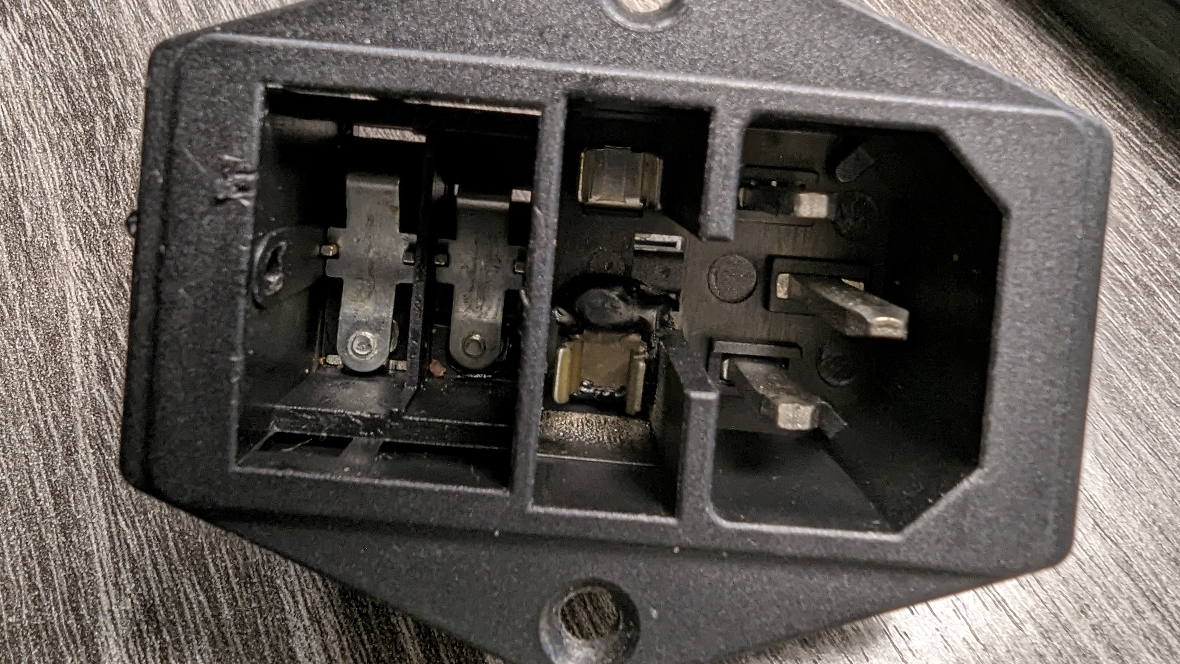

        oh - just looked at the picture.
        so it's not the switch burning - it's the fuse holder clips.
        well - like i said, 20mm is only rated for 10A - infact most are only rated upto 6.3A

          The entry module has no North American safety approvals, like UL/CSA. Better ones use copper, not aluminium. So it's junky part in the first place. The fuseholder jaws need to be thicker for high current. Same for the IEC power cord.
          Second, I would say the failure could be due to the unit having a terrible (capacitive) power factor or ultrasonic ripple currents if the primary cap is fading away.
          Nobody needs 15A (fuse) worth of ultrasonic that I know of. It might be missing an inrush NTC or just has very high mains current peaks that will overstress components.
          Post more pictures, most important is that a shorted power mosfet does clear the fuse and not burn up something else.

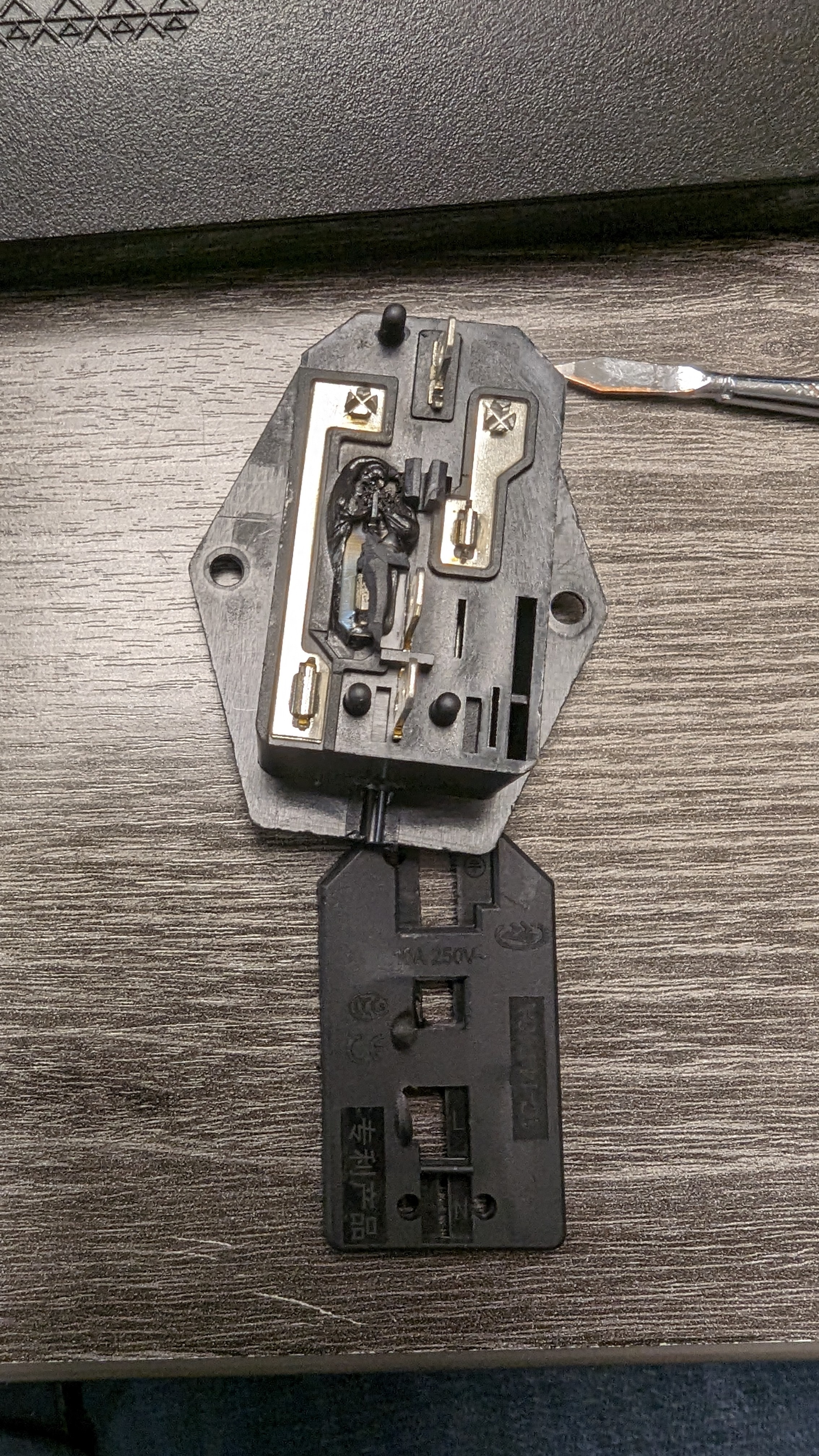

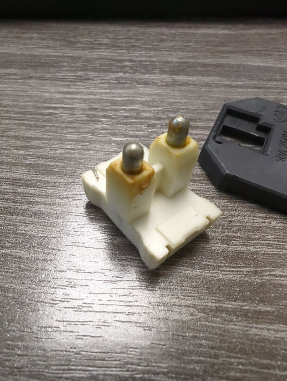

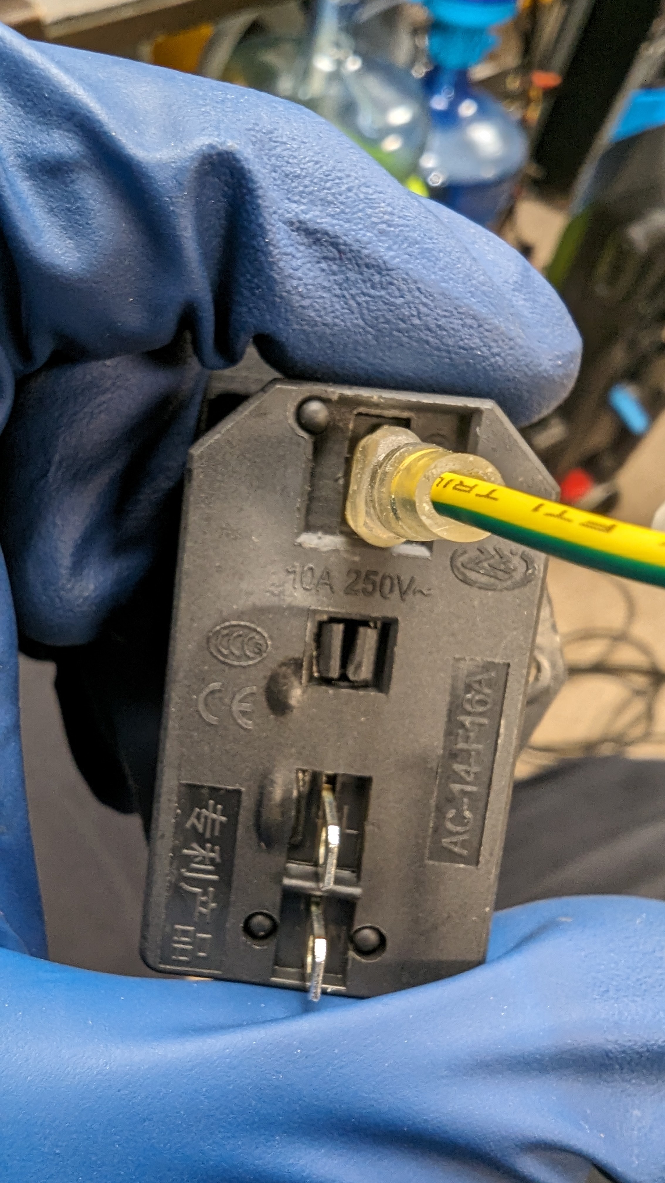

            The switch assembly taken apart...

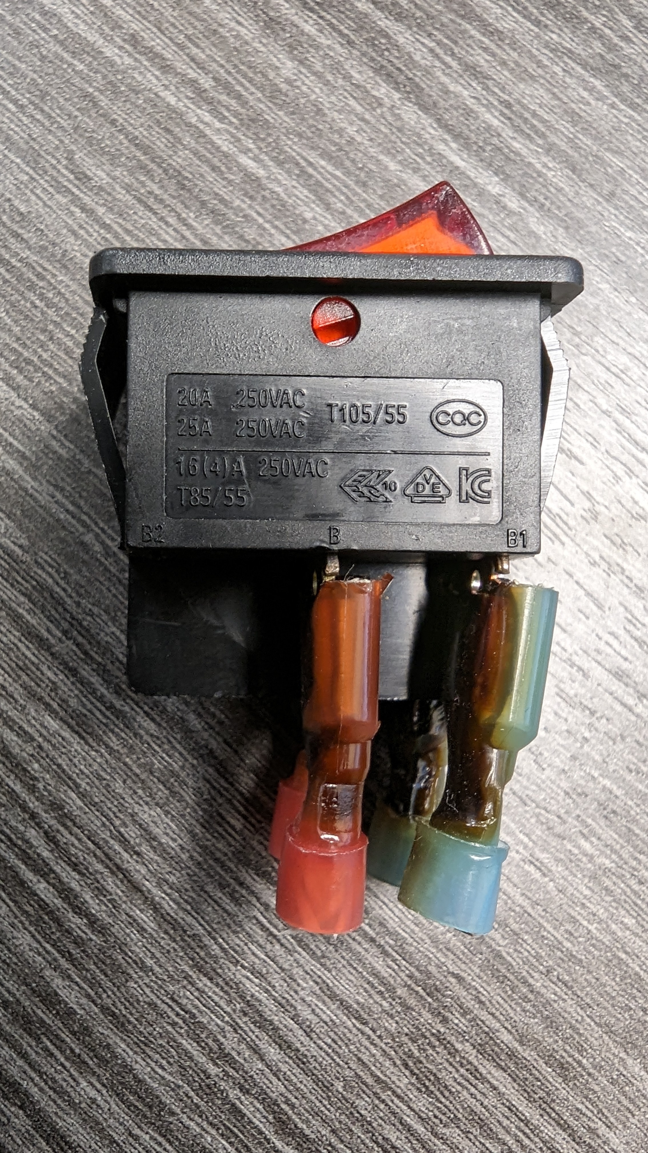

              Here's another switch that I replaced recently.

                • 31277
                so the bus bar linking the fuse holder to the switch failed,, maybe soldering those bars will help.
                still, your overloading the unit and the design is fine.
                IEC cables are mostly rated to 10A, 20mm fuses officially only go to 10A because they arent long enough to break a high current arc
                dont blame the chinese if you melt it by going 50% above the rating.
                blame them for fitting it maybe, but i'm not sure there is another way unless they use a seperate 32mm fuse holder

                    My last post was a switch from a heat press rated at 16A with a 15A fuse. While the configuration was built with tolerance in mind the switch assembly failed which is what I'm seeing quite frequently.

                        Eniaro, spade connector's limit is 16A and even then they must fit perfect. They look a bit off size.
                        Pic related- the switch, common from china is to have very large holes and notches on the tabs which lowers contact area.
                        What happens is the spade connector and the crimp has resistance and generates heat. The switch also makes heat due to contact resistance. It can be too much and once things melt a bit, it gets worse. The two have be right.
                        Also in OP the fuse holders going to the busbar are super thin, I have bought 10A or 20A fuse clips like Littelfuse 100 Series and they are much thicker than pictured.
                        Still curious about OP's ultrasonic cleaner. I'll bet it has no PFC and huge mains caps to give high peak input currents.
                        The average current can be low but high peaks can make an appliance strangely eat connectors, switches. Or the original part is just junk.

                            my advice - for now.
                            remove the interconnector strips and fit a seperate 32mm fuseholder with a 15A CERAMIC fuse.
                            the switch is o.k.
                            and the C14 is working to it's limits but we will overlook that unless/until it cooks - then you can use a C20 style inlet & cable.
                            it's got nothing to do with quality, i keep trying to point out that 2 out of 3 of the parts on the panel are NOT rated for 15A and never will be regardless of what brand you buy.

                                    I'd get a new IEC entry module - the old one the compression rivets on the busbar likely junk too, that might have been the poor connection that started it all.
                                    Check the power cord IEC end did not melt too and it is as stj says it all should be rated for higher current. 1,400W 120VAC is almost 12A.
                                    That UK section 18 baloney I thought is funny - if I could I would be raiding the garbage bins over there. Somebody should let Vevor know.
                                    The ground wire "overheating" it only has to take current long enough for the breaker to trip, if there is a ground fault.
                                    One product I designed and submitted for approvals, the certifier put 15A through the ground for an hour and checked temps... their assumption is at 15.0A the mains breaker trips but at 14.99A it doesn't.
