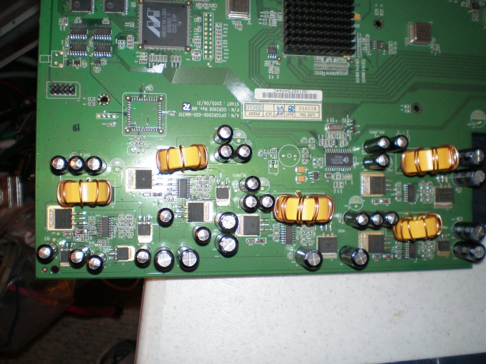

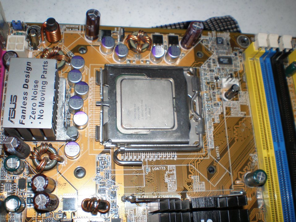

    this came into work, dead, we kept it, and I want to try to fix it
    http://paullinebarger.net/files/Pc160235.jpg
    soot and some terrible 4v 680 OST's. can anyone hook me up with some solids? me love u long time
    Asus P5GDC

        yeah I've re-capped before, have nice variable temp weller iron. what else do I need?
        you mean the computer? oh i'm a tech, I have everything and more

          what a weird looking thing, it looks like it's coming from 70s...
          that chemicon kzg looks bulged to(?)
          as for polymers...
          perhaps
          https://www.badcaps.net/store/produc...products_id=77
          if they're working at 2.5v or less(but don't get these if you don't know for sure about the operating voltage)
          or this if higher voltage is required
          https://www.badcaps.net/store/produc...products_id=79
          OR perhaps
          http://stores.ebay.com/PC-MotherBoar...34Q2ec0Q2em322
          dunno what polymers kc has and is he willing to sell...

            Re: Help and Isotope out
            they're 680uf 4v
            really I found some nichicon solids: PLE0G681MDO1
            I can actualy get them at the local mouser hq, but I have to be a business to do it (according to a guy I know that works there). I might be able to get the company I work for to get 10 of them, unless tc can get them here, or somewhere else for a better price
            http://www.mouser.com/Search/Product...7-PLE0G681MDO1
            • i4004
              • Oct 2006
              • 2029
              >they're 680uf 4v
              i know they are, but vrm is probably working on less than 4v voltage ergo 2.5v perhaps would fit...
              and capacitance a bit up or down won't change much.
              offcourse if you can get exact replacements, get them, by all means.

                well you can say words like 'probably' but going down in voltage might not be a good idea cause I don't exactly have the circuit design from Asus, so I can't just guess
                yeah I know you can vary the capicatance a little bit, but I would rather go up slightly then down slightly
                hey TC can you get these for me? maybe you can make these a pre-made kit for the p5gtc deluxe, you usually get discounts for larger orders.
                  if it boots at all, you could measure the voltage on those caps...then you'll know.
                  if it doesn't boot, turning it on could be hazardous.
                  in that case somebody who has working board could be able to tell you, but by judging interest for this thread not that many people have/have worked with this board.
                  then again, thread is misnamed, and misplaced...there is asus subforum here...
                  send topcat a PM, perhaps he didn't see this thread..or perhaps he doesn't do such one-off deals...
                    use these.
                    change out the kzg's too.
                    https://www.badcaps.net/store/produc...products_id=78
                    the 820@2.5 are too tall with some hsf.

                        I have some 16/1200 rubys to replace the KZG'S
                        I'm still not sure i'm comfortable with replacing 680's with 560', little too close for comfort for me

                          From the look of those OST's they aren't even poly's. The general rule of thumb when replacing with poly's is 1/2 the capacitance, bulk capacitance isn't really needed in the VRM, what matters is ESR, which poly's have extremely low ESR.

                                  well, thank you for the 10 polys TC, but i'm declaring this one fail. I should of known better with all that charring next to the VRM. Power light comes on but it dosen't even turn on, switched out the clear jumper and still nothing at all. it was worth a try though
                                  hey TC how come these caps have shorter leads then i'd expect? I've gotten other caps before and they usually have much longer leads and one lead longer indicating polarity (which is indicated by the big ass painted half of the cap anyways).

                                      btw thats dirt not char.
                                      recheck your work.
                                      the polys you got were prepped for an insertion machine.
                                      its an ordering option from sanyo.
