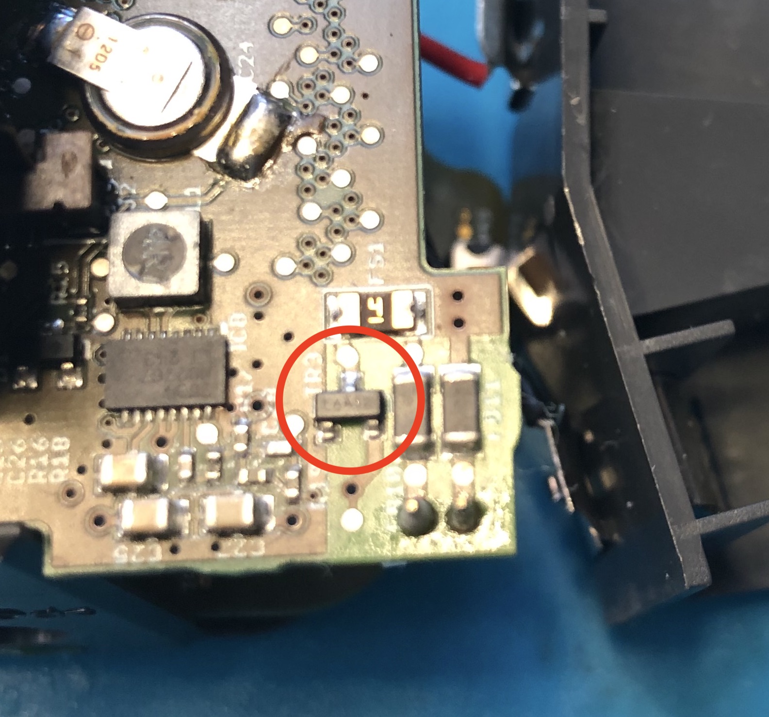

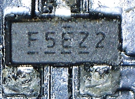

          OK. I got the Fluke back and took it apart again. The part is marked FAAS2 with underlined letters. The PCB indicates it as TR03. Here is an image of the part in question. Just want to see about replacing it but I can't figure out what it is. MOSFET?
          https://www.dropbox.com/sh/c2pnfqmn4...T9uDWloHa?dl=0[IMG]
            Re: Need help identifying component FAAS2
            Can you use GO ADVANCED and attach good clear focused pictures of the whole board and in the area where this TR03 is located
            What Voltage testing have you done on the board and on each pin of that TR03?

                  Attached is a photo of the PCB and component location circled in red. It is in series right after the "fuse" from what I can tell. 3.3v comes from the battery source to the J connector. I will post voltage measurements shortly.
                    • 31009
                    is there only one on the board??
                    because if there is another then an option is to lift it and put it in a component tester to see what it is.

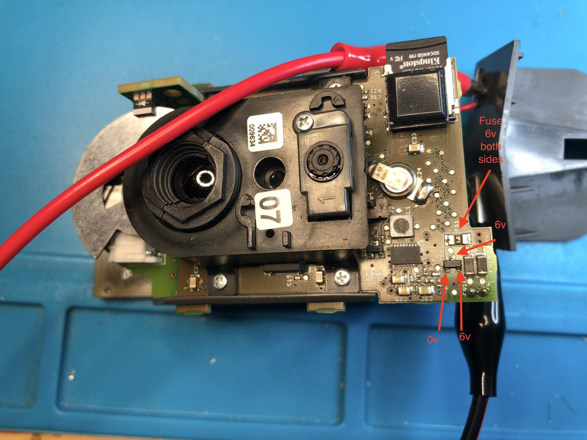

                      Here's a better photo of the PCB and the component in question. The unit is powered by (4) AAA batteries. I have 6v at the J connector & both sides of the fuse. I have 6v at the top pin, 0v on the lower left pin & 6v on the lower right pin.
                          From the looks of the layout, That looks to be P-CH MOSFET, the Drain pin is connected to the fuse which is fed by the 6V source, the Source pin is the Output which you do have 6V.
                          See if the Voltage on the Gate pin toggle between 0V and 6v or so when power switch is toggle.
                          You can also check the Voltages on the caps on the board to see if they have Voltages on them.
