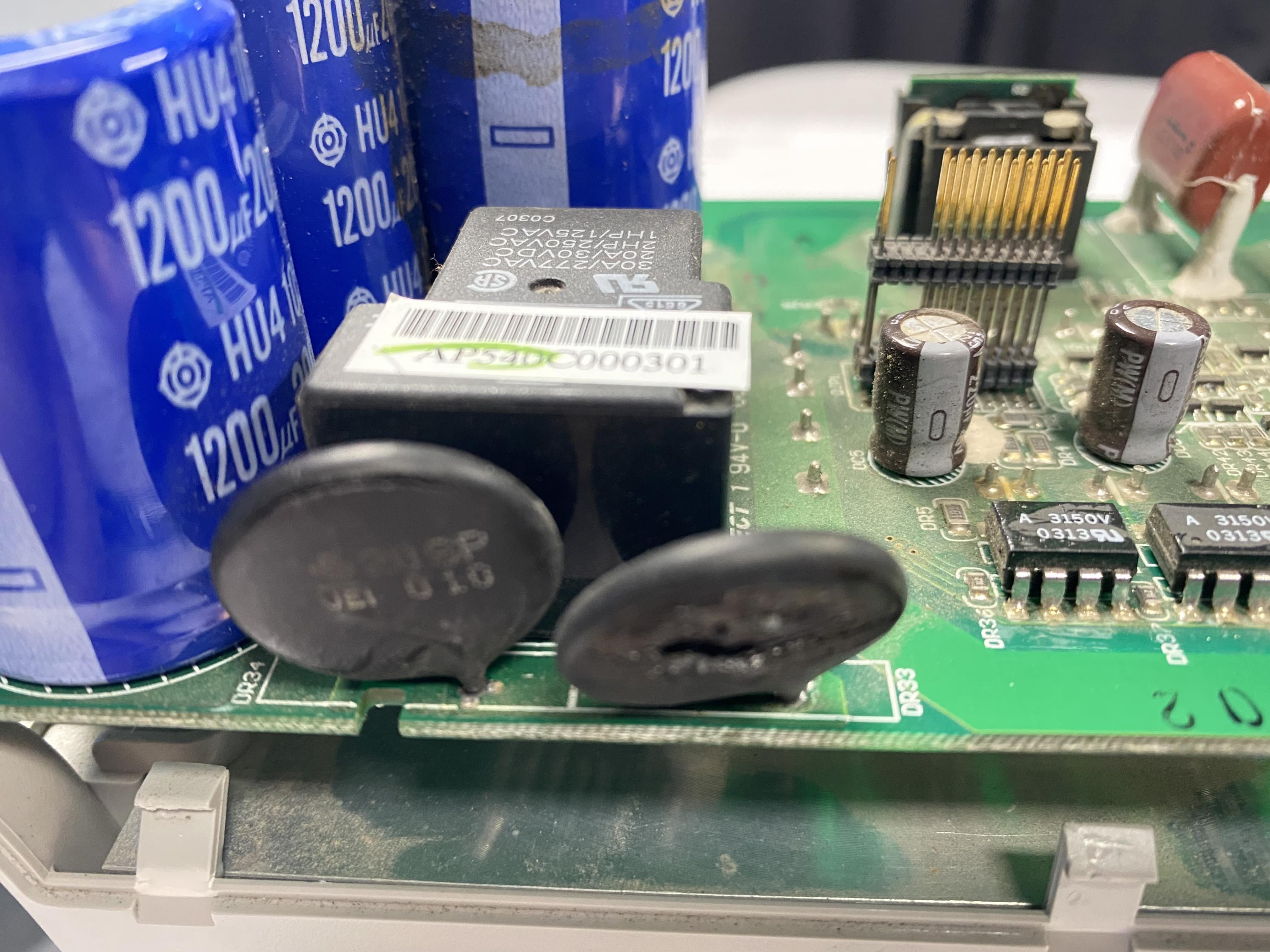

    I need help determining what this component is called? Also, where the best place to purchase them would be?

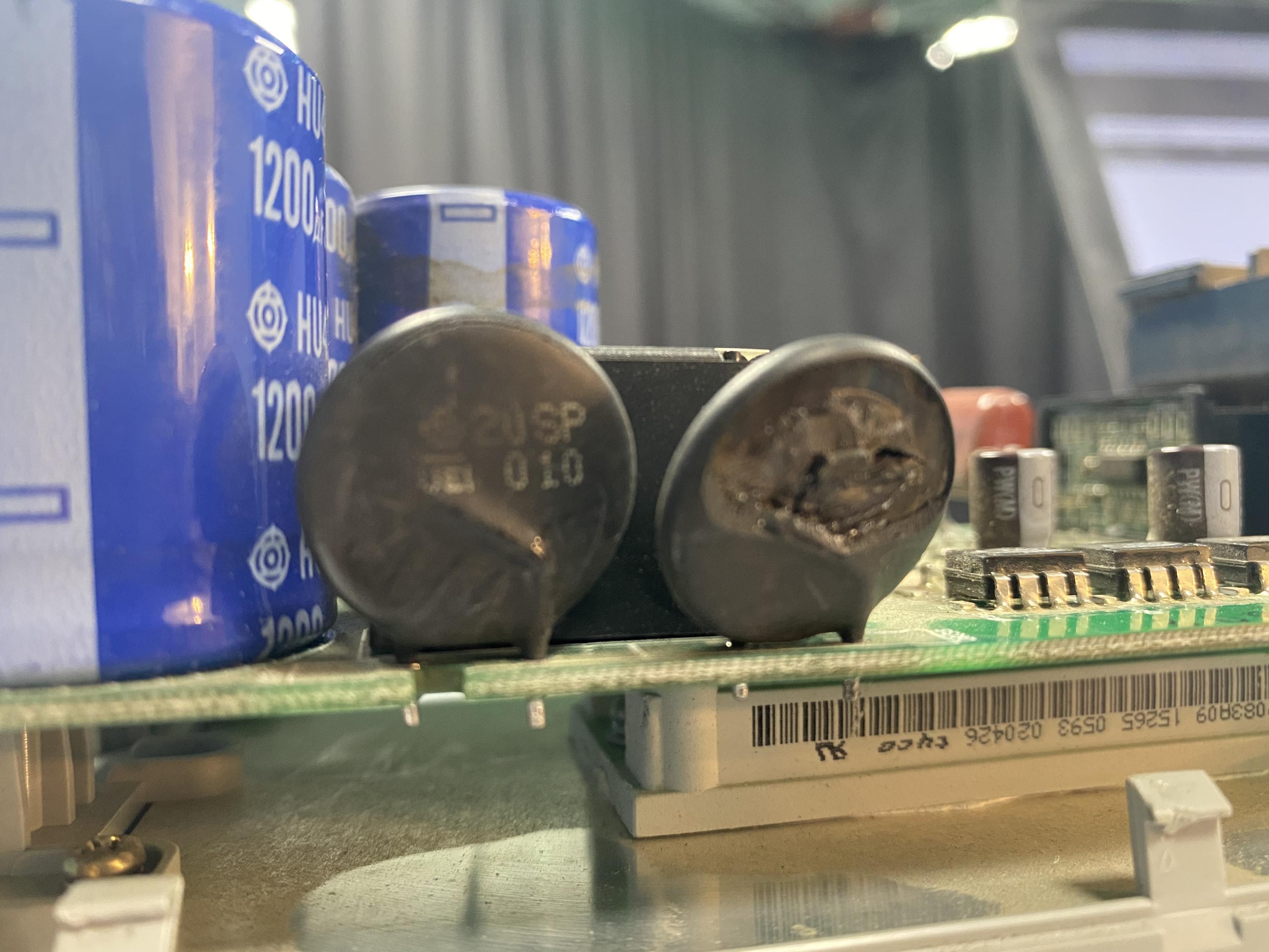

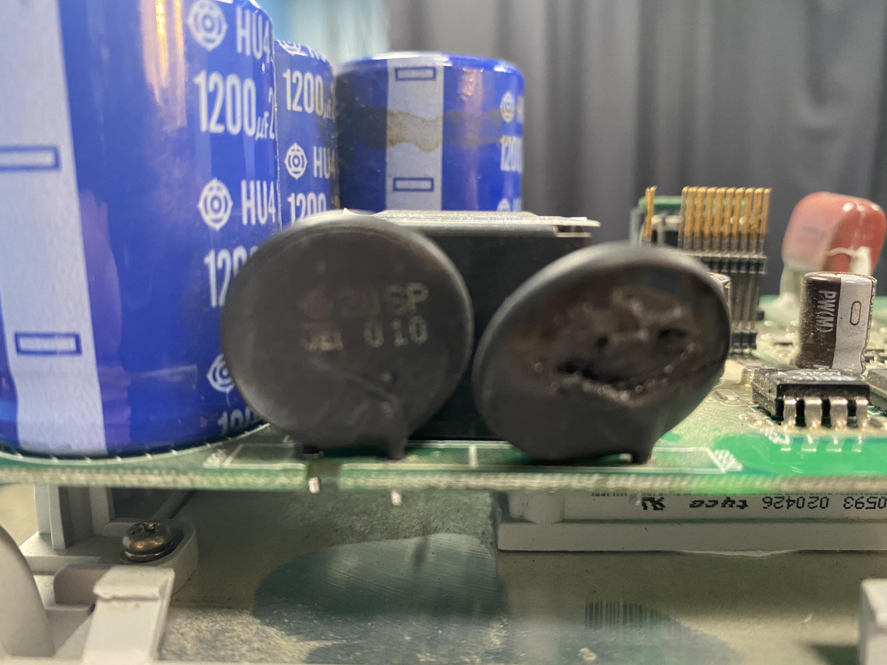

    It is a NTC thermistor 10Ω 6a Protection thermistor 20SP 010
    Looks like a Canthern MF73T-1 10/8 Digikey 317-1596-ND would work.

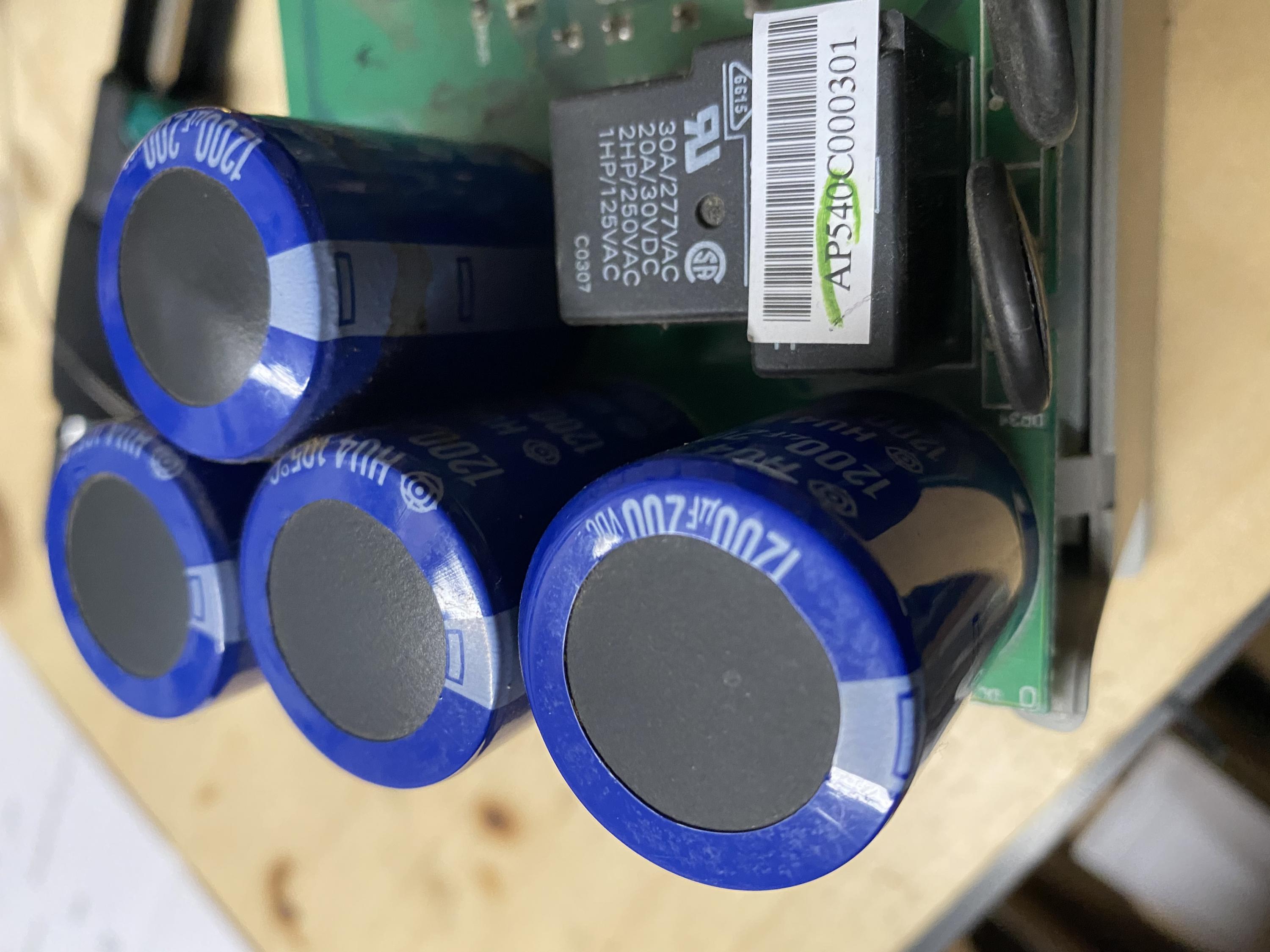

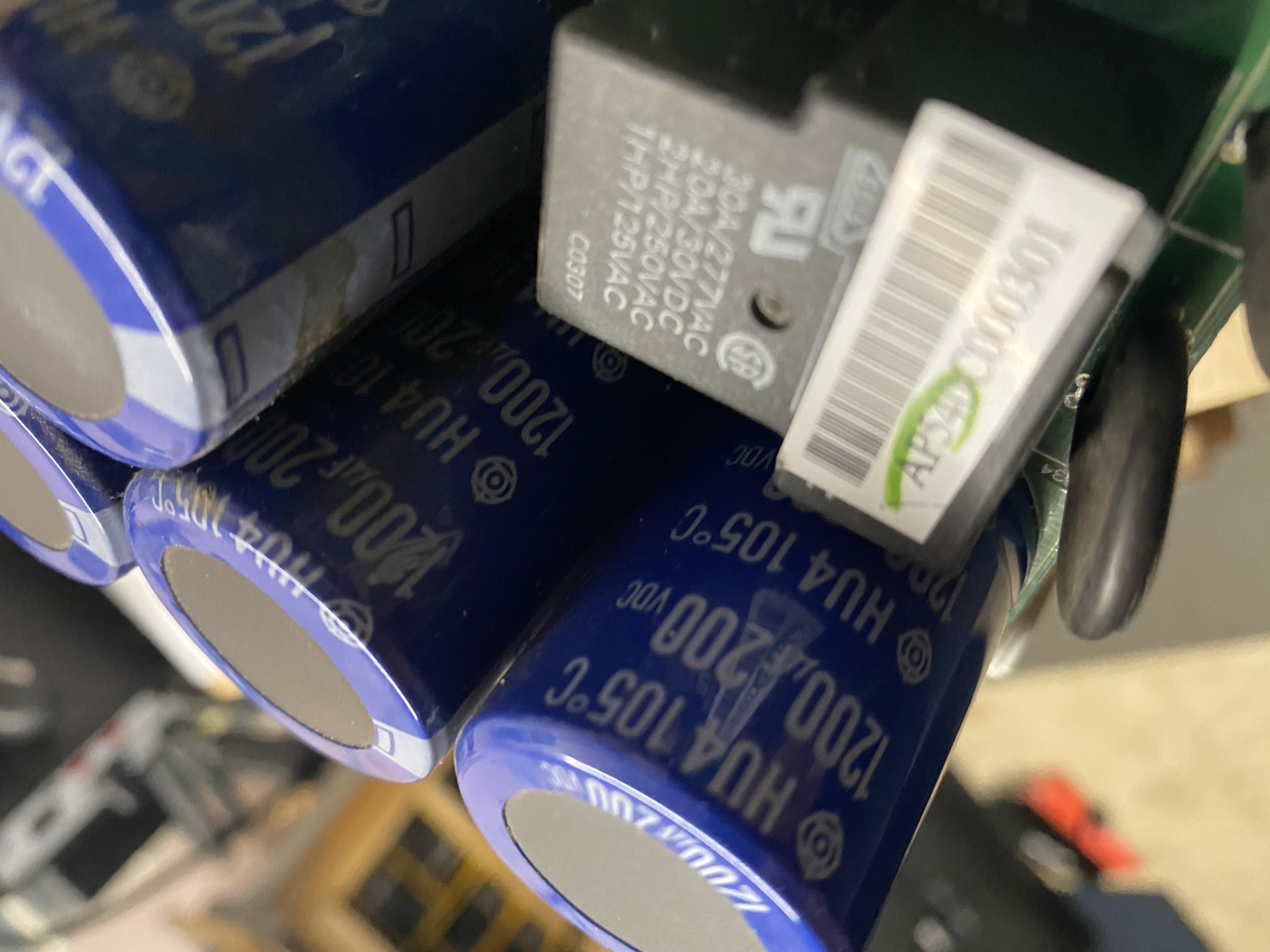

        By "these" I assume you mean the electrolytic capacitors?

          The capacitors... sorry I was not clear on that response.

            This will get you close, https://www.digikey.com/products/en/...=1&pageSize=25
            you will need the diameter, height & lead spacing to get closer
            The originals had a "Ripple Current @ Low Frequency" of 2.04~2.49, so I suspect any of the replacements should be ok

              I was able to order them. Thanks for all the help.

                The thermistor vendor is Uppermost Electronic Industries. Inrush thermistors are sort of like fuses in the sense that they don't blow like that on their own. There must have been a short circuit "downstream" from them.

                  The one cap does look a bit bulged and that could cause some issues, I would also check the igbt to see if any of the internal components are shorted. this looks like it is a vfd or some sort of speed controller.
