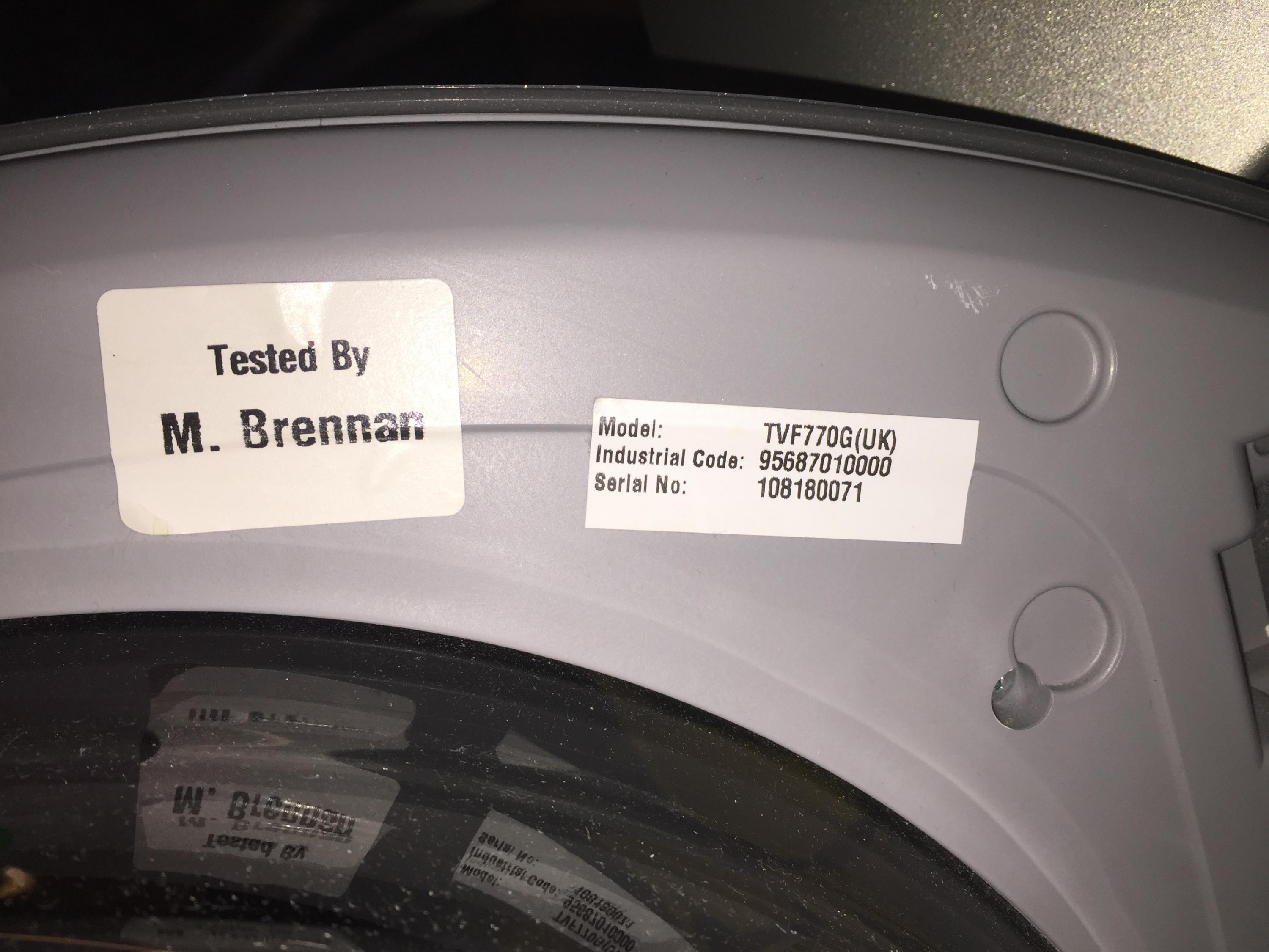

        What make and model is the dryer?
        You likely have a run capacitor and a start switch. But that's more than three wires...

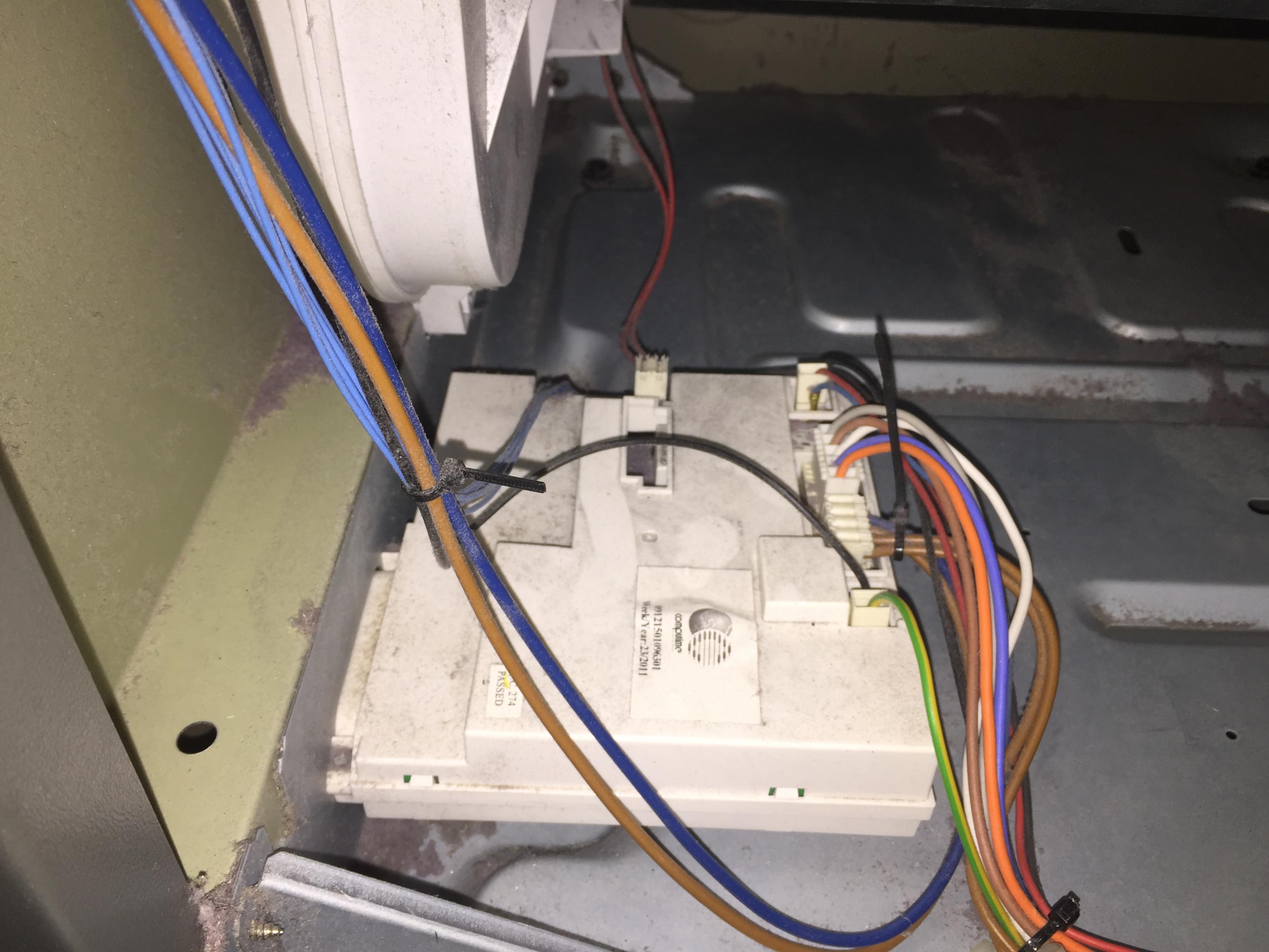

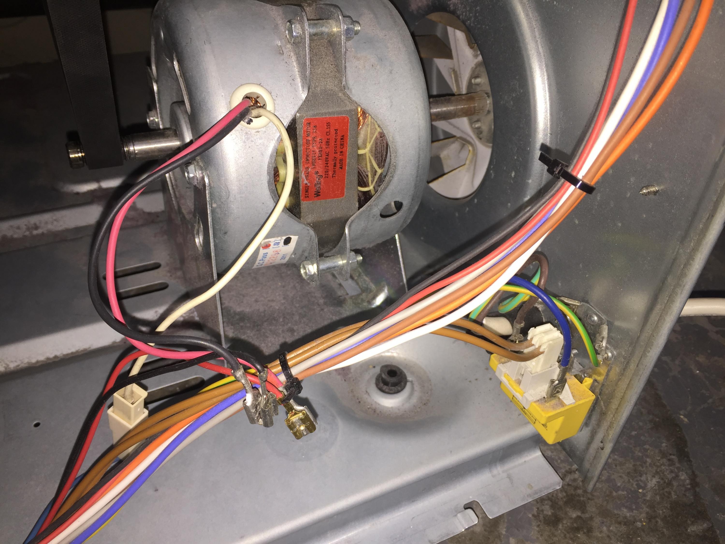

          I've attached a few images of the motor.
          Sorry just realised the start capacitor is not installed, that obviously connects to the red and black wires that are hanging down.

                      I have put the capacitor back on then with the machine plugged in and switched on with the power button but the start button not pressed, I only get a few volts which is falling between red and white.
                      I've tested resistance and get about 30 ohm's between red and white but get OL between white and black

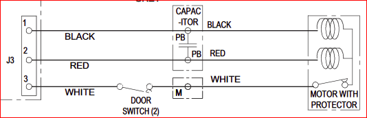

                        I suspect the motor winding could be open, white should be the common, I suspect Red must be the main winding, and Black could be the start winding.
                        Do you read any resistance between Red and Black on the motor?
                        It could be like this diagram (this is from a reversable motor model)

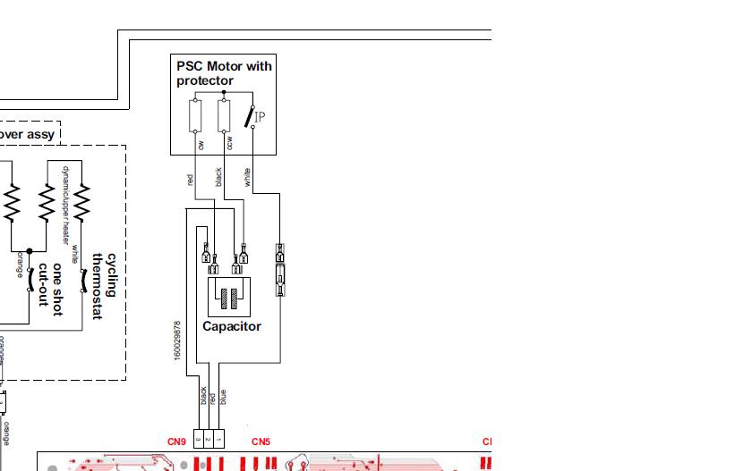

                              Hotpoint TVF770G Aquarius tumble dryer 95687010000, also goes by Indesit, Ariston, Cannon, Creda, Proline etc. I could not find the service manual.
                              But looking at another model, the motor has two windings and the control board seems to have a relay to do the start/run switching.
                              The motor might actually be OK, it's just the rolling load is too high. The belt might be installed wrong or too tight and I would check the support rollers are not worn out or need lube, the dryer is level. Otherwise a new belt will just wear out fast.
                              Check the huge safety recall on it too.

                                    You should get continuity, a reading of a few ohms. With the motor unplugged, white-red should be a few ohms and white-black as well. black-red should roughly equal the sum of the two.
                                    If you get open circuit, then you might have tugged on the motor's wires and broken a connection somewhere, have to look hard or take the motor apart to fix.
                                    It needs the start winding to get going with drum and clothes as a load. A motor will start up with no-load, belt off even though no start winding connected.
