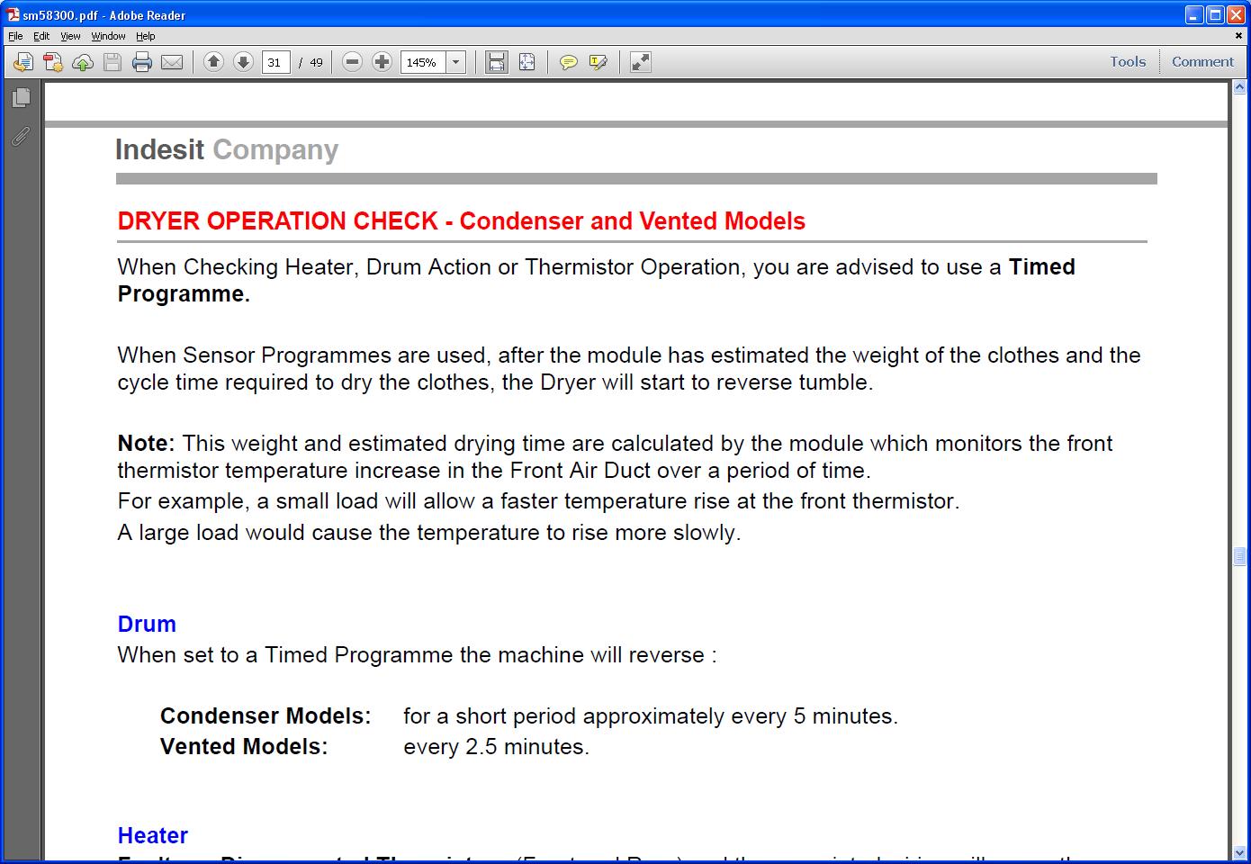

    if this wiring diagram is correct why does this motor needs to be reverse-able I have never seen a dryer with this feature what would the purpose be

      Re: Tumble Dryer start capacitor
      Some models DO reverse, it prevents clothes from being rolled into a ball and not drying properly. A reverse action tumble reduces creases, which means less ironing once your clothes are dry.
      And this from a similar service manual
      • redwire
        • Dec 2010
        • 3912
        I read it in a service manual for another Hotpoint Aquarius tumble dryer AQC851. It has an "anti-allergy program" that uses two directions, so the drum must have strange tines. The motor has the same three leads and cap. That model needs a hardware dongle to do tests and read fault codes. What a scam.
        If it does reverse, then there is no start winding. I would suspect the capacitor is low value at load or mains voltages? Compared to a multimeter test.

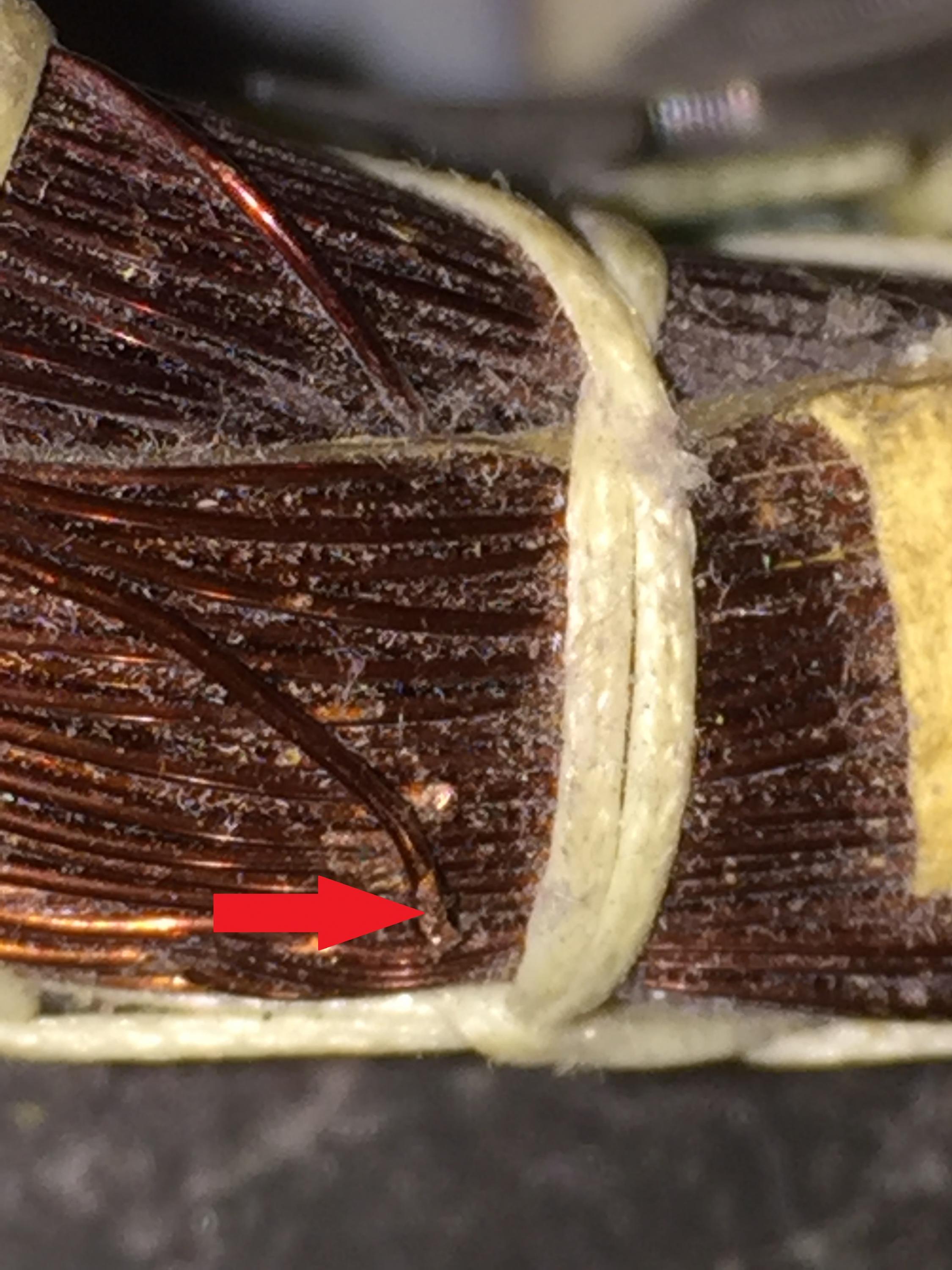

                          • pintglass
                            • Jul 2019
                            • 79
                            • United Kingdom
                            #33
                            I have taken the motor apart and think I've found the problem, I have a break in the winding wire.
                            As can just about be seen in the image I pushed the wires together and now get about 60 ohm's from red to black and about 30 ohm's from black to white.
                            Could I solder the wire together?
                            Would i have to be careful not to remove the enamel from the wire, i have some uv cure solder mask could i cover the wire with this to insulate it.
                            • R_J
                              • Jun 2012
                              • 9624
                              #34
                              You should be able to clean the enamel and solder it, If you can expose a bit more of the wire that would be better but if it's held in by the rest of the winding that might be tough. Try and secure the wire that is connecting to where it is broken so there won't be any stress on the solder joint. slip a piece of heat shrink or even a thin piece of plastic tube over the longer wire first, then slide it over the solder connection.
                              • pintglass
                                • Jul 2019
                                • 79
                                • United Kingdom
                                #35
                                I've fixed the motor and the dryer seems to be working fine, so thanks to all that helped.
