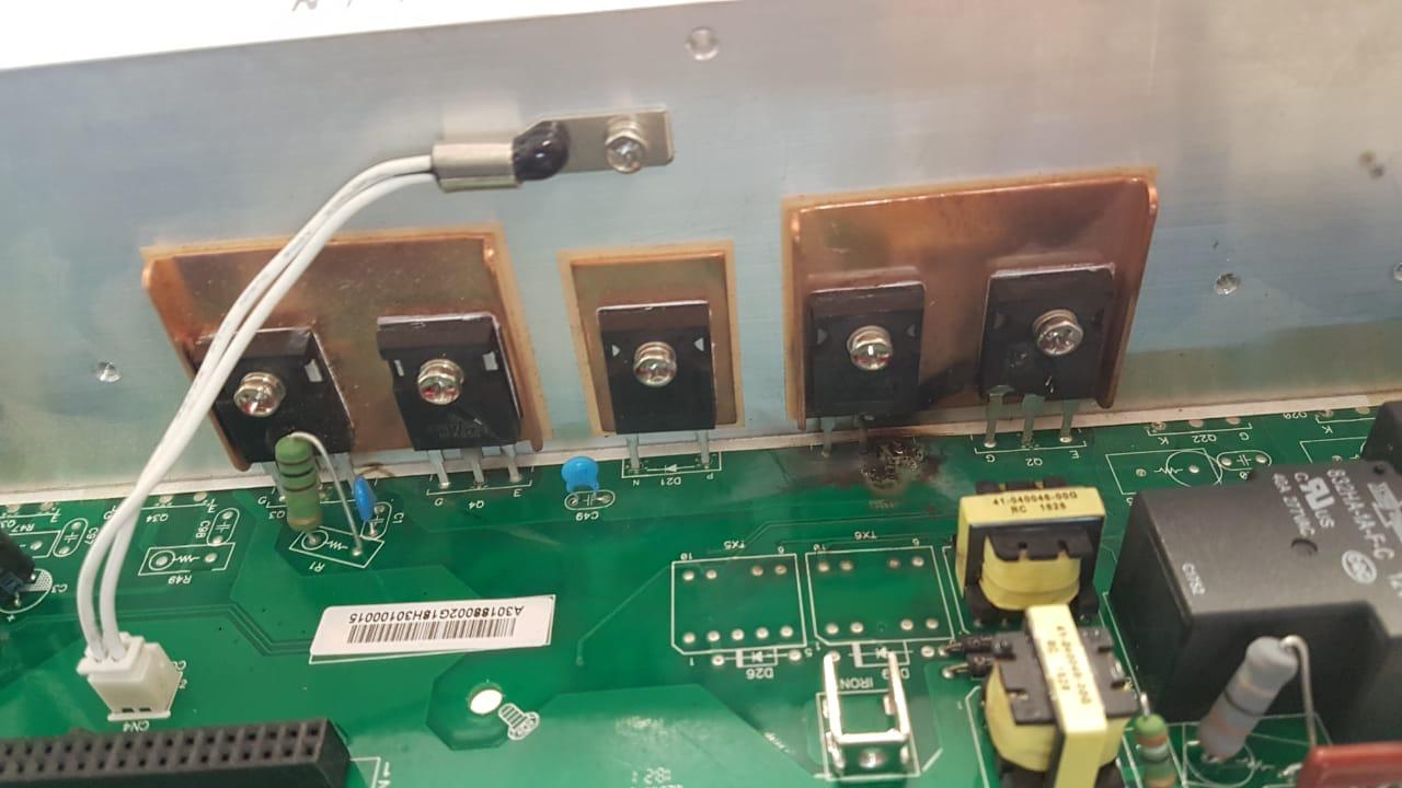

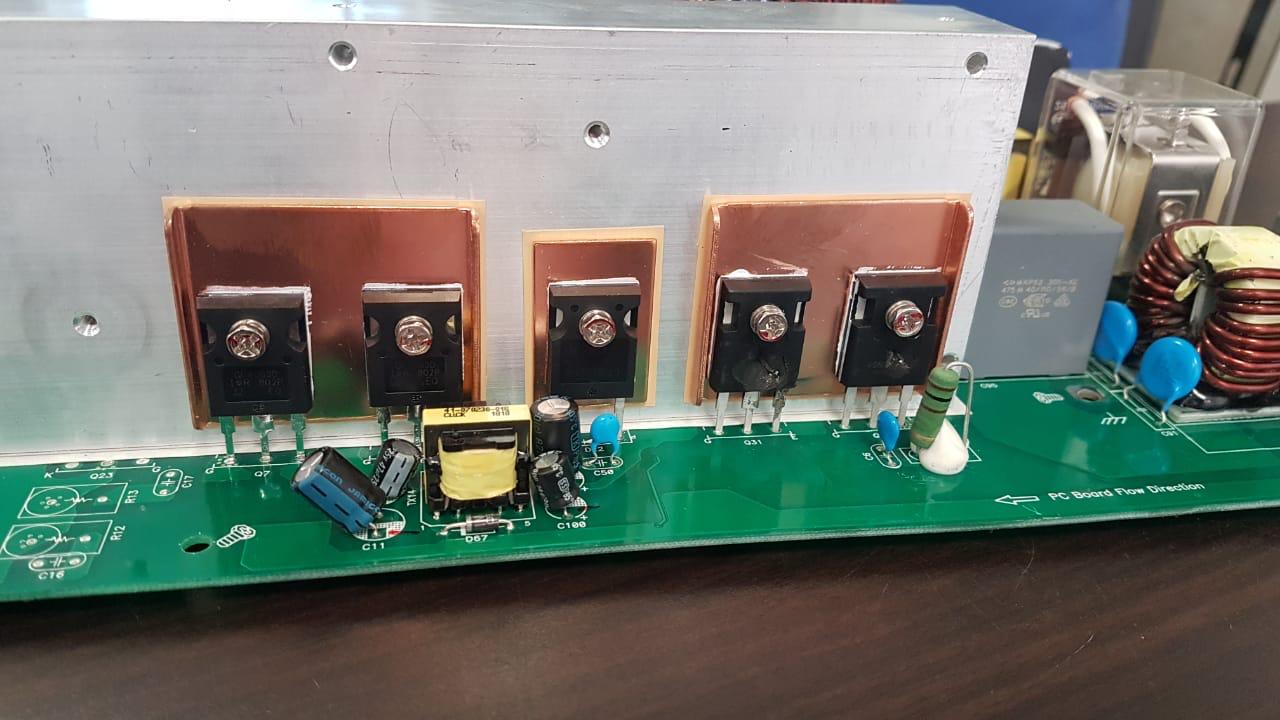

    Hello everybody.
    I have opened a UPS for repair today and i was surprised to see 40A 1200V IGBTs in a bridge configuration along with 2 40A 600V IGBTs. and a 75A 1200V ultra fast diode.
    The UPS has an input and output of 240 V ac .
    And using 12 Vdc 9Ah batterie totaling around 16 or 20 battery.

              Ngtb40n120fl2w-d along with GP4063D on the right and a 75 A 1200V diode in the middle RHRG75120.
                • 31214
                Re: Why this UPS is using 1200V IGBTs ?
                i think one pair is faulty.
