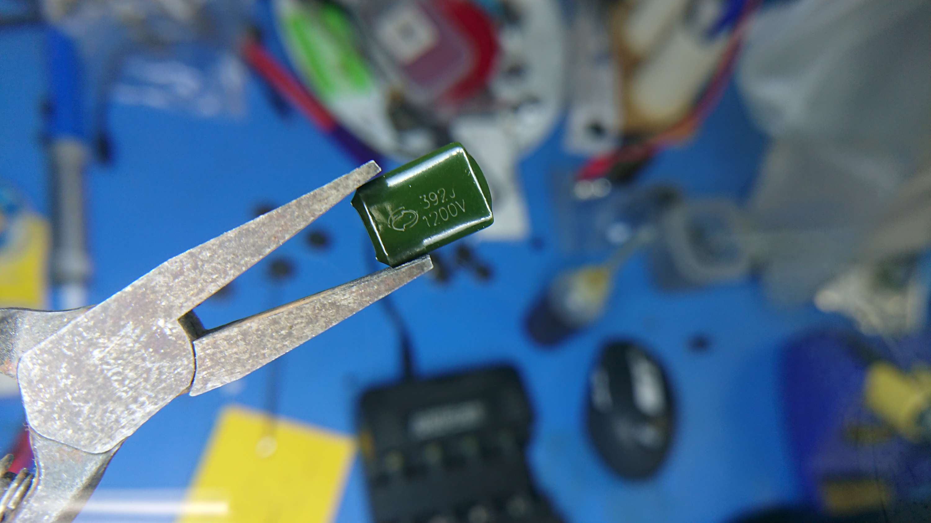

    I had a logitech Z506 psu go bad due some glue corroding the legs of several components and the one i'm struggling to find a replacement for is a green polyester capacitor markings 392J 1200V.
    The problem is I can't find any 3.9nF caps with a voltage rating of 1200V from any reputable retailers (plenty of 100V) , this particular cap only seems to be available from Chinese sellers which leads me to believe the rating is garbage or the cap is.

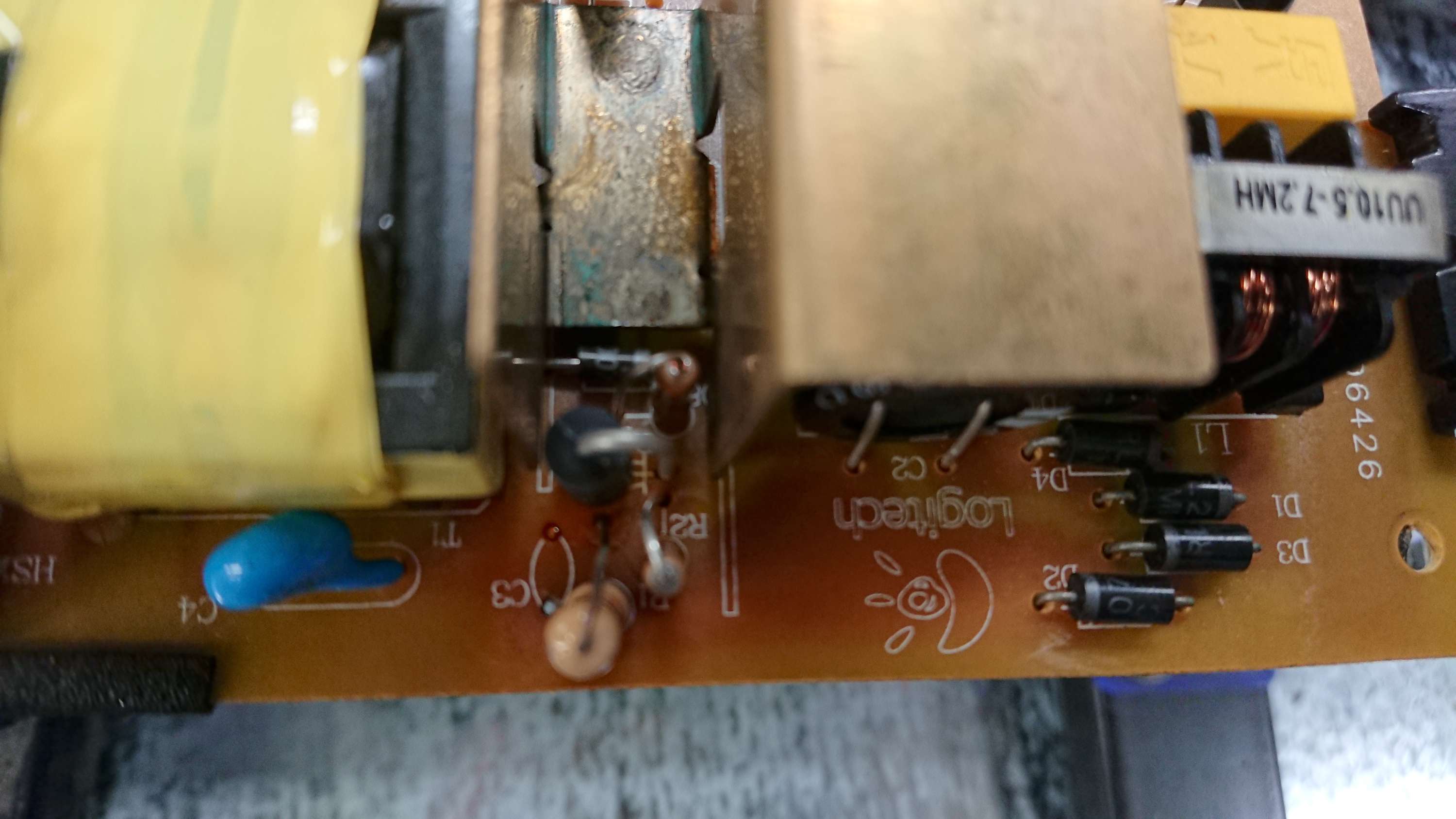

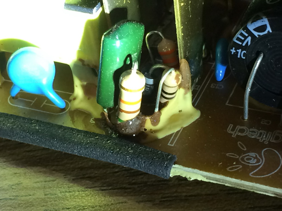

        Ok some pictures attached.
        yeah according to that linked thread it is part of the snubber circuit .
        Thanks for the catalogue link, so ECW-H8393RJV is the same capacitance, lead spacing (7.5mm) but only rated to 800VDC. Honestly I don't know how critical that is and whether the greencap rating is even genuine. The Panasonic caps rated to 1.25kV have a 20mm lead spacing.

              The cap was likely ok, but he cut the leads off so now it is nfg. You can get .0039µf 1200v mylar or polyester caps from many suppliers.

                You always so passive aggressive? no 'he' didn't cut the leads off why would I of done that when I had all the tools in front of me to remove it. The leads had been completely corroded by the glue and pretty much disintegrated.
                I don't have an actual picture of mine but it looked similar to this but only much worse as the entire cap base was covered in the glue which had changed state into the corrosive brown stuff.
                Would you care to share which suppliers you are referring to? like I said all I could find of that capacitance, with that lead spacing and voltage rating were dodgy chinese suppliers.

                    It is the primary RCD snubber network on the Logitech Z506 power supply.
                    D5 FR207 1kV 2A 500nsec
                    C3 3,900pF 1200V LS=7.5mm
                    R2 10R 1W
                    R1 51k 3W
                    TOP258MN datasheet they use a 3.9nF 1,000V cap plus a 200V TVS though fig39. The IC max. is 675V. It's just a cheap Logitech design and then even cheaper parts went in.
                    Nothing is rated 1,200V in that small 7.5mm leads, and it runs next to hot resistors, is covered in conductive glue. I would stuff in a quality film cap 1kV or ceramic disk cap 2kV there.

                        Originally posted by stj
                        i was just thinking 2kv ceramic
                        Same here.
                        2 kV Ceramic should be fine... unless the design is so bad that this somehow causes oscillations on the primary (I've seen it happen on cheap 2-transistor flyback designs on the 5VSB of an ATX PSU... but those are a more special case, I think.)
                        If not, I think the rating could also be dropped to 630V on the film cap. As others said, nothing in the circuit is rated for that high of a voltage, so it probably isn't needed... unless the ripple current on that snubber circuit is so high that it causes lower-voltage (smaller case size) film caps to overheat.
                        In any case, I suggest going with a 630V quality polypropylene cap in there, and that should be fine. Polyester might work too, but PP has better high-frequency stability. If not, go with a 2kV ceramic.
