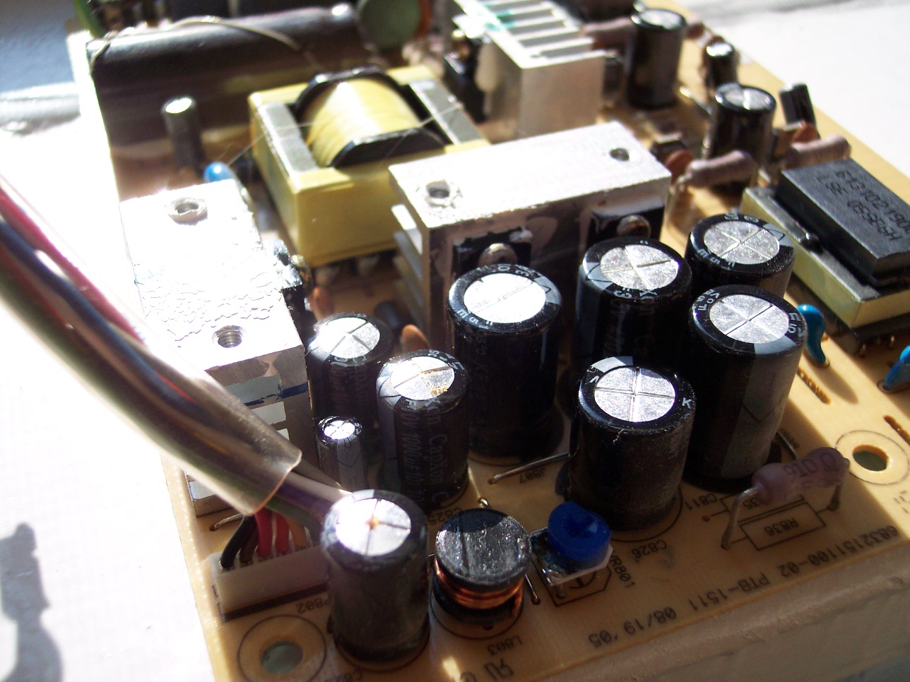

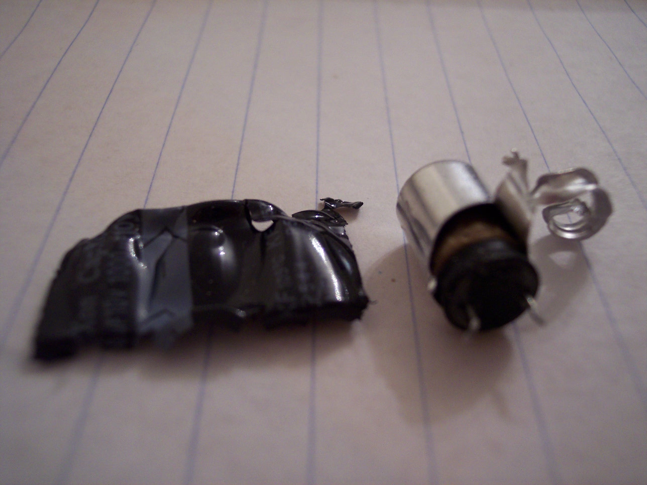

    CapXon

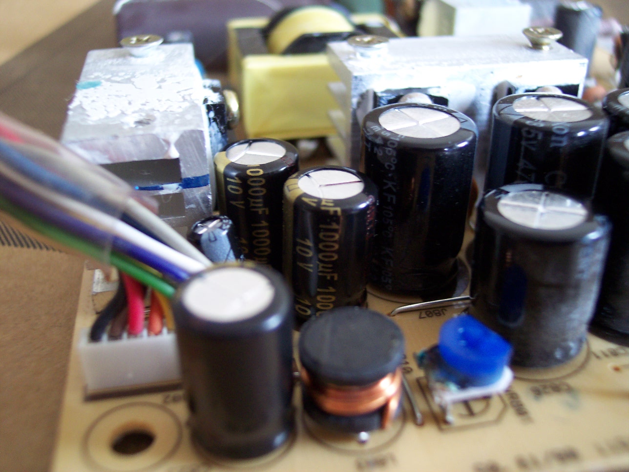

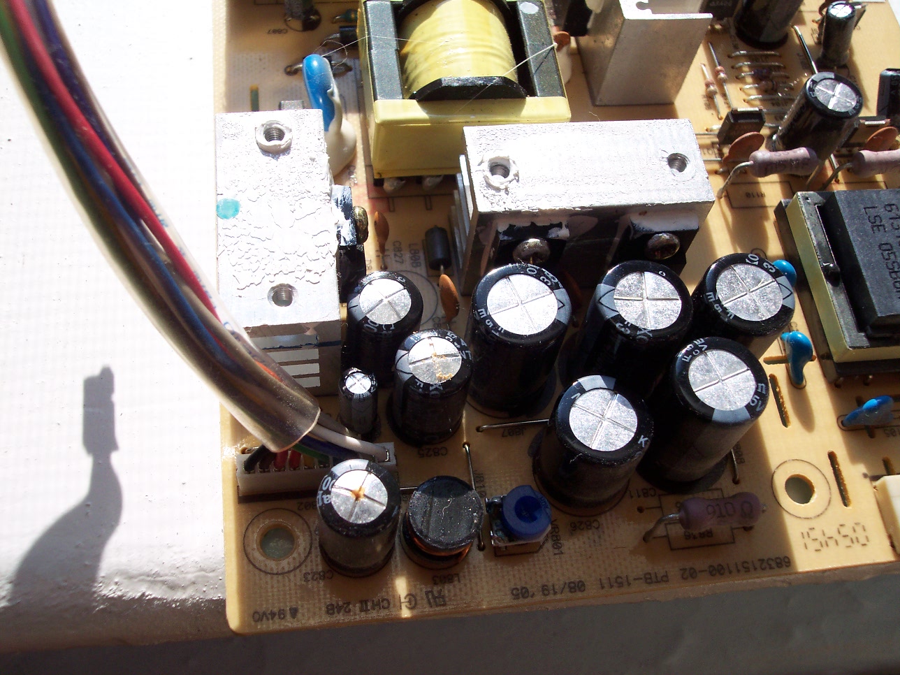

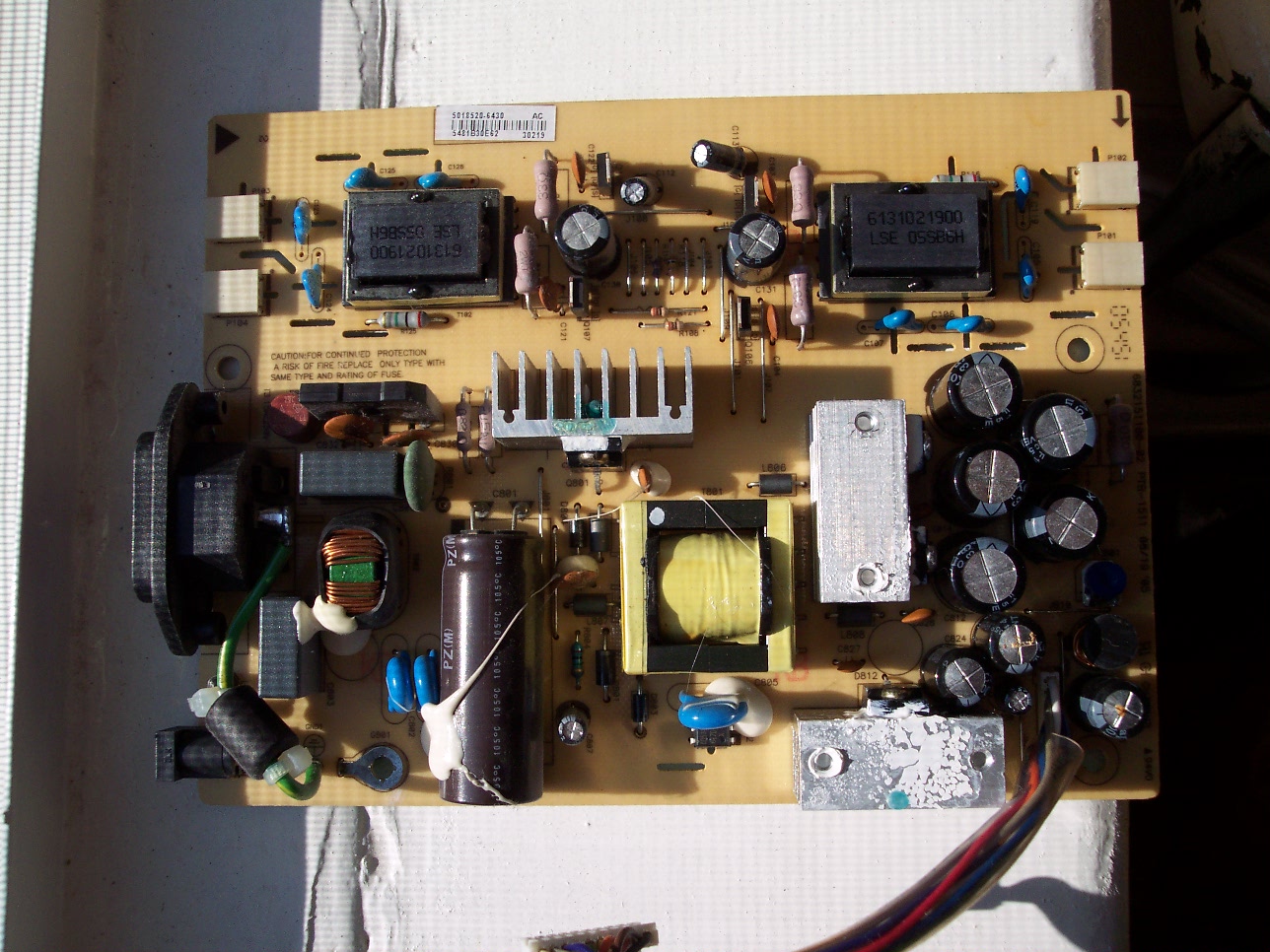

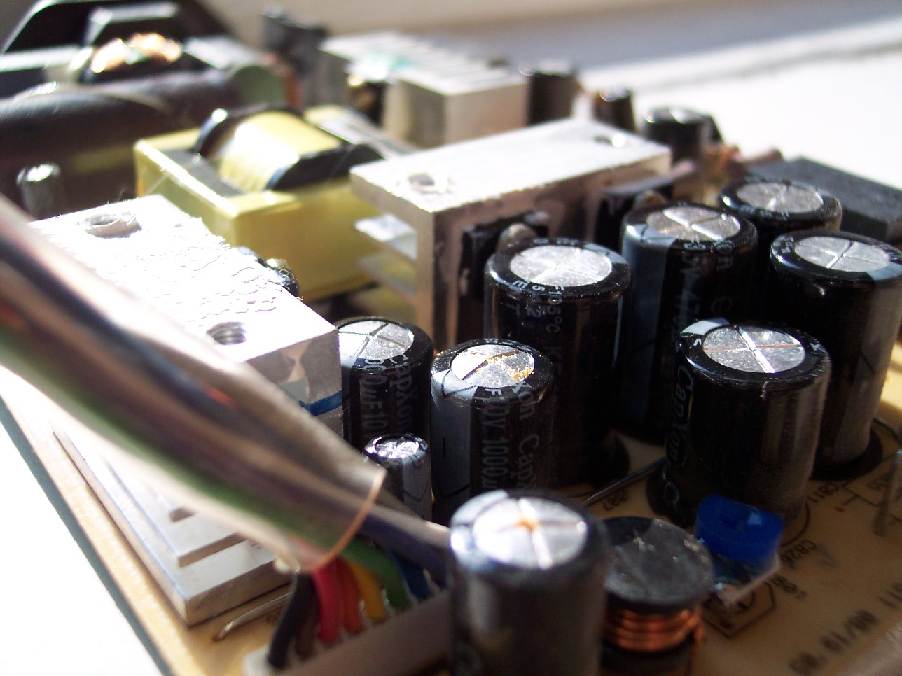

    My Dell lcd monitor went dead on me out of nowhere. I thought the button broke but on further inspection I found that 3 of the capacitors on the power board were bulging. The middle capacitor had much more yellow junk on it but I brushed it off by accident. I want to replace the capacitors so I don't have to buy a new monitor. Can anyone tell me which capacitors I need to get? There are so many on the market.
    The caps are rated:
    1000 uF
    10 V

    Hi CapacitorUser
    Welcome to the Forum!
    You need to know the capacitor "series" as well as the voltage and rating.
    The Series is a 2-letter code and for CapXon Power Supply caps might be: "GL", "KF", "KZ", "GF" or "LZ".
    For example, a CapXon KF series is considered a "Low Impedance" capacitor suitable for use in Power Supplies.
    Once you find the series, go to CapXon's website and look up the specific capacitor that you need.
    You're interested in:
    Mounting - Radial Leads
    Series
    Voltage
    Capacitance in microfarads (μf)
    Size, especially Diameter in mm
    Ripple Current in milliamps (ma)
    ESR or Impedance in ohms (Ω)
    Next, you need to find a suitable replacement from a better manufacturer.
    Badcaps.net offers Rubycon and Samxon brands.
    Other well-regarded brands are: Nichicon, Panasonic, United/Nippon Chemi-con... along with others that you may notice mentioned in the forum.
    My personal guess would be something like a Nichicon PW or a United Chemi-con (UCC) KY with about 1000ma Ripple Current and maybe .060Ω Impedance. You can usually be a little off on Capacitance, ESR or Ripple Current but never go low on the Voltage.
    You can buy suitable capacitors right here at BadCaps.net, at eBay, Digi-Key or other electronics suppliers. Radio Shack only carries General Purpose capacitors not usually suited for use in a power supply.
      I'm not sure if it's the same in the USA, but in Canada at The Source (used to be known as RadioShack in Canada in the past) the capacitors in the capacitor value packs are from some "TREC" brand:
      I've had no experience with this brand, but I'm guessing that it isn't a high quality capacitor manufacturer.
      I'm guessing RadioShack radial aluminum electrolytic capacitors of 1000uf can be used if they fit, but at best they're a temporary repair until better low impedance capacitors are available to you.

        Re: CapXon

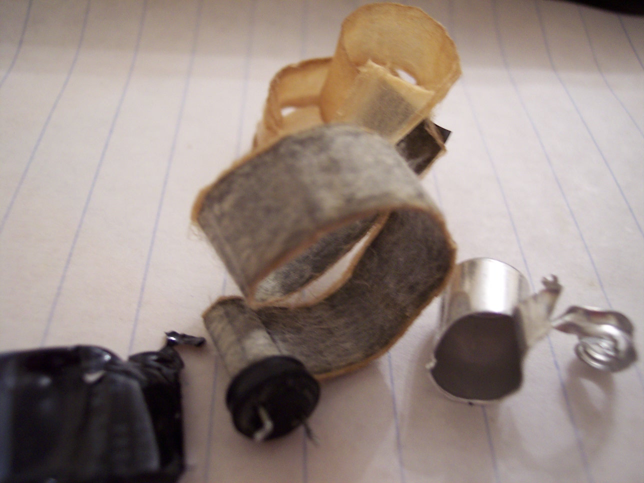

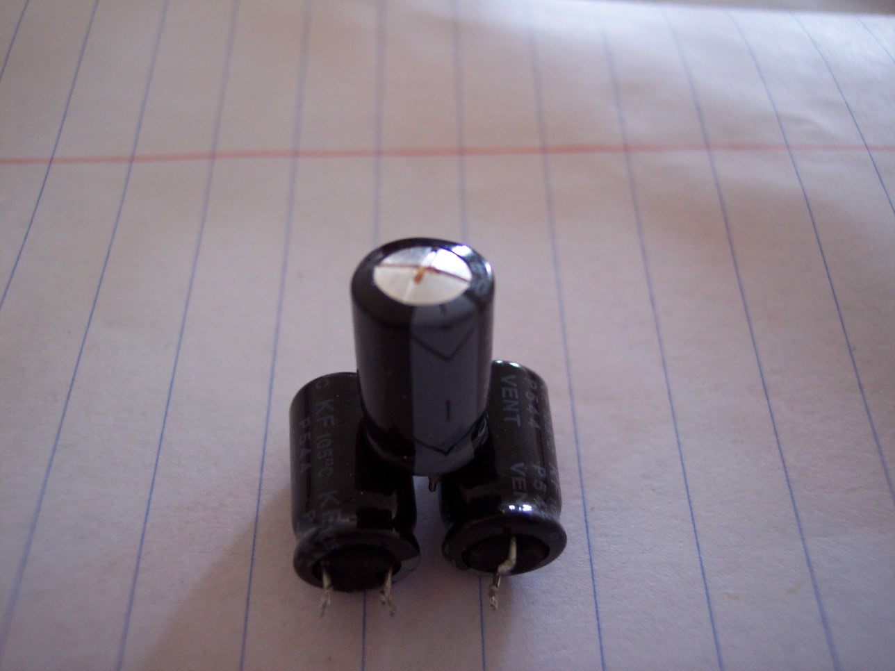

        I found the model number of the capacitors. Its CapXon P544 VENT. I could not find the specs on CapXon website.
        However I was wondering if this capacitor that I found on digikey will work.
        http://www.digikey.com/scripts/DkSea...name=P10224-ND
        • Newbie2
          • Sep 2005
          • 885
          Re: CapXon
          That capacitor will work perfectly for your monitor.
          If there are any other CapXon capacitors in your monitor with different values, you might also want to purchase replacement capacitors for those too to avoid a future problem with capacitors.

            looks to be exactly the same dell monitor that I repaired over in this thread. If I were you I'd replace the other 5 fatter caps while you're at it. If the little ones went, they won't be far off...
            In addition to the pieces of information mentioned by KeriJane, you'll need to know the lead spacing (distance between the leads, so that it will fit), and the height, so that you'll be able to put everything back together afterwards.
            If you'd like I can get you the exact part numbers from digikey for what you'll need. They fit perfectly and the monitor has been running for 2 months without problems.

                Thanks to everyone for their input. My monitor is working again!!! Sorry for the late update. Here is the pic of the new Panasonic caps on the power board. Don't know if its interesting but I took apart one of the culprits and pictures are provided. When I tried to open the cap there was a big hiss like when you puncture a aerosol can. The metal strip looked blackened.
