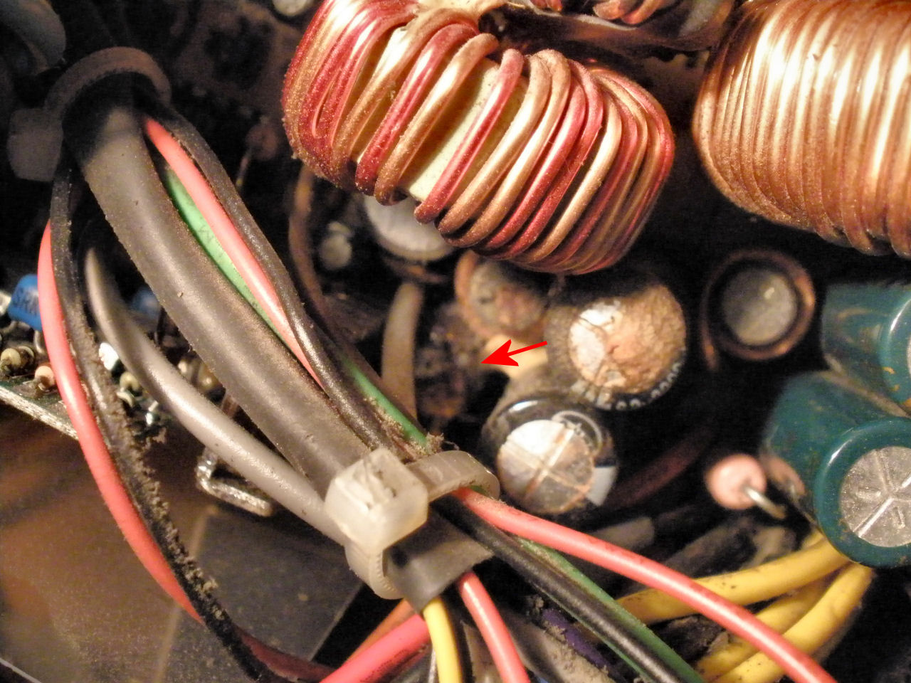

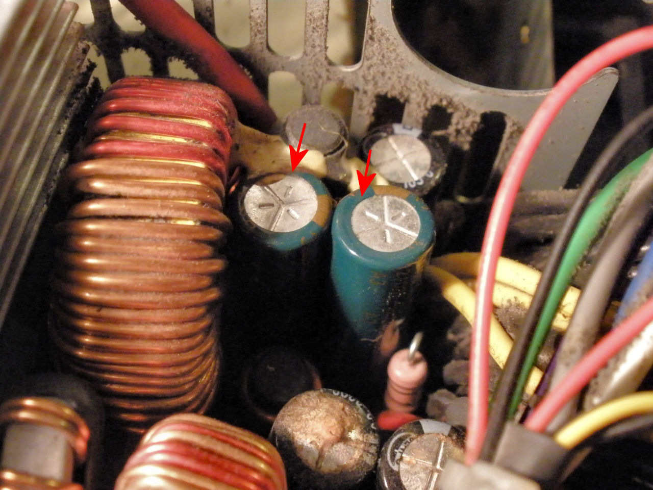

    To identify the caps I had to cut through this well designed thing, yet I can't see the brand of 2 green 3300uF 10V caps
    and a small hidden unknown cap
    Does anyone knows the brand and can help identify the small one?

    Can't see the little one.
    The green 3300uF are Teapo. [Very slight possibility they are Tayeh].
    That vent stamp shape is Teapo's trademark but I have seen some [rare] Tayeh with it,,,, which is why I think Teapo was the OEM behind Tayeh.

      Re: What the heck is this?
      the black one looks kinda like the canicons i found in a tyan tiger 133 once- total crap
        take that back, mine had gold print...
          These lower end thermaltakes are HEC's.
          You'll find that the pcb states that its only good for 300w.
          The caps are teapo (the green ones,) Ltec, Capxon, and Su'scon.
          Not too terrible of cap choices, same as a lot of delta's, but they obviously can still fail
