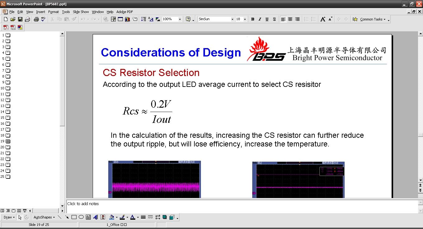

    The VF of the LED will vary withe current flwoing through the LED, temperature all affect Vf, that is why you should use constant current source, 30V may be OK it depends on the Vdrops of the Constant current active control element at the needed current and variation of the total Vf of the LED string, you want it to have head room for the Output Voltage to go up and down as needed to maintain constant current.
    See page 12 of the graph which is typical spec provided by the LED manufacturer which I doubt if you have it for your LED. If you have constant current power supply then you do the measurement and see what you get with your LEDs you will be using.

            Read post 34, I already show you how that 180mA comes about, so to change the LED current setting you just need to change the value of the resistor. It is all in the spec sheet.

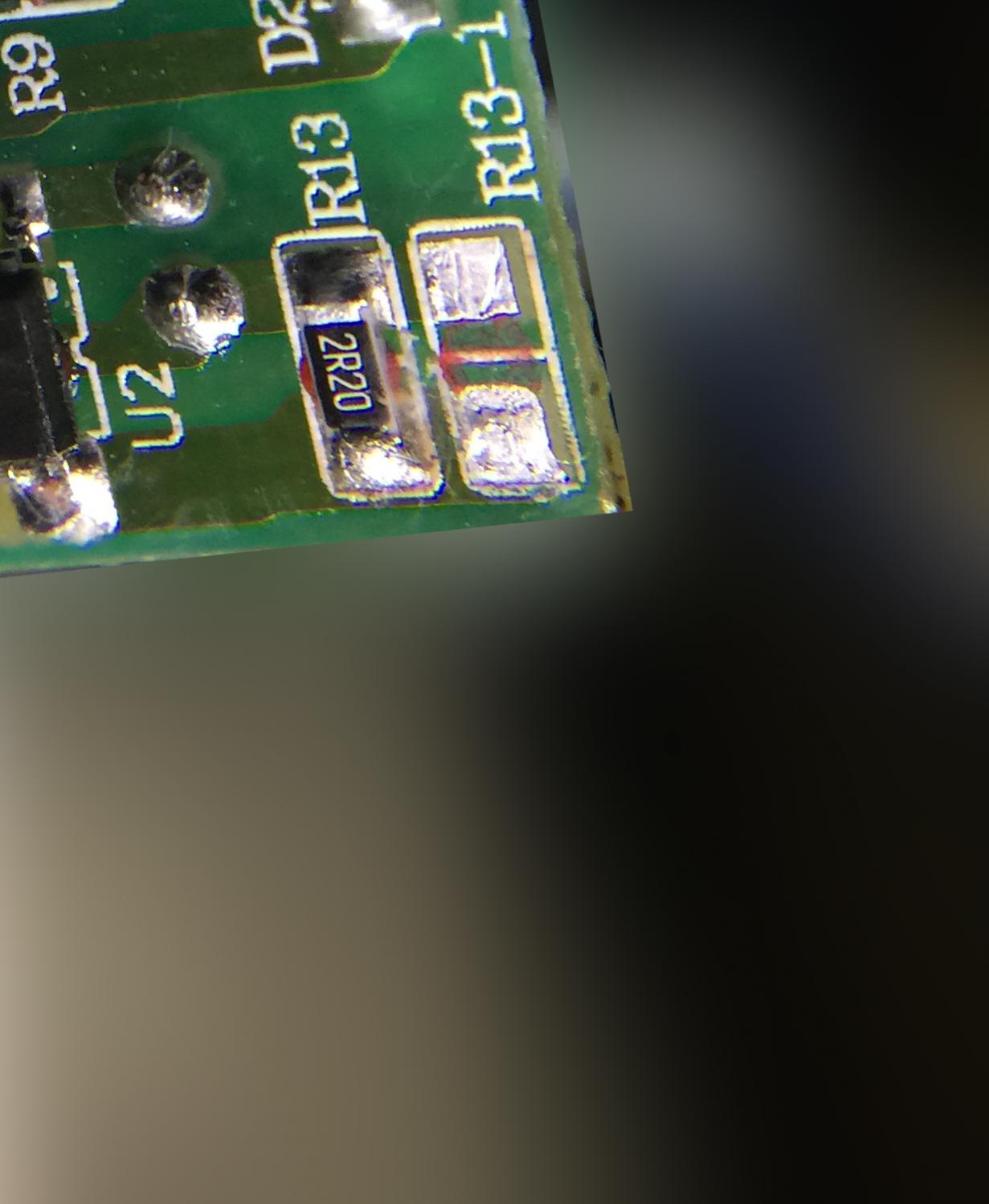

              BTW, if you remove one of the two R13 (2R20) resistor, the constant current will drop down in half to 90mA.
                NOPE!

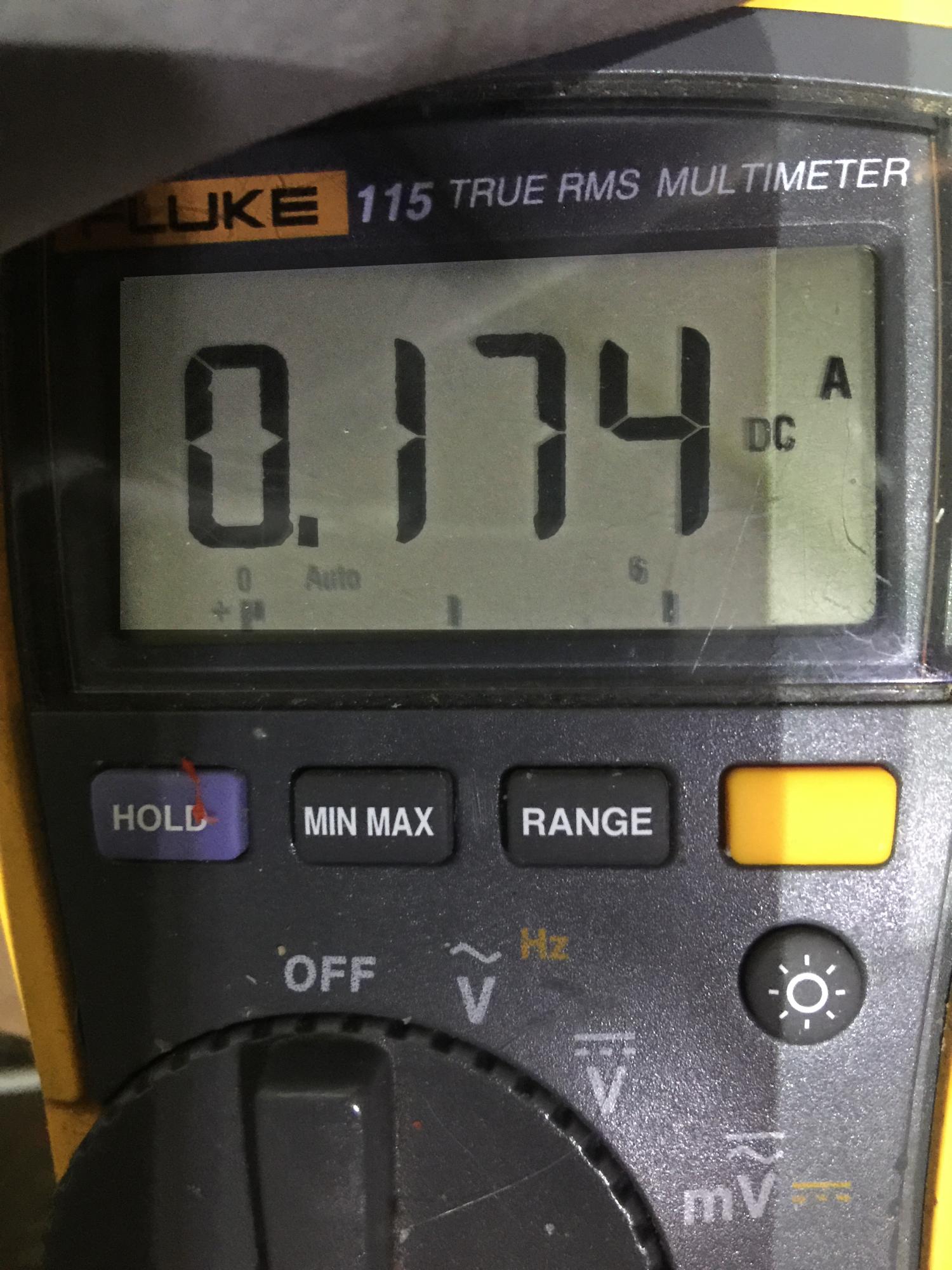

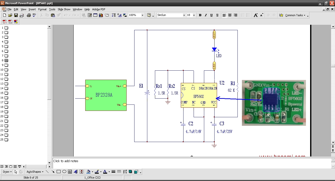

                  Where is the meter connected to? In series with the LED string? Unless that spec sheet diagram does not match what you have, or 5602 is no longer regulating the current.
                  See the calculation and how the 5602 is connected, verify if it matches your board lay out as far as R13 connection is concerned. I see that one end of the resistor is connected to pin 7, 8 for sure, most Chinese manufacturers will just copy the circuit from the IC manufacturer application circuits.

                    [QUOTE=budm;861331]Where is the meter connected to? In series with the LED string?[quote]
                    Yes
