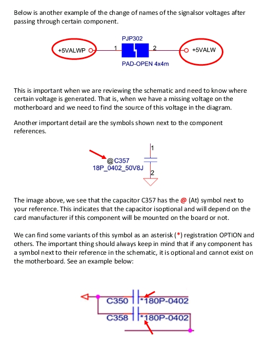

    Greetings to all of you, as you will understand from the questions, I'm not familiar with electronic diagrams .... from theory to practice there is always an abyss :o)
    1 - I often find the "@" character in the electronic diagrams of laptops near the component and I'd like to understand if it indicates a component that may not be present in the real hardware execution or if there is a different explanation for the use of this @.
    2 - I write these examples:
    2S@ PC217 0.22U_0603_16V7K 16 volts (max) what does it mean 7K ?
    @ what does it mean the @ character ?
    GPU@ PC218 0.1U_0603_25V7K
    The 0603 it means the package?
    the 0603 package is used to classify both capacitors and resistors or there are different tables?

    I dont know entirely, but I will try to answer based on some kind of logic.
    Name-of-rail-or-signal@ schematics-and-board-name-of-component used-value ___ used-package(dimension) ___ designed for max voltage
    So, there is C217 capacitor with 0.22 uF capacitance (220nF)/16V in package 0603.
    In some type of package could be any component who can fitted in, so, in 0603 package can be capacitor, resistor, led diode, inductor... and so on.
    What means sufix @ prefix P and 7K on end I dont know. Some mark for tolerance maybe... or specific marking of that company, schematic...

        I would like to try to insert an attachment to explain better...
        OK done
        you will see on page 41 in the captions LED3 and LED7 a resistor with the character @, the other without @.
        and on page 45 you will see PD3 - PR8 - PC6 with character @.
        For the capacitors, I'm a qualified electronic technician, and I know the differences and the values of the components quite well, but my limits concern these representations regarding the electronic diagrams.
        Sometimes I see 7k in capacitors, but also 8J or 6 as on page 47
        Probably as Harp says it will indicate the tolerance, but I wanted to ask you if you know of the tables that describe these values, after all, for the resistances I see that the % is entered

          So, simbols with @, * or so, may have be ommited by manufacturer...
          Signals with # mean low voltage is active true (inverted).
