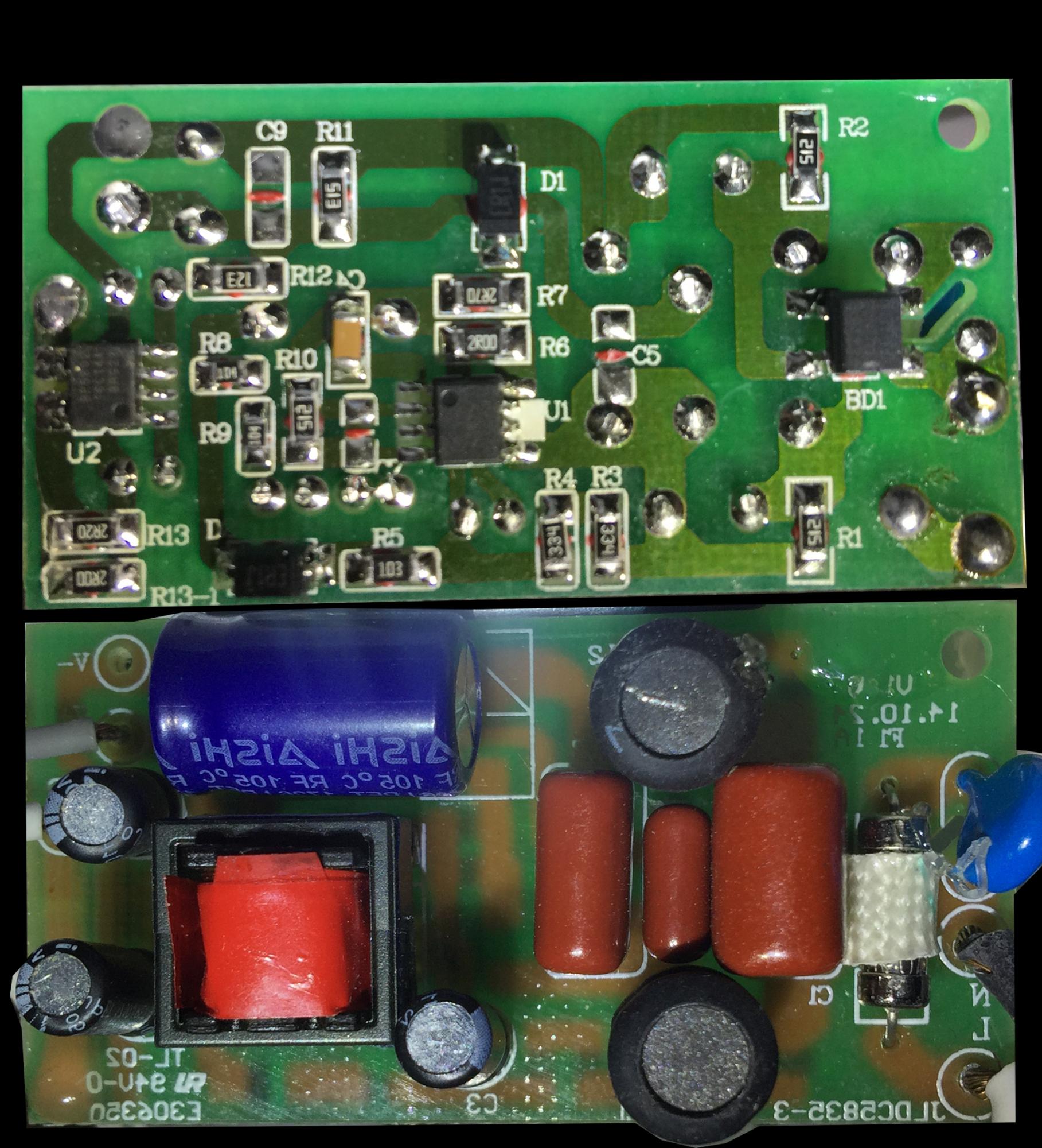

    That power supply board looks like capacitive dropper type.
    Are there any parts on the bottom side of the board.

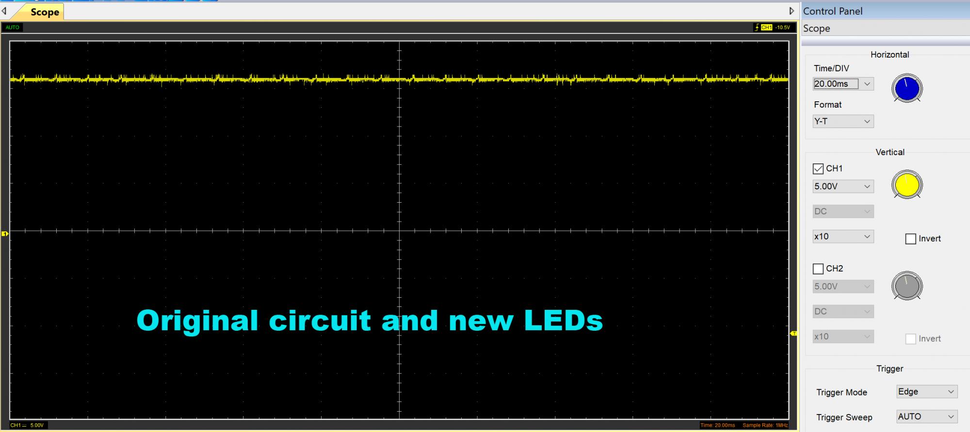

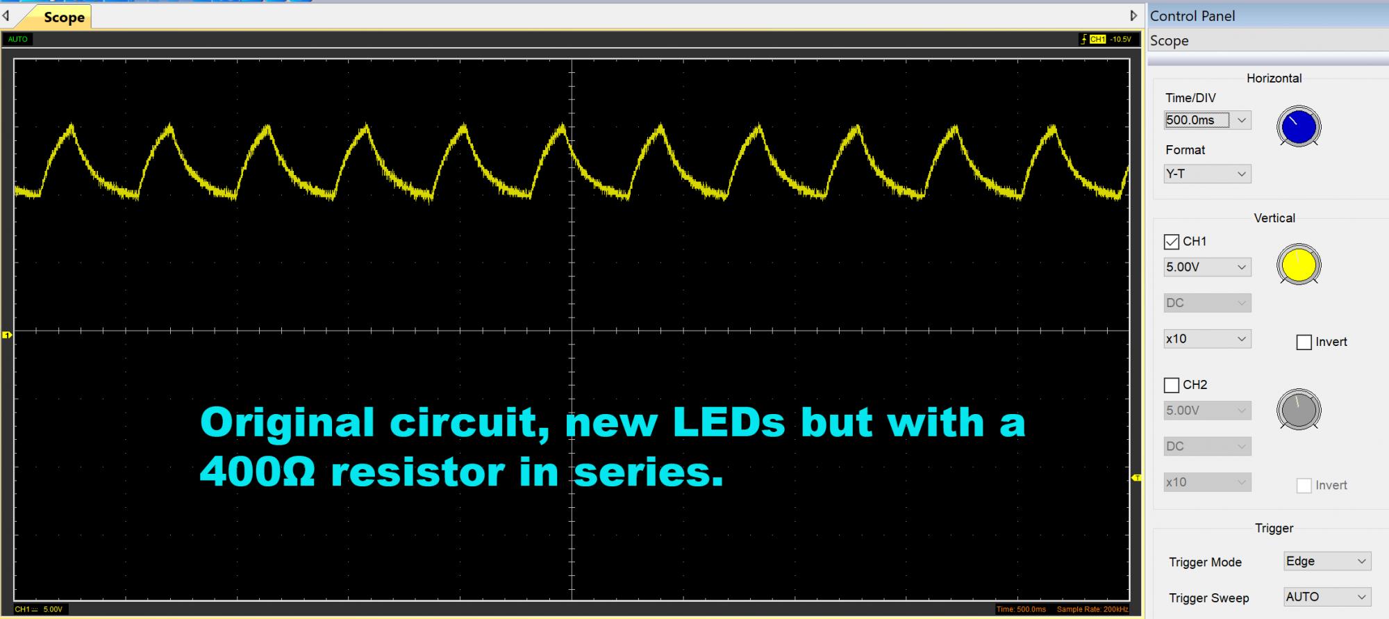

      Is it really pulsing? What is the ON time and OFF time of the pulse being applied to the LED's?
      So this is kind of interesting ... here is the voltage with the stock circuit powering the new LEDs with no other modifications:
      and here is the same exact thing with an added 400Ω resistor in series
      it definitely pulses on and off with the resistor in series ... by the way I tested this earlier with my ammeter and it still draws 170ma even with a series resistor in place and even when it flashes...

        I do not understand the 'ORIGINAL CIRCUIT', what is the ORIGINAL CIRCUIT? The power supply module? You should also shows the bottom side of the board so we can see how the output section is setup, it may be setup as constant current source already.
        So the second picture shows ripple (5V P-P) riding on top of 12.5VDC. at what test point is that?
        15V source (based on you scope showing 5V per division with compensation with x10 PROBE) with 400 Ohms so the max shorted current will be 15V/400 Ohms = 37.5mA so how many LED's are connected in series with that resistor?
          ORIGINAL CIRCUIT = Driver circuit installed in the lamp from the factory ... the "original" ... no modifications, and no additions to the output etc.
          OK, so when I said there was nothing on the underside of this board, I made a mistake ... I was thinking of my other thread about the flashlight circuit ... this one does have stuff on the bottom ... here is the picture... I reversed one of the images so that the components line up properly ... you'll see what I mean ...
          I have NINE LEDs in series but only 4 are working now ... here are the exact LEDs that I'm using:

              That looks to be non-isolated constant current power supply (HOT chassis, so I hope you are using scope without the safety connected which is dangerous or connect this board to isolation transformer), what are the P/N of IC U1, U2?
                  offcourse you did, there were no semiconductors on the top side, so nothing to rectify mains ac etc.
                  that small smps pos(like "cheap chinese piece of shit") has no power and that's why it starts to pulse as soon as you (over)load it, and it doesn't take much.

                    Look at the attached image ... the power comes in through that ... im assuming thats an isolation transformer?
                    U1
                    BP2326A
                    16D30A
                    DEG26 or OEG26 or CEG26
                    U2
                    BP5602
                    16C14A
                    BRG23
                    sigpic

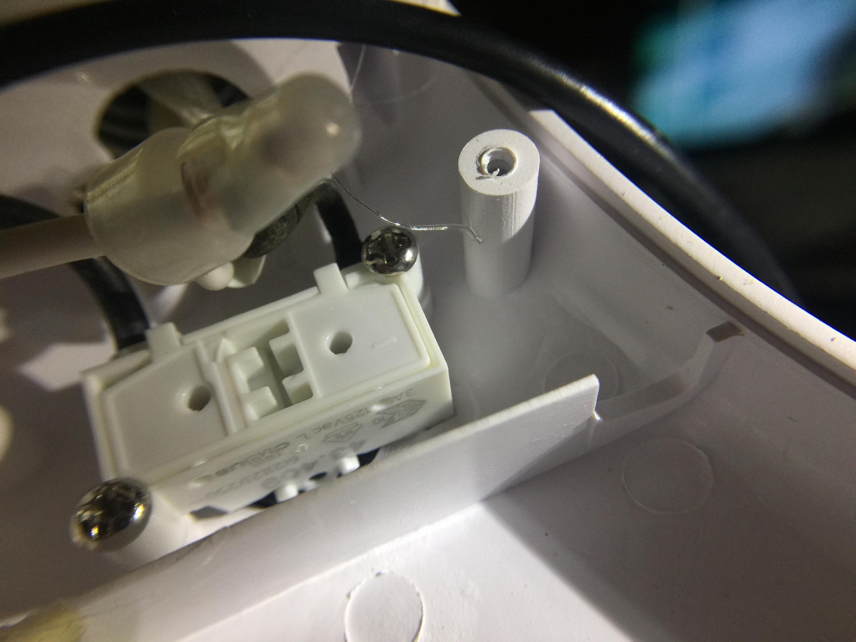

                      looks like a connector block ..
                      p.s there seems to be a stray bare wire melted into the wire nut .

                              U1 BP2326:
                              https://cdn.badcaps-static.com/pdfs/...aa1495d297.pdf
                              U2 BP5602: http://bpsemi.com.cn/uploads/file/20...170036_863.ppt
                              Looking at the board layout, it looks like U1 (BP2326) is set up as the Buck converter to supply the Voltage to run the U2 (BP5602) LED driver.
                              Resistors (R13/R13 1 (2R20 Ohms in parallel = 1.1 Ohms) connected in parallel) at CS pins 7 & 8 of BP5602 determine the LED current setting.
                              Formula: Rcs = 0.2V/Iout, that means it is set for about 180mA (Iout = 0.2V/1.1 Ohms) of constant current which is what you have found out in the earlier test. So when you put 400 Ohms in series, there is no way the circuit can force 180mA through 400 Ohms resistor + the LED's, the power supply does not have enough Voltage to force 180mA through, 400 Ohms x 0.18A = 72V so no way it will happen.
                                Actually, it ended up being the on off switch...

                                  https://www.badcaps.net/forum/attach...8&d=1541545003
                                  Looks like line filter, rated at 3A 12VAC.
                                  Ended up being the on off switch ... I'll take a BIG FAT ZERO for that one ...
                                    When I dropped the series resistor down low enough to make it stop blinking, it still drew 170ma ... and when I had the 400 in there, it drew 170ma ... just not constantly (obviously) ... its as if a series resistor didn't do Diddley squat for limiting current ... which kind of makes sense if the power supply is a CC at 180ma .... what respectable CC power supply would give two craps about a pesky series resistor ... just another obstacle to overcome for the power supply is all ... it's gonna deliver 180ma come hell or high water ... or pulse on and off like a whiney two year old if the load is too heavy ... but at least it's putting forth a valiant effort...
                                    So all of this analysis of the circuit was fun and all ... but the question is still on the table: How do I take 120V AC and kick out some decent DC voltage at roughly 100 to 120 milliamps in the small space I have to work in? Remember STJ recommended the capacitive dropper ... what are your thoughts on that option?

                                      It cannot force 180mA through 400 Ohms resistor if the power supply cannot go up high enough to force 180mA through the resistor, the Voltage across the load is varied to maintain constant current.
