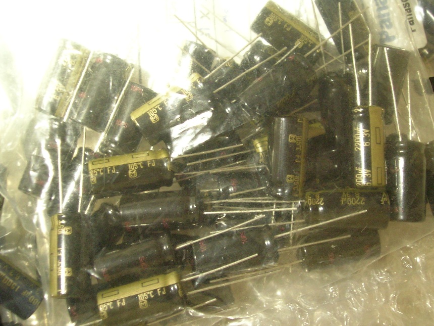

    Is this genuine Panasonic FJ ?

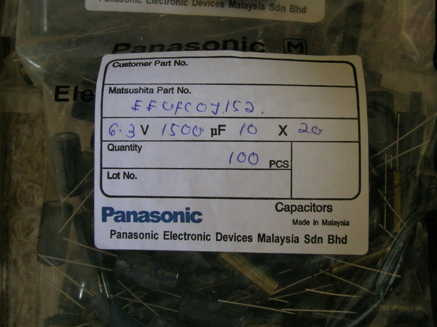

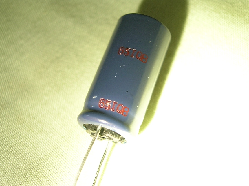

    Had just bought 50pcs panny FJ from local surplus store. Not sure whether it is genuine or fake. The date code marking is different ... I compared it with FC samples factory.
    pict_01: FC sample from factory
    pict_02: date code of the FC sample [ 65IQB -- year 2006, may, 1st week, line Q, prod. date 2 ]

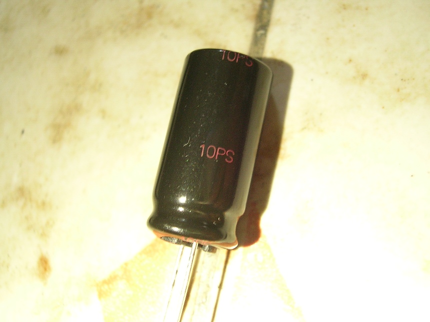

    pict_03: FJ from local store
    pict_04: date code of FJ: 10PS -- ?
  • linuxguru
    • Apr 2005
    • 1564
    Re: Is this genuine Panasonic FJ ?
    It looks like they're using a different red date code (?), but other than that, it looks nearly identical to the Malaysian FJs that I have. If you can, post a pic of the bottom rubber bung as well as the top vent scoring. The Malaysian Pannys have a much wider scoring on the top vent than the Japanese Pannys, but they're functionally equivalent.
    In my opinion, these are authentic Malaysian FJs.

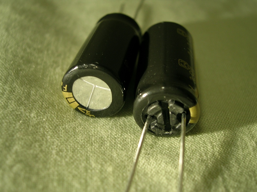

      Here is the pict. of top vent and bottom rubber bung of FJs.
      • linuxguru
        • Apr 2005
        • 1564
        Yes, it's genuine. A low-cost counterfeit that's this good in finish would not be worthwhile for the counterfeiter.
