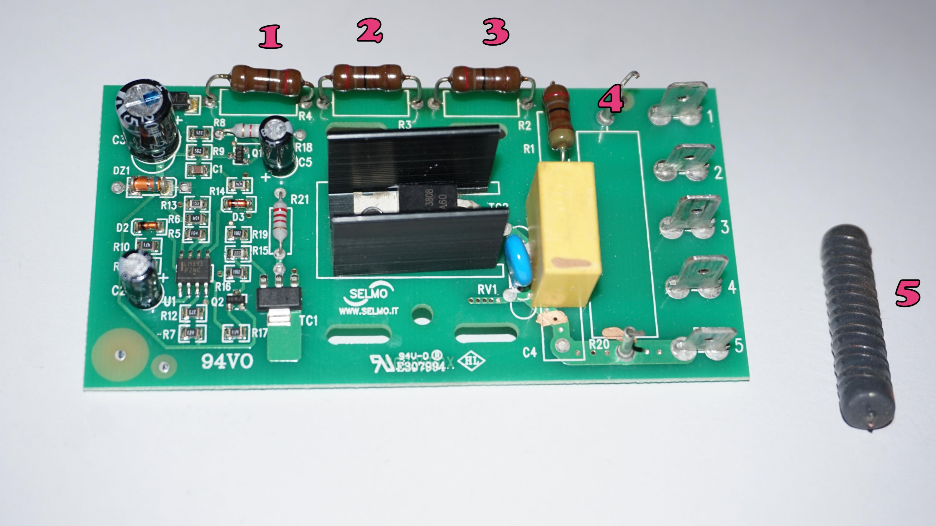

    Hi Guys
    I have a Makita 440 Vacum and when i was switching it on it wouldnt work but LEDS were on at switch
    When i opened it up looked okay
    The power is going to the switches okay, i tested the motor direct to 240v it is fine
    So the only other bit is this small PCB and im a rookie and cant/wont pay £50 for a new board or $80
    So was wanting to replace the capcitators, can anyone please let me know what the small cap types are at the top? and the big long one ive already removed?
    So i can buy new caps and replace them,

    Re: Makita 440 Cap types?
    that is a resistor .
          All components you call capacitors and have given numbers in the photo in your OP are resistors.
            Like everyone says, those are resistors.
            You can grab a multimeter and measure the resistor you broke off.
            You can desolder at least one leg of the other resistors and then measure those, or you can just figure out the value using the colors http://www.resistorguide.com/resistor-color-code/
            The capacitors are the ones with code starting with C and they look fine from here.

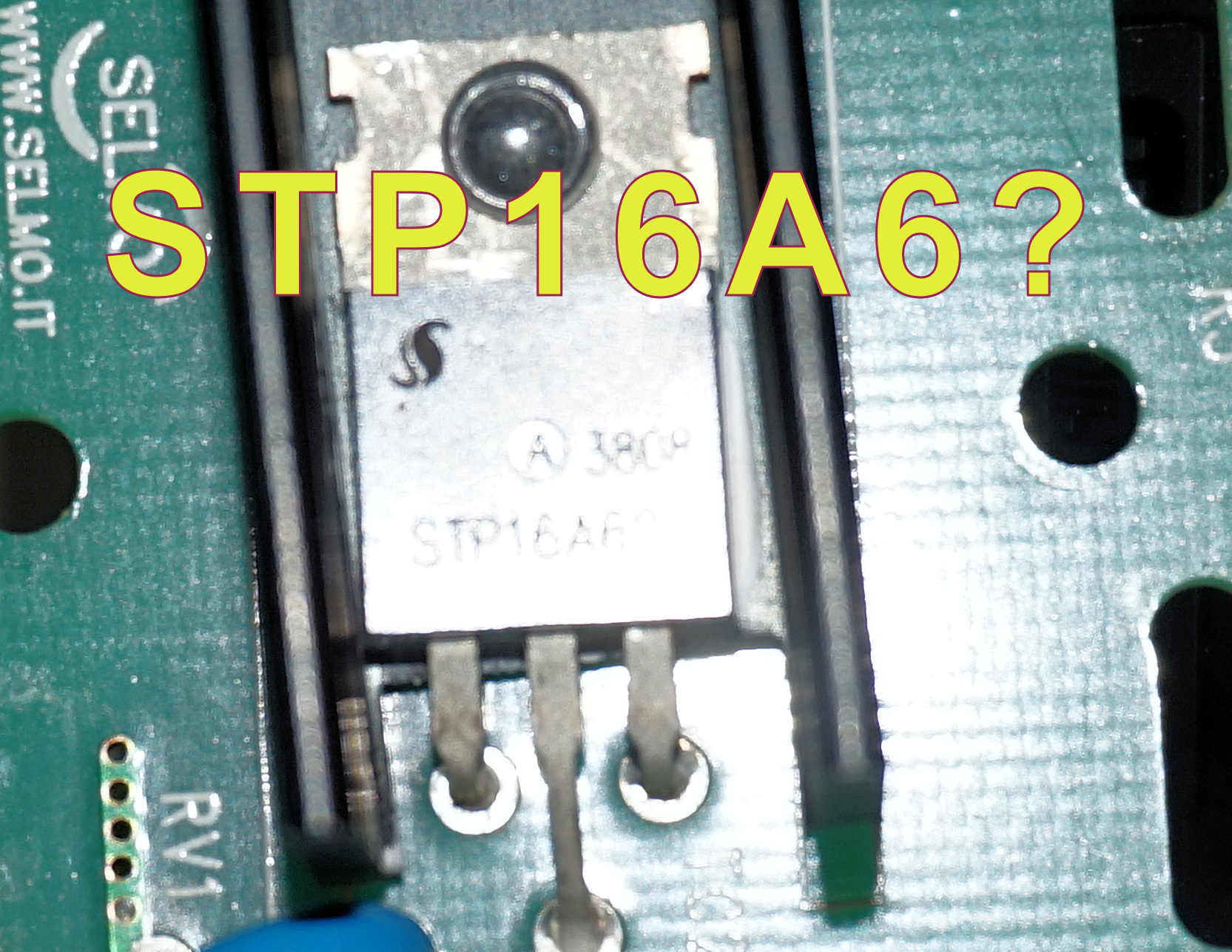

            Other points of failure could be that chip on the heatsink (with 3808 on it, which is probably mosfet or transistor or triac or something like that) and maybe that sot-223 chip with code TC1 (temperature compensation? maybe some temperature over-protection?)

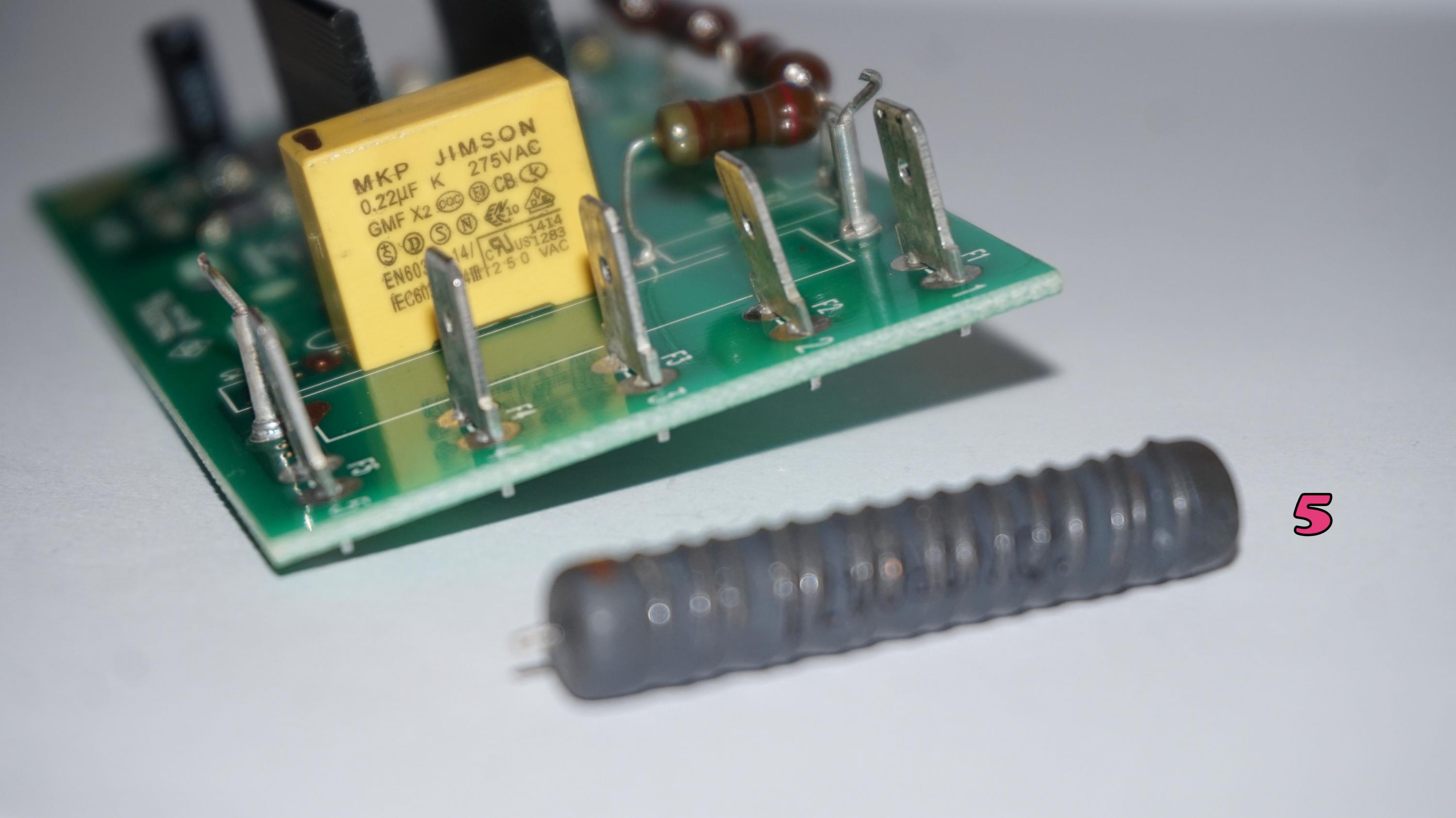

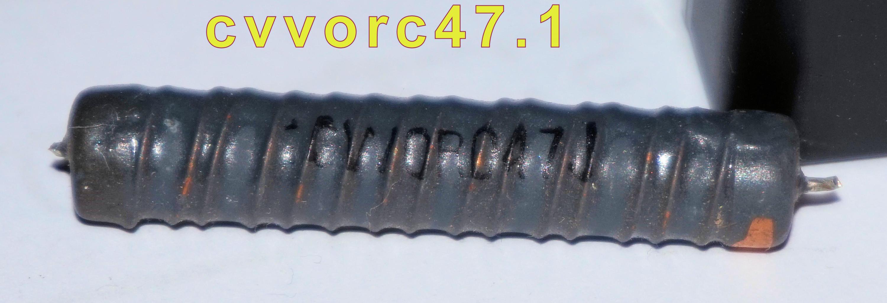

              The large resistor you cut out is 10W0r047J it is recommended to also check R18 3.9k

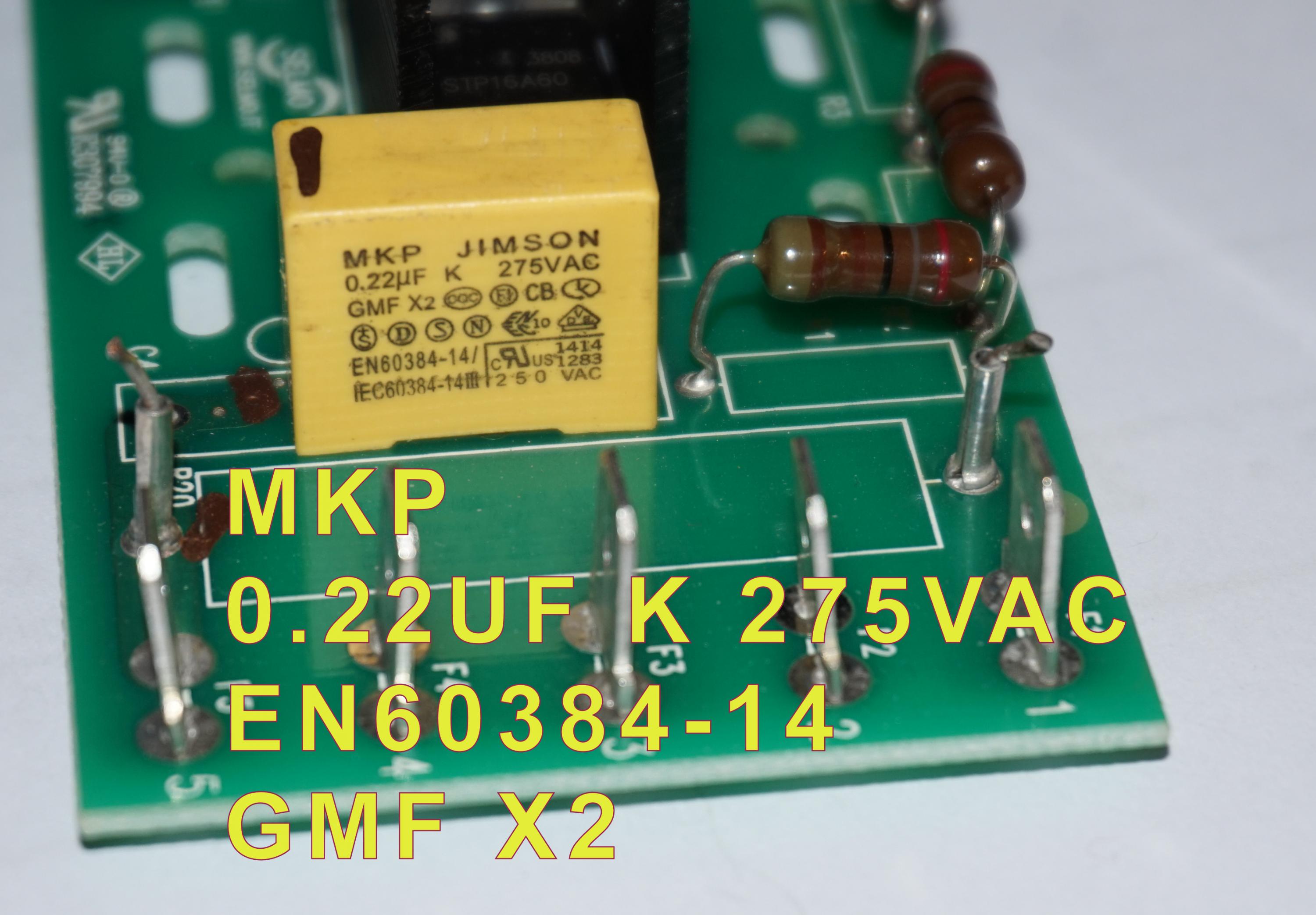

                the yellow cap and r 1 thru 4 are failure prone.
                that provides low voltage supply for the controller.
                its simply clamped by a zener and filtered by a lytic.
                    I cant find anything on google with those codes, is there any alternatives to what resistors i should buy?
                    Ive already ordered the yellow ones but wanted to try and get new heatsink with 3808
                    and 10W0r047J and R18 3.9k
                      http://resistor.cherryjourney.pt/
                      got the resistor codes just the long one and other ones now

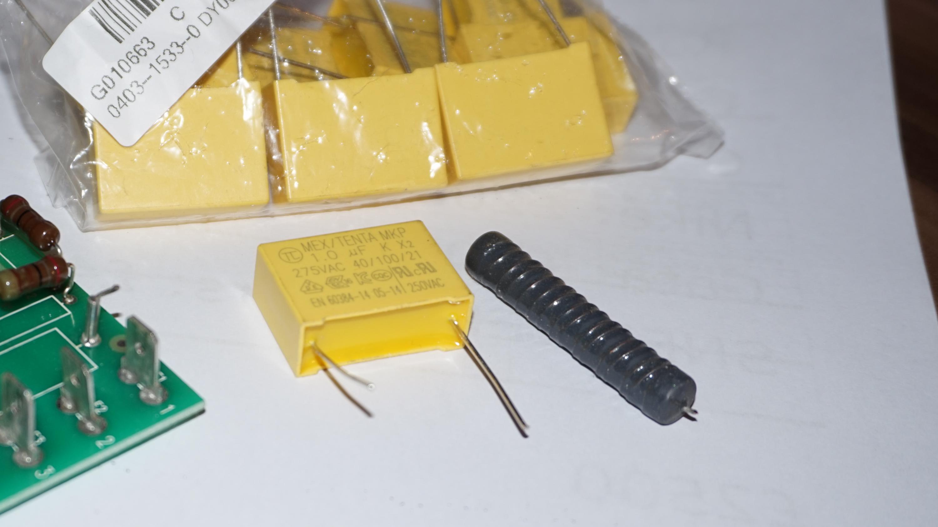

                        I Spoke to soon
                        Got the new yellow caps and they too big
                        anyone know where i can get the other heatsink with 3808
                          It looks like the triac is a BTB16-6008, If the original is bad, remove it from the heatsink and replace it.
                                  x2 series .. farnel have them .
                                      also try cpc in case there is free shipping ...http://cpc.farnell.com/search?st=MKP3382
