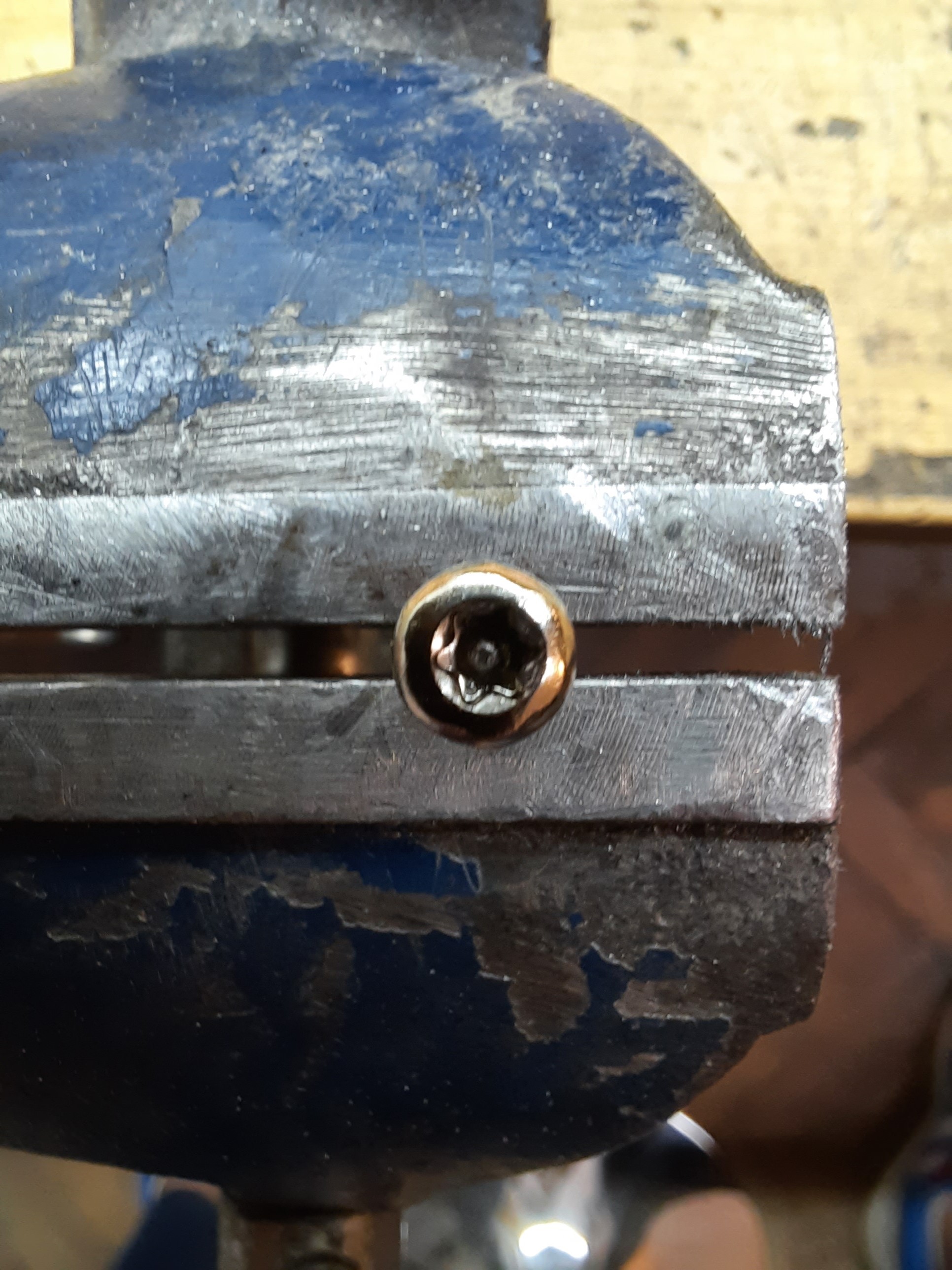

    Hi all
    Trying to take this thing apart & there are 2 screws buried deep in the back of unit .
    Look like torx of hexagonal heads .
    Can anyone help with type & size of driver required ?

      Re: DMR115 , Makita on site radio
      Thanks Sam
      Pulled up the exploded view , & seems to use M3 HEX type screws
      Ordered a 4 piece set of long bits from Ebay .
      Hopefully one of them will fit .
      • zen
        • 511
        Contrary to exploded view ,the head is actually a Torx type .
        It's a TX15 & needs to be a minimum of 100 mm in length to reach screw .
        How do i know ? , well ended up sacrificing a long HEX 3 mm bit , which i filed down enough to grip screws , then remove them .

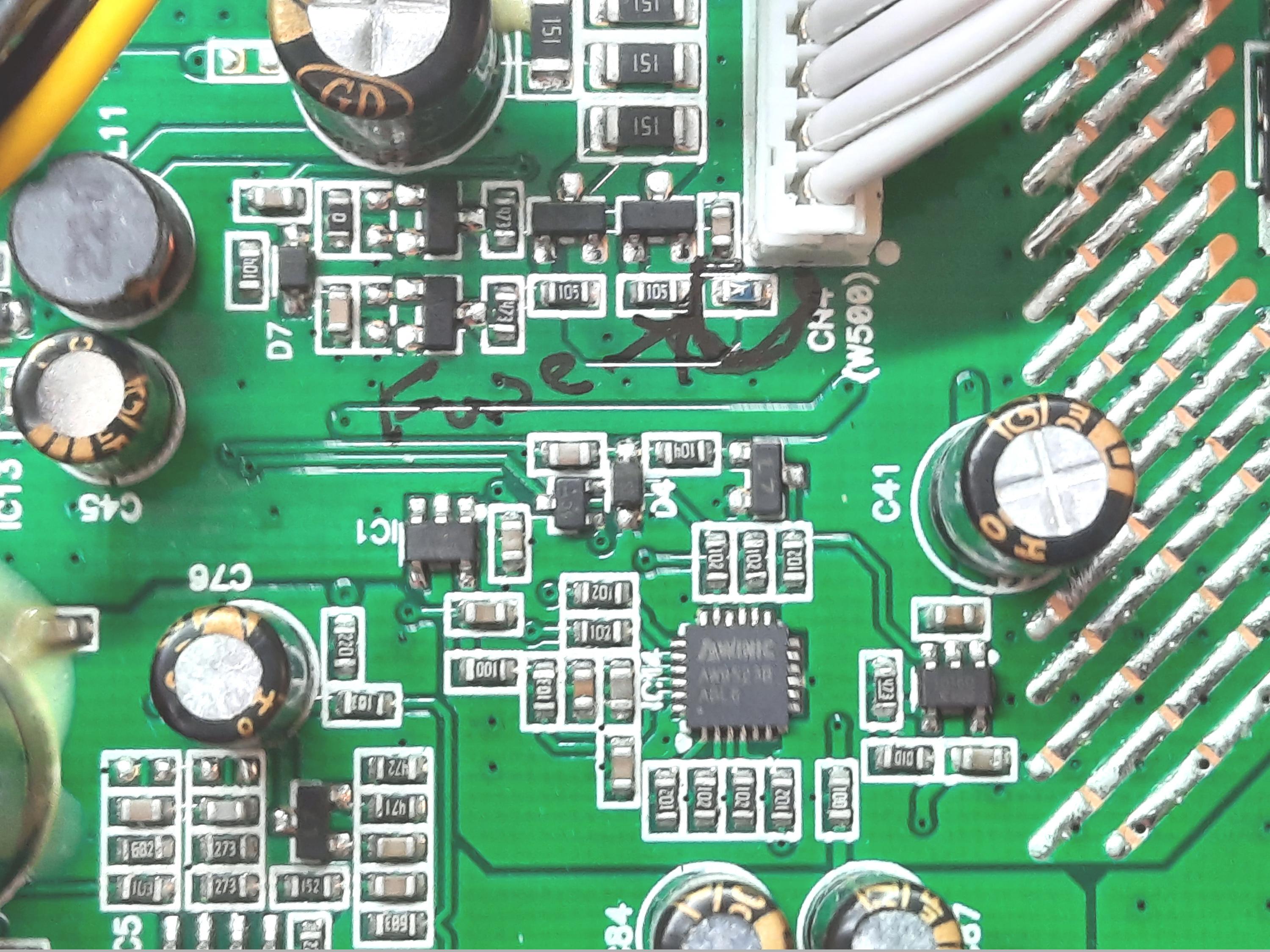

          Discovered an SMD fuse O/C , next to connector CN4 .
          Might be lucky for a change .
          I would gauge it's value at just over 3 AMP , as battery is rated at 3 AMP & the charger 2.5 AMP .
          Will replace it & hope for the best .
          • zen
            • 511
            Fuse marked T , which is 5 AMP .
            Replacement restored power
              that screw is a security-torx,
              what a bunch of fucks!
                A lot of stuff I open lately have that security torx screw.
                  • 31142
                  yes, but they arent usually used in deep recesses - i find tri-wing in those types of casing

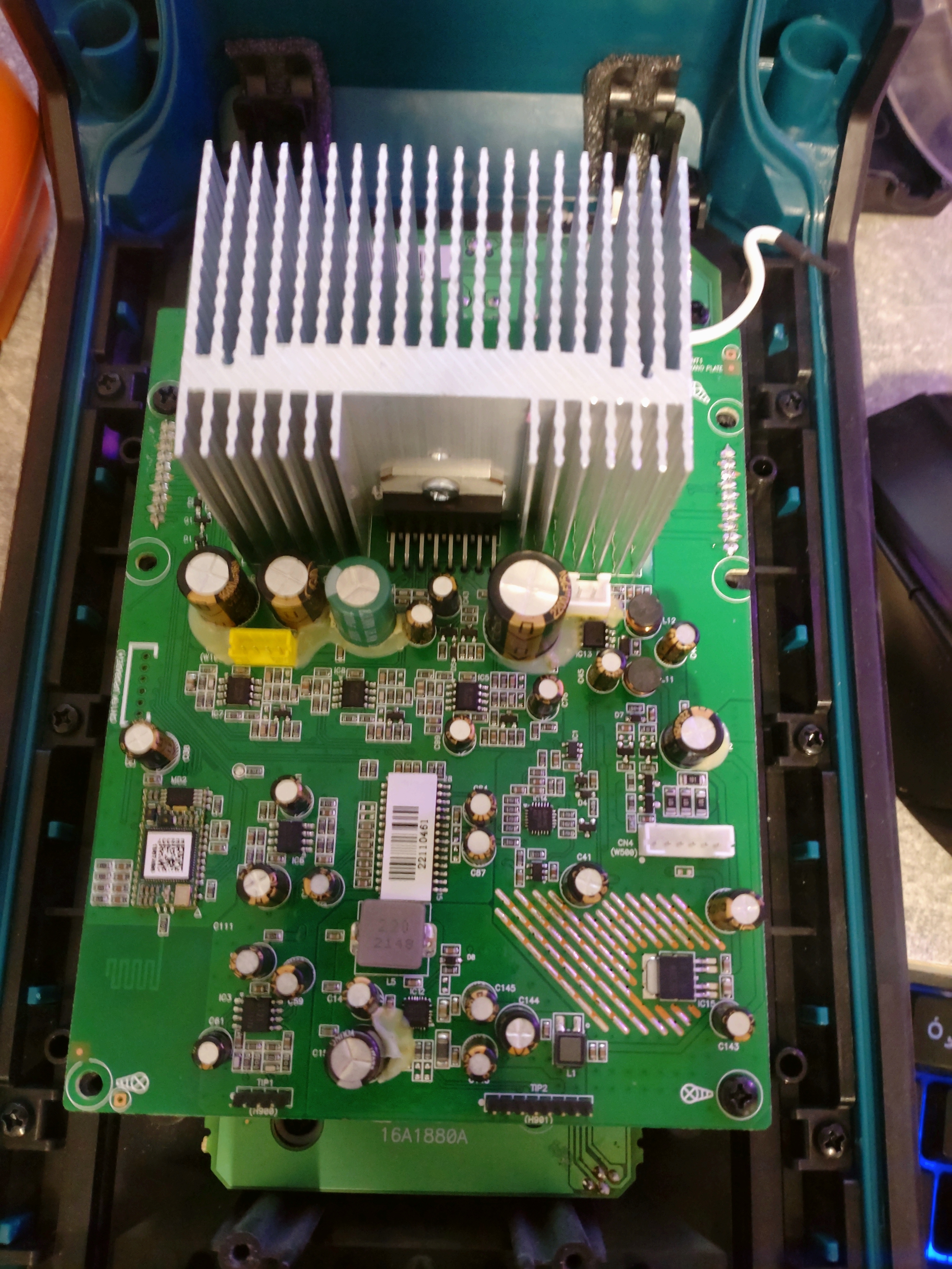

                                Hi! were you able to solve the problem? I also have two such radios, they work after replacing the fuse but cannot be turned off.
                                  • 31142
                                  post pcb pictures
                                  • O.Szilard
                                    • May 2019
                                    • 161
                                    • hungary
                                    Originally posted by stj
                                    post pcb pictures
                                    another problem is that if I connect a battery, the fuse blows immediately. due to sudden high current consumption.
                                      • 31142
                                      trace the battery wires through the fuse and see where they go - then see if that area is getting hot

                                        Hello guys,
                                        If the radio cannot be turned off, replace Mosfet (1) and resistor (2). Resistor is 1M and Mosfet is AO3403. Mosfet is used as a simple DC switch. I used replacement MOSFET IRLML5203TRPBF and it aslo works.
