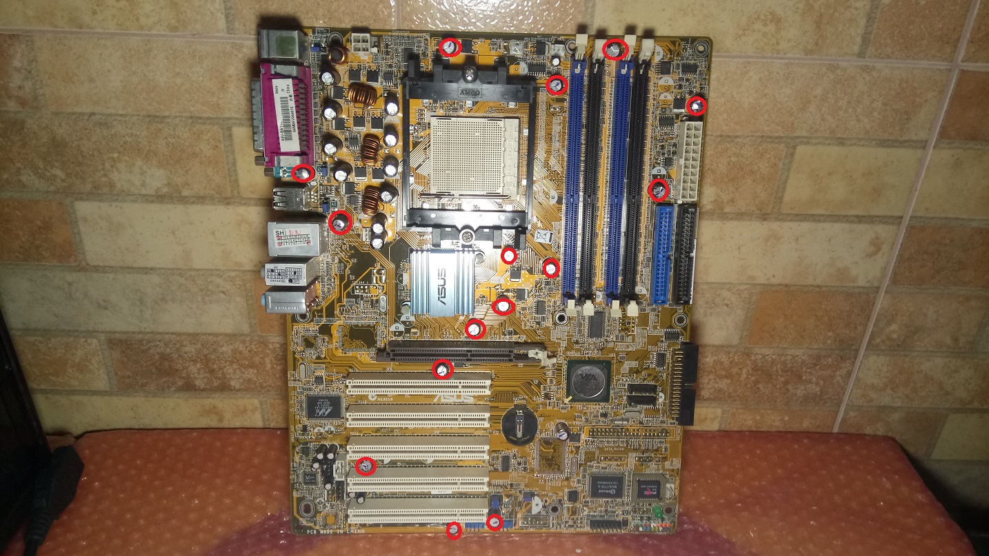

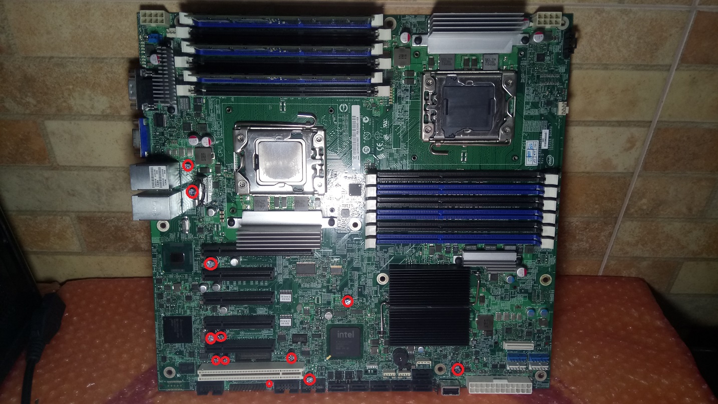

                          • Brazil
                          Re: Swapping japanese/generic electrolythics with solid-states
                          I've checked (eye only) two boards ATM:
                          ASUS A8V:
                          NCC KZG:
                          15x 820uF @ 6.3V
                          INTEL S5520HC:
                          NICHICON:
                          10x 470uf @ 10V
                          NCC KMG:
                          2X 470uF @ 16V
                          Apparently the failed/failing caps aren't responsible for the VRM. The Asus have some Panasonic and Rubycons there while the Intel have polymers.
                          The Asus got some bulged ones (so I think replacing all of them would be wiser) and the Intel have caps sizzling when operating at a high-power level (2x 130W CPUs).
                            For both of these boards, they probably failed due to simply being a problem series (in the case of KZG) or maybe because the power supply had a bad 5v / 5v stand by circuit.
                            On the green board ... all but the one above the chipset and the one near the 24 pin atx connector are used as additional filtering for 5v in PCI slots and USB ports.
                            Not really worth spending extra money on polymer capacitors to replace those.. you can use any 820uF 6.3v .. 16v electrolytic capacitors with low esr ... can also be higher, 1000-1200uF would be safe to use. You can go up in voltage (if you have for example 820uF 16v capacitors left from another project for example you can use those), just make sure they're not too tall to block cards ... for example for the capacitors near the pci slots.
                            You can use any low ESR electrolytic capacitors .. panasonic fm, fr, nichicon hm, hn, nippon chemi con kze, ky , rubycon zlg , yxg, zlh, zlj
                            You can replace the 10v rated Nichicon capacitors with 6.3v rated capacitors, those are also used with 5v or less...
                            The second power supply also has some capacitors that only filter usb ports (they're near the usb connectors or headers) but that one has more of those near the cpu socket and memory sticks, probably that board uses a dc-dc converter that uses 5v to 1.8v or whatever the voltage used for memory is.
                            The first one uses 12v to produce the lower voltages for memory, because there's more sticks and makes more sense to use 12v for conversion.
                              ASUS A8V:
                              NCC KZG:
                              15x 820uF @ 6.3V
                              INTEL S5520HC:
                              NICHICON:
                              10x 470uf @ 10V
                              NCC KMG:
                              2X 470uF @ 16V
                              For the Asus board:
                              Re-cap the VRM. Those caps are approaching almost 15 years now. I have opened up 15 year old Panasonic FL/FJ. They do not look pretty inside (electrolyte concentrates on the bottom - for lack of a better way of putting it at the moment). The VRM high and low are 8mm. For the high use 16V 270uF-470uF polymers or better, and for the low use 2.5v-4v 680uF or better (You can get 2.5v 1500uF polymers in 8mm if you're prepared to pay).
                              For the Intel board:
                              Just replace the electrolytics with polymer equivalents (and do the same for the Asus - i.e. replace all the non-VRM caps).
                              If you want to save money, use something like Panasonic FR or equivalent for these non-VRM caps.
                              If you need help finding caps, let me know.
                                Thanks for the tips. The green PCB is the Intel one, it's a server board that handles quite some load into it. I haven't seen any bulged (top) on it, just some sizzling. The board operates OK, I just want to recap BEFORE anything goes bad since I've heard the sizzling noise when using high power CPUs.
                                Originally posted by mockingbird
                                For the Asus board:
                                Thanks. So I should go for a full recap on the Asus. I'll check the specs on the VRM caps (Rubys next to the CPU side, Panas to the IO side) later. What bothered me is that the board hadn't a single cap bulging or leaking (from the top) last time I've played with it, a year and half ago. Looks like bad caps can go poof even when not used at all.
                                  +1
                                  For the non-VRM caps of the ASUS A8V board, none of the caps need to have very good ESR spec, despite the originals being KZG. This is because older ASUS boards from that vintage use linear regulators pretty much throughout the board. Thus ultra-low ESR caps are not a requirement at all.
                                  That noise might be coil whine too.
                                  That's Chemicon KZG for ya! (Same goes for KZJ too, tough it happens far less often.) That said, newer KZG caps (made past 2008/2009) haven't had too many problems, so looks like Chemicon might have actually fixed the issue.
                                    for the asus a8v, i think u missed a cap near the cmos battery right by the mosfet. i have this exact same board and the cap and mosfet there actually regulates the 5vsb supply for the board. i recommend replacing that as well so u have 16 kzg caps to replace not 15.
                                    • Uranium-235
                                      Comrade Glimmer
                                      • Aug 2007
                                      • 5042
                                      • US
                                      I had an A8N, and I believe someone I knew had an A8V. Just remember one thing. These Asus boards have the capacitor half-moon mark on the POSITIVE side of the capacitor.
                                      • mariushm
                                        • May 2011
                                        • 3799
                                        Yeah, Asus and Asrock (for some time, I'm not sure they still do it) ... used the reverse notation for capacitors where the filled side of the circle represented the positive.
                                        Good to keep in mind as HP if I remember correctly often uses OEM motherboards made by Asus
