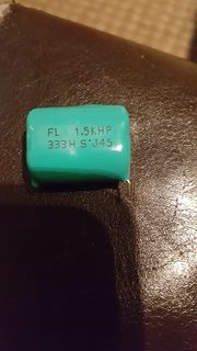

    where can i get one of these caps
    please can someone help ,where can i get the same type of cap as this in the uk.ive tried rs components but cant find one.
    its 33nf rated at 1.5kv.
    thank you.

    nearest i can find is this only 1kv rated not sure if would work though maybe budm can advise if a suitable replacement for that position on the pcb
    http://www.ebay.co.uk/itm/Capacitors...AAAOSw8gVX8Hp3
    http://www.ebay.co.uk/itm/Capacitors...3D381795915318

      what exactly is it from?
      with a schematic we could work out the maximum voltage

        its a lg 42pj550-zd set if i remember correctly from his other thread

            Maybe these will do free uk delivery too
            https://www.amazon.co.uk/MKS4-33N-15...polyester+33nF
            your capacitor looks resin dipped so not sure if these will work?

              I really underestimated my longtime stock , if this little thingy is priced at 18 dollars , lol .
              The red one is compatible 100% ..
